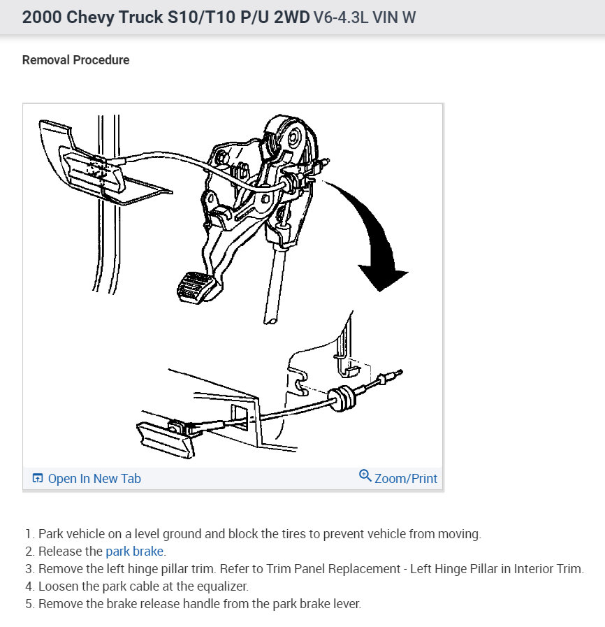

parking brake will not release?
2000 CHEVROLET S-10
53,000 MILES • V6 • 2WD • AUTOMATIC
MIKE121842
parking brake not releasing.
Mar 3, 2023 at 8:34 PM
  • 55,433 POSTS
So, can you feel the e brake hold mechanism release when you pull the release lever, and the car doesn't move? or the e brake mechanism does not release when you pull the level, we need more information than what you have given? Here is a diagrams of the parking brake and you can see the cable that releases the system you may need to work it manually. Check out the images (below). Let us know what happens and please upload pictures or videos of the problem.
