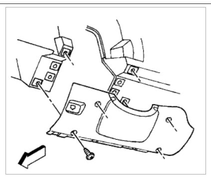

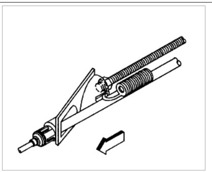

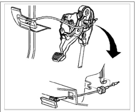

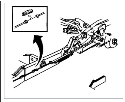

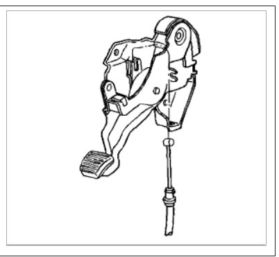

Brakes problem 6 cyl Two Wheel Drive Automatic 43000 miles
The parking brake does not engage when stepped on The brake peddle mechanism is not engaged and will not stay engaged. I do not think it ever worked. Is there some type of adjustment on the release cable? Please help
Sep 2, 2010 at 4:22 AM
  • 55,423 POSTS
There is an adjustment, however make sure that the cables are connected. It sounds like you have a foot actuator that has gone out here is diagrams to help you see how to replace it.
