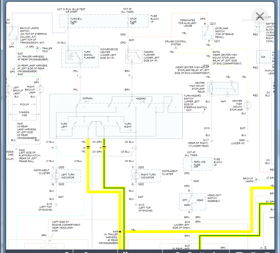

On my 1994 Chevrolet 1500 my Park lights tail lights and brake lights are not working or Dash lights. Can anyone please give me some suggestions thank you so much for your time
Jun 7, 2021 at 9:17 AM

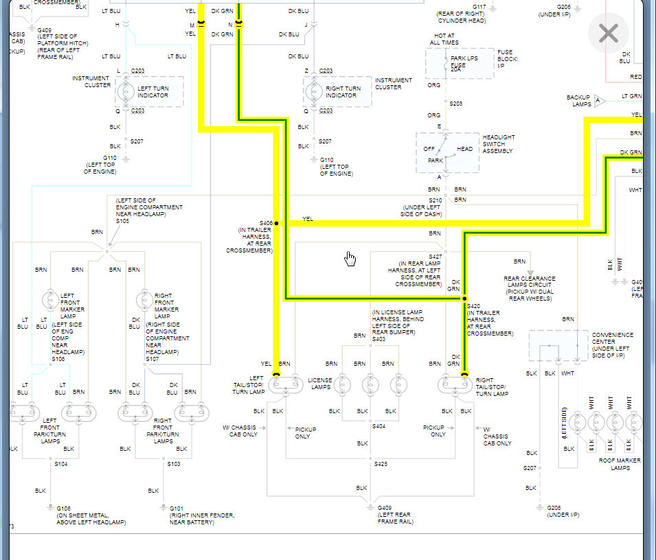

The most likely cause of this is the multifunction switch as these bulbs are run through the switch. I would suggest starting with checking for power coming out of the switch and if you don't have any then I would replace it and go from there.
It is unlikely that the interior lights are related to this so I would just start with the exterior and if it repairs both then that is a bonus.
Below are the wiring diagrams that we need to test this. Please let us know if you have questions and what you find. Thanks
