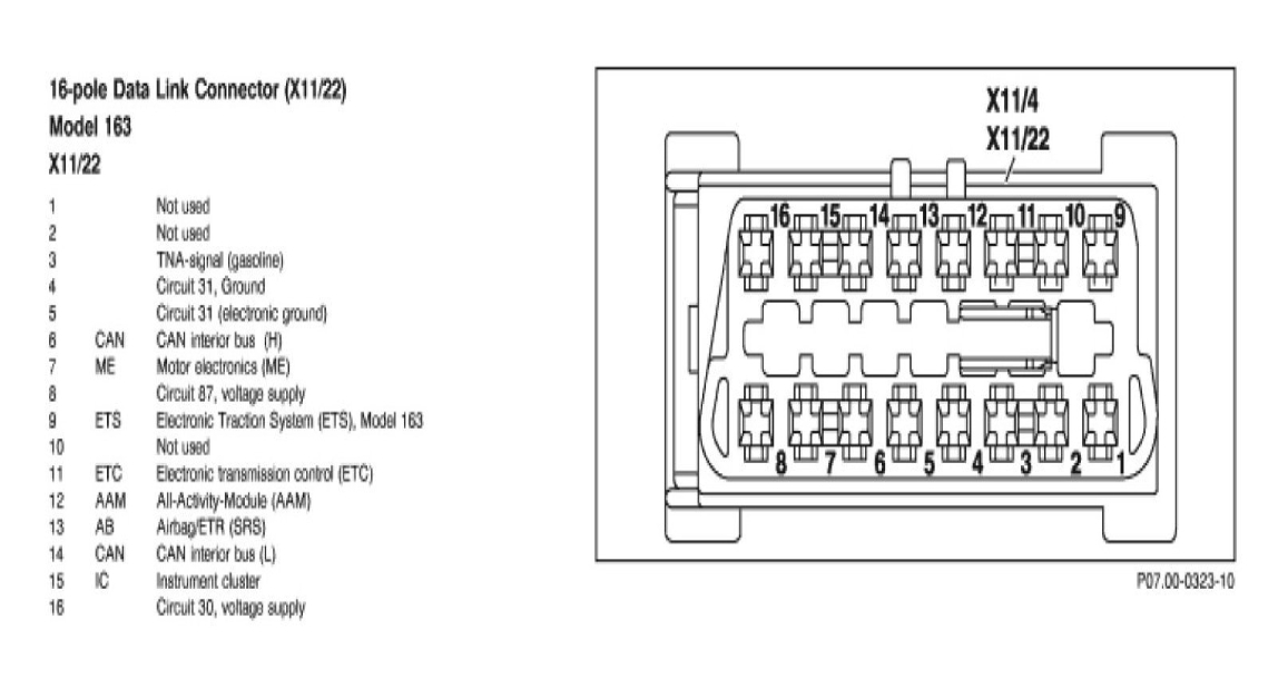

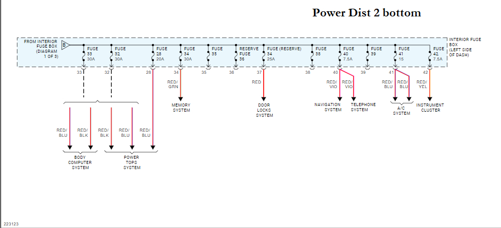

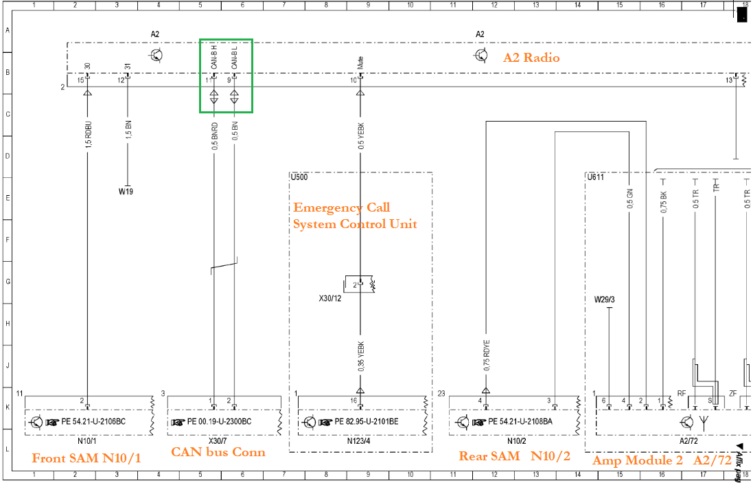

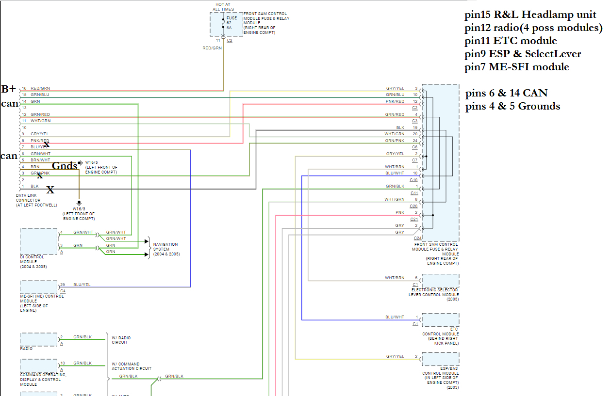

You can check for voltage at the DLC, pin 16 is B+, 4 & 5 are still grounds, 6 & 14 are Interior CAN bus High and Low, the rest are labelled on the 1st OEM diagram, not sure how accurate the aftermarket one is I marked out in the 2nd diagram. But 6 and 14 should drop off to 0volts when it goes to sleep. I'm not sure how many CAN bus networks there are in total, since it looks like there are other diagnostic connectors possibly in the vehicle.
The label 6A on the amp clamp just means it will read up to 6amps on that setting, it's for accuracy if you need to measure higher amperage circuits.
Friday, December 15th, 2023 AT 5:33 PM

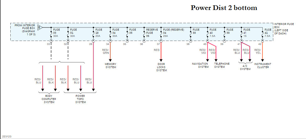

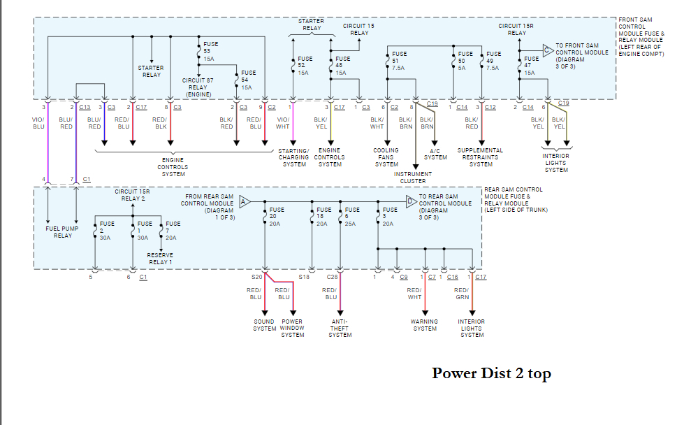

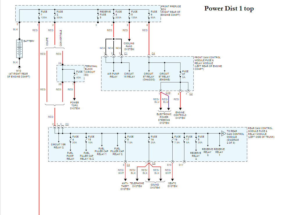

So far overnight it has dropped to 12.25, which is a good sign. I need to find out what those 2 fuses are for first. Seems like more than one fuse is drawing current, but they also could be for one system. Can you get me the diagram for the fuse box with labels as none are found in the car or on the fuse cover?

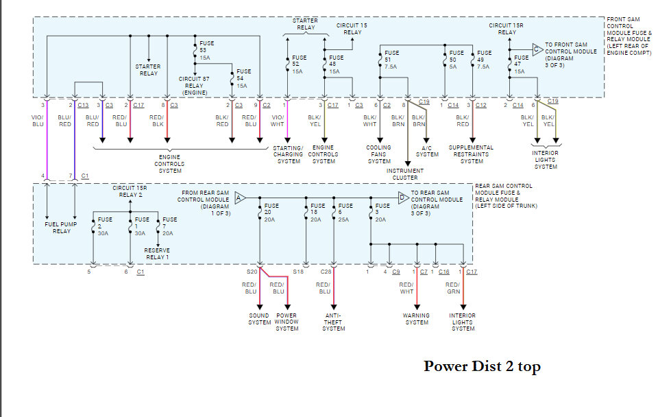

Saturday, December 16th, 2023 AT 4:02 AM
AL514

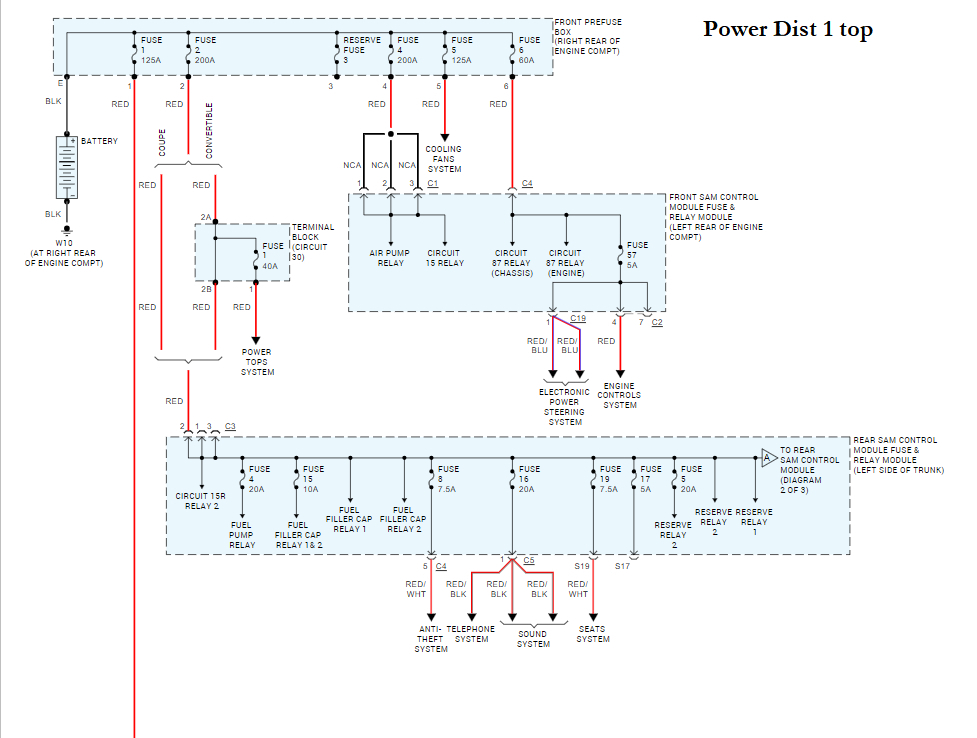

  • 4,793 POSTS

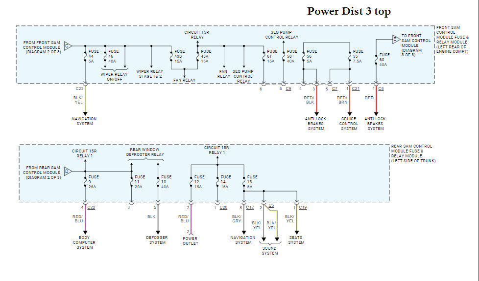

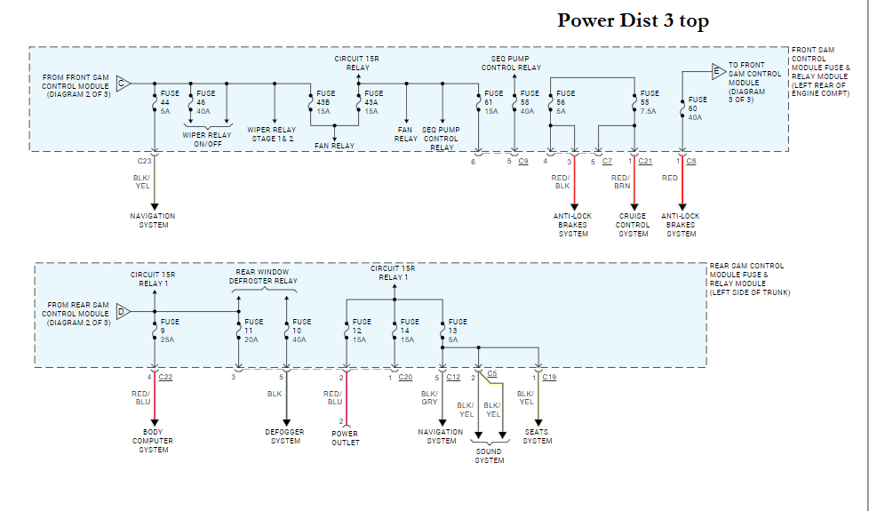

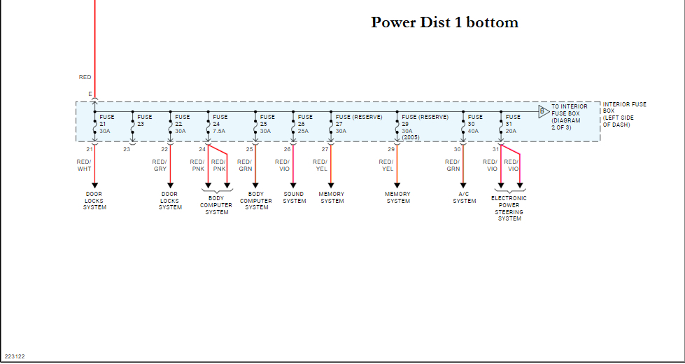

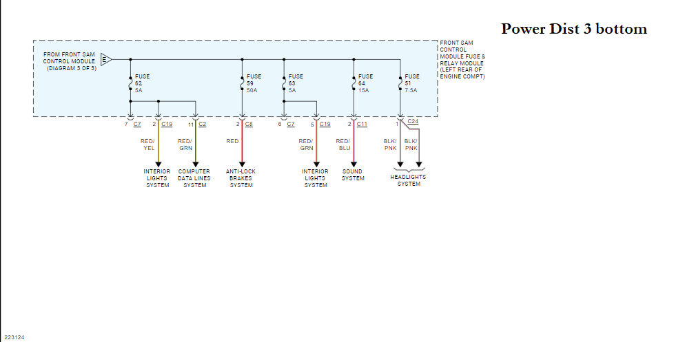

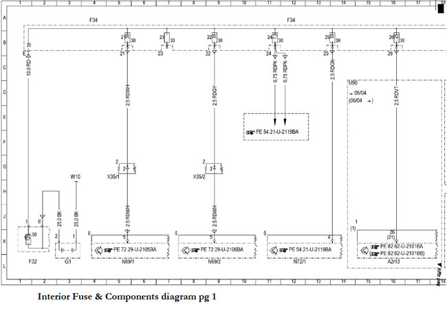

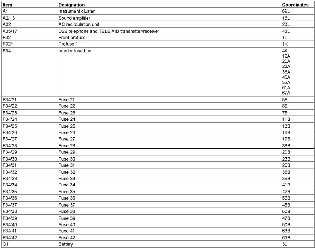

These are the aftermarket power distribution diagrams, the OEMs are pretty difficult to read, but if something is missing let me know. The aftermarket info is not always full.
How many fuse panels are there in the vehicle?
Saturday, December 16th, 2023 AT 10:47 AM

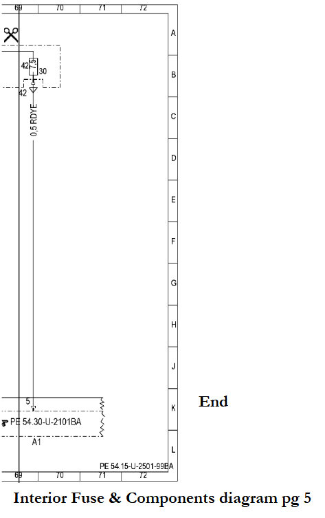

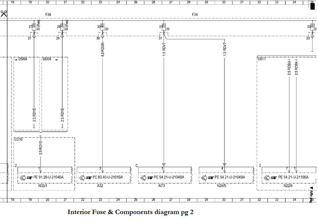

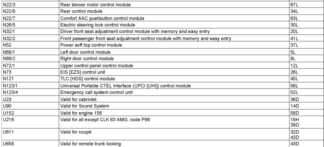

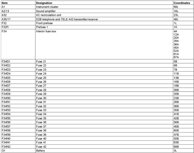

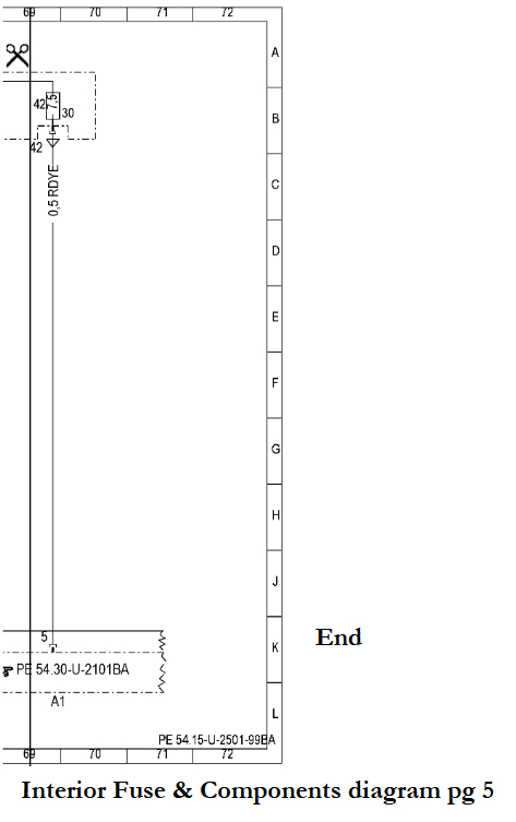

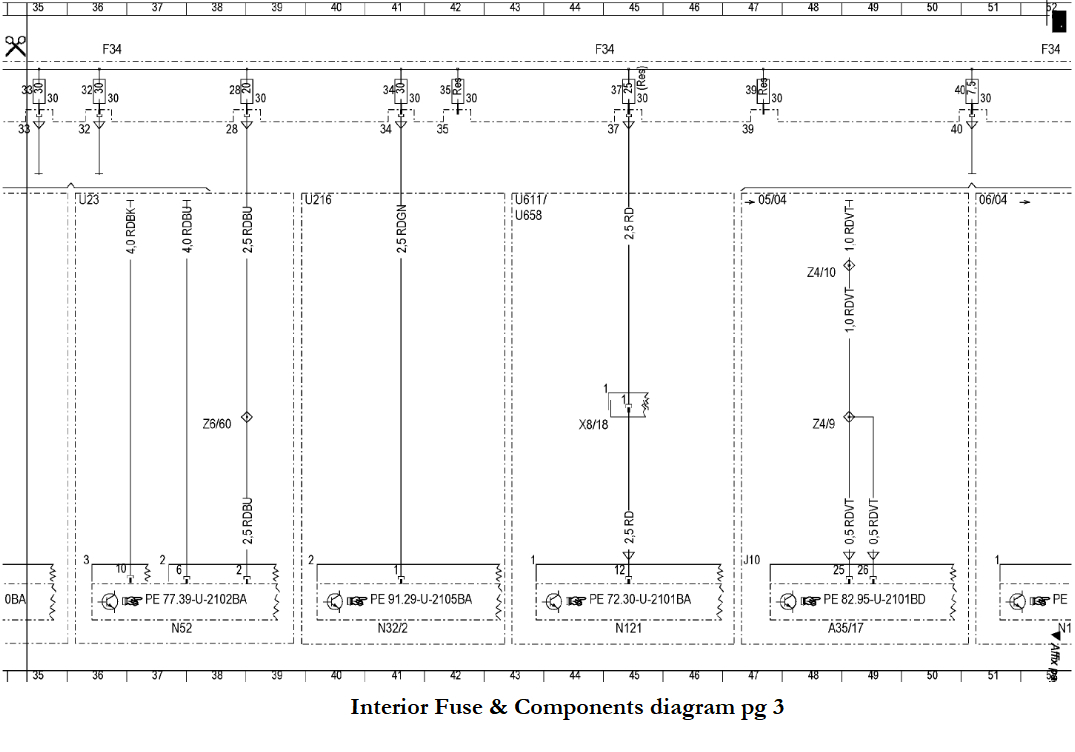

AL514
  • 4,793 POSTS

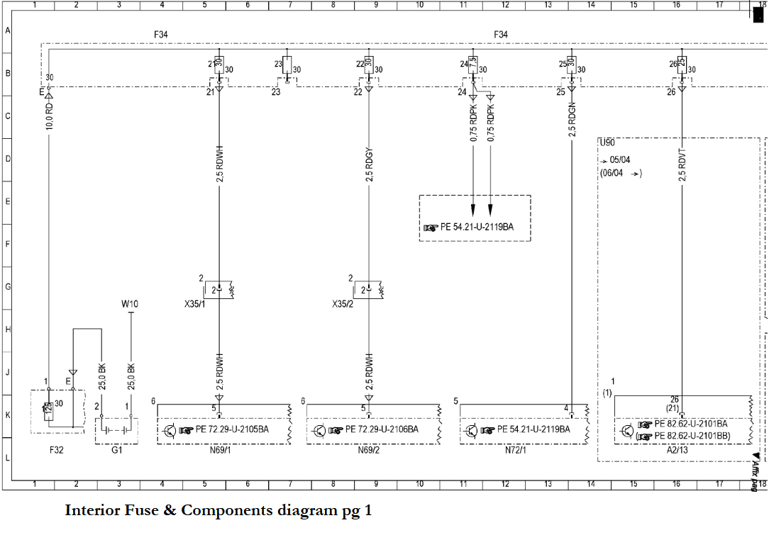

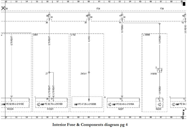

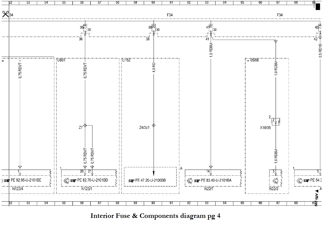

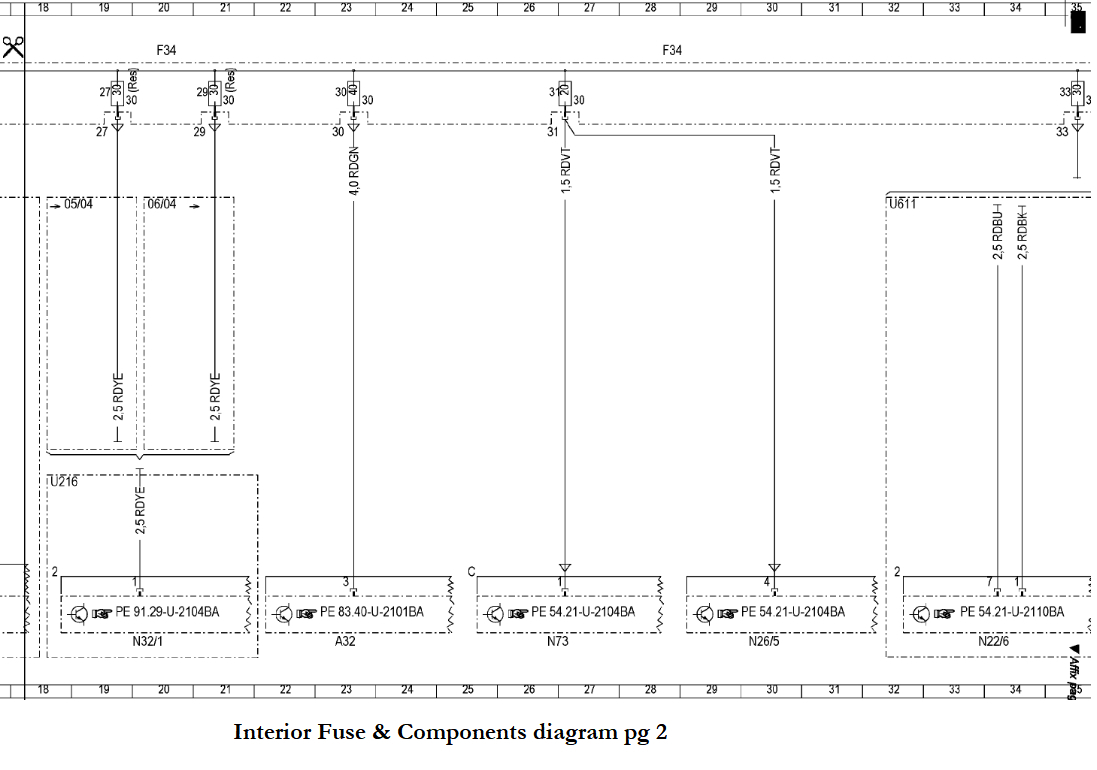

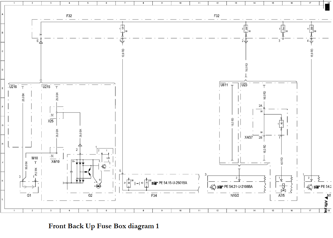

These are the OEM diagrams for the interior fuse, and it looks like modules as well which offers coordinates to each component on the diagram. They look like they're designed more for engineers than technicians. But in case you need them, I will check the others as well. I think there's one more set with fuses.
Saturday, December 16th, 2023 AT 11:03 AM

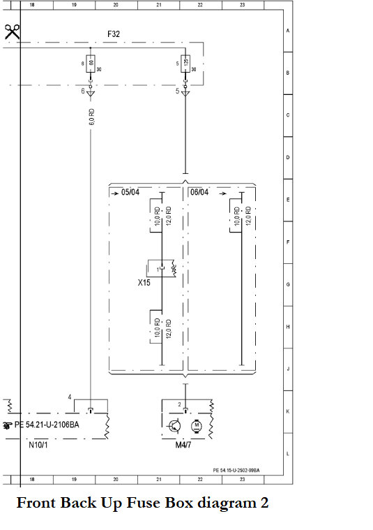

AL514
  • 4,793 POSTS

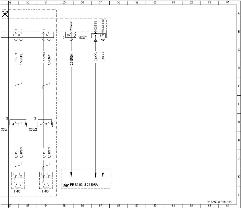

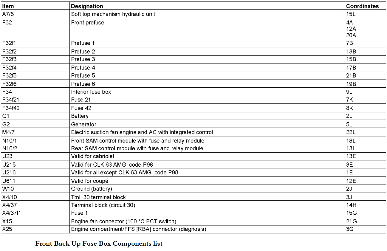

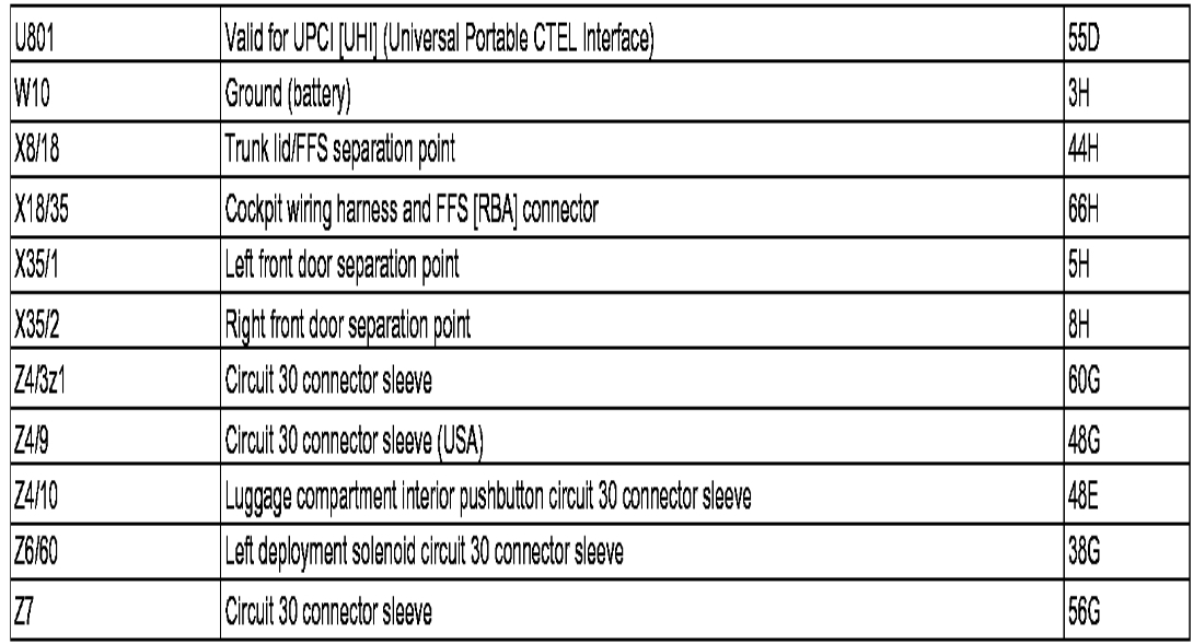

These are the oem Front Back Up Fuse Box components, there are lists of connectors as well, they all look like this, you mentioned hearing a noise in the dash as well, check for a CD changer in the glovebox. Theres supposed to be one in there, maybe that has a CD stuck in it thats staying active. That happens pretty easily.
Saturday, December 16th, 2023 AT 11:12 AM

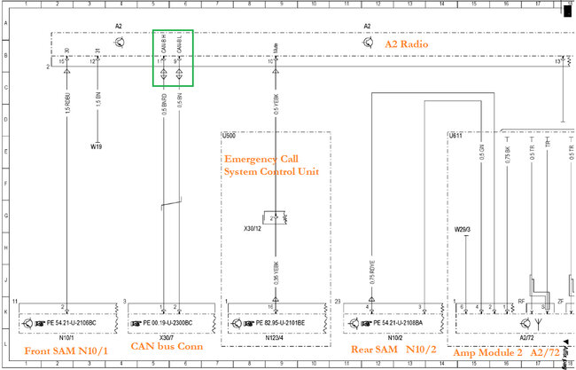

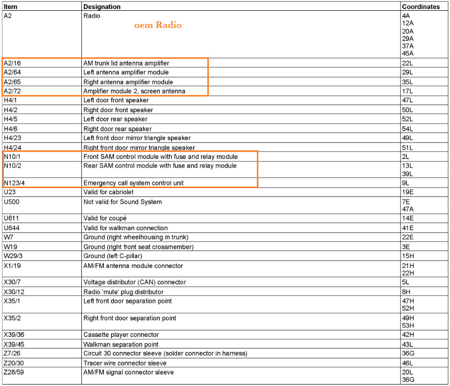

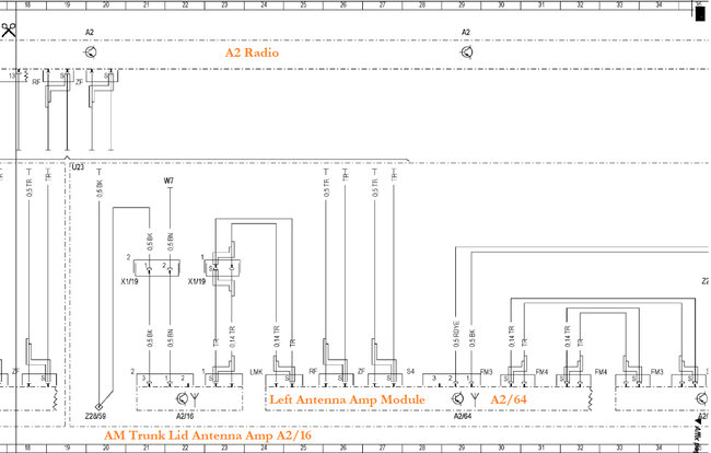

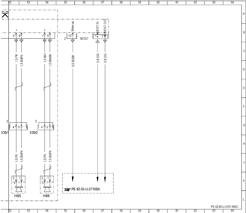

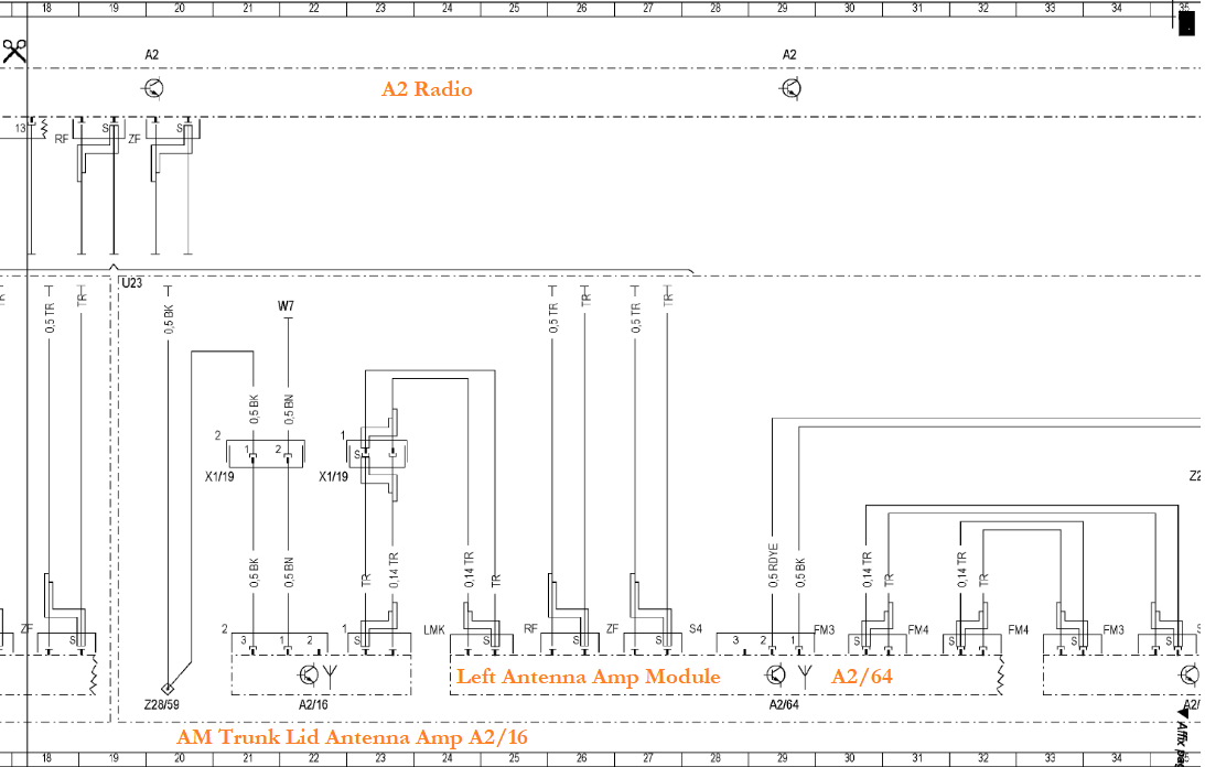

AL514
  • 4,793 POSTS

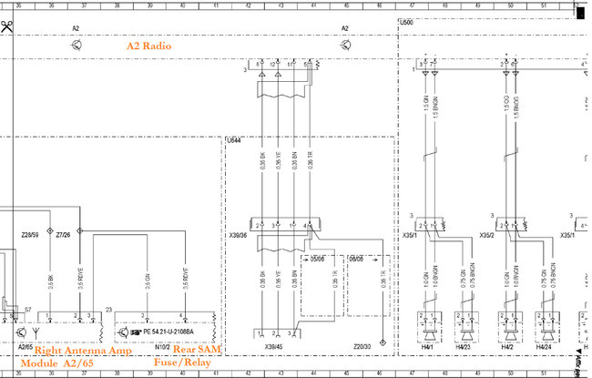

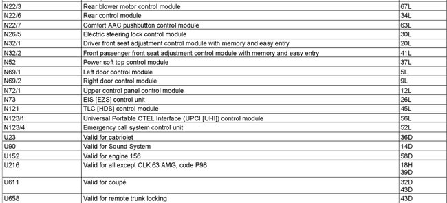

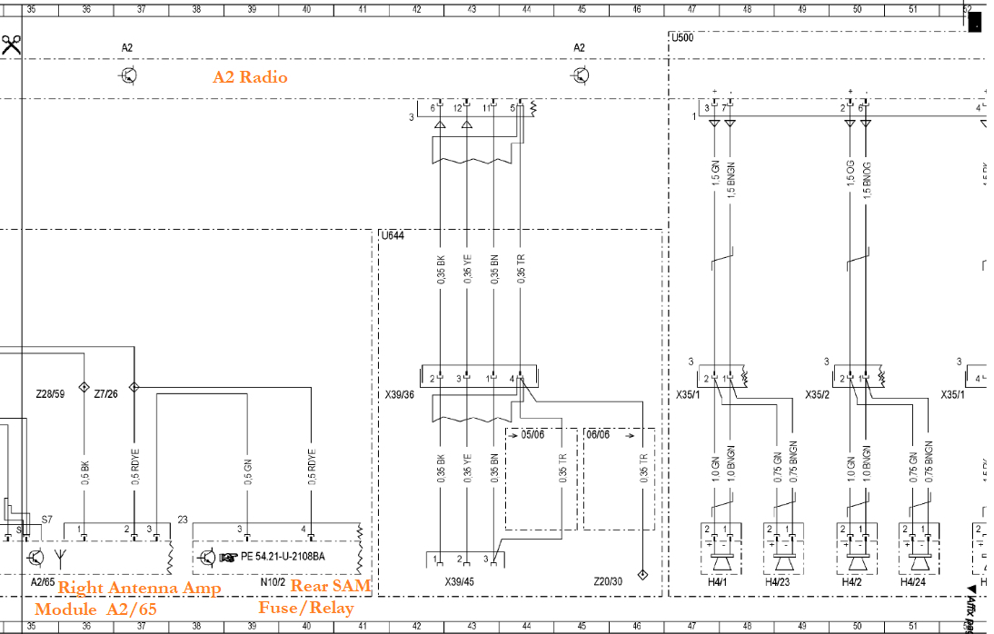

Try unplugging the cd changer, unless it's functioning okay. But it seems everyone I've ever had ended up with a cd stuck in it. But the Radio is on the CAN Bus and also has a right and left amplifier modules (so more computers to stay awake), an Amplifier module 2 Screen Antenna, an AM Trunk Lid Antenna amplifier, Emergency call system control unit, etc.
These are the OEM diagrams for the Radio, there are 7 modules that are linked to the Radio circuits.
Sunday, December 17th, 2023 AT 12:40 PM

Now the noise behind the dash pulls current while it's doing it for 10 seconds but once it stops the current drops from 0.8 to 0.4. Also, he pointed to a teleaid fuse which I removed and the current dropped to 0.14. The 2 fuses that dropped the current before were this teleaid and the cluster fuse. But I can't have the cluster one removed as the cluster goes dead. Left telaid off and will monitor how battery does in couple of hours.
