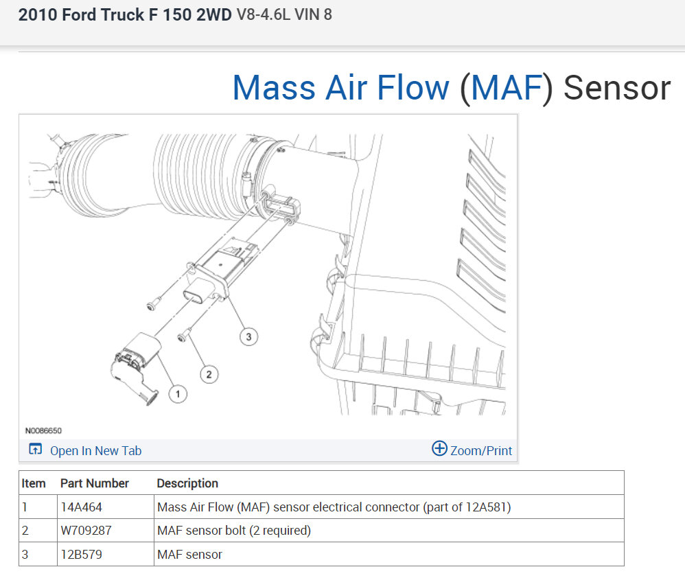

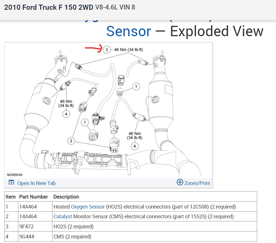

Codes P2197 and P2195?
2010 FORD F-150
10,000 MILES
PCAVINEE
  • 28 POSTS
These are the sensors my engine analyzer said I need to replace. I am assuming they are located underneath the truck on the converters. But I'm not sure. I think it is a 4.6. Thanks Ken
Mar 7, 2024 at 2:08 AM
  • 55,399 POSTS
So changes of both oxygen sensors being bad is remote.
P2197: O2 Sensor Signal Stuck Lean - Bank 2 Sensor 1
P2195: O2 Sensor Signal Stuck Lean - Bank 1 Sensor 1
These are stuck lean due to a vacuum leak or a bad MAF sensor.
Here is a guide to you understand what's going on:
https://www.2carpros.com/articles/repair-lean-mixture-codes-p0171-or-p0174-on-some-manufacturers
Here are the locations of the oxygen sensors and the MAR sensor, also please use this guide when the engine is cold only:
Check out the images (below). Please upload pictures or videos in your response to the problem so we can see what's going on.
