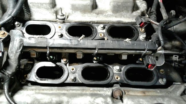

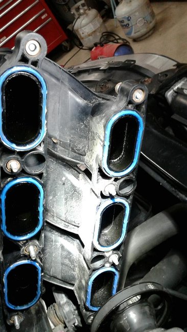

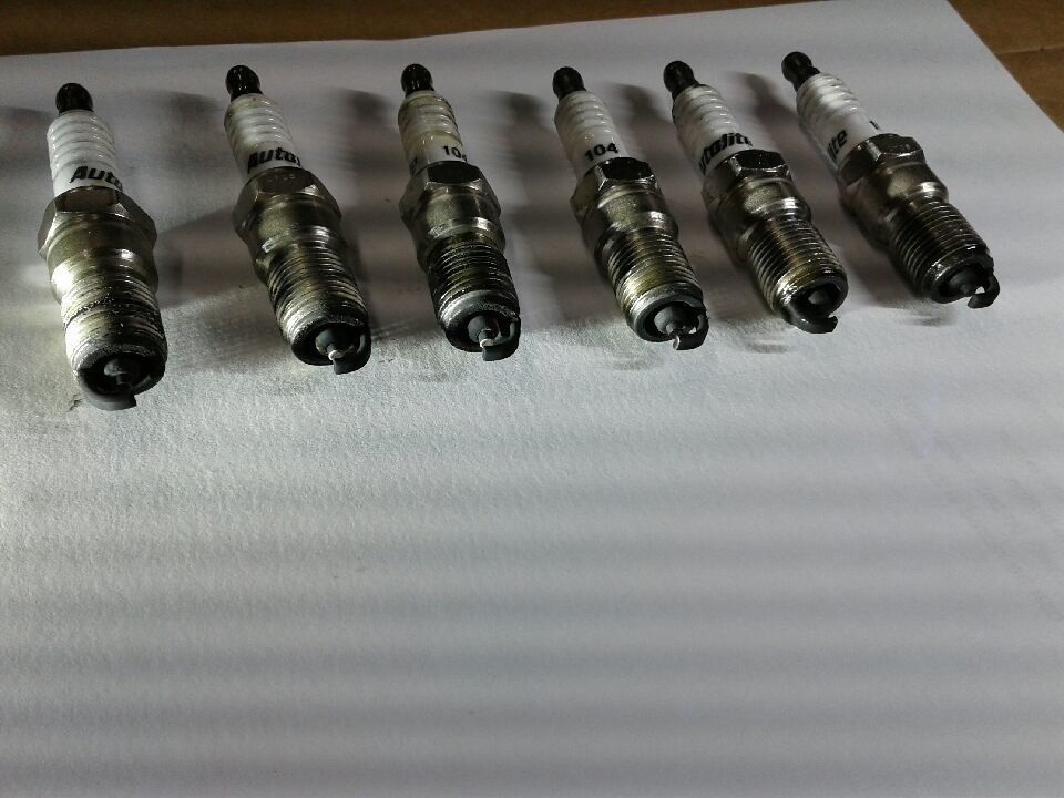

I removed intake to check injector wiring. I noticed a large amount of fuel on intake runners and intake plenum. So I decided to remove plugs, they appear to be carbon fouled. How is it possible to get fuel 'above' the injectors?

With all spark plugs black I would think the fuel pressure is low. Let's do a check and if okay I would replace the injectors. Here are two guides:
and
https://www.2carpros.com/articles/how-to-test-a-fuel-injector
Are those OEM plugs got the right heat range?

I changed injectors once already. They are oem plugs. Fuel pressure is 39psi.

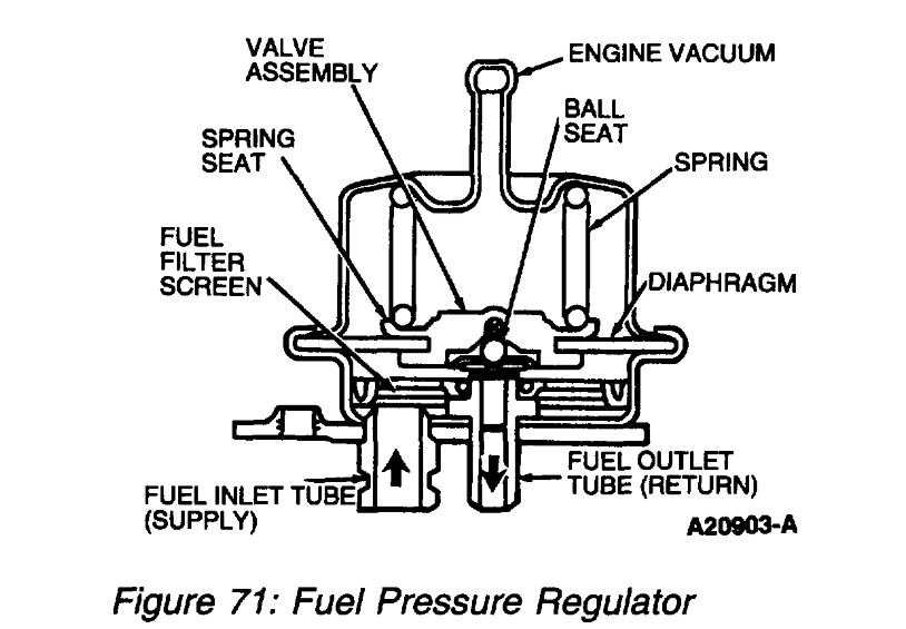

A leaking fuel pressure regulator will allow unmetered fuel into the intake manifold above the injectors. I would check this. The diaphragm ruptures internally and fuel goes into the vacuum line to the intake manifold.

Check that regulator for fuel coming out the vacuum port with the engine running.

Where is (fuel?) Regulator?
Tuesday, November 27th, 2018 AT 1:26 AM
  • 52,797 POSTS
I attached the procedure and location of the regulator. It is on the fuel rail.
Pardon me for asking but how did you know there was no fuel at the vacuum hose if you do not know where it is located?
The fuel pressure regulator is attached to the fuel rail downstream of the fuel injectors. It regulates the fuel pressure supplied to the fuel injectors. The regulator is a diaphragm-operated relief valve. One side of the diaphragm senses the fuel pressure and the other side is connected to the intake manifold vacuum. Fuel pressure is established by a spring preload applied to the diaphragm. Balancing one side of the diaphragm with manifold vacuum maintains a constant fuel pressure drop across the fuel injectors. Fuel pressure is high when engine vacuum is low. Excess fuel is bypassed through the fuel pressure regulator and returned through the fuel return line to the fuel tank.

Great question Roy, On this particular engine there is no return line. The fuel rail has one feed pipe, six injectors attached to it and the regulator. Regulator has vacuum line and four wire plug.

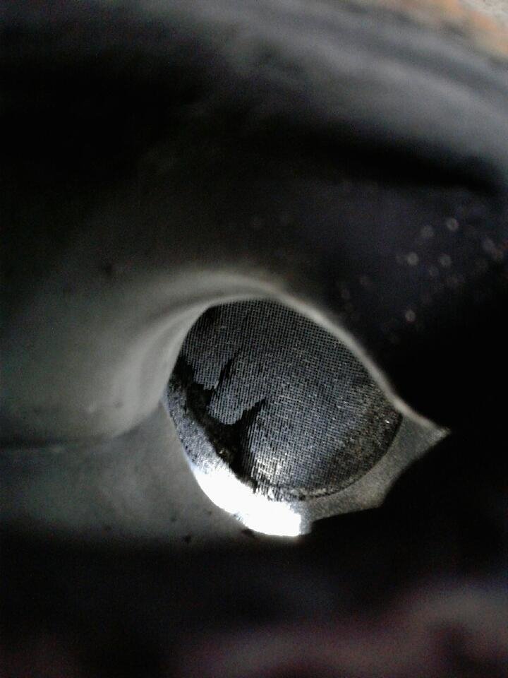

So My buddy was over and we were chatting about all your suggestions and he asked 'Did you inspect the pre catalytic converter?" Why no, no I did not. So we removed it. Picture attached.
Could this be rough idle, smooth between 1,200-3,500 rpm's? Rough and popping between 3,600-3,900 rpm's. Approximately 20% of pre catalytic converter is deteriorated.

No, the catalytic converter would have nothing to do with fuel in the intake.

This can cause a plug of the exhaust system which can cause mixture issues. I would check all of the catalytic converters to see if any others are falling apart and replace them. Here is a guide to help:
