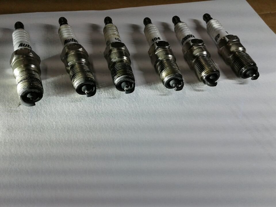

First MAF sensor did not fix issue. Surprise. I did do compression check. Results: #1-170, #2-165, #3-170, #4-180, #5-210, #6-205. Also, plugs #1-#3 are black and sooty. I suspect manifold/pre-catalytic converter restricted.
Shawn.
Nov 16, 2018 at 12:40 PM
  • 54,832 POSTS
Good find on the plugs, it sounds like you have two bad injectors on #1 and 3. Here are guides to help us confirm the issue:

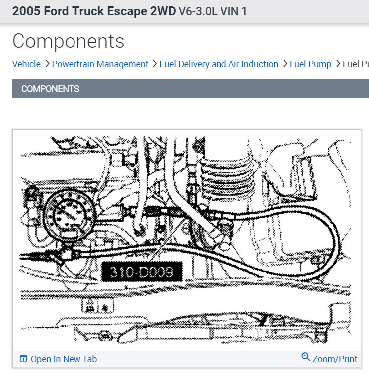

It sounds like it could be fuel pressure issue causing the injectors to not work right. Test the pump to confirm.
Fuel Pressure
Key on, engine off .................... 269 kPa (39 psi)
Engine running .................... 269 kPa (39 psi)
Fuel pump output volume per 10 seconds .................... 125 cc (4.32 oz.)
Nov 17, 2018 at 9:45 AM
CRJMECH00
  • 11 POSTS
I checked that before. Fuel pressure is 39PSI. Engine will not rev past about 4,000 rpm's. Was wondering fuel injector wiring is bad? I changed all injectors. Maybe one on bank 1 is not firing or poor ground?

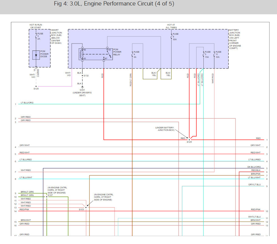

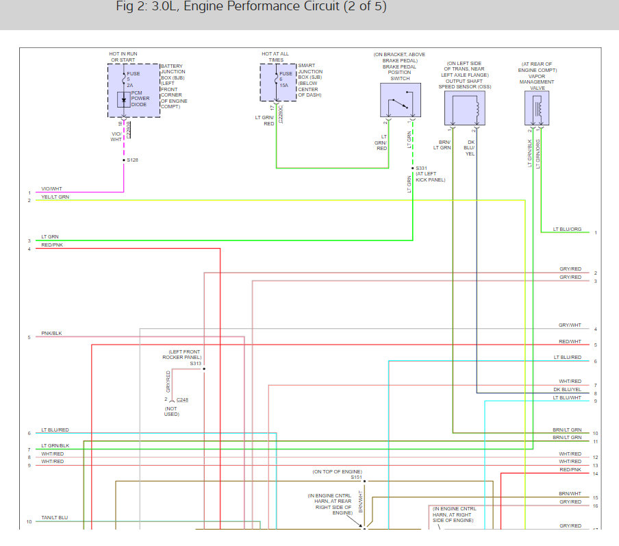

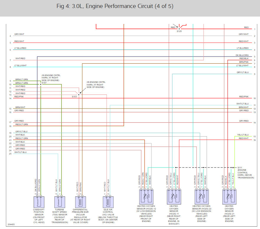

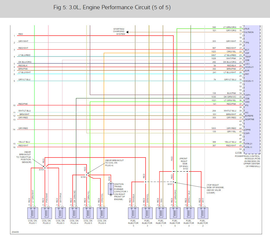

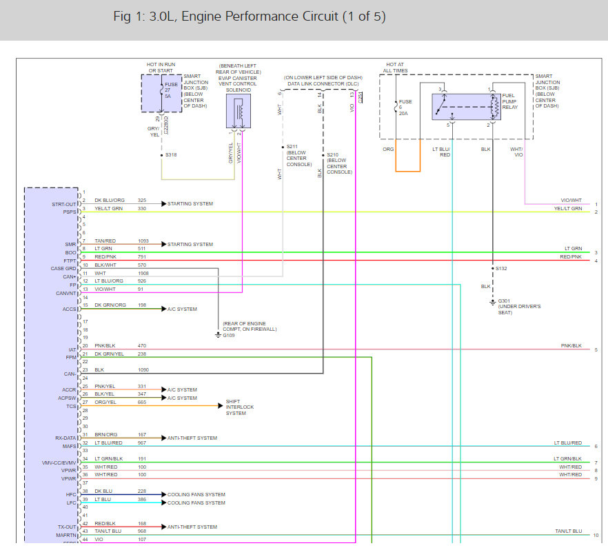

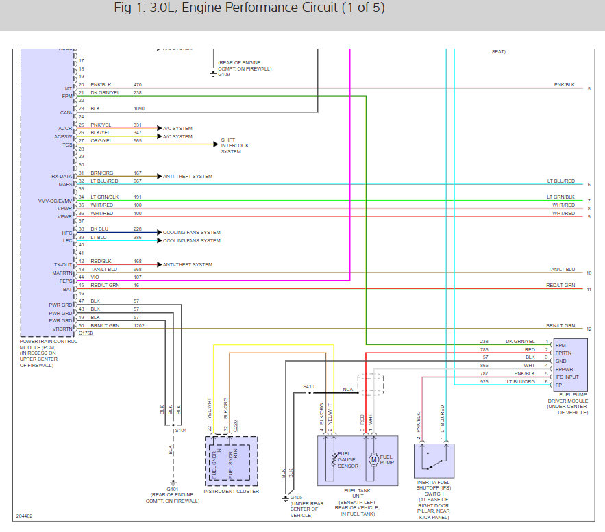

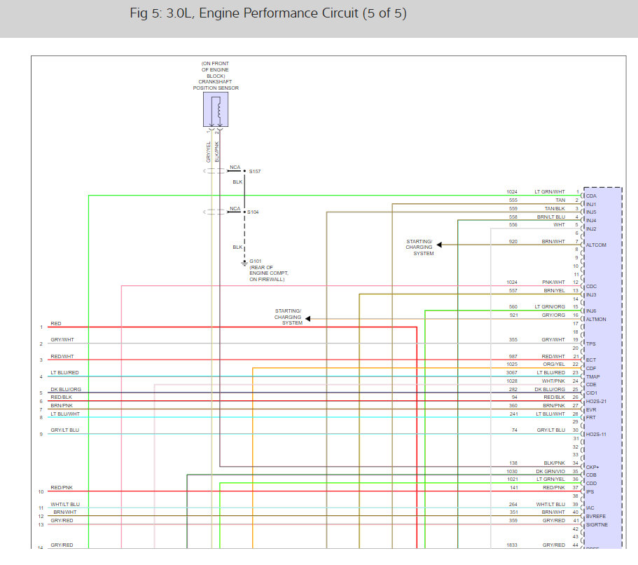

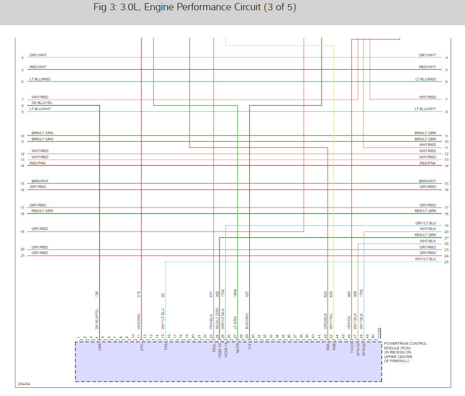

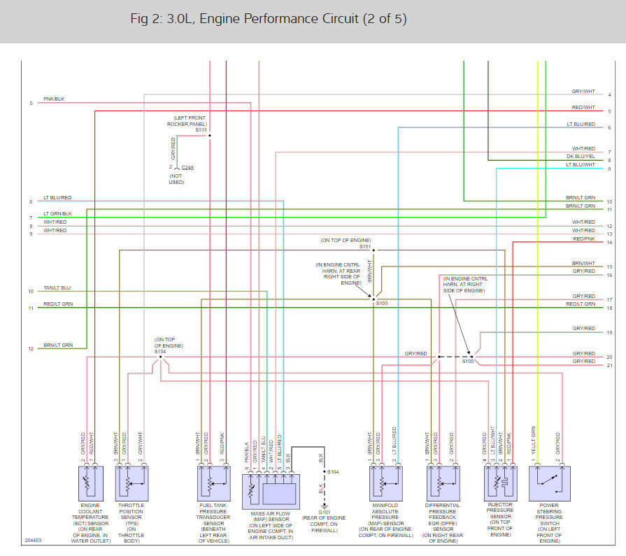

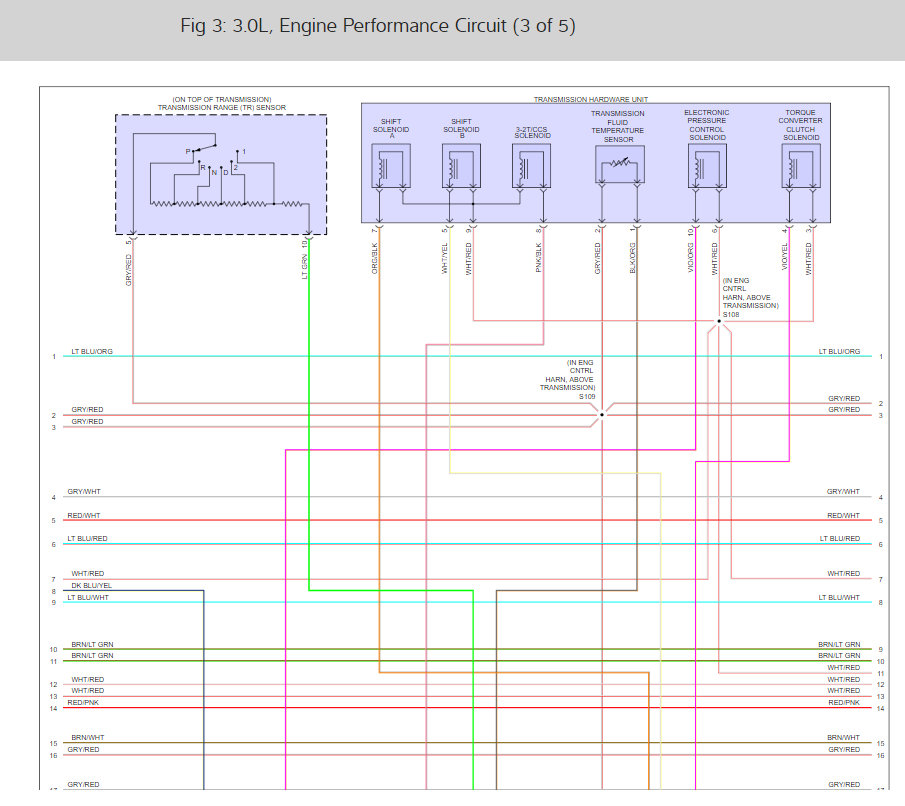

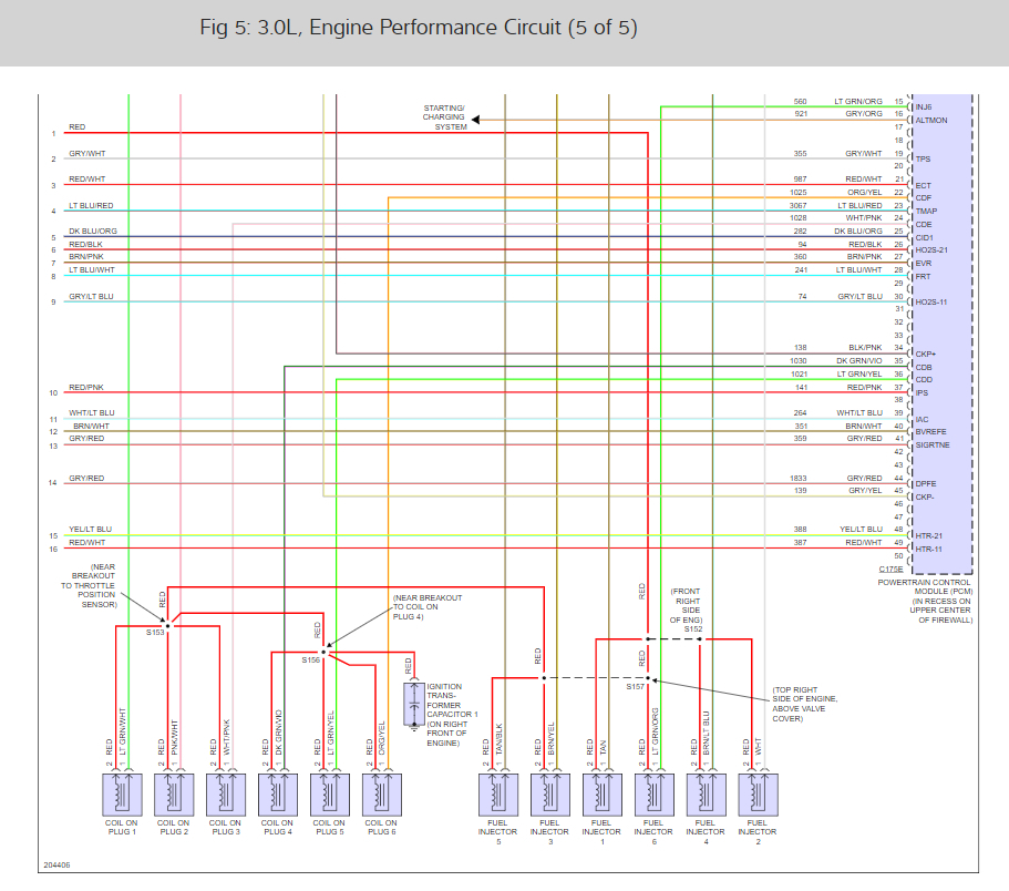

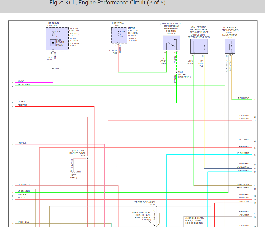

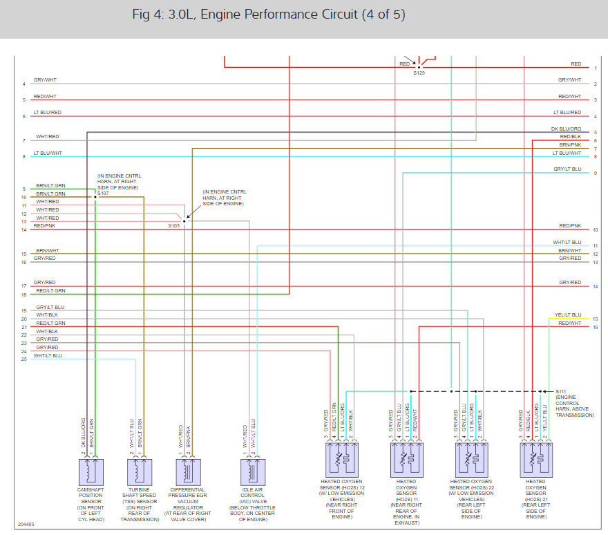

Ken, Do you have ECM pinout for 2005?
Shawn.
Nov 17, 2018 at 6:52 PM
  • 54,832 POSTS
Yes, here are the engine wiring diagrams and a guide to help to test the wiring:
Check out the diagrams (below). Please let us know what you find.
Nov 19, 2018 at 11:27 AM

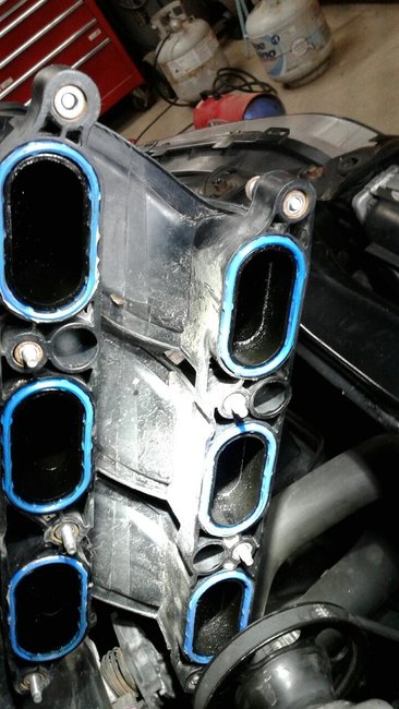

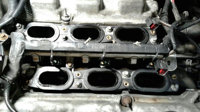

Hope everyone is having/had a great Thanksgiving.
I removed intake to check injector wiring. I noticed a large amount of fuel on intake runners and intake plenum. So I decided to remove plugs, they appear to be carbon fouled. How is it possible to get fuel 'above' the injectors?
Nov 22, 2018 at 2:54 PM
  • 54,832 POSTS
With all spark plugs black I would think the fuel pressure is low. Let's do a check and if okay I would replace the injectors. Here are two guides:

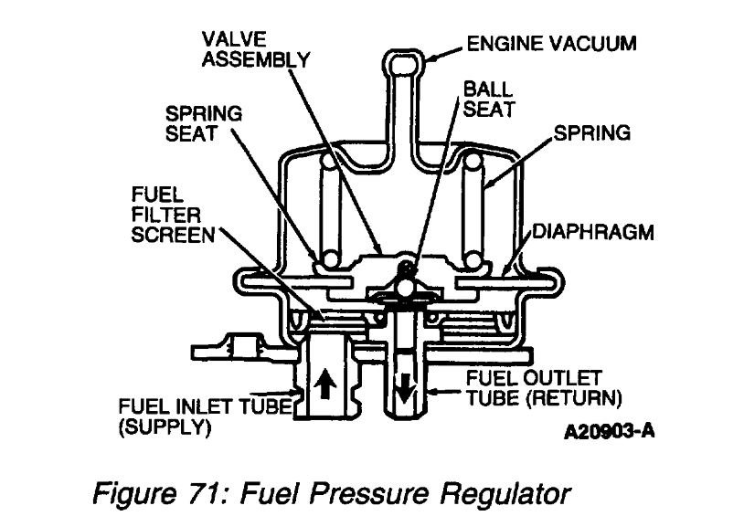

A leaking fuel pressure regulator will allow unmetered fuel into the intake manifold above the injectors. I would check this. the diaphragm ruptures internally and fuel goes into the vacuum line to the intake manifold.

Ken has a very valid point but before I would assume it may be a PCM, I think you need to verify where the fuel is coming from in the plenum.
The regulator sticks in my mind as it is the only avenue for the fuel to get in there from the outside.
Nov 26, 2018 at 1:14 PM
CRJMECH00
  • 11 POSTS
Where is (fuel?) regulator?
Nov 27, 2018 at 1:26 AM
I attached the procedure and location of the regulator. It is on the fuel rail.
Pardon me for asking but how did you know there was no fuel at the vacuum hose if you do not know where it is located?
The fuel pressure regulator is attached to the fuel rail downstream of the fuel injectors. It regulates the fuel pressure supplied to the fuel injectors. The regulator is a diaphragm-operated relief valve. One side of the diaphragm senses the fuel pressure and the other side is connected to the intake manifold vacuum. Fuel pressure is established by a spring preload applied to the diaphragm. Balancing one side of the diaphragm with manifold vacuum maintains a constant fuel pressure drop across the fuel injectors. Fuel pressure is high when engine vacuum is low. Excess fuel is bypassed through the fuel pressure regulator and returned through the fuel return line to the fuel tank.

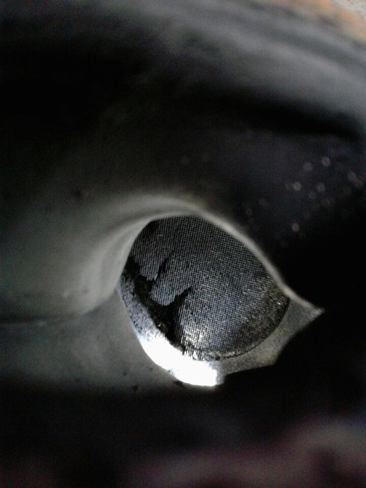

So My buddy was over and we were chatting about all your suggestions and he asked 'Did you inspect the pre catalytic converter?" Why no, no I did not. So we removed it. Picture attached.
Could this be rough idle, smooth between 1,200-3,500 rpm's? Rough and popping between 3,600-3,900 rpm's. Approximately 20% of pre catalytic converter is deteriorated.
Nov 27, 2018 at 5:42 PM
No, the catalytic converter would have nothing to do with fuel in the intake.
Nov 28, 2018 at 4:52 AM
  • 54,832 POSTS
This can cause a plug of the exhaust system which can cause mixture issues. I would check all of the catalytic converters to see if any others are falling apart and replace them. Here is a guide to help:
