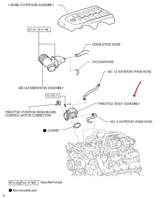

Backstory: Had a drained battery yesterday on the vehicle, when I tried to jump it, it was backwards, this caused what I can only describe as a "surge" (horn went off, lights, etc.), went and got new battery, put in, vehicle would start but no dash, would not shift out of park, no acceleration, etc., had truck towed to shop. The shop says the "main fuse" was blown and took a day to fix, ~$700. On the receipt is says "Fusible Link is Damaged." Part is Fusible Link. I pick up the truck today and it starts, runs, etc., but it feels kind of sluggish and the CD player/deck isn't working. Also, the a/c takes a minute to kick on and it didn't do that before. It is also throwing code P2118, which when I look that up says its Throttle Actuator Control Motor Current Range/Performance. I ask the shop about this, and they say it will go away with time, etc., and that the vehicle is drivable, etc. I'm on a ~900 road trip right now so I had to take it to a small shop, not my regular place. I don't know if they screwed me or what, I'm really not that worried about the money part I just want to know if I can get the truck home. If I can get it back I can get it to my guy. Is it ok to drive that far?

How long have you driven it since the repair? Yep, the battery does not like to get jumped backwards, this can lead to many problems like the truck going into limp mode because of the code.
A P2118 code on a 2018 Toyota Tundra refers to an issue with the Throttle Actuator Control (TAC) Motor Current Range/Performance
This guide can help as well:
https://www.2carpros.com/articles/resolving-reverse-battery-connection-in-cars-a-step-by-step-repair-guide

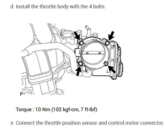

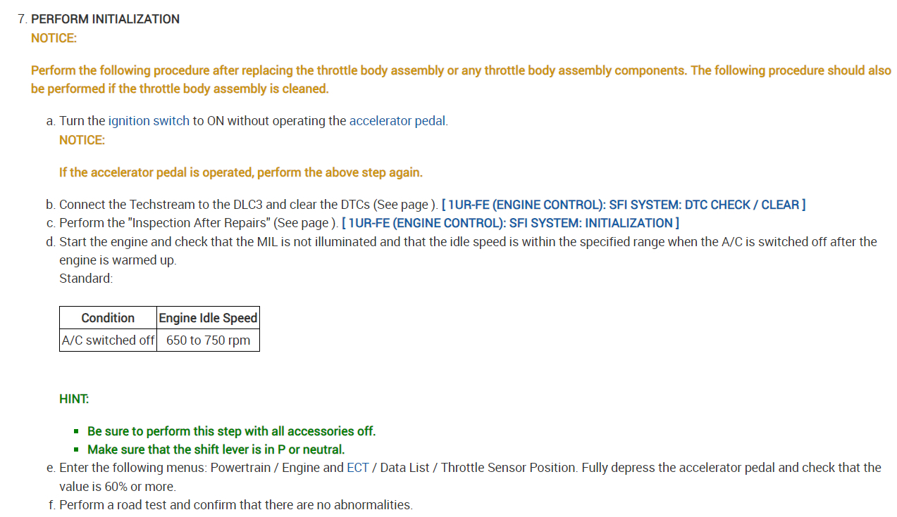

I would replace the throttle body which can get burnt up during the event. Here is how the job is done make sure to clear the codes once the repair is complete. Check out the images (below). Please let us know what happens.

It might be okay but if the PCM decides the throttle body is a safety issue it will put the truck in limp mode, when this happens you need to clear the codes for the truck to keep going but it can just happen again. I don't like to say you will be safe when there might be a problem.
