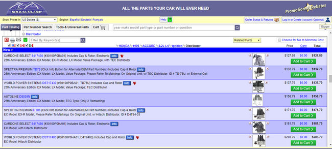

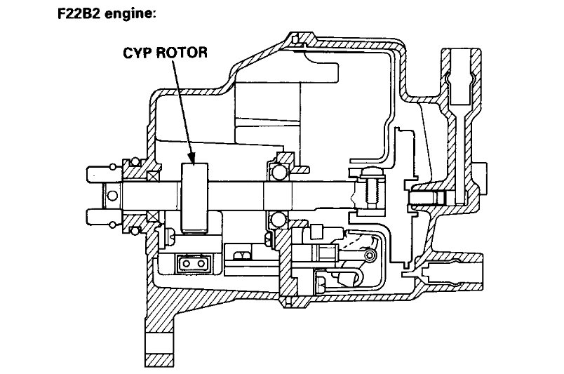

With this code, I always replaced the distributor with a remanufactured one that contains all the sensors. I have never had any luck replacing just the sensors due to the shaft being worn in the distributor itself.

The scan tool indicates Diagnostic Trouble Code (DTC) P1381: Intermittent interruption in the Cylinder Position (CYP) sensor circuit.
DESCRIPTION
The CYP Sensor detects the position of No. 1 cylinder for sequential fuel injection to each cylinder.

Thanks Roy, I am going to check it out today. When you say re-manufactured do you mean at the Honda dealership instead of AutoZone Carquest and other places? Hopefully this works out and I hope it is not the shaft itself under the valve cover that would be bad. :( Again thanks more replies would be more helpful. :)
Sep 1, 2018 at 2:44 AM
The shaft is part of the distributor.
AutoZone, Advanced, Pepboys and O'Reilly's all carry the unit.

Cap?
I suggested the entire distributor not just the cap.

Oh, because I purchased the distributor rotor like a month ago and I lost the receipt. :( So should I just might as well get the entire distributor or the cap only? Sorry that is why I wanted to figure this out because my money is going and going. :(
Sep 1, 2018 at 3:17 AM
The entire distributor as I suggested. It does not come with the cap.

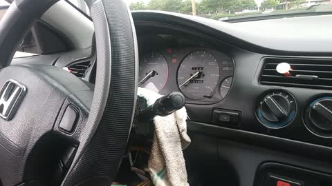

So it starts when I crank it like the second time or third time and like the rpm arrow is good at first, but then when gets down to 0 or close to 0. Sounds like car is rigidly or like a shake for like three or four seconds and then runs fine. But, when I press the gas pedal lightly to see if it sounds like its about to turn off with that shake rigidly feeling and it does but when pressing all the way its fine. Just as I show on my video but when I start it again another time the car jerks. It is so annoying on every gear I shift like it is about to shut off while I am driving after every shift. I have new battery and distributor and code still shows the same of p1381. It is nerve wracking, lol. I really need help. :(

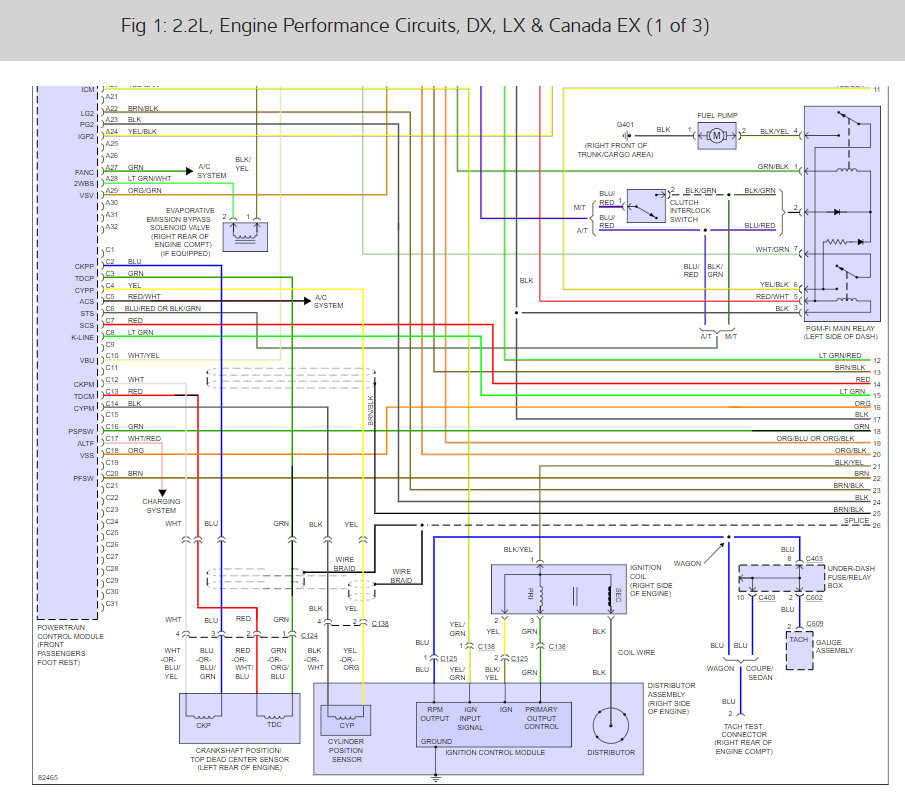

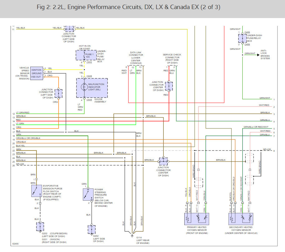

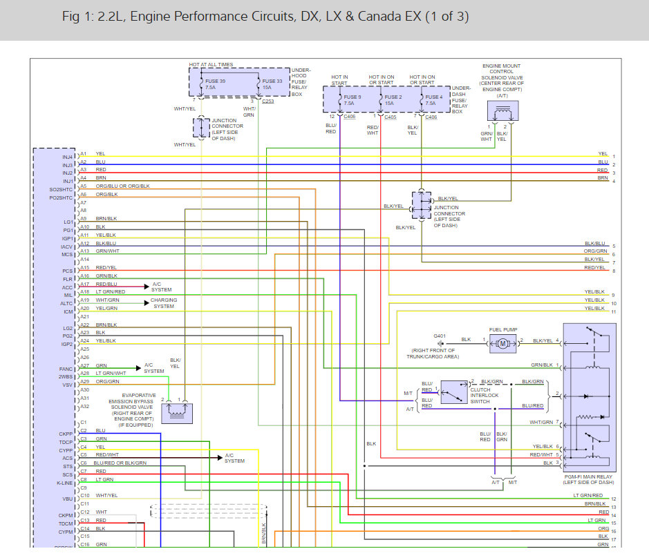

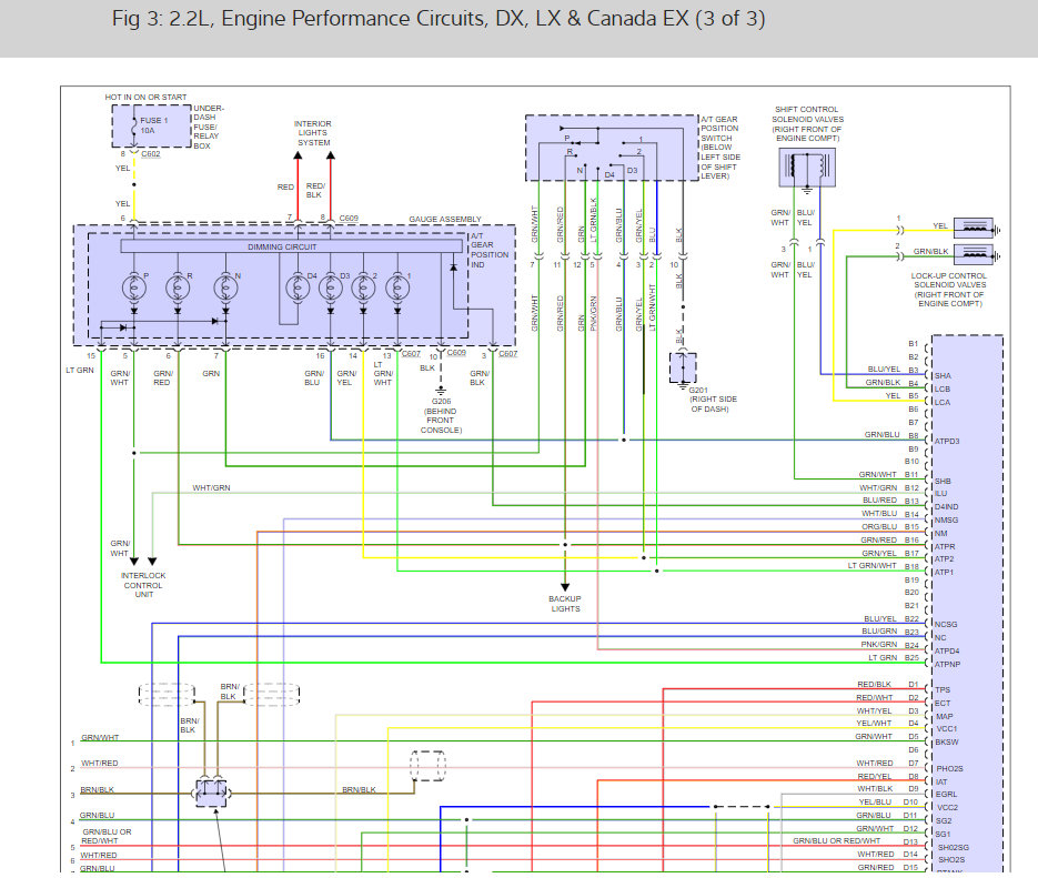

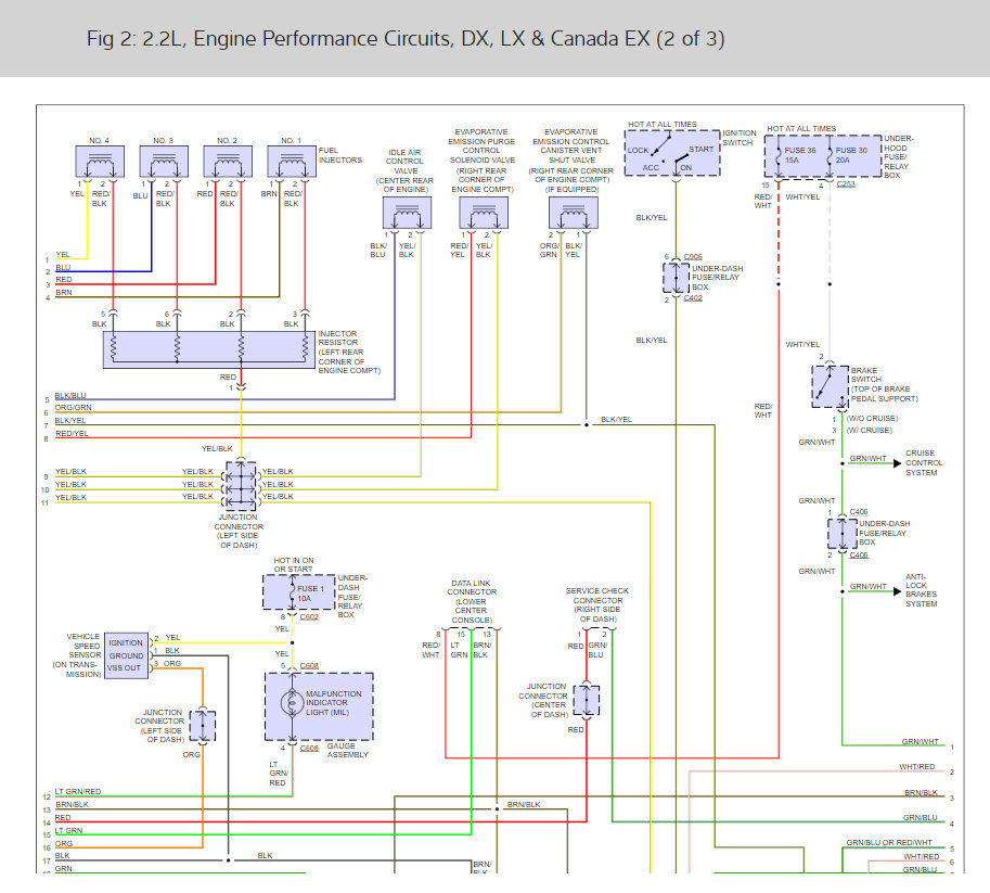

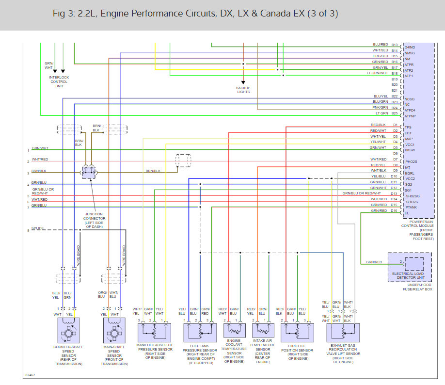

Before we say the PCM is bad lets check the wiring from the distributor to the PCM. Here is a guide to help us get started and the engine wiring diagrams so you can see how the system works. It sounds like you have one wire that is broken.
Sep 16, 2018 at 8:42 AM
  • 55,381 POSTS
MIGUEL, we need to make sure the wiring is good. Please run the test above.

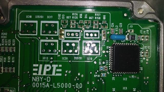

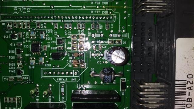

So, I am confused. I looked in under the ashtray that ob2 plug for the scan tool and follow the wires to the ECM/PCM also the wires from the distributor to the ECM/PCM they look fine. I did not want to take the plastic black stuff off because the wires look too good to me. But I want to be sure I am not holding the TCM because I could not find another computer on the other side or in the middle of the radio but on the passenger side under the feet cover. It was only one computer with three connections and I want to make sure if that is the ECM/PCM not the TCM on my car. But, yea I see that there is small corrosion. I am going to post a video and pictures of the computer. It is a 1996 computer it shows the date.
Sep 18, 2018 at 8:51 AM
MIGUEL VARGAS2
  • 31 POSTS
Here are the pictures:
Sep 18, 2018 at 12:23 PM
MIGUEL VARGAS2
  • 31 POSTS
I will upload the video tomorrow. But I have seen the ECM and as you can see the joints are corroded for such an old computer. I do not know if you can see that but the joints are like yellow and at first I thought it was normal copper joints, but it was not it was brown yellowish corrosion around all joints and its small brownish spots on corners of the plate chip itself on the back side. The picture shows the front.
Sep 18, 2018 at 12:46 PM
  • 55,381 POSTS
Yep, that does not look good. Can you smell a burnt electrical odor? If so I would get a used PCM and plug it in to see what happens. These computer sit low in the car and are subject to moisture.

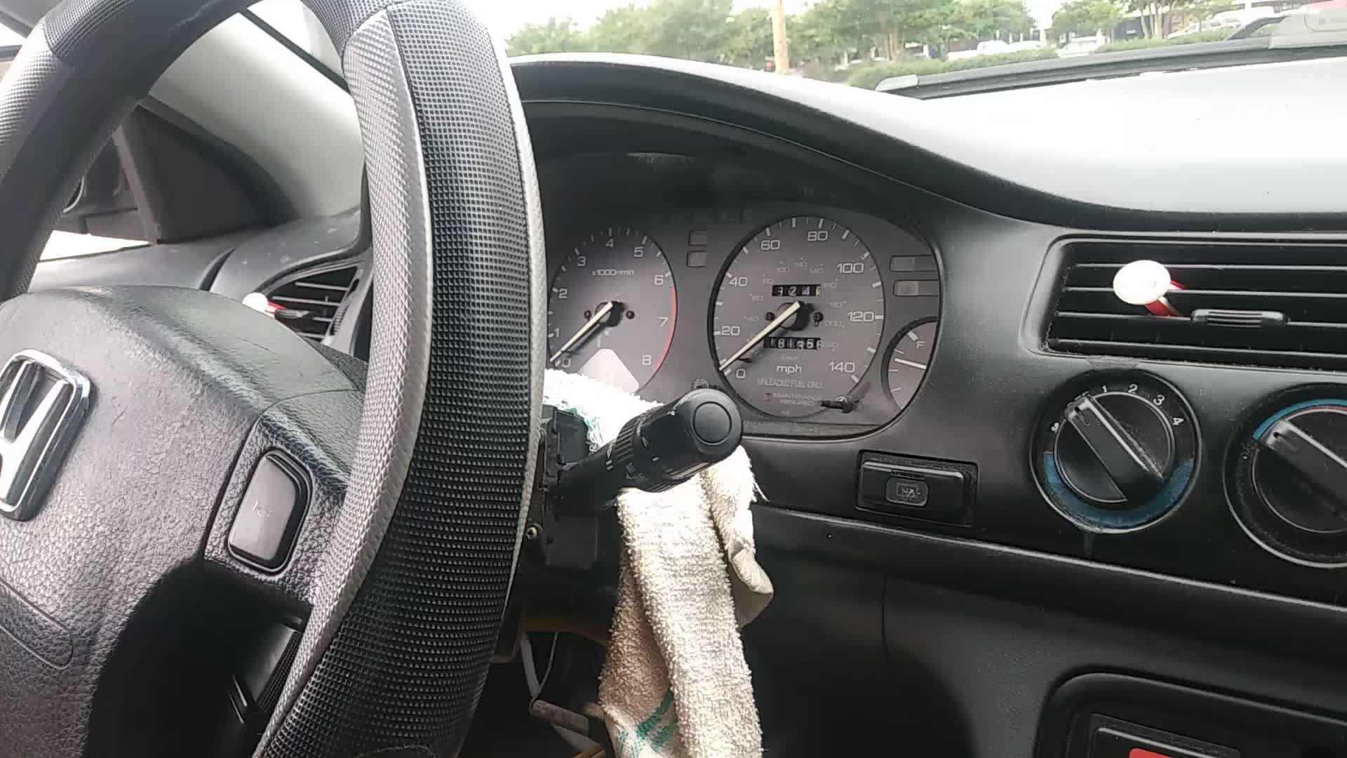

MIGUEL VARGAS2
  • 31 POSTS
Hello I am back and still have problems. :/ So I have changed the valve cover gasket with the kit and new spark plugs got a computer from the junkyard and tested two of them from the old and from the junkyard and same problems. Cranks but it does not start. I bought a new distributor with OEM parts online at RockAuto and my model is a DX engine is f22b2 just throwing it out there. Because I found out that is my model of my car, but still it sounds like the distributor or the connectors or like you said the wire with the connectors of the distributor that a wire might be broken. :/ How do I test that when I find the wire?
Oct 4, 2018 at 12:18 PM
  • 55,381 POSTS
Thanks for the video it sounds like you have love compression in one or more cylinders. Does the engine have spark? If so will it run on starting fluid?
Oct 6, 2018 at 8:06 AM
MIGUEL VARGAS2
  • 31 POSTS
*drum roll* :)) It was the coil the ignition coil connects to thee spark plug wires and a new computer which I got from the junkyard. But my gauge on my MPH sometime acts and get stuck on 20 MPH when I am going over then that when I am driving the the RPM gauge is no problem.
