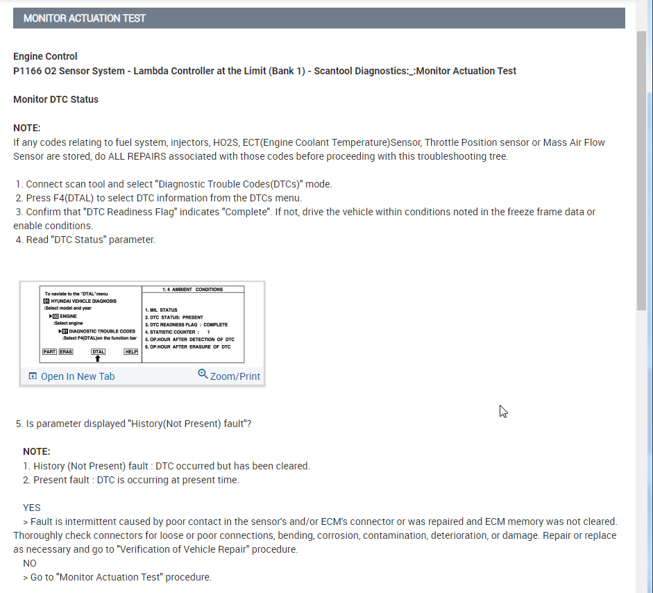

Code P1166 and misfire on cylinders five and six
2001 HYUNDAI SANTA FE
317,000 MILES • 2.7L • V6 • 2WD • AUTOMATIC
CA7922303
  • 165 POSTS
Getting these codes, rough idle, snap on engine analyzer shows all four(4) with no readings, but getting voltage.
Mar 13, 2021 at 7:35 AM

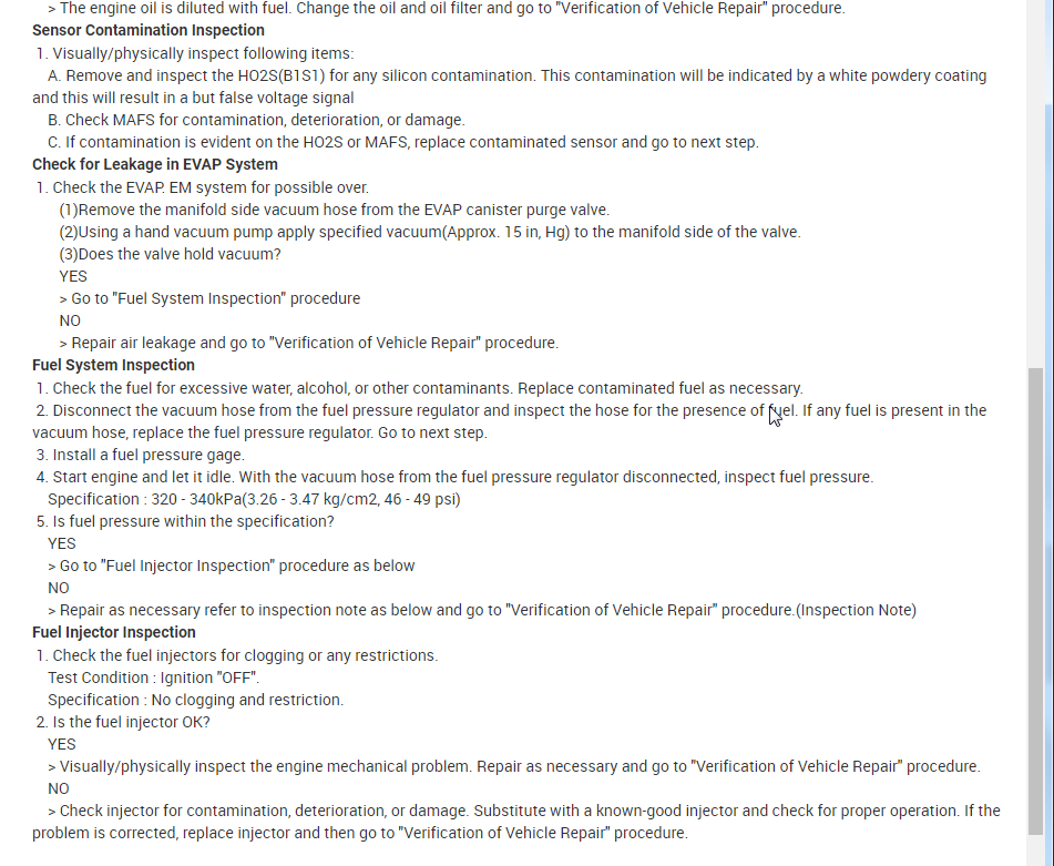

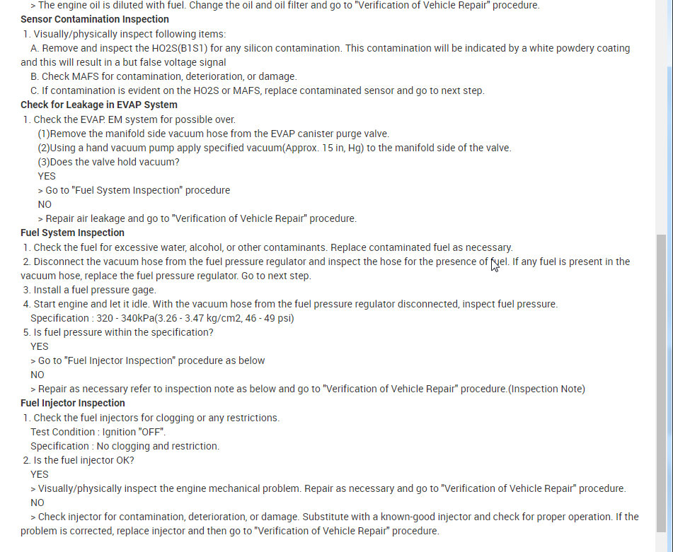

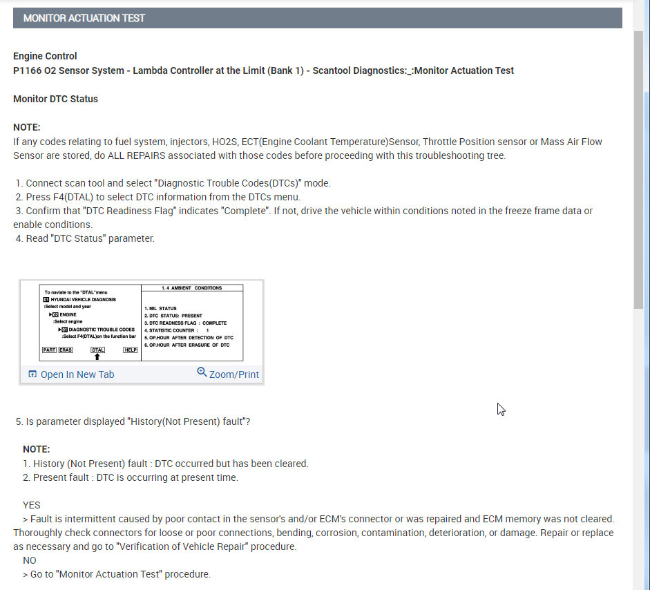

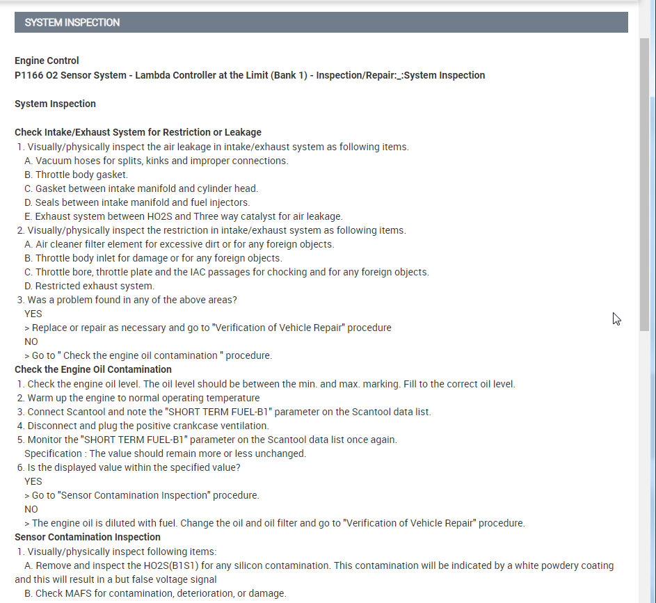

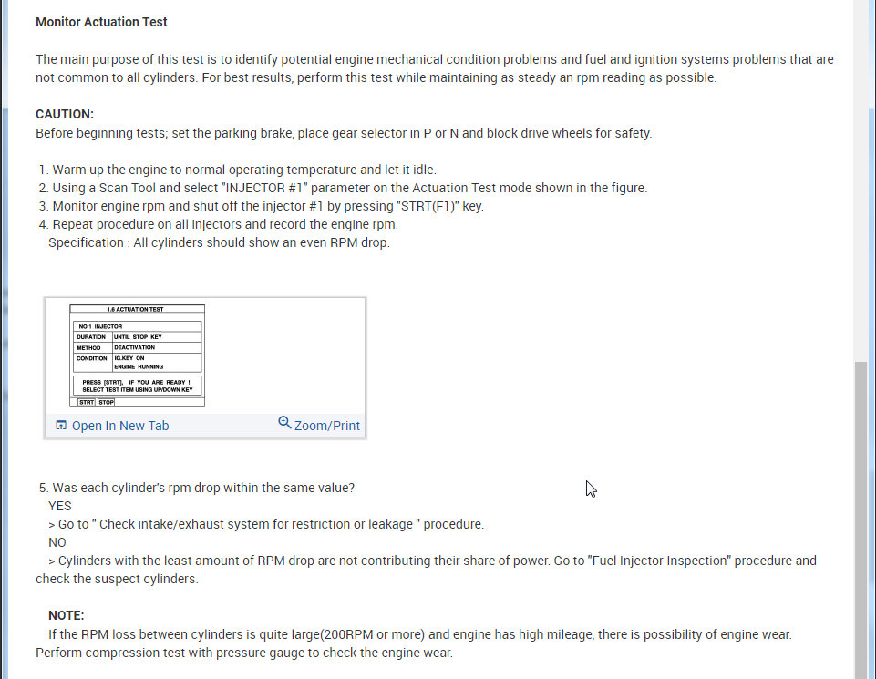

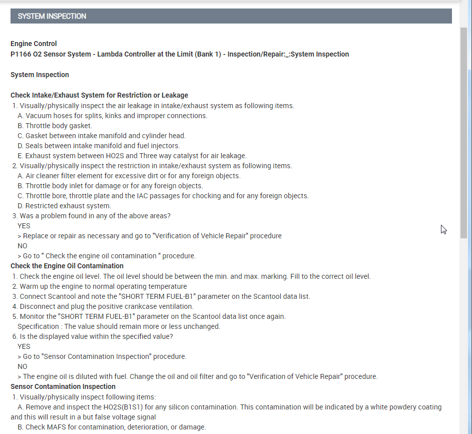

I attached the test that we need to run through for this code but given you have misfires on two cylinders, I would bet we have injector issues.
I attached the testing below so let's at least run through the system inspection items and go from there but again, I am thinking injector issues so you may want to swap those injectors with the cylinders that are not missing and see if the misfires move.
Let me know what questions you have on this. Thanks
