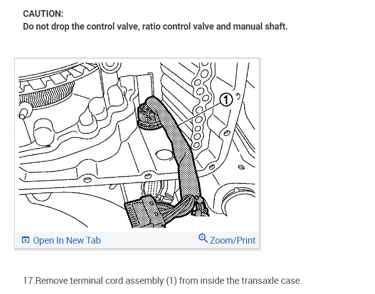

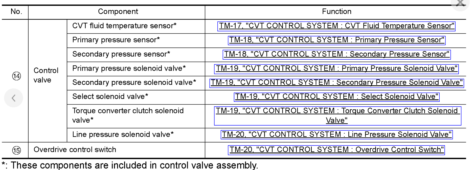

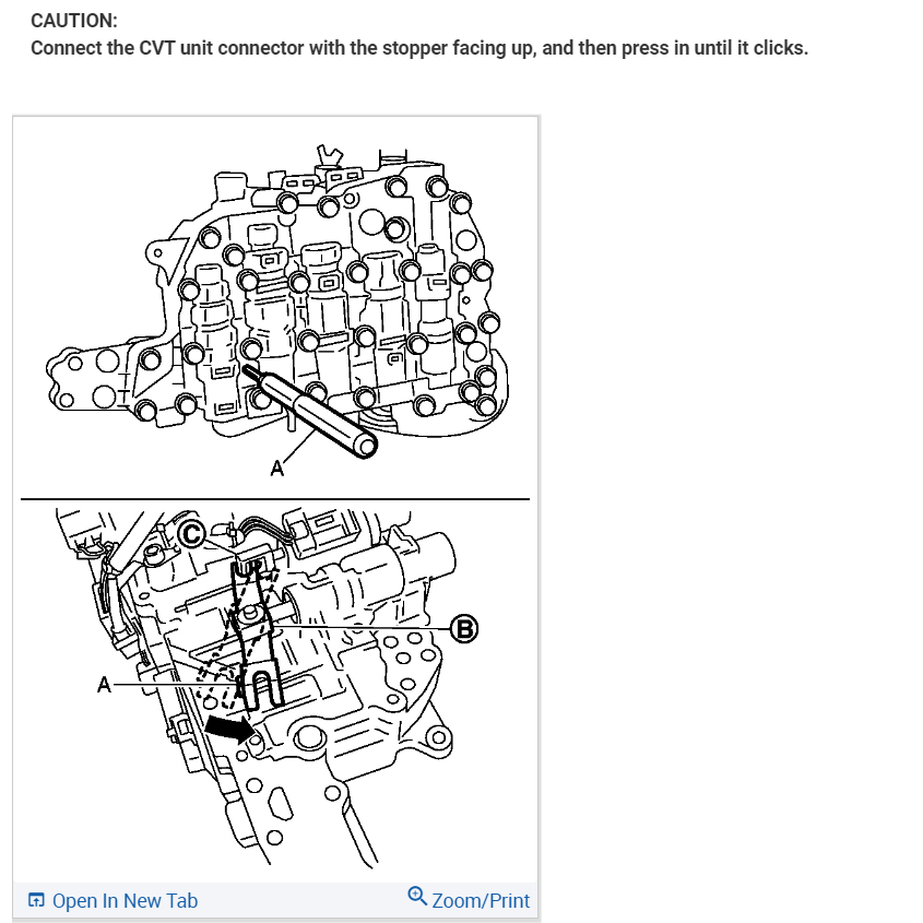

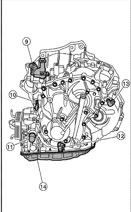

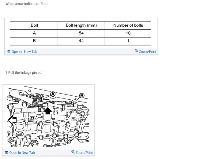

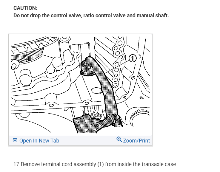

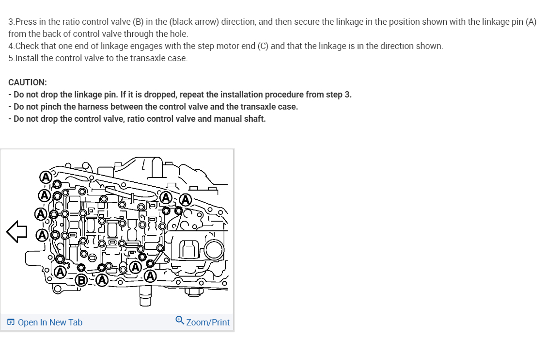

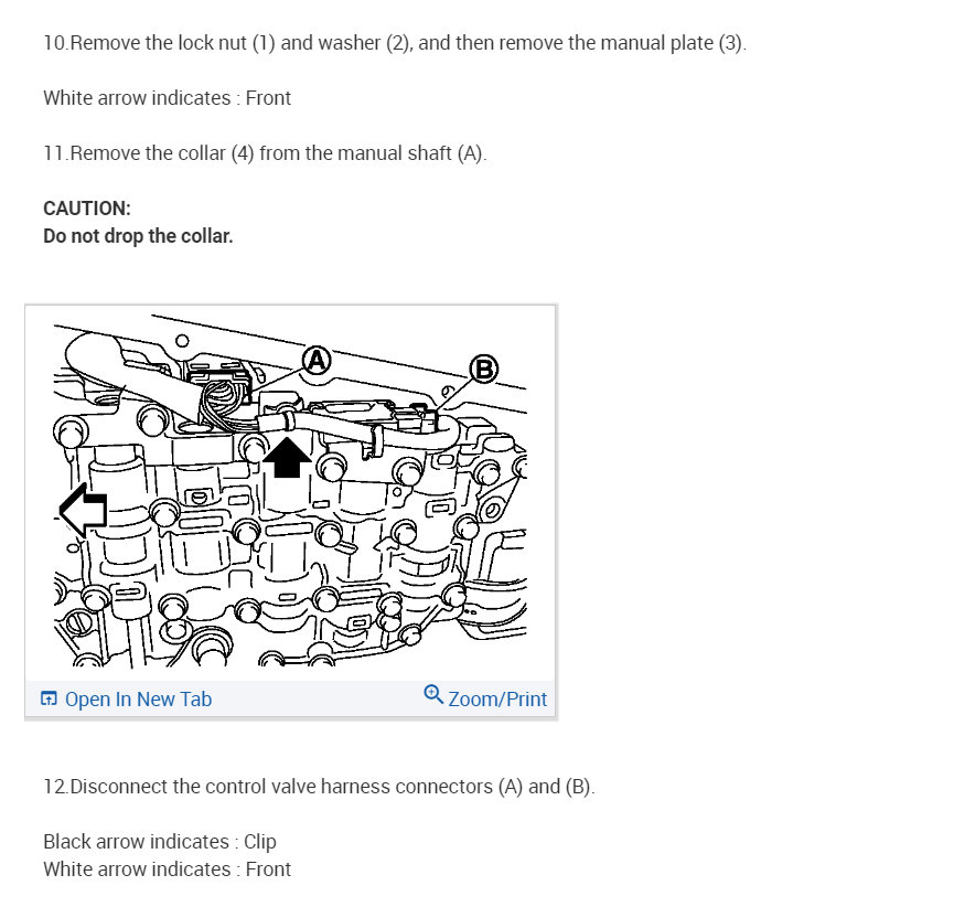

Code P0776, pressure control solenoid B performance or stuck closed?
129,567 MILES • 2.4L • 4 CYL • 2WD • AUTOMATIC
DSANDOVAL80

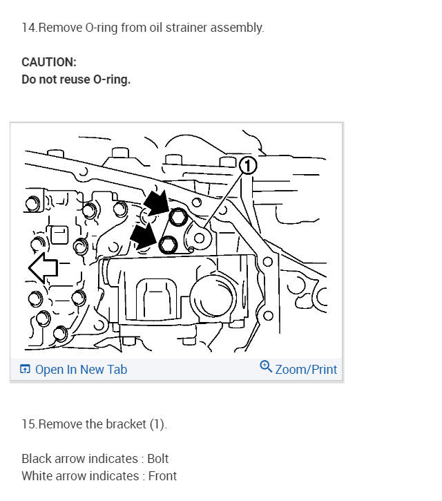

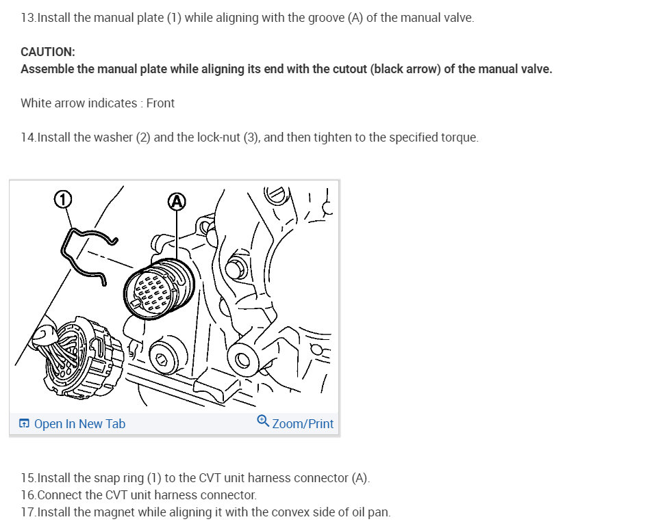

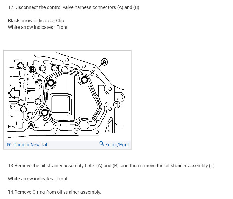

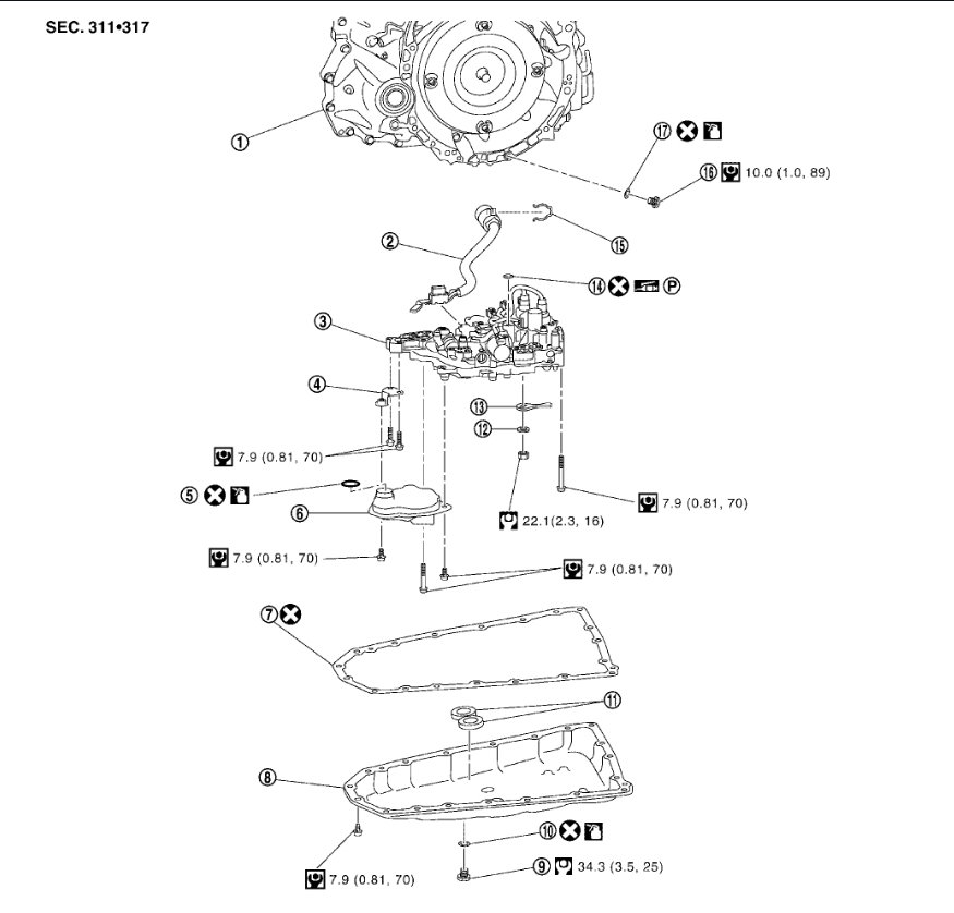

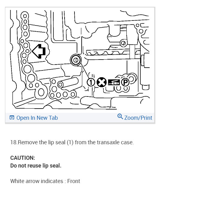

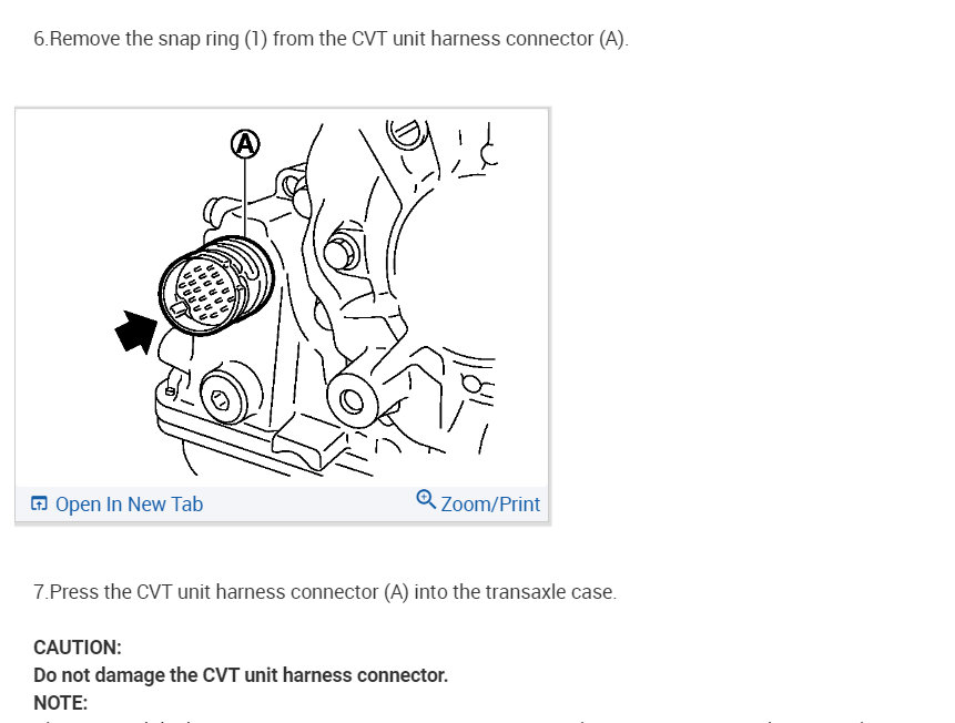

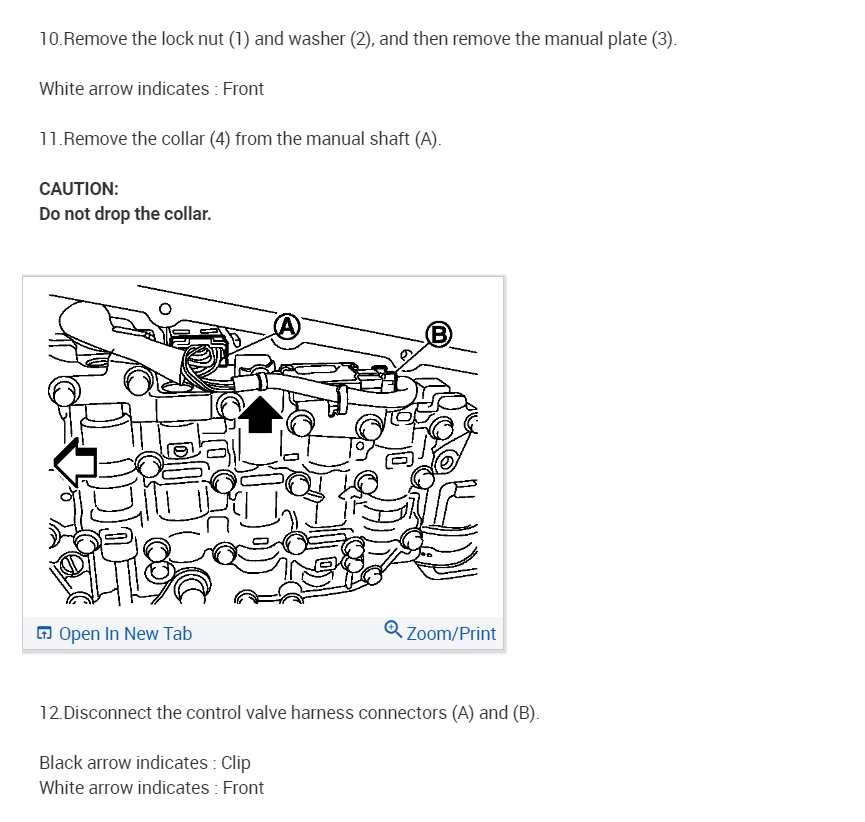

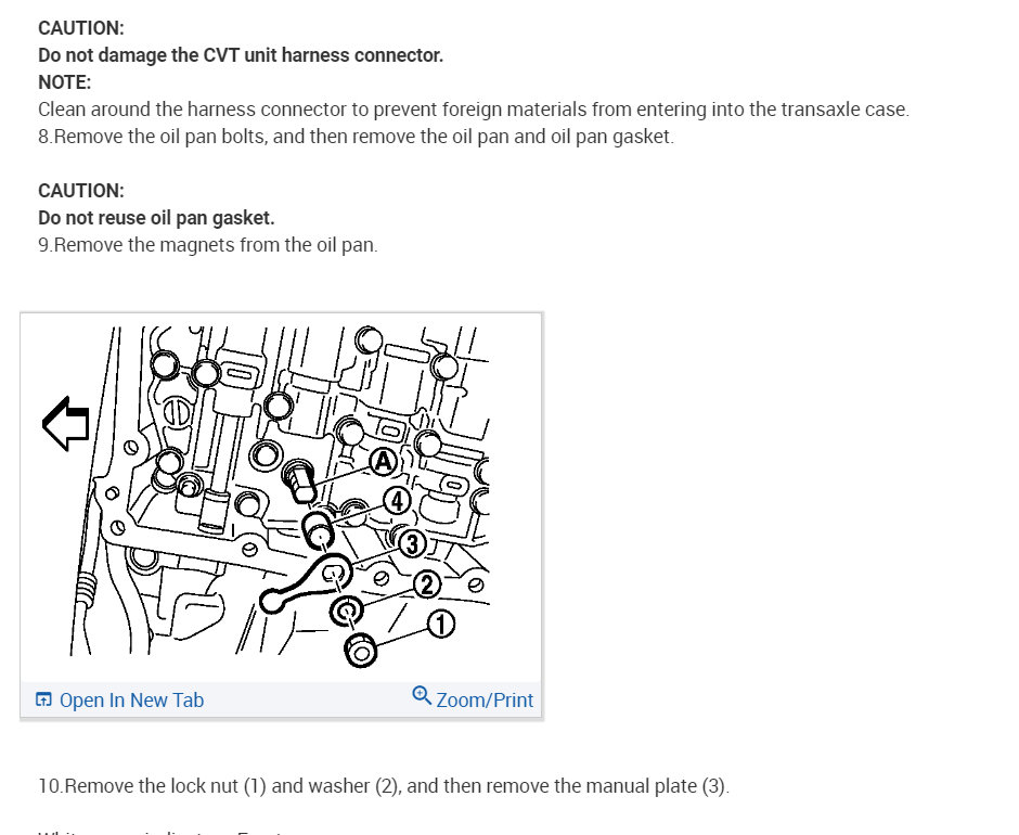

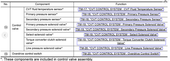

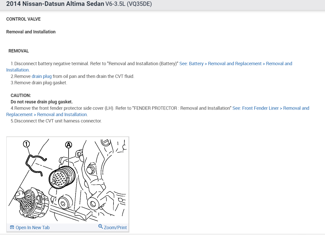

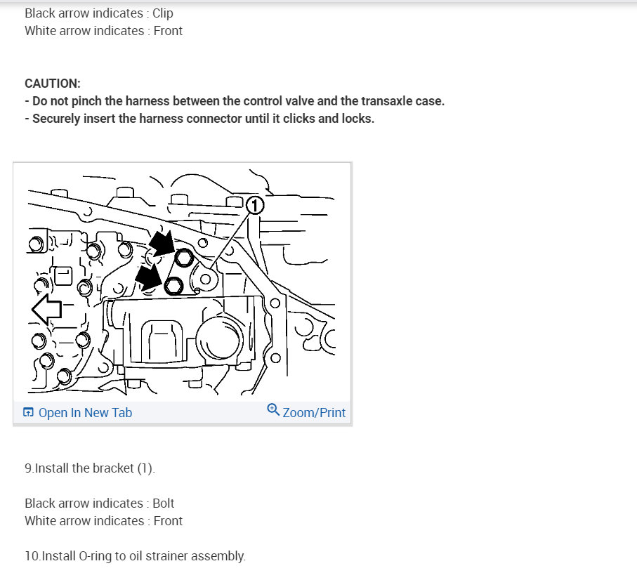

How do i replace and where is it located?
Sep 16, 2022 at 2:22 AM
  • 55,732 POSTS

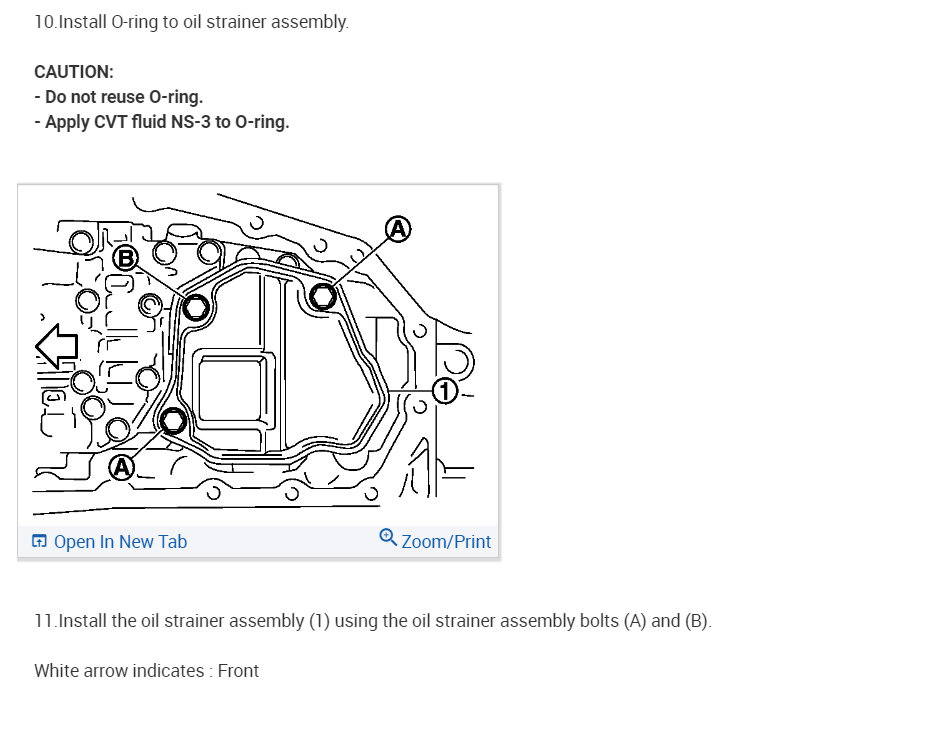

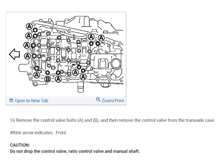

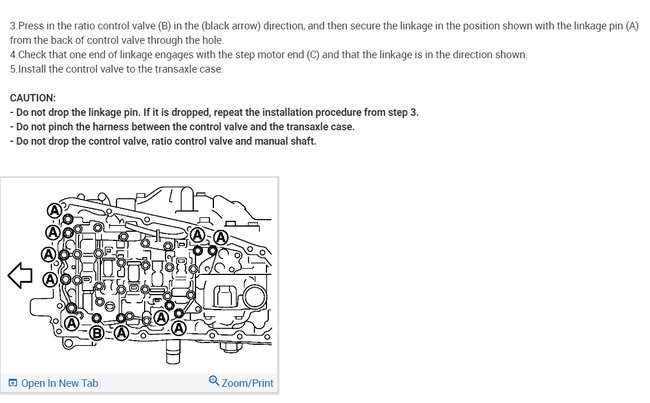

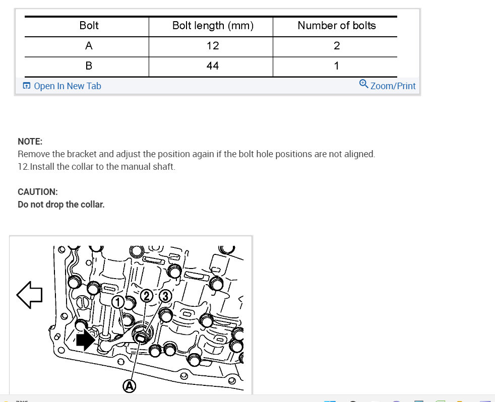

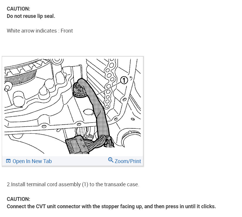

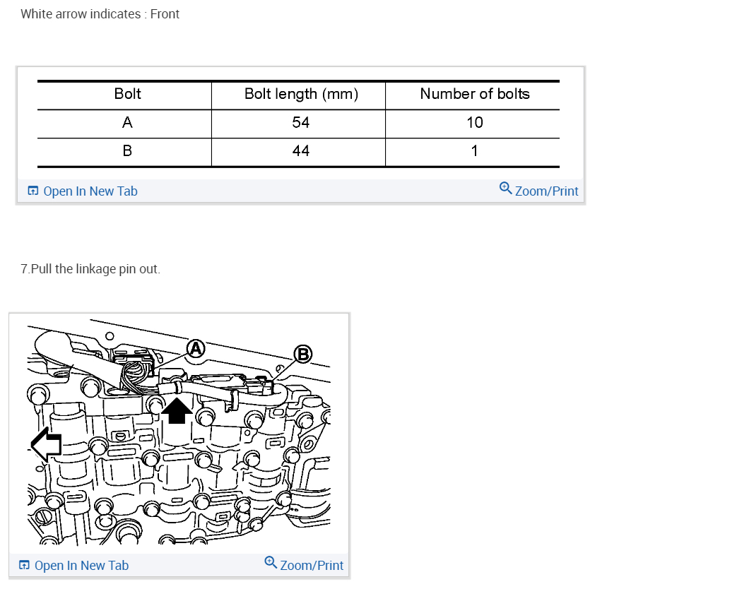

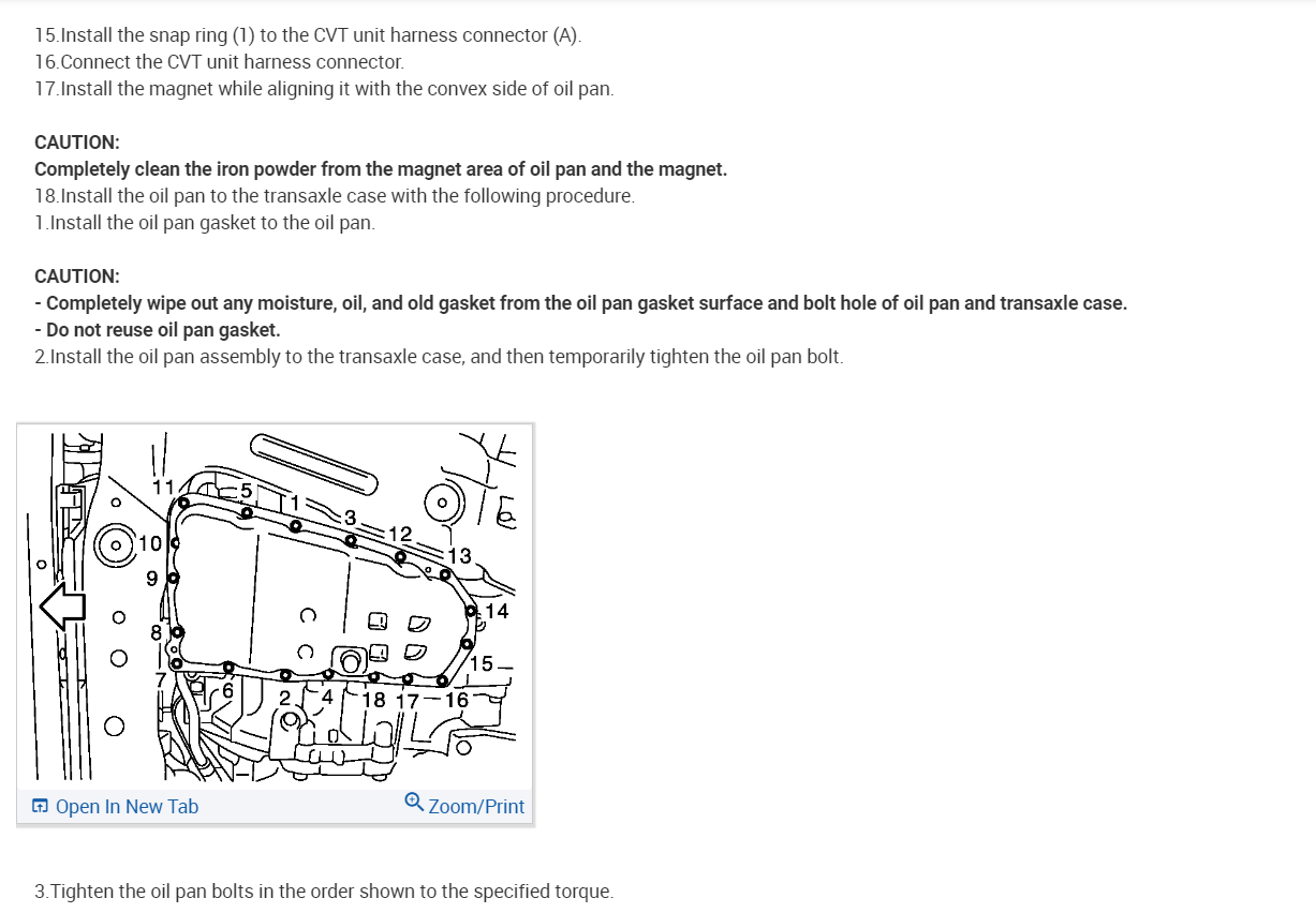

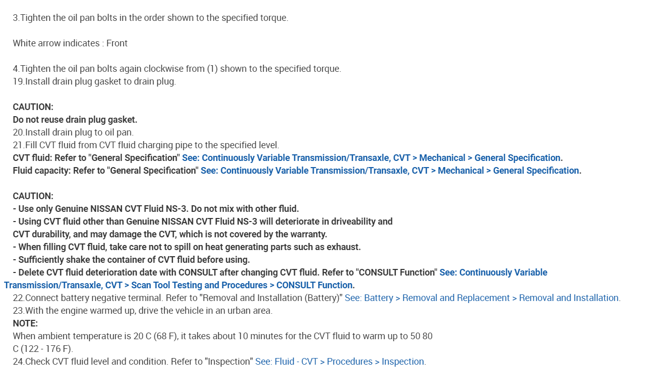

The pressure regulating control solenoid is inside the fluid pan and it has an orange wire going to it. You will need to drop the pan to change it out. Here is what they show in the images below on how to change it out. Check out the images (below). Please let us know if you need anything else to get the problem fixed.
