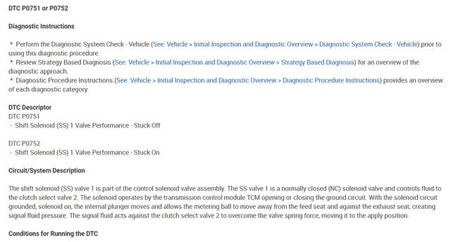

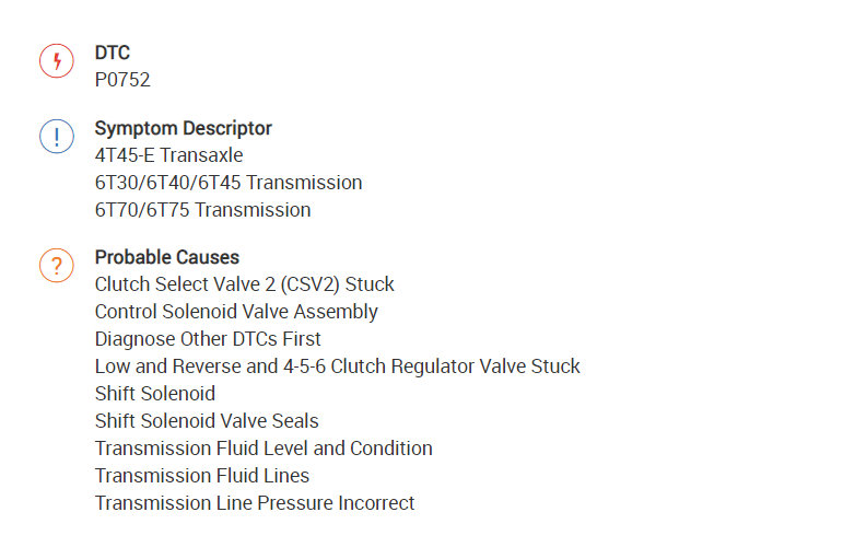

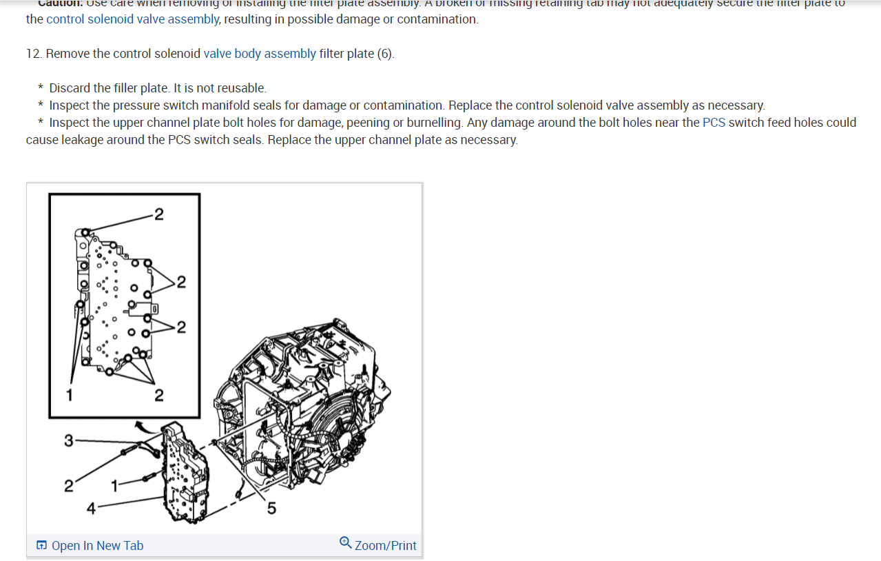

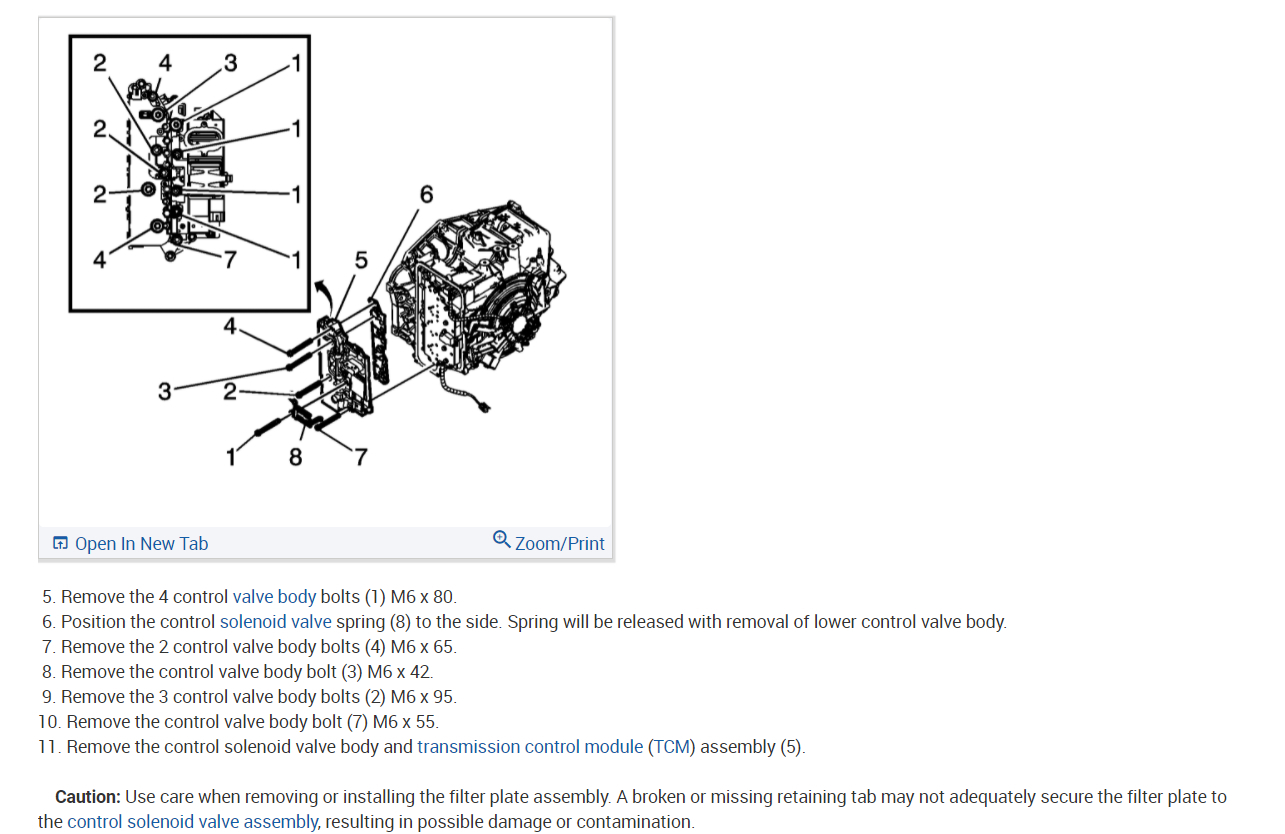

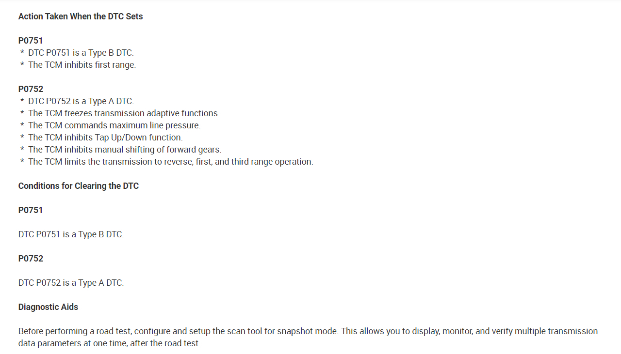

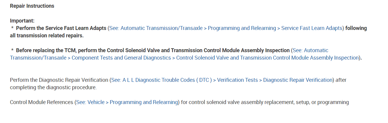

I have those two codes. I’ve changed out the TCM and pressure and cooling lines still will have the vehicle driving normal but at random times mainly in low gear it will get stuck in limp mode. everyone tells me to change transmission, mine doesn’t have 100 on it and I don’t want to put a new one in so could I just change out the valve body and that solve the problem?
May 6, 2021 at 7:30 AM

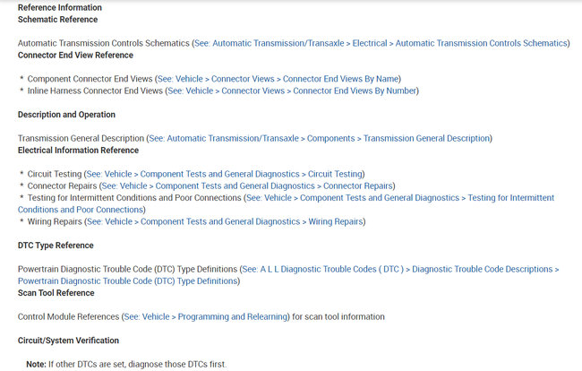

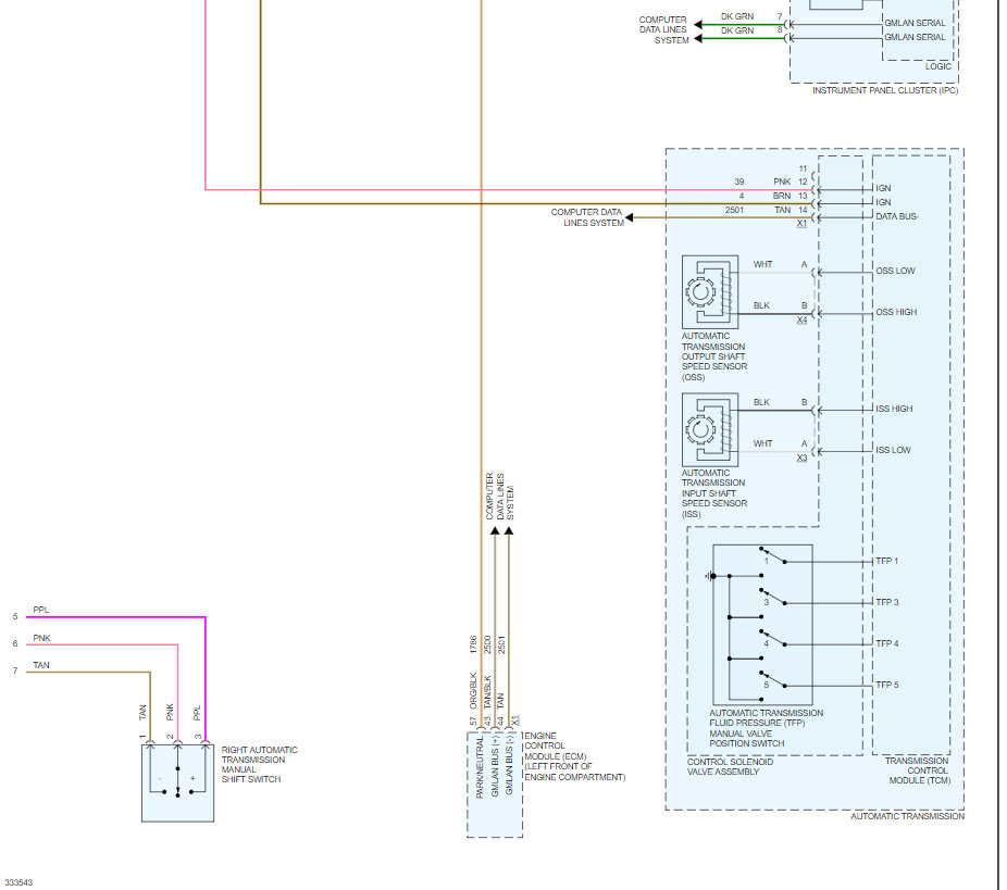

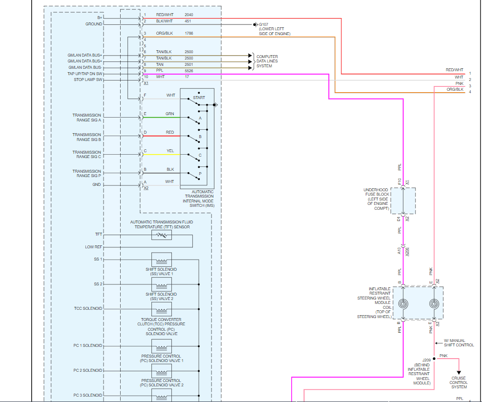

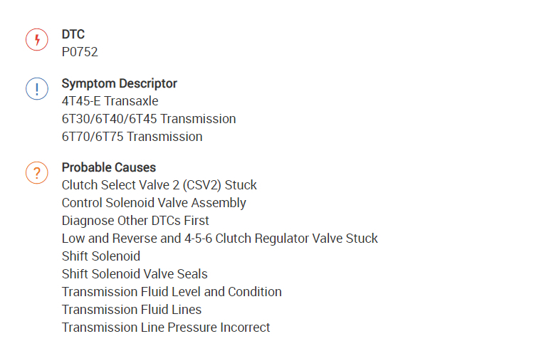

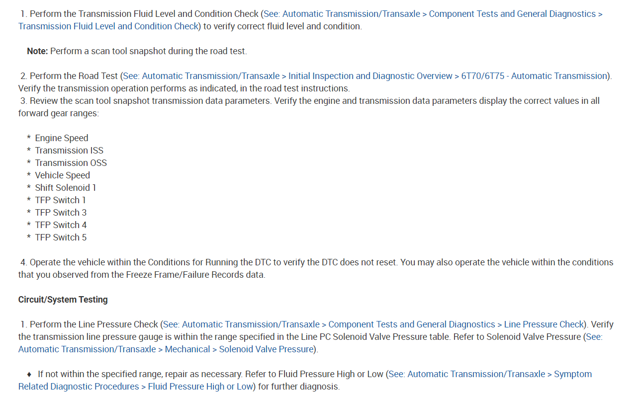

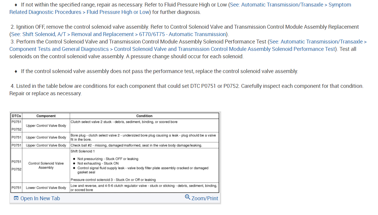

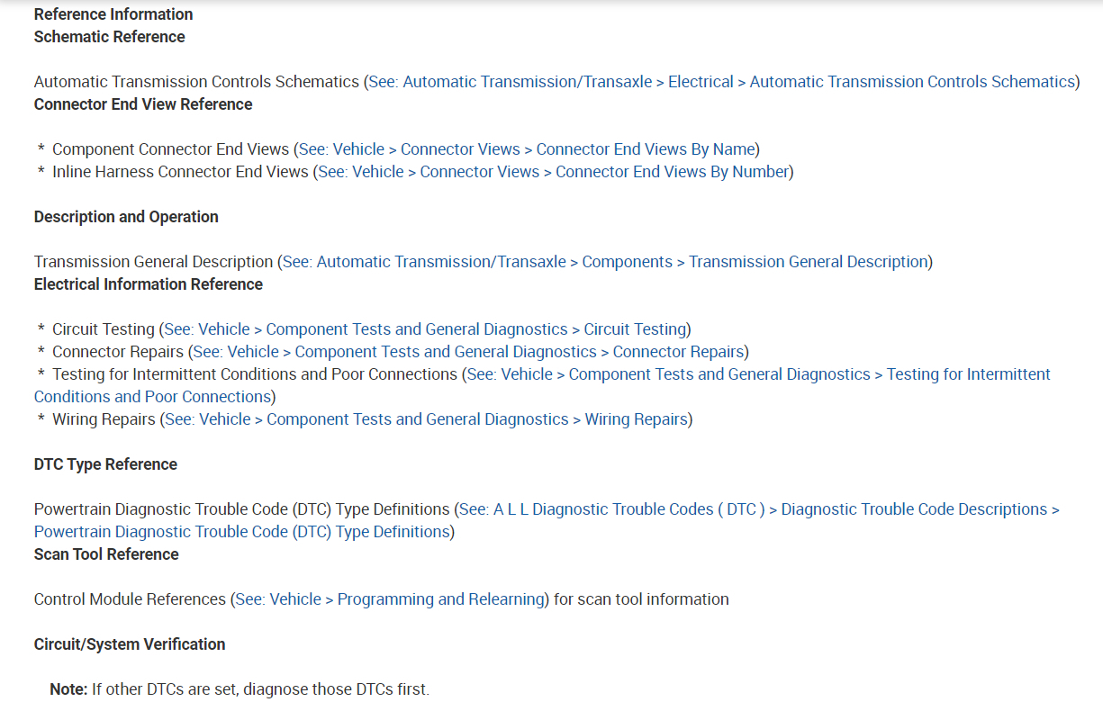

Good afternoon,

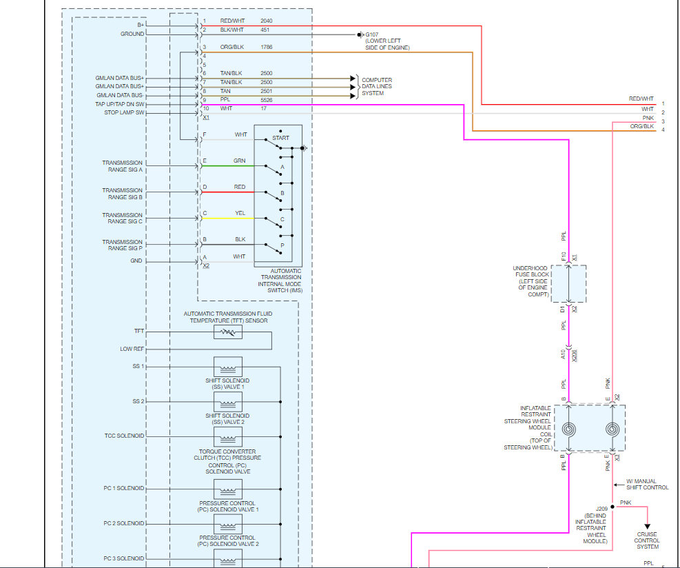

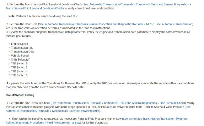

I attached the possibilities for you for review. It could be the valve body but needs to be confirmed. There are many other possibilities for this as well.
I would start by changing the fluid and filter. It should be done every 50,000 miles.

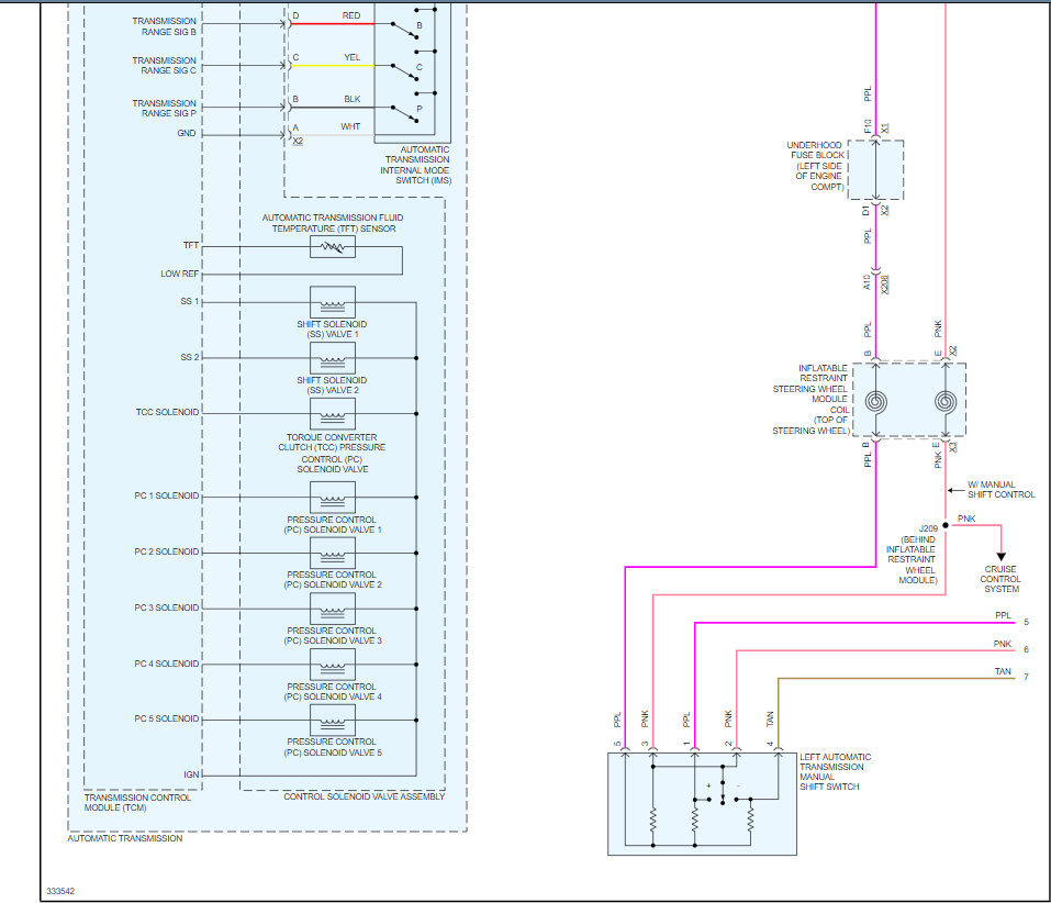

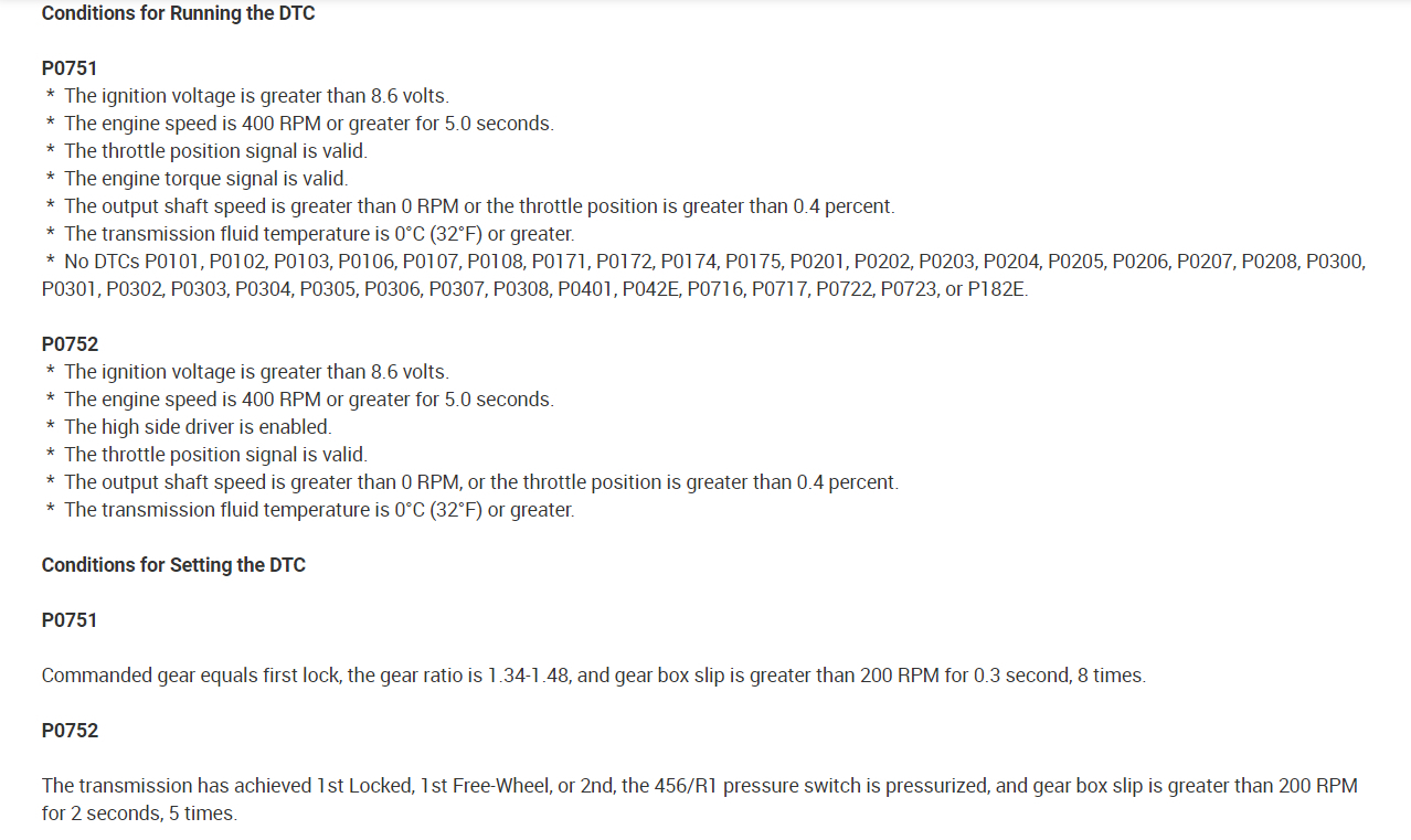

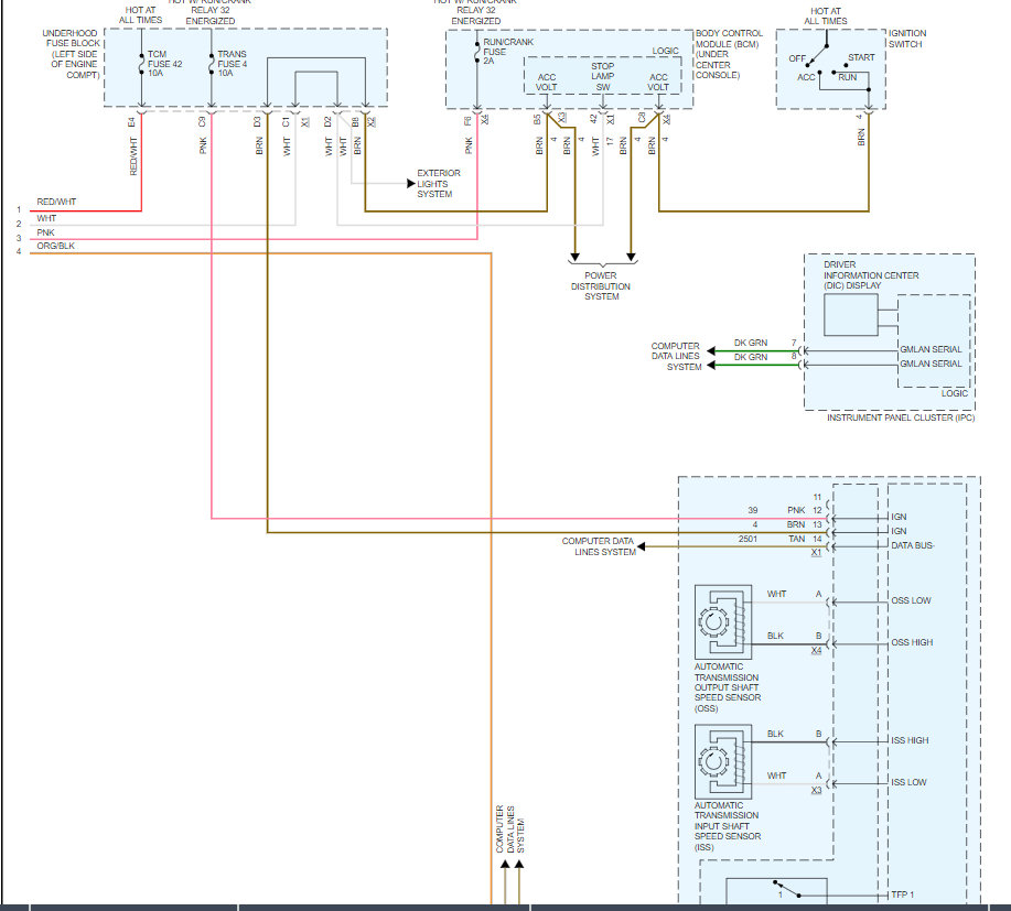

I also attached the flow chart for determining the failure for you as well.
May 6, 2021 at 8:30 AM

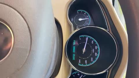

Here’s a driving video during failure:
May 6, 2021 at 8:46 AM

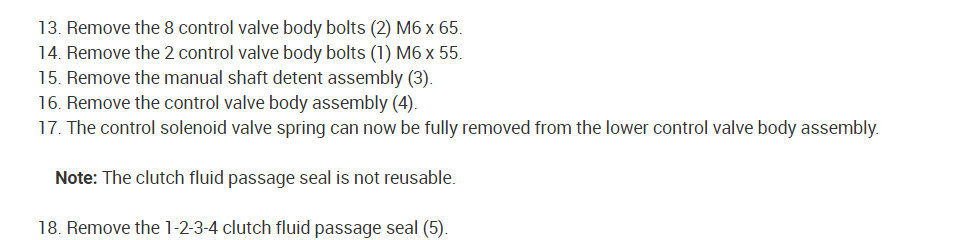

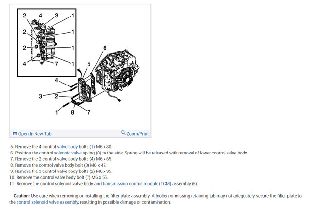

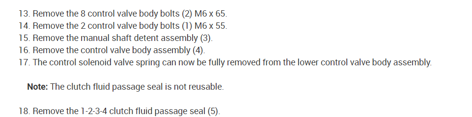

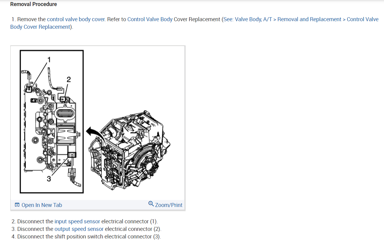

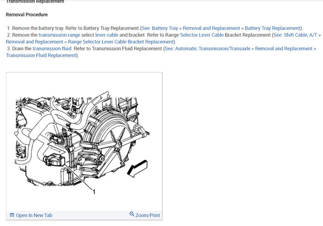

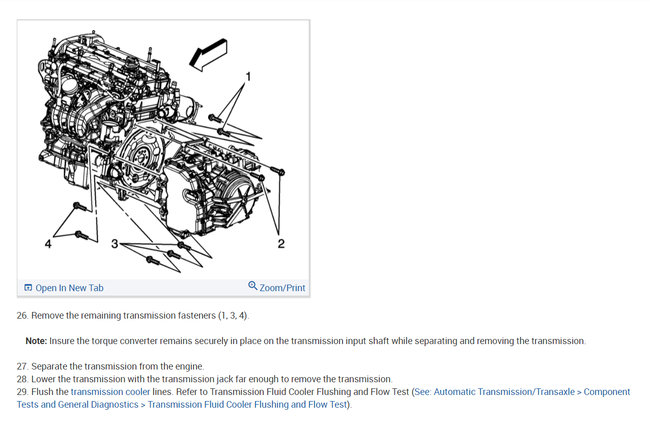

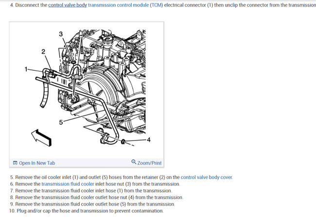

Perfect, I’ll try that thank you. But as far as diagnosis and changing the valve as opposed to the whole transmission what is your opinion there? And do I need to drop the subframe for that?
May 6, 2021 at 10:08 AM
ANTHONY COOK
  • 17 POSTS
Or is it something I could do with my car on jack stands?
May 6, 2021 at 10:09 AM

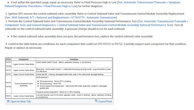

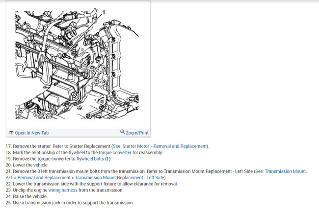

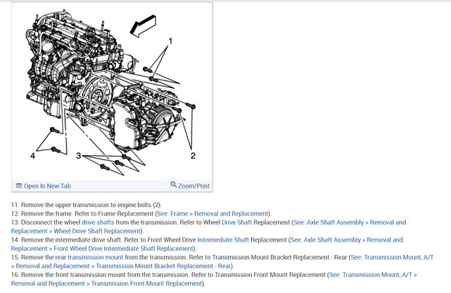

I attached the procedure for you for the removal of the transmission. The book pays 10 hours which means it will take you at least 2 times that.
No, it does not say to drop the subframe at all.
May 6, 2021 at 10:31 AM
ANTHONY COOK
  • 17 POSTS
So change the whole transmission and not just the valve body?
May 6, 2021 at 12:21 PM
Yes, I would. I do not believe it is the valve body at all.
May 6, 2021 at 12:29 PM
ANTHONY COOK
  • 17 POSTS
But why is it so intermittent? only really happens when it’s hot outside.
May 6, 2021 at 12:35 PM
Seals for the clutches are affected by heat both from inside the transmission and the outside temperature.
