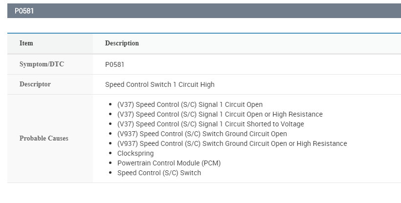

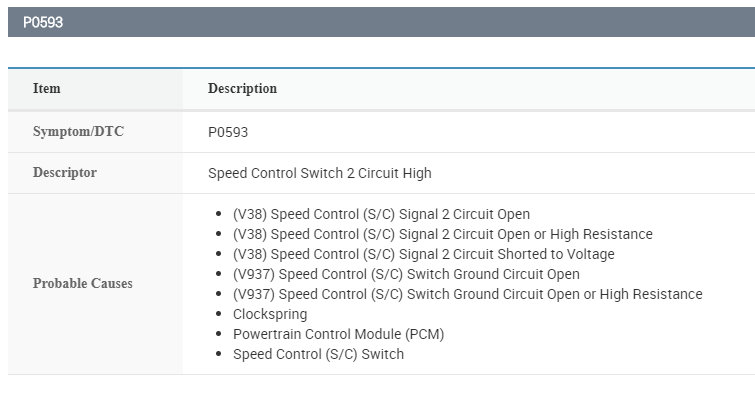

I have the vehicle listed above SE. even though the car doesn't have cruise control (wasn't an option with this SE from the factory) I'm getting two codes p0581 and p0593 (speed control switch 1 and 2 circuit high). Those 2 codes have to do with the cruise control which my car doesn't even have! Now a secondary thing that's going on which may be a hint as to why I'm getting those codes, is that my airbag light comes off and on intermittently and shows I need to fix the clock spring. I heard a faulty clock spring could potentially set those 2 codes off. Now here's the 3rd and final part of all this all the most important one, when in driving then downshifting and coming to brake the rpm's will jump up a few hundred rpm at around 1,350 then again at 1,000 up to maybe 1,300. If i don't let go of the brake it'll only do the rpm jump a tab, if i don't brake hard it can even get stuck at 1000 for a couple seconds the jerk me forward and go back down to 1,000 rpm's. Can all these electrical codes be causing my rpm's so jump up while braking/downshifting? The cruise control does affect rpm, so if my car thinks there is a cruise control problem that's could cause it, but why only when downshifting? I went to a transmission guy and there are no codes and he thinks it's nothing to do with the transmission. Anyways, has anyone has any experience with this insanity? Thank you so much guys. thanks again.

The clock spring could be producing these codes. The 2 codes you sent me do indicate the clock spring as a possibility.

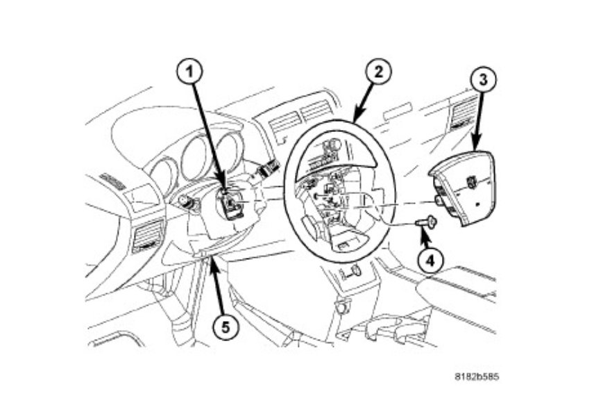

Caution: When installing the steering wheel, the clock-spring must be centered in its travel to avoid overextending the clock-spring inner parts, causing the clock-spring to become inoperative. If removed and handled properly using the correct procedures, it should be in the "centered" position. If there is any question as to whether the clock-spring is in the "centered" position of travel, perform the clock-spring centering procedure before proceeding. See: Clockspring Assembly / Spiral Cable, Air Bag > Procedures > Clockspring Centering .

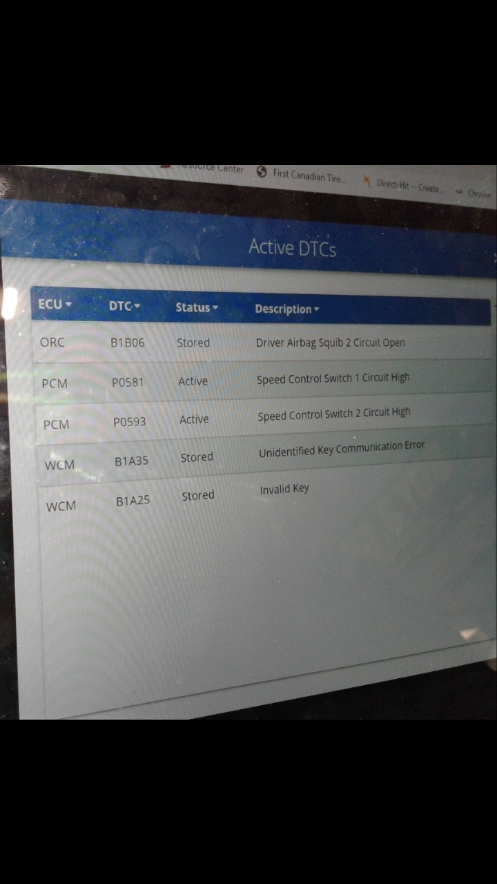

These are the 3 codes. The airbag one is B1B06 and as you can see from all 3 codes all 3 circuits are high. Whatever that means lol. I'm thinking the B1B06 aka clock spring (right?). Is causing the other 2 codes to go off and my car doesn't even have cruise control. As for the software thing the dealership can't just check that, that's part of a diagnostic which is $162.00, so I doubt I'll so it unless I really have to and no one can ever figure out why the rpm's go up while downshifting. Once again thanks for your help and time Roy.
Oct 28, 2019 at 3:01 PM
The 2 B codes you showed are for unidentified keys.
Did you use an incorrect key to start?
The other ones should be part of the update on the software since you do not have cruise.
I would not get a clock spring. What makes you think you need a clock spring?
Oct 28, 2019 at 3:14 PM

The first code is also a B code, you said my 2 B codes and I have 3. You are saying the first B code which has to do with the airbag has nothing to do with the speed circuit high codes and the reason I'm getting these codes is most like because of the bottom 2 codes which are also B codes? And I need a factory update done?
Oct 28, 2019 at 6:06 PM
What was the third B code. I could not read it in the picture.
Oct 28, 2019 at 6:35 PM
MITCHRUBIN09
  • 16 POSTS
B1b06, b1a35, b1a25 a. those 3 say stored under status, the p0593 and p0581 says active under status.
Oct 28, 2019 at 7:08 PM
Can you verify the B1b06 code? I see nothing at all for this code for your car.
Oct 29, 2019 at 12:51 PM
MITCHRUBIN09
  • 16 POSTS
The first code is b1b06 (status/stored)-driver airbag squib 2 circuit high. The next code is p0581(status/active)-speed control switch 1 circuit high and the 3rd code is p0593 (status/active)-speed control switch 2 circuit high. I attached a picture, not sure why you couldn't see the b1b06 code? But it's there with the other 2.
Oct 29, 2019 at 6:42 PM
I am not saying I cannot see it on your picture, I do not see it in my information system.
Anyway, the explanation indicates a short somewhere in the harness with the high voltage code. Yes, it could be the clock spring but also could be a short somewhere else.
I would start by getting the reprogramming done for the other codes so they do not mislead you to thinking the other codes may not be real.
