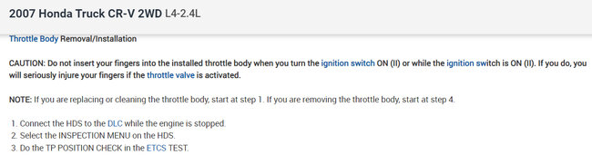

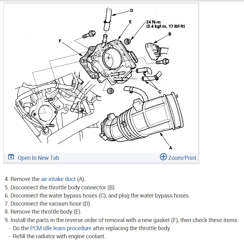

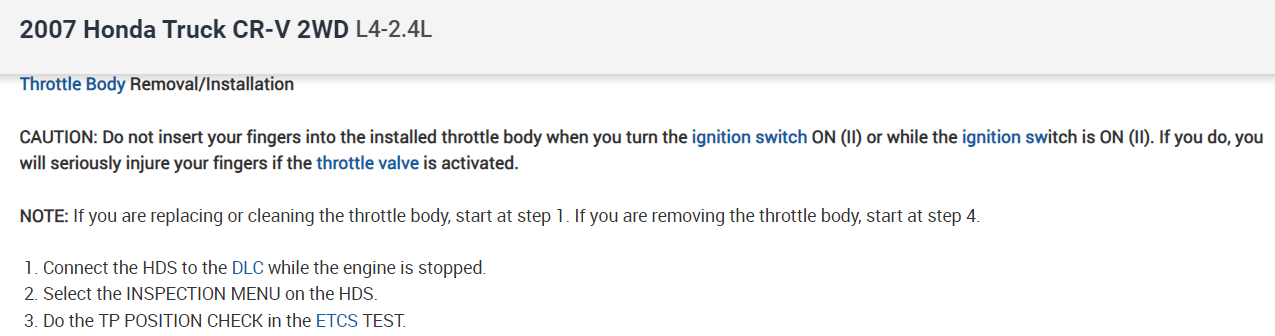

I have seen a dirty throttle bore cause this issue or a vacuum leak FYI. Here are guides to help you fix it.
https://www.2carpros.com/articles/engine-idles-too-high
and
Here is how the job is done on your car. Check out the images (below). Please upload pictures or videos in your response to the problem so we can see what's going on.
