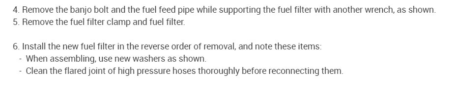

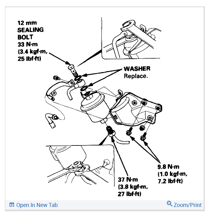

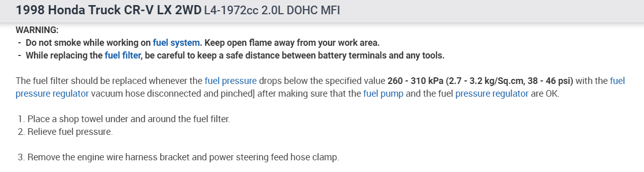

P0170 is fuel trim Bank 1 and P0171 is system too lean Bank 1. I have seen a clogged fuel filter cause this here is the location so you can check it out, also if the filter is new then I would check for vacuum leaks. Here are too guides that can help.
https://www.2carpros.com/articles/repair-lean-mixture-codes-p0171-or-p0174-on-some-manufacturers
and use this guide when the engine is cold only.

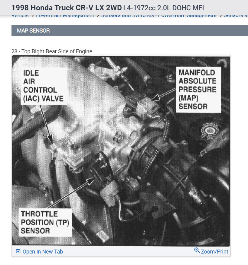

If everything checks out I would replace the MAP sensor. Check out the images (Below). Please let us know what you find. We are interested to see what it is.
