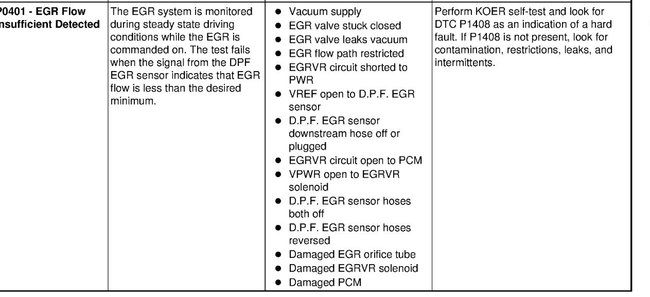

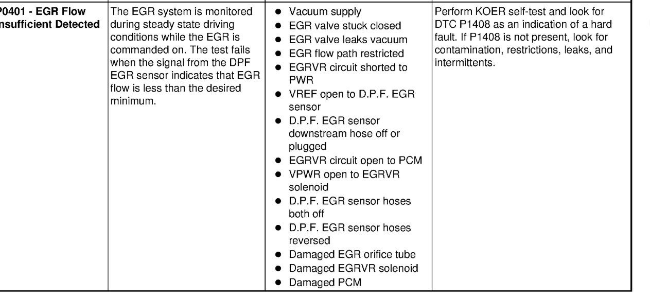

Good morning,
The 401 code is for the DPFE sensor. it is n exhaust back pressure sensor.
Was there a code prior to this that made you think the sensor was bad?
401 possible issues
P0401
Descriptor
Egr Flow Insufficient Detected
Probable Causes
Differential Pressure Feedback EGR (DPFE) Sensor Downstream Hose Off or Plugged
Differential Pressure Feedback EGR (DPFE) Sensor Hoses Both Off
Differential Pressure Feedback EGR (DPFE) Sensor Hoses Reversed
EGR Vacuum Regulator (EGRVR) Circuit Shorted to Power
EGR Vacuum Regulator (EGRVR) Solenoid Damaged
EGR Vacuum Regulator (EGRVR) solenoid Circuit Open to Powertrain Control Module (PCM)
Exhaust Gas Recirculation (EGR) Flow Restricted
Exhaust Gas Recirculation (EGR) Orifice Tube Damaged
Exhaust Gas Recirculation (EGR) Solenoid
Exhaust Gas Recirculation (EGR) Valve
Exhaust Gas Recirculation (EGR) Valve Leak Vacuum
Exhaust Gas Recirculation (EGR) Valve Stuck Closed
Powertrain Control Module (PCM) Damaged
Reference Voltage from Powertrain Control Module (PCM) Open to Differential Pressure Feedback EGR (DPFE) Sensor
Vacuum Supply
Voltage Power Open to EGR Vacuum Regulator (EGRVR) Solenoid

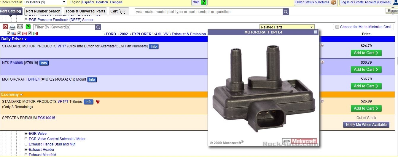

Good. I would replace the DPFE sensor.

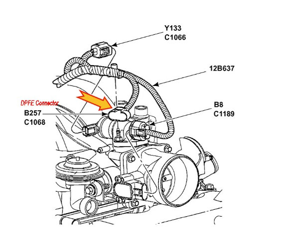

Would you happen to have the location of it. Passenger side of the motor I assume. And plug and play?
Dec 15, 2018 at 6:40 AM
It is on top of the motor behind the throttle body. it has two rubber hoses that go to the exhaust manifold.
it is a plug and play replacement.
Dec 15, 2018 at 9:26 AM
