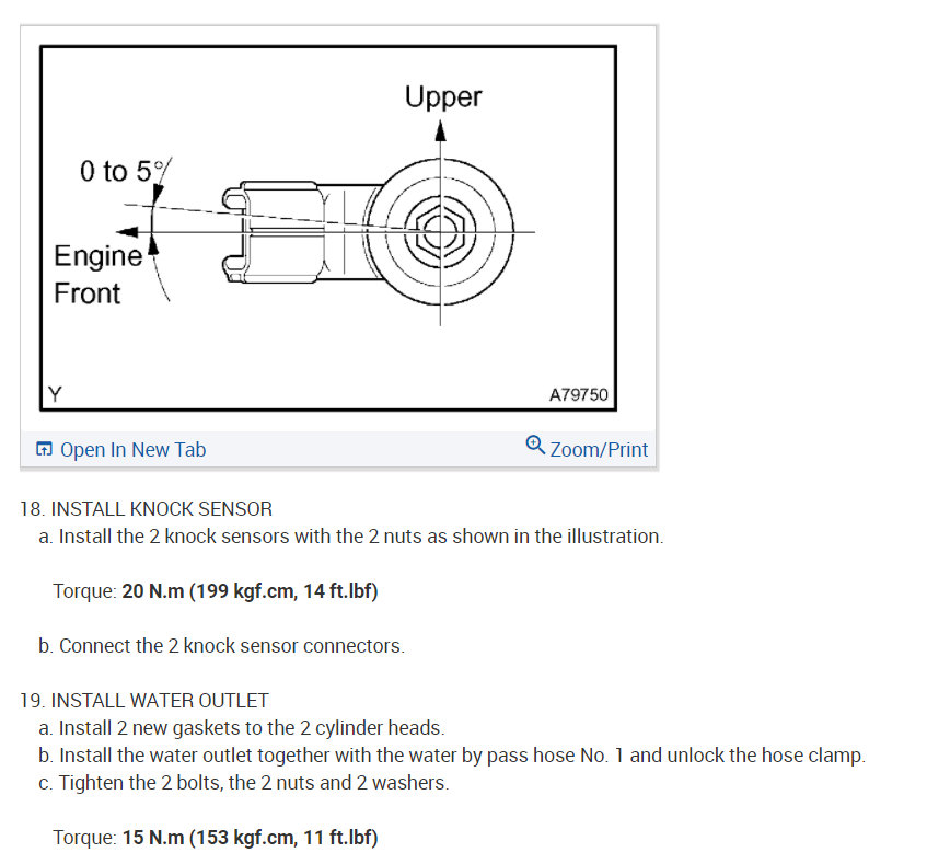

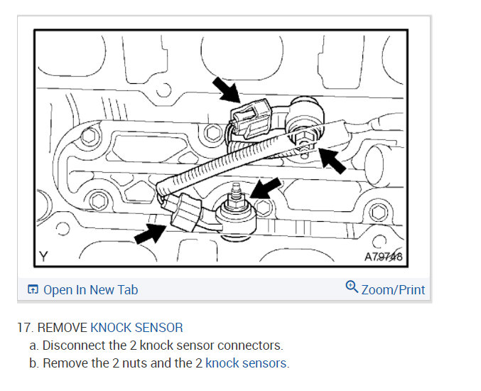

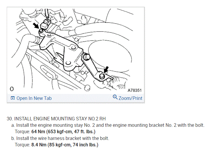

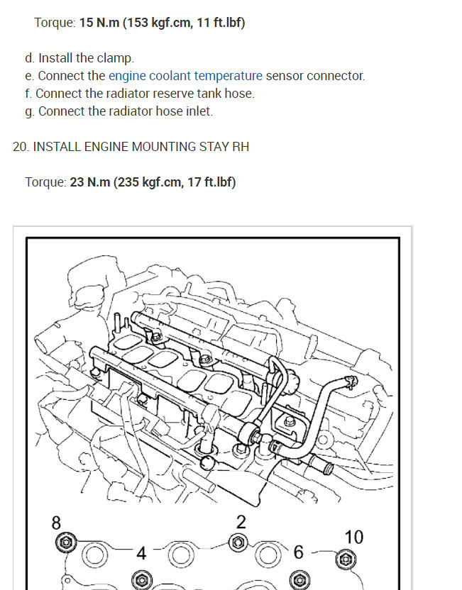

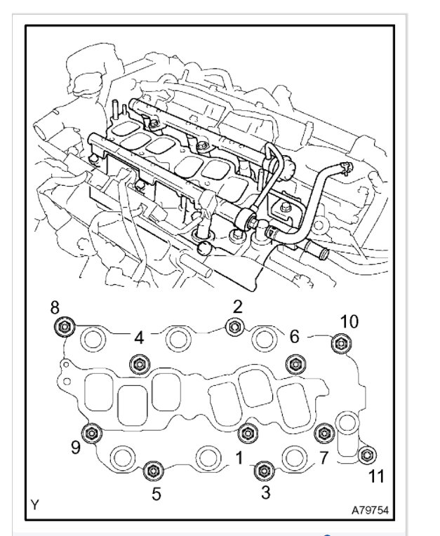

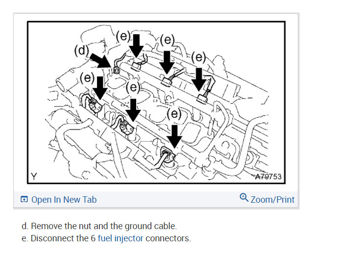

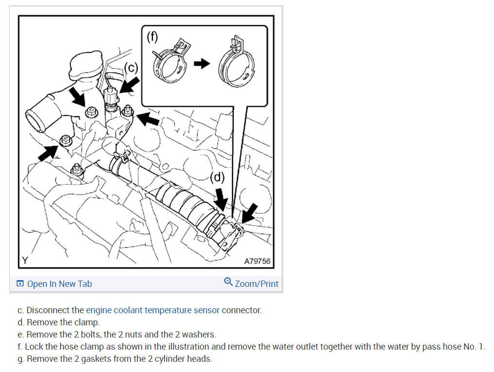

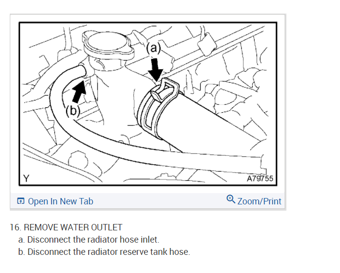

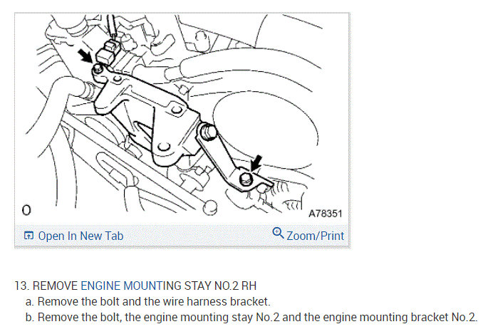

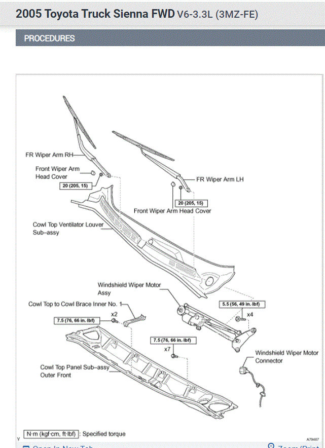

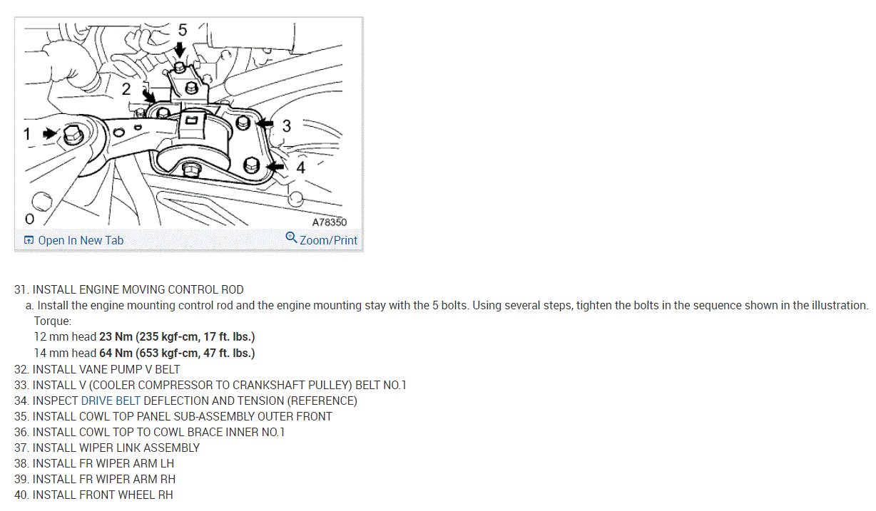

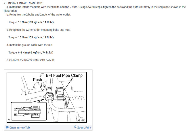

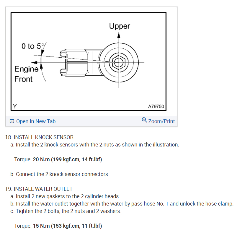

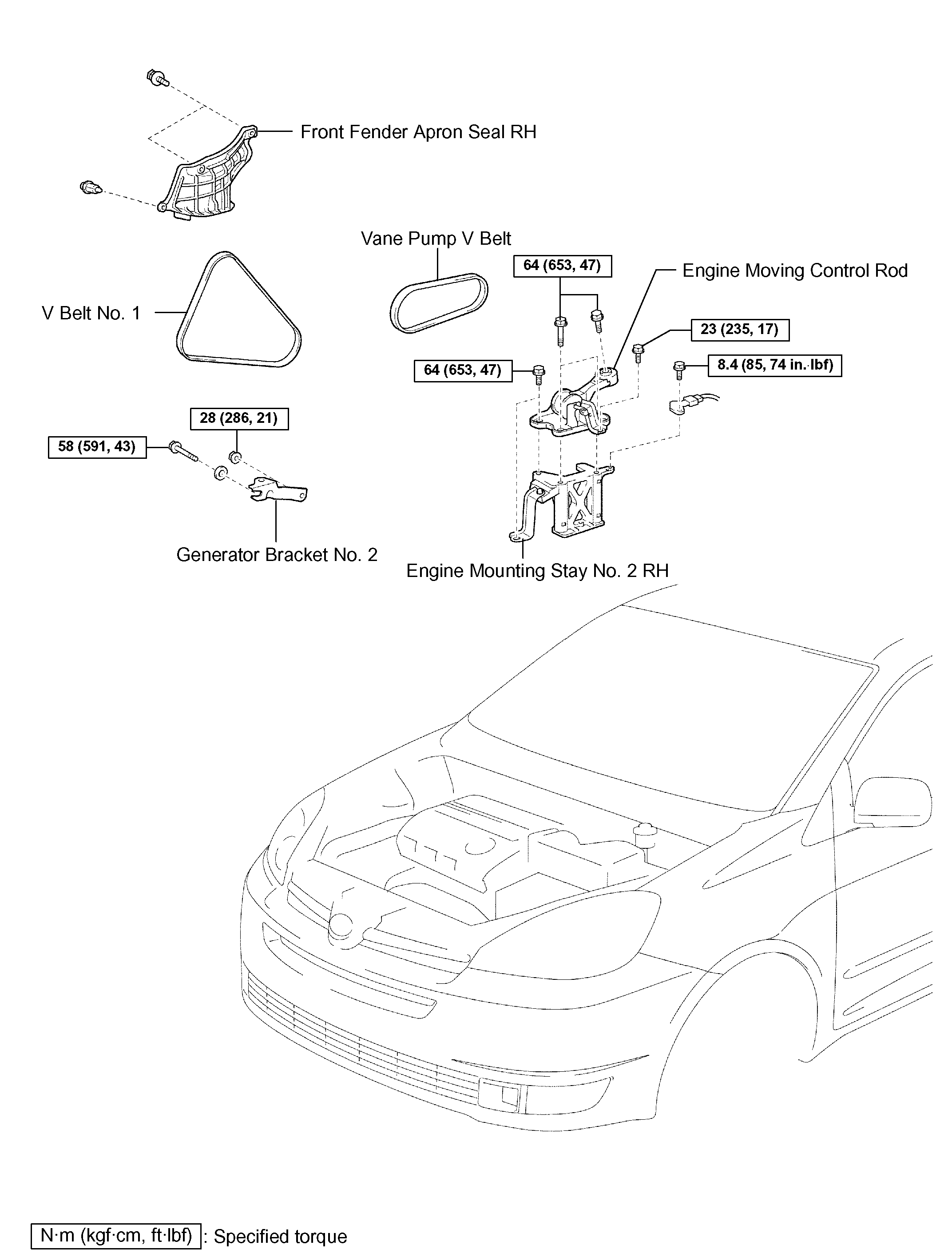

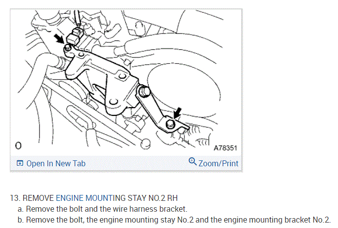

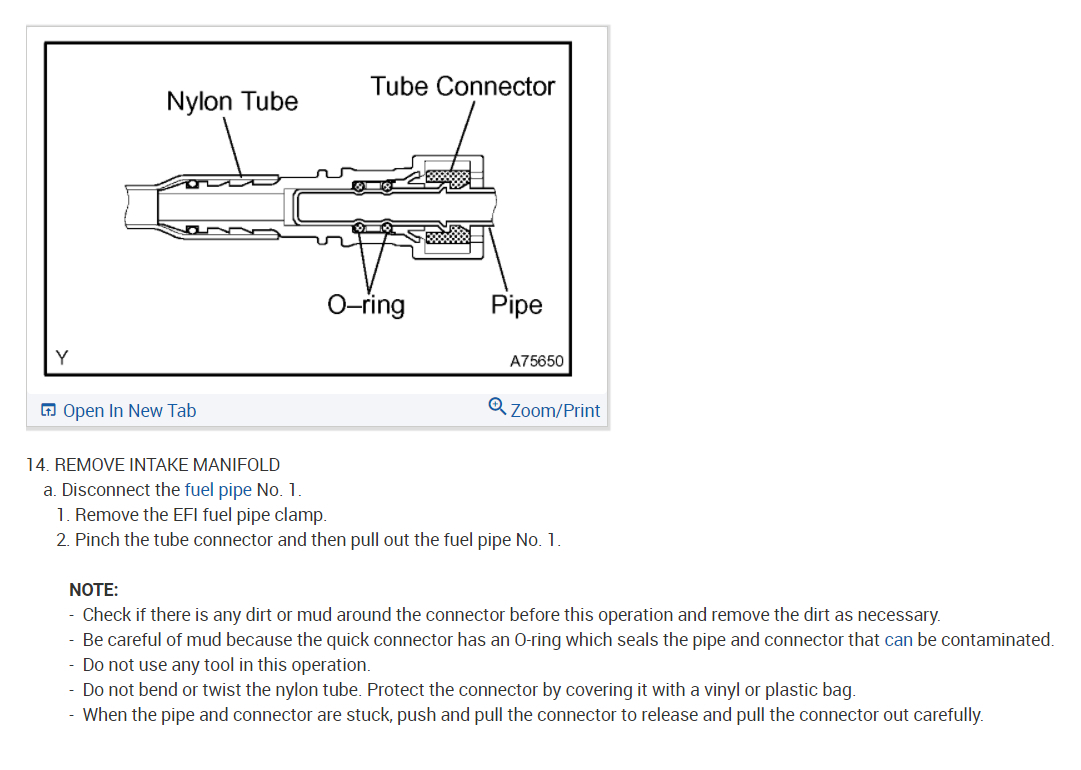

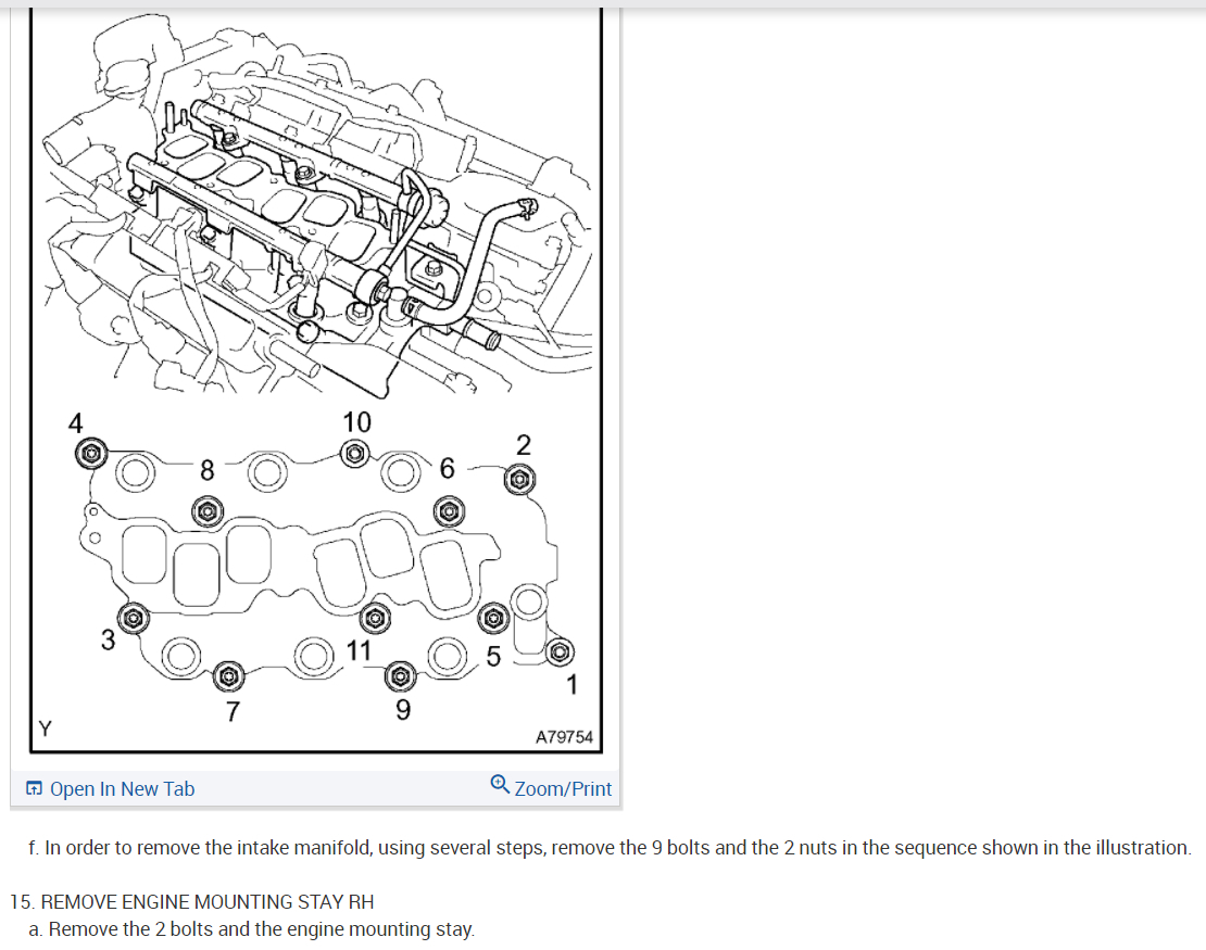

The P0328 code is telling us that there is a high input from the bank 1 knock sensor 1. The ECU detects excessively high voltage that is out of range of the knock sensor. Yes OEM sensors are best but it sounds like you over tightened which can damage the sensor. I would redo the job with OEM units. here is how to change them out in the diagrams below with torque specs. Check out the diagrams (below). Let us know what happens and please upload pictures or videos of the problem.
May 19, 2021 at 4:19 AM

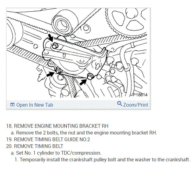

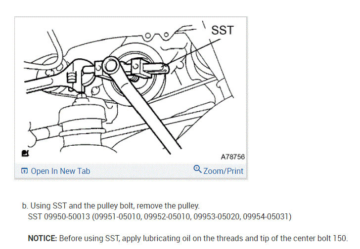

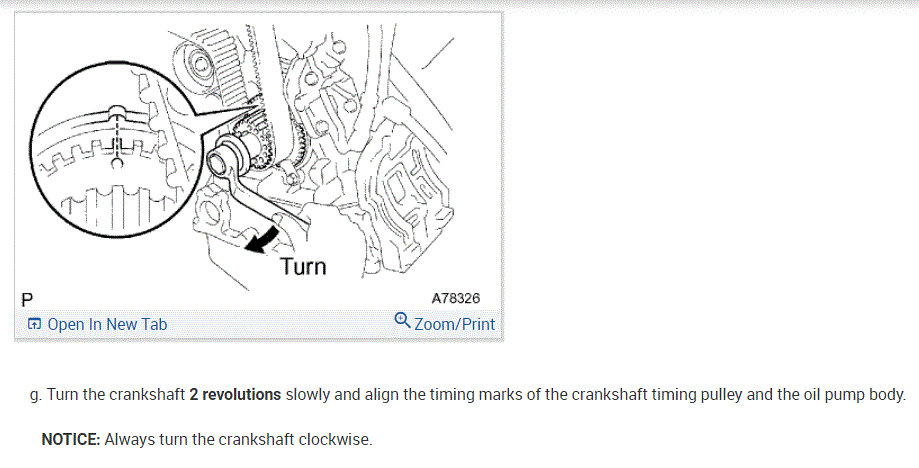

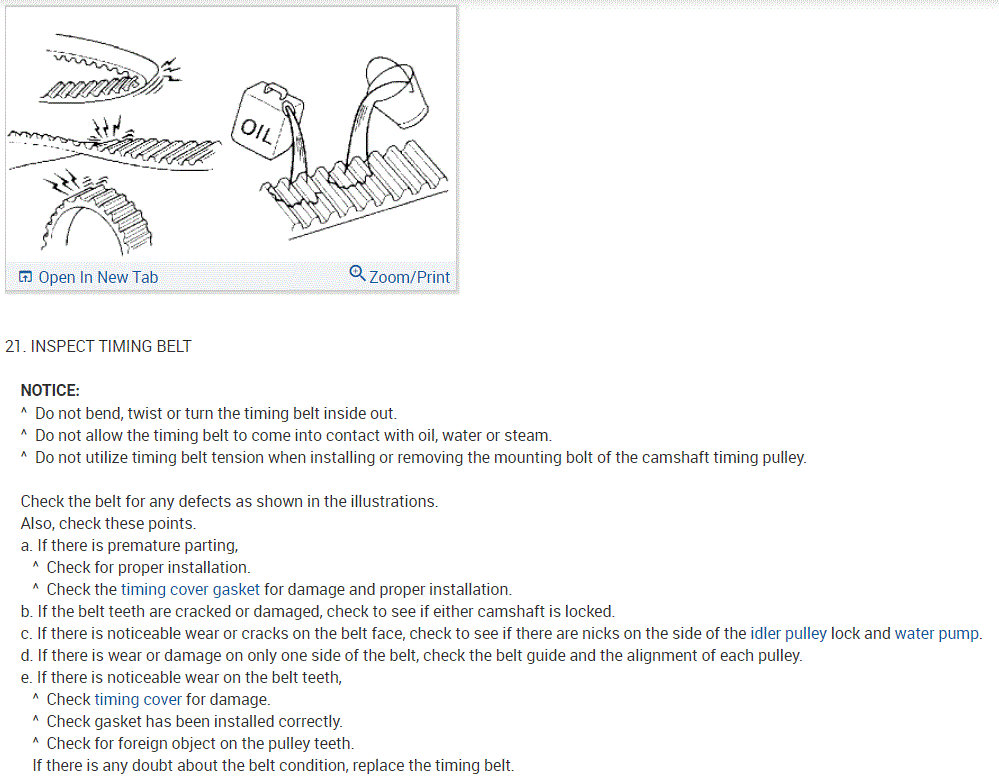

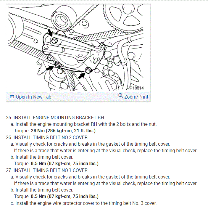

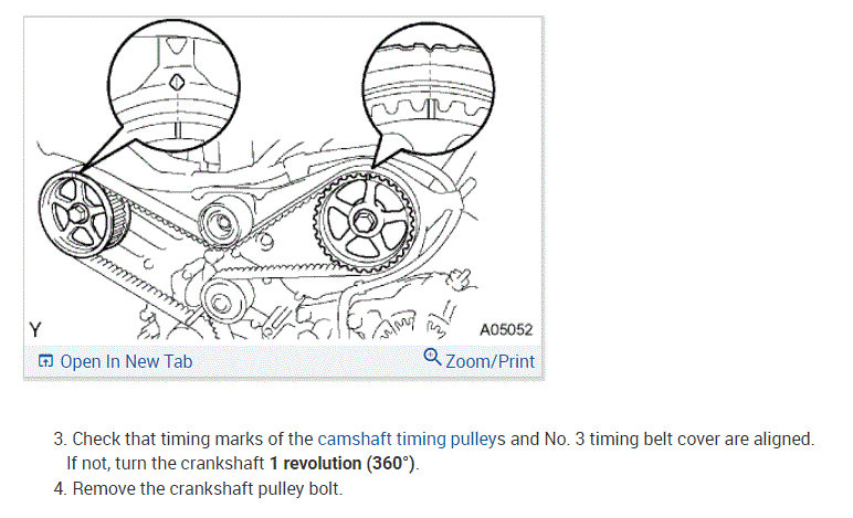

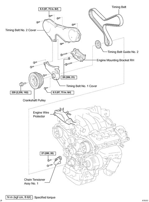

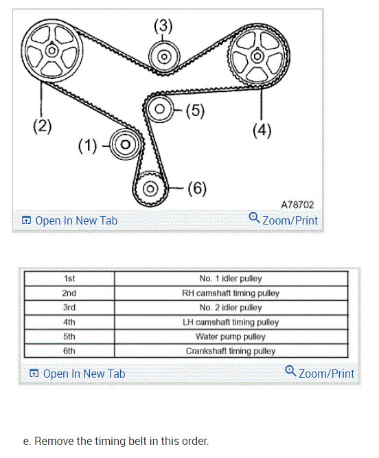

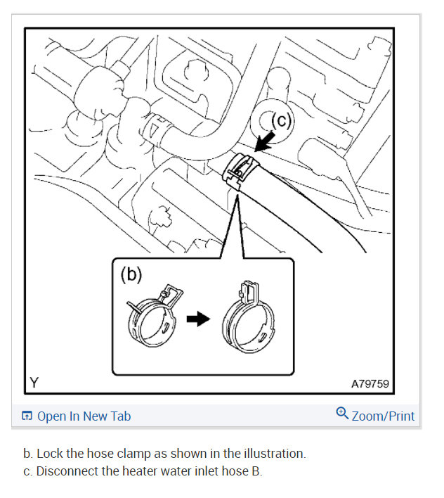

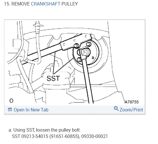

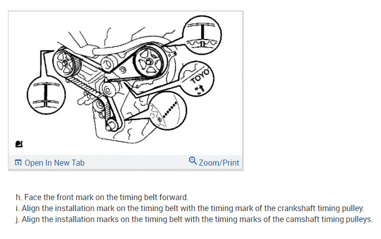

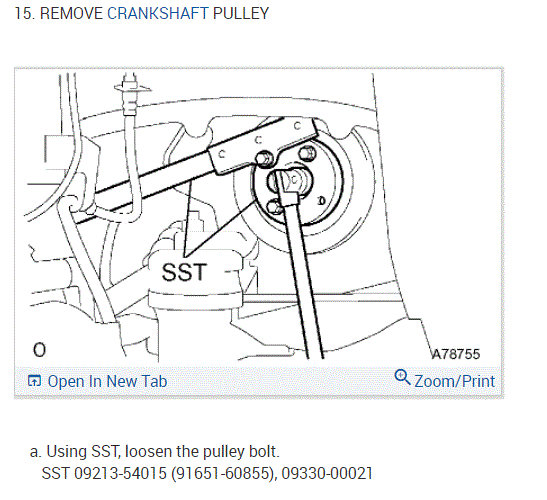

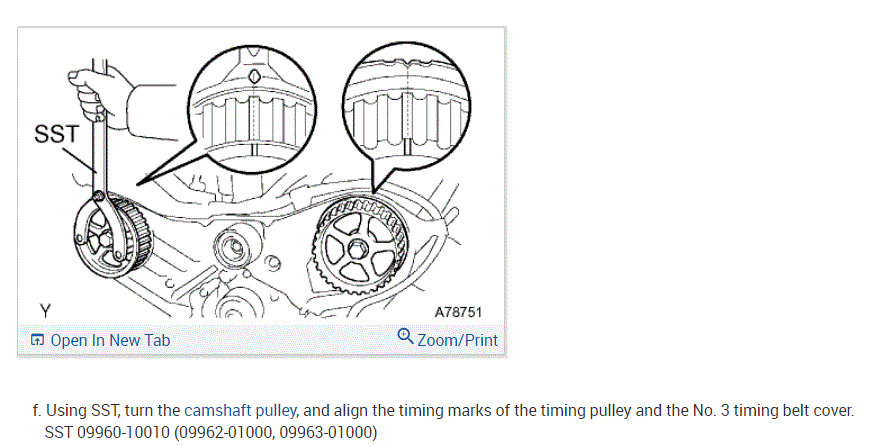

  • 110,244 POSTS

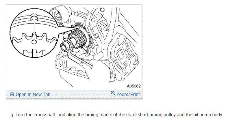

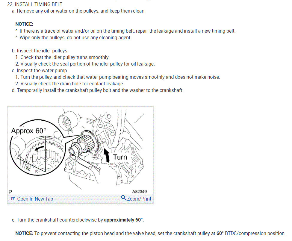

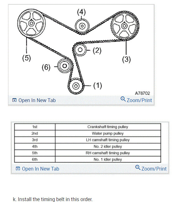

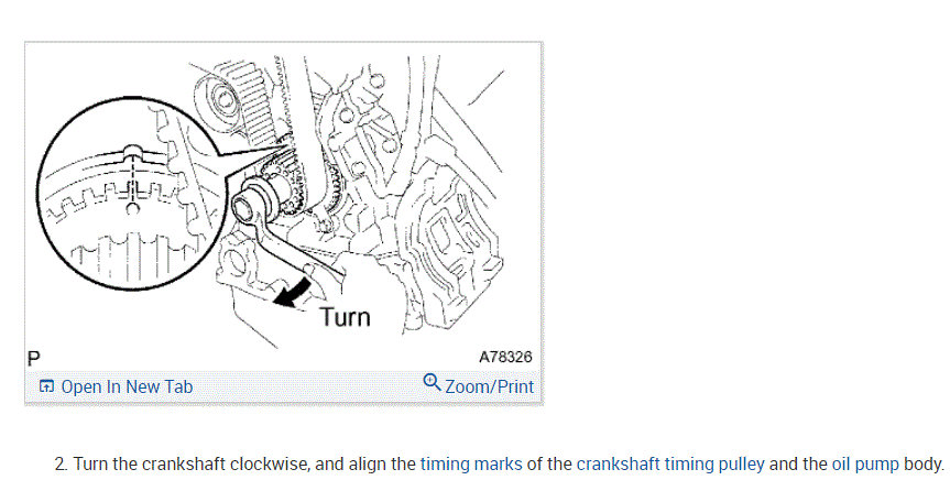

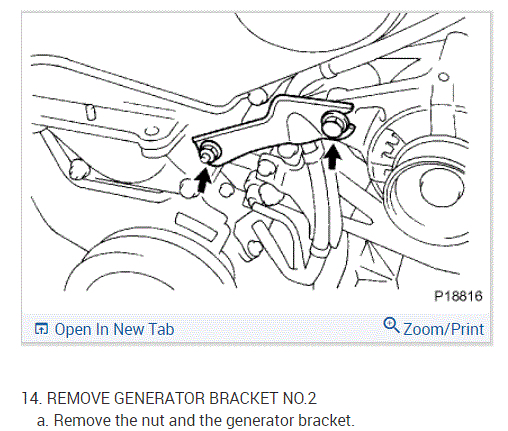

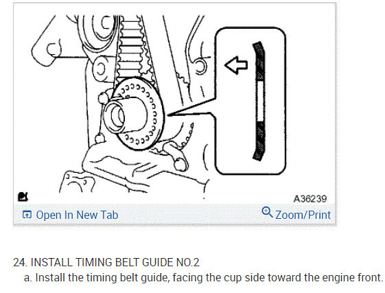

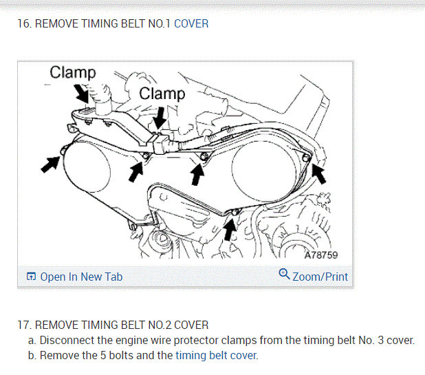

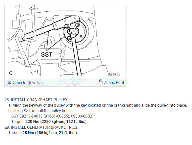

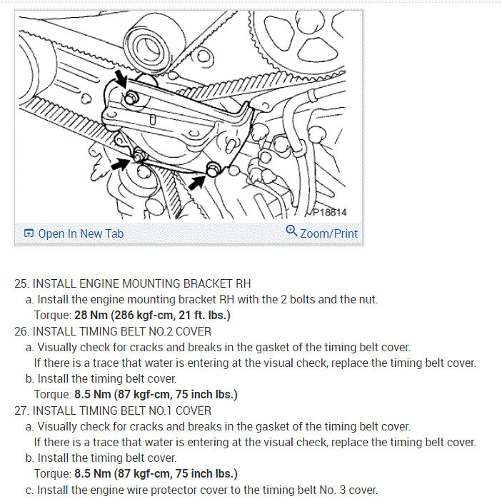

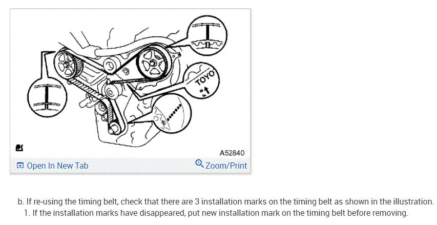

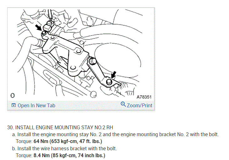

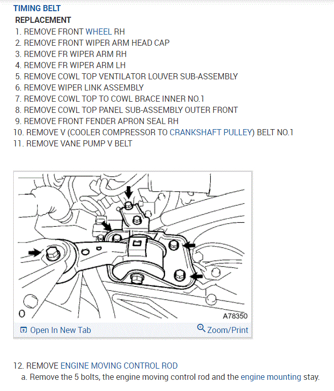

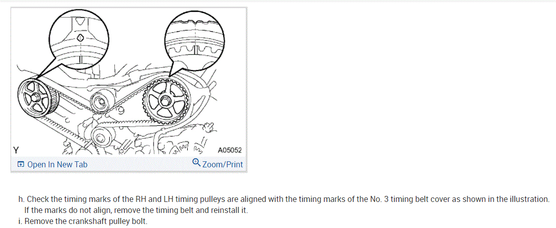

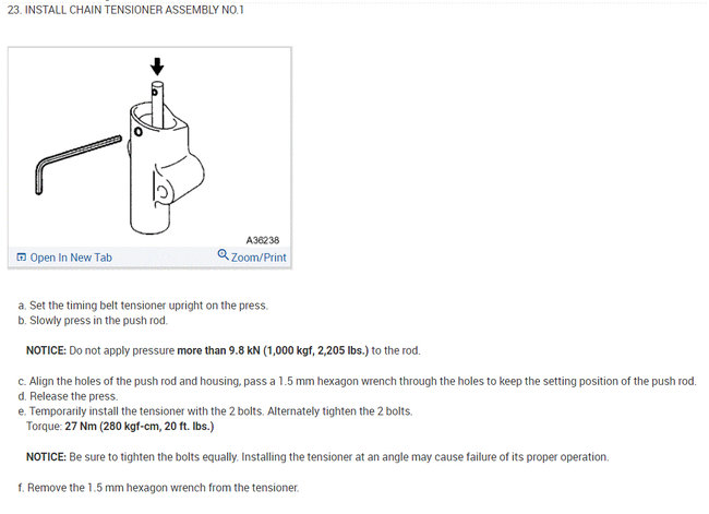

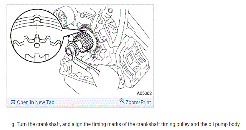

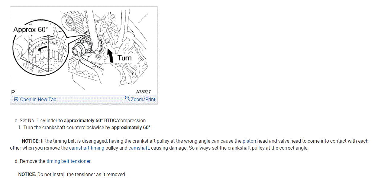

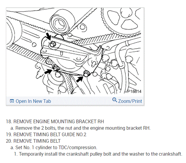

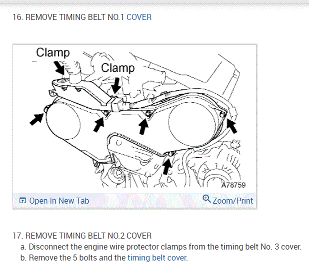

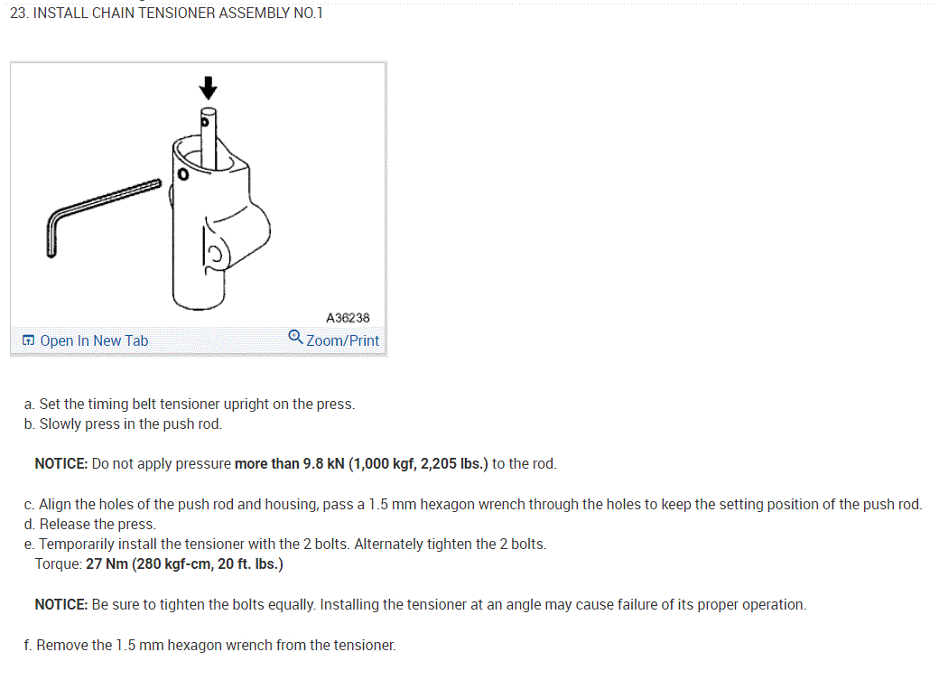

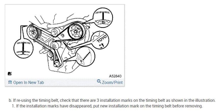

If the belt is original, it is likely stretched at this point and certainly could cause a problem with engine timing. And it could also cause a power loss to a degree. But it wouldn't cause a transmission issue. Have you had the CAN scanned to see if there are codes in other modules?
I would suggest replacing it because of mileage. This is an interference engine and if it breaks, it will likely cause internal engine damage.

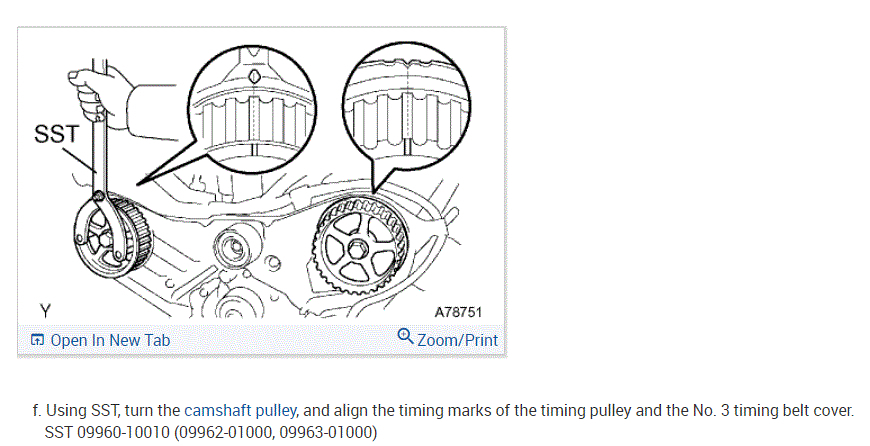

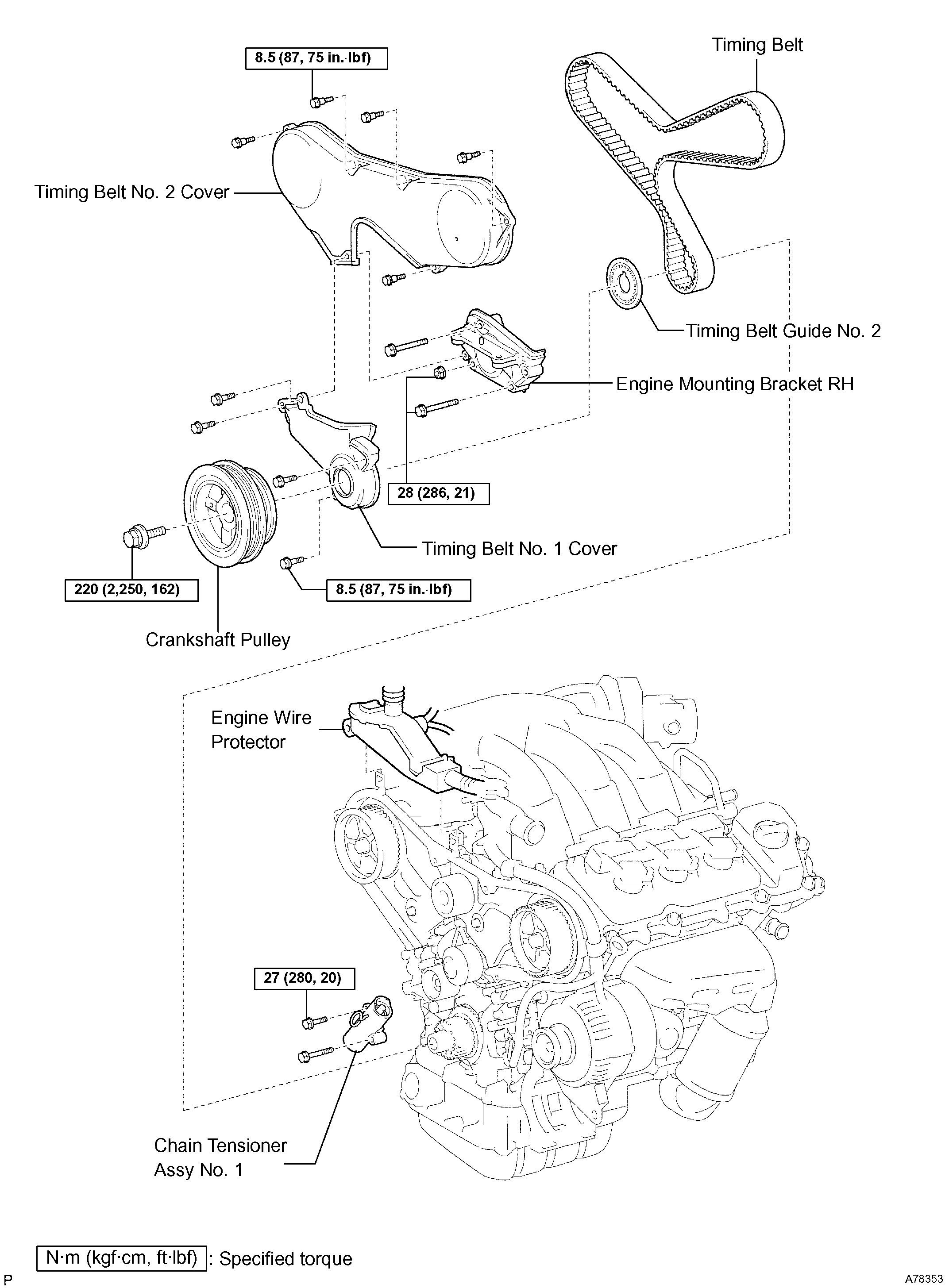

Replacing it is a somewhat big job. I attached the directions below for your review. Let me know if it is something you are comfortable doing.
Jun 5, 2021 at 12:58 PM

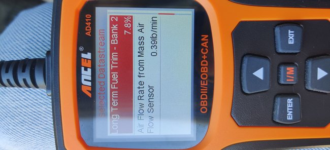

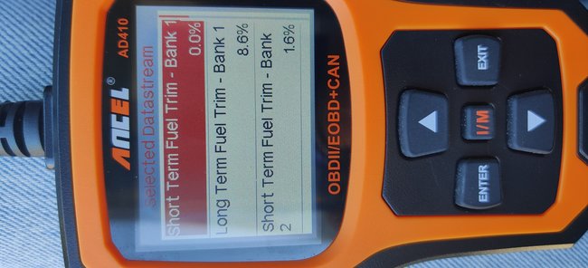

RUDYPAK
  • 42 POSTS
First and foremost I would like to thank all the people who have so generously offered the information.
Using a basic scan tool I was able to look at my MAF, short and long fuel trim. In the attachments you can see I am running a little high on my long for both Banks 1 & 2.
From what some information I gathered on the internet my MAF is reading low.
Also the fuel injector seals that go into the intake manifold are really loose. A couple I can wiggle side to side. Does this create vacuum leak and it's my MAF going bad?
Thank you
Jun 15, 2021 at 10:42 PM

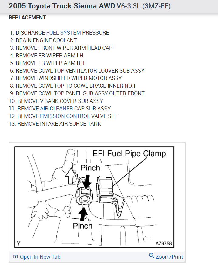

  • 110,244 POSTS

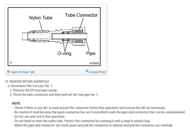

If you are able to wiggle the injectors, something is wrong. They should be tight. By any chance are you getting a fuel smell when the engine runs? If the injectors are loose, they could be leaking which can be dangerous.
Also, if they are leaking, that could explain why you have high fuel trims. The computer may be trying to compensate for fuel loss or unmetered air getting into the combustion chamber.

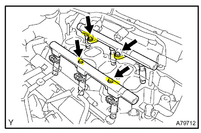

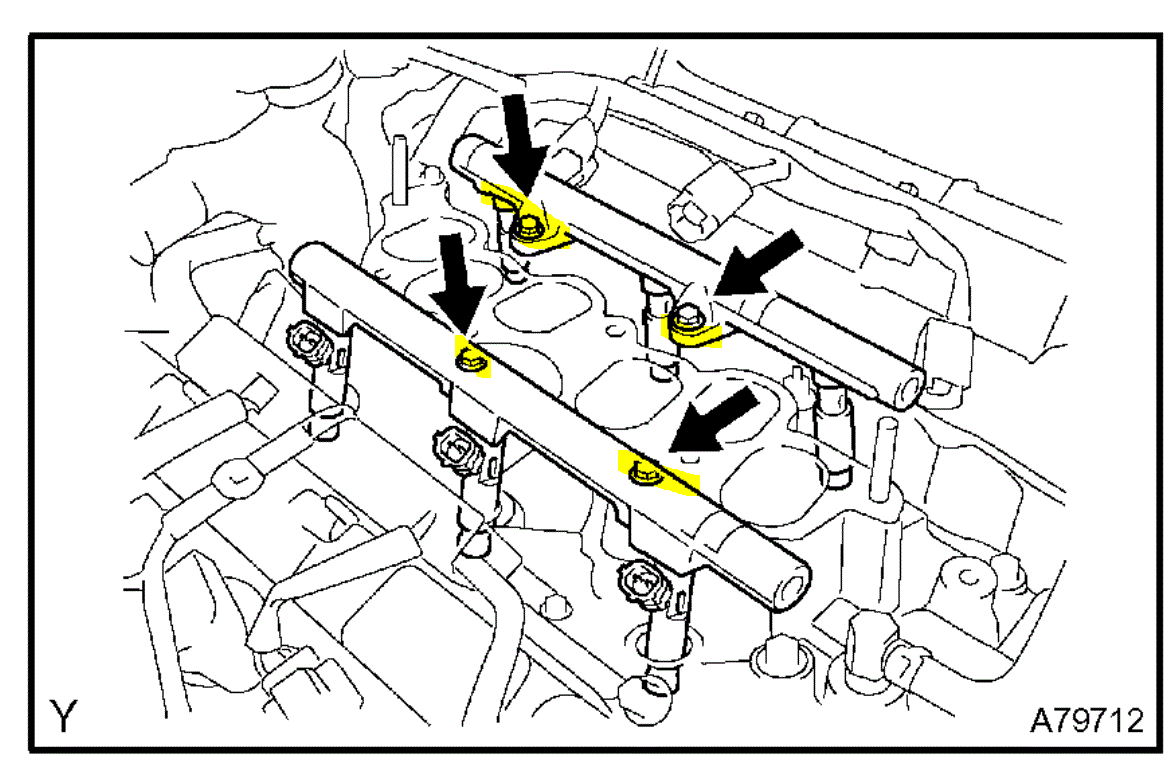

The injectors are under the intake, which I suspect you already know. There are 4 bolts that hold them in place. Are you able to see if the entire fuel rail is loose?
I attached a pic below showing the location of the mounting bolts.
See pic below.
Jun 16, 2021 at 11:49 AM
RUDYPAK
  • 42 POSTS
I have changed the coil packs, spark plugs, 2 knock sensors with the short harness. All 4 bolts are tight for the fuel rail.

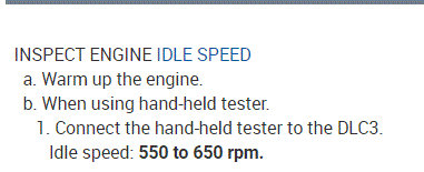

One more thing I just noticed. In the morning the idle even after it comes to temperature it's at about 800 RPMs and comes down slightly by the time I get to work, which is about 40 minutes later. In the afternoon when I leave work after it warms up it's as low as 550-600 RPMs. That's when I can notice the rough idle more and it hiccups. Meaning the rpm drops for a split second every once in a while. It never stalls but feels like it might. If I turn the A/C on it does it more often. Like it becomes worse under load.
Jun 16, 2021 at 12:18 PM
  • 110,244 POSTS
The idle is exactly where it should be. See pic below.

Removal (Sienna) Air intake chamber and intake manifold must be removed for access to knock sensors. Knock sensors are located on cylinder block, just below cylinder heads. See Fig. 3 -5. Remove caps, windshield wiper arm nuts and windshield wiper arms. Remove top seal from cowl top panel. See Fig. 12 . Remove cowl top panel cap. Remove clip and disconnect hose for each washer nozzle. Remove driver's side and passenger's side ventilation louvers. See Fig. 12 . Remove bolts from cowl top panel. Disconnect electrical connector for windshield wiper motor. Remove cowl top panel. Fig. 12: Locating Cowl Top Panel & Components (Sienna) Courtesy of TOYOTA MOTOR SALES, U.S.A., INC. Release fuel pressure. See FUEL SYSTEM PRESSURE RELEASE under FUEL SYSTEM. Drain cooling system. Remove air cleaner hose with air cleaner upper cap. See Fig. 13 . Remove "V" bank cover. Remove bolts and engine mount support brace for engine mount at timing belt end of engine. Engine mount support brace fits from top of coolant housing to the engine mount. Remove spark plug wire assembly. Disconnect control cables, electrical connectors, vacuum hoses and coolant hoses at throttle body. Disconnect electrical connectors and vacuum hoses from vacuum switching valves on emission control valve set located on side of air intake chamber. See Fig. 13 . Remove nuts and disconnect power steering pressure tube from engine hanger. Disconnect necessary electrical connectors, ground straps, air hoses and vacuum hoses for removal of air intake chamber and intake manifold. Disconnect PCV hose from PCV valve on rear cylinder head. Remove bolts, engine hanger and air intake chamber support brace from air intake chamber. Remove bolts/nuts, air intake chamber and gasket. Note location of electrical connectors on fuel injectors for installation reference. Disconnect electrical connectors at fuel injectors. Remove fuel inlet pipe-to-fuel filter union bolt with gaskets, and disconnect fuel inlet pipe from top of fuel filter. See Fig. 13 . Disconnect hose for air assist assembly at throttle body. Disconnect coolant hoses at intake manifold. Remove bolts/nuts and intake manifold with fuel injectors and fuel rails as an assembly. Remove gaskets for intake manifold. Disconnect electrical connectors and hoses for removal of coolant housing. Coolant housing is located on cylinder block, in front of intake manifold area. See Fig. 13 . Remove bolts/nuts, coolant housing and gaskets. Disconnect electrical connectors at knock sensors. Using Socket (SST 09817-16011), remove knock sensor(s) from cylinder block. Installation Install and tighten knock sensor(s) to specification. See TORQUE SPECIFICATIONS . To install remaining components, reverse removal procedure using NEW gaskets. Tighten bolts/nuts and fuel inlet pipe-to-fuel filter union bolt to specification. See TORQUE SPECIFICATIONS . Ensure intake manifold bolts/nuts are tightened to specification in sequence. See Fig. 8 . Ensure coolant housing bolts/nuts are retightened to specification once intake manifold is installed and bolts/nuts are tightened to specification. Fill cooling system. Install negative battery cable. Operate fuel pump and check for fuel leaks. See FUEL PUMP OPERATION under FUEL SYSTEM in appropriate BASIC TESTING article. Fig. 13: Exploded View Of Air Intake Chamber & Fuel Rail Components (Sienna)
