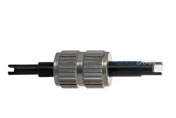

Hi Joe, pressure gage hose adapter won't thread on to fuel rail Shrader valve because the valve starts rotating in the end of the fuel rail. Is there a tiny open-end wrench for that Schrader valve? By the way, cylinder four dry compression: 90 PSI. Wet (4 squirts engine oil) compression: 126 PSI.
Jun 22, 2022 at 2:53 AM
  • 110,244 POSTS
The valve core in the fuel pressure port is similar to the valve core in a tire. There are tools made specifically for them. I attached a pic below, so you have an idea of what it looks like.
The compression is a concern. The idea that it is 90 dry sounds too low. Also, you went up 36 psi wet, so I suspect the compression rings are worn in that cylinder.

My Schrader valve rotation problem was solved with a thin 7mm open end wrench to hold it while I use a 1/2" open end wrench to screw the adapter onto the Schrader valve. Haven't tried this yet because the car was hot after getting 7 mm wrench. Cylinders 4 and 5 injector resistance was 12.7 ohms for both. I don't know yet if I have a valve core problem (referencing your picture).

Why do you mention the valve core? I can't screw the Ford adapter fitting on far enough to engage the two valve core pins (1 in the adapter and 1 in the fuel rail Schrader valve) and I'd like to know if my fuel pressure is leaking down.
Jun 22, 2022 at 1:52 PM
KUALUMNUS
  • 19 POSTS
I'm sure the valve core is tight because it's not leaking gasoline; just like a car tire would leak air with a loose valve core.
Jun 22, 2022 at 2:00 PM
  • 110,244 POSTS
I'm sorry. I thought that is what was loose. I was wondering how you were able to tighten it with an open-ended wrench. LOL
Are you sure the adapter is the correct one? That doesn't make sense unless the threads are damaged on one or the other.
