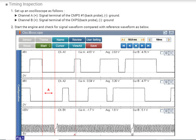

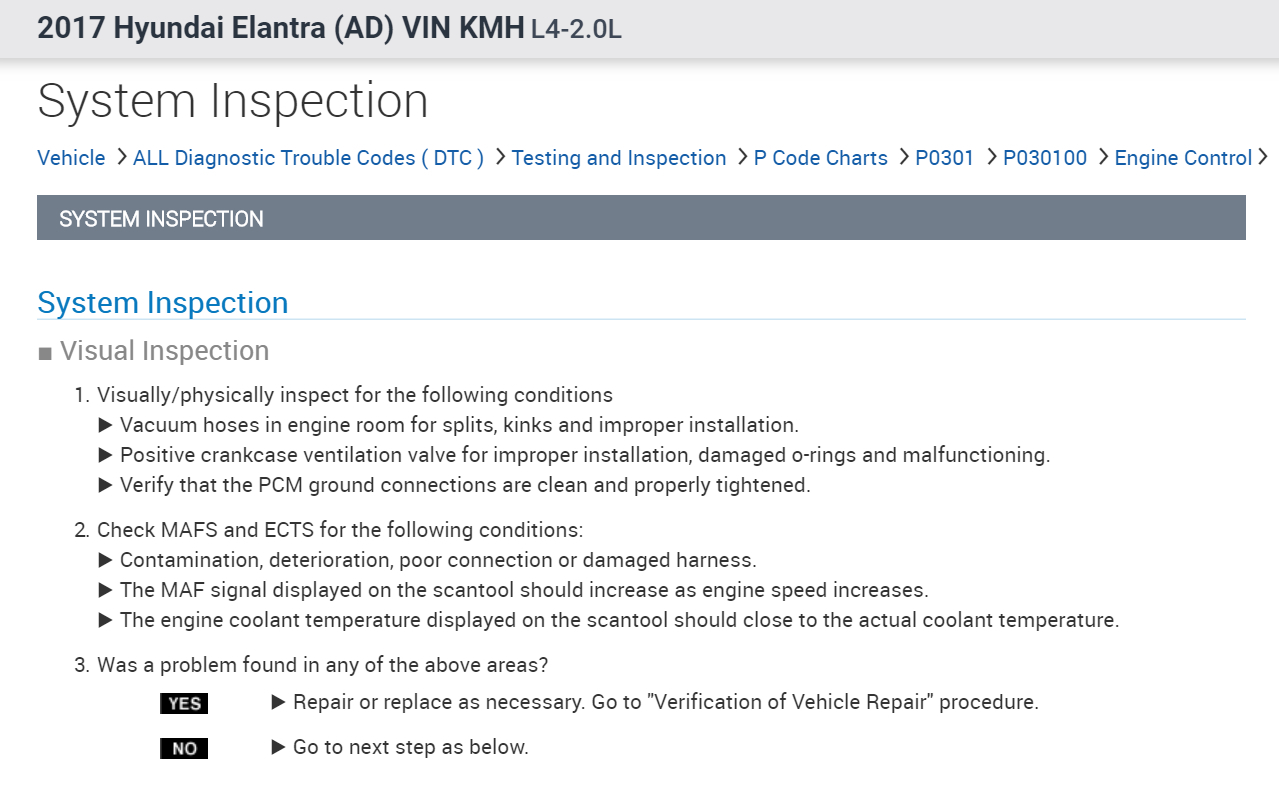

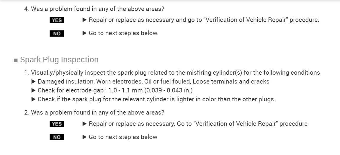

So a few days ago I had a check engine light come on in my car and the code was P0301. I was told to do a fuel system cleaner or fuel injector cleaner so I did that. Yesterday the light came back on briefly and then disappeared again there has been a sputter in the idle occasionally. So last night I change the spark plugs and now it’s running ten times worse. Any ideas of what to do from here? Or what did I do wrong yesterday?

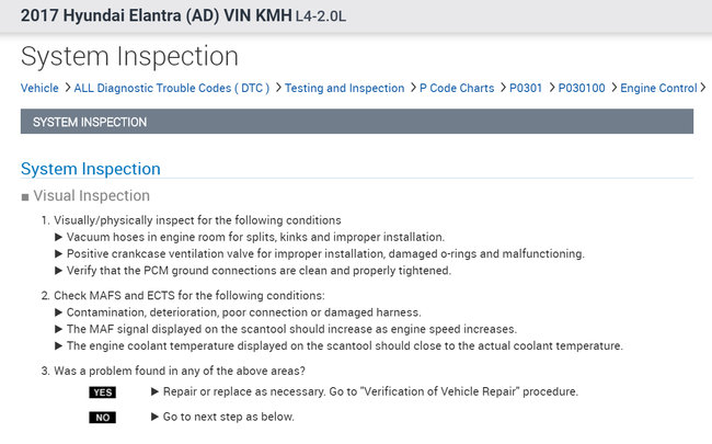

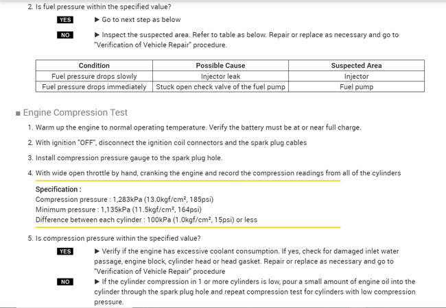

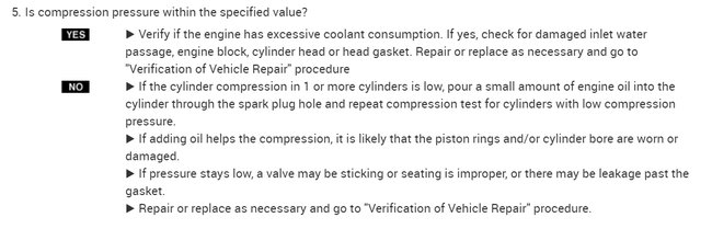

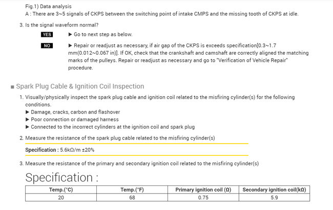

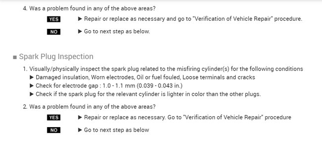

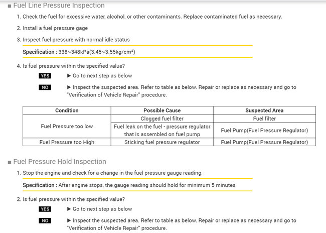

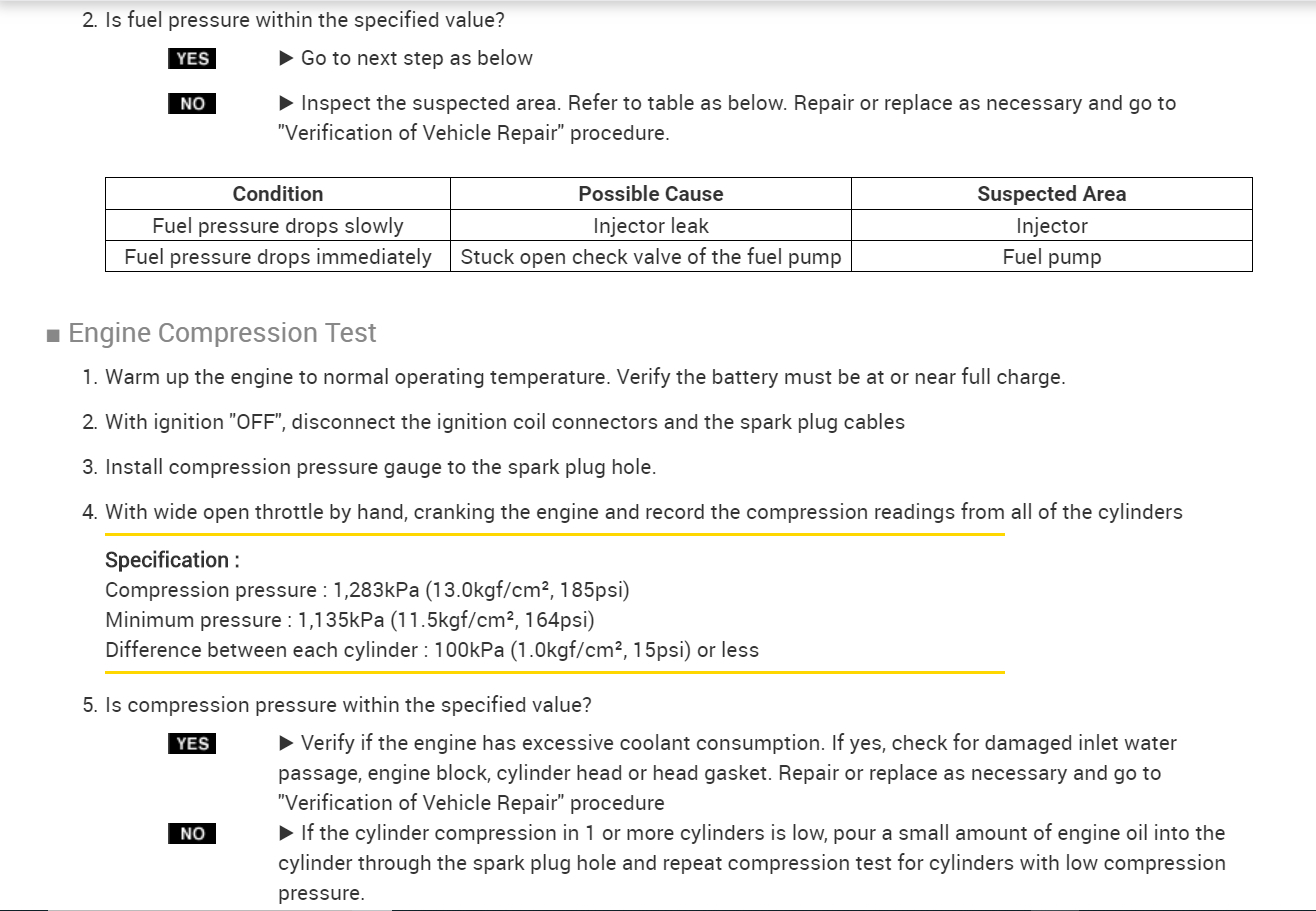

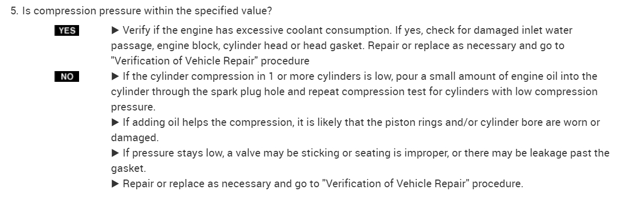

P0301 is an Automotive of Service Excellence (ASE) or "generic" Direct Trouble Code (DTC) for a misfire in cylinder #1. It can be caused by many things. In the diagrams down below I have included a inspection guide from the vehicle manufacturer for DTC P0301. Please go through this guide and get back to us with what you are able to find out.

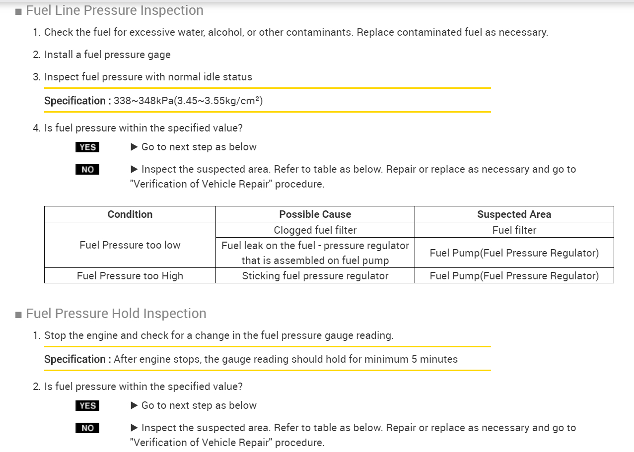

This guide can help as well:
