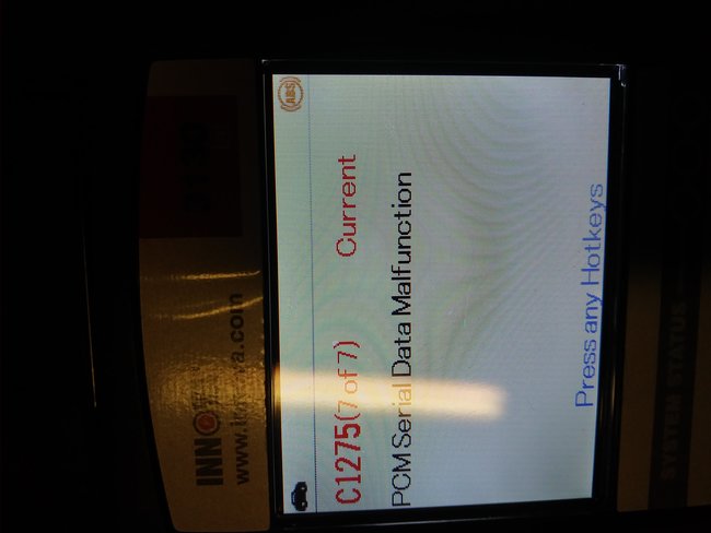

I figured out the issue. Bought a code reader, read through ABS system said PCM malfunction class 2 and lost communication to PCM. I think maybe the PCM got wet because we recently had snow. So I am going to take it out and put Dielectric grease in the connectors and dry the area and clean the grounds. If that doesn't work I most likely need another one either way.

JFIGUEROA2600
  • 10 POSTS
I cleared the codes and checked again. Code C1275 PCM serial data malfunction is the one that comes up.
Saturday, February 23rd, 2019 AT 7:57 AM
  • 52,797 POSTS

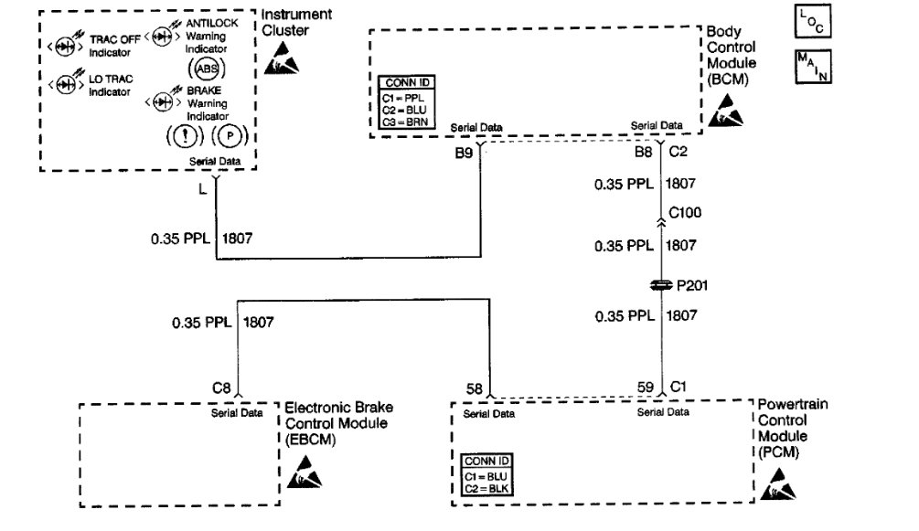

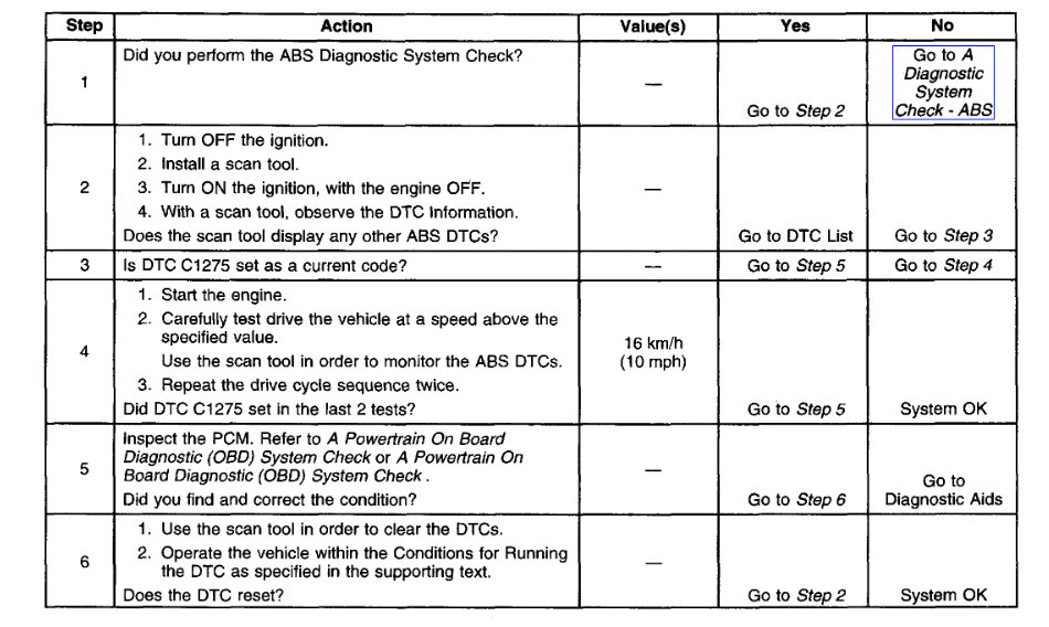

Thats not for the PCM. It is for the serial data line that talks to all the modules.
You should never have erased the codes. Thats does nothing and now we not information to diagnose.
Below is a description and attached is the wiring diagram and tests.
Circuit Description
The PCM monitors various parameters and will not allow ETS operation if any parameter falls outside a specified range.
Conditions for Running the DTC
The ignition is ON.
Conditions for Setting the DTC
A malfunction has been detected by the PCM which would inhibit ETS operation.
Action Taken When the DTC Sets
The EBCM disables the ETS for the duration of the ignition cycle.
The TRAC OFF indicator turns ON.
The ABS will remain functional.
Conditions for Clearing the DTC
The condition for setting the DTC is no longer present and the scan tool Clear DTCs function is used.
The EBCM automatically clears the history DTC when a current DTC is not detected in 100 consecutive drive cycles.
Diagnostic Aids
Thoroughly inspect the wiring and the connectors. An incomplete inspection of the wiring and the connectors may result in a misdiagnosis, causing a part replacement with the reappearance of the malfunction.
If an intermittent malfunction exists, refer to Testing for Intermittent and Poor Connections see Diagnostic Aids under Diagrams.

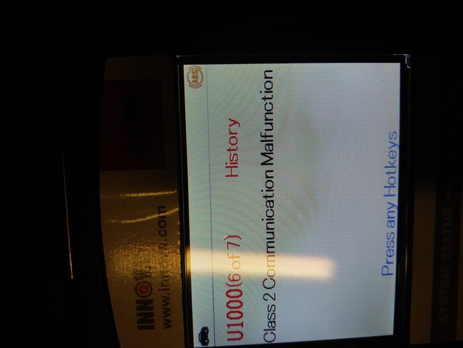

JFIGUEROA2600
  • 10 POSTS
I was able to get two out that is it.

  • 52,797 POSTS
Okay, The u1000 is below.
CIRCUIT DESCRIPTION
Modules connected to the class 2 serial data circuit monitor for serial data communications during normal vehicle operation. Operating information and commands are exchanged among the modules. When a module receives a message for a critical operating parameter, the module records the ID number of the module which sent the message for State of Health monitoring (Node Alive messages). A critical operating parameter is one which, when not received, requires that the module use a default value for that parameter. When a module does not associate an ID number with at least one critical parameter within about five seconds of beginning serial data communication, DTC U1OOO is set. When more than one critical parameter does not have an ID number associated with it, the DTC will only be reported once.
