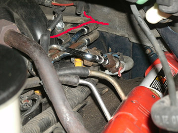

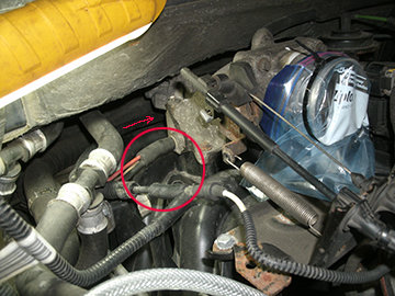

Roy, How are you on 2001 Ford Expedition vacuum line routing?
I have a disconnected hose and do not know where it plugs in.
Should be easy, but I just can't find it.
Let me know. I have enclosed a couple of photos just in case.
I think I have the white hose correct, It is the red one that I can't find a home for.
They both come out in a harness from the passenger side of the engine around back to the driver's side.
Wayne

  • 52,797 POSTS
OK, We are on a new vehicle.
Site rules are 1 vehicle per post.
Please start a new request and we will be glad to help you with this issue as well.
