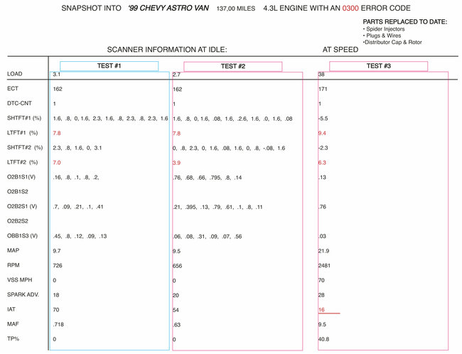

I have a P0300 code (random misfires).
I have replaced fuel injectors, plugs, wires, distributor cap and rotor.
I am attaching some information from my scanner in hopes someone out there can figure out what my next approach should be. I have a smoke machine on order to see if there are any vacuum leaks I can find.
The attached jpg file might be helpful.

Good evening,
What is the fuel pressure? Low fuel pressure is the most common cause for this code.
You have covered most of the basics. but the fuel pressure should have been the first check.
Did you do a compression test when you had the plugs out?

I am almost positive it was 65 lbs. I will pull the doghouse today and confirm. I have had no less than six fuel pumps replaced on my 1996 Astro! So I wouldn't doubt that it could have been the cause. I had to cut a hole in the floor of the truck to get faster access to the pump for replacement. Saved dropping the tank each time. The truck coughs and stumbles starting up from a stop until I give it more throttle! At higher speeds it runs fairly well until I let up on the throttle a bit, then it stumbles (misses). I hope the jpg with the fuel trim data helped. I will reply again once I pull the dog house and take another reading to the fuel pressure.

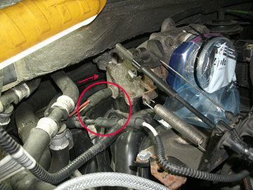

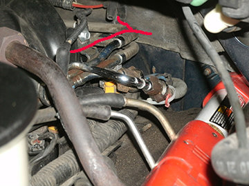

Roy, How are you on 2001 Ford Expedition vacuum line routing?
I have a disconnected hose and do not know where it plugs in.
Should be easy, but I just can't find it.
Let me know. I have enclosed a couple of photos just in case.
I think I have the white hose correct, It is the red one that I can't find a home for.
They both come out in a harness from the passenger side of the engine around back to the driver's side.
Wayne
Jan 25, 2019 at 1:59 PM
OK, We are on a new vehicle.
Site rules are 1 vehicle per post.
Please start a new request and we will be glad to help you with this issue as well.
