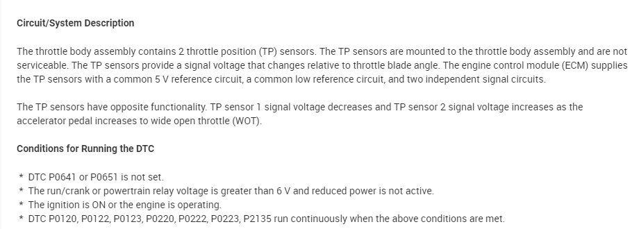

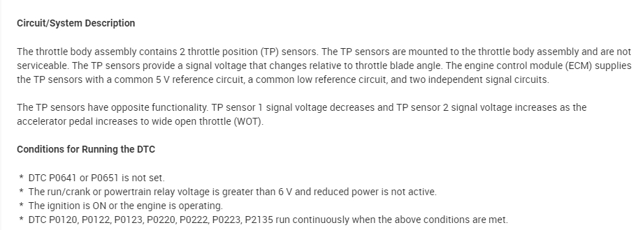

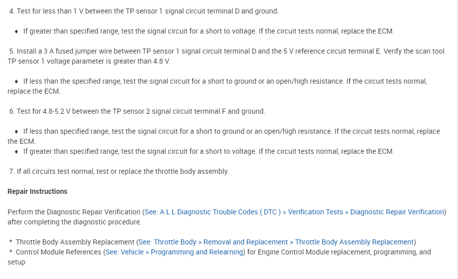

First I would clean the throttle body this guide will help

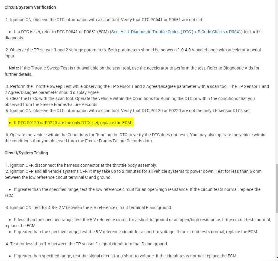

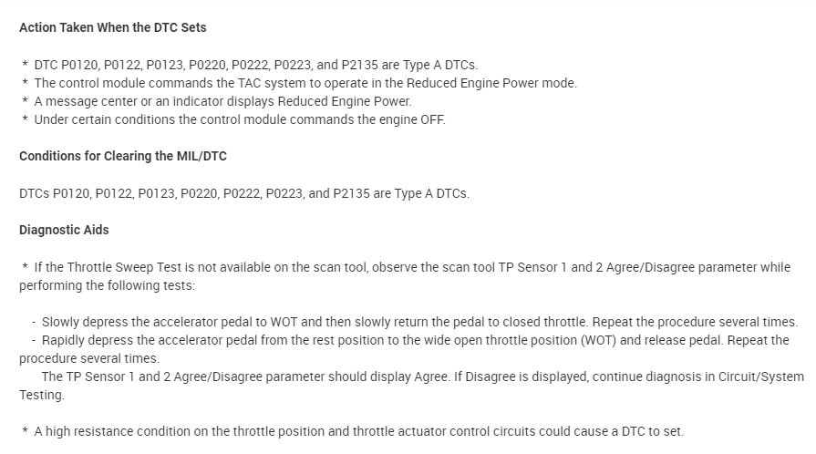

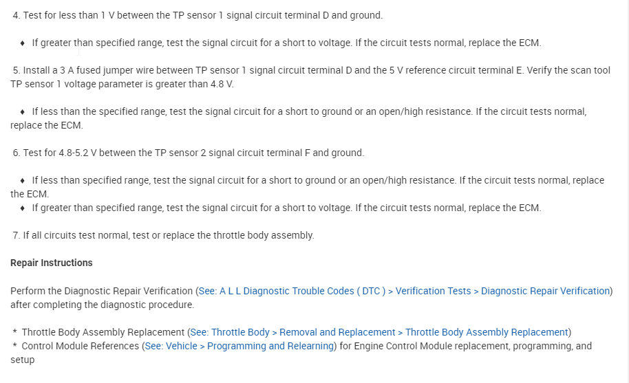

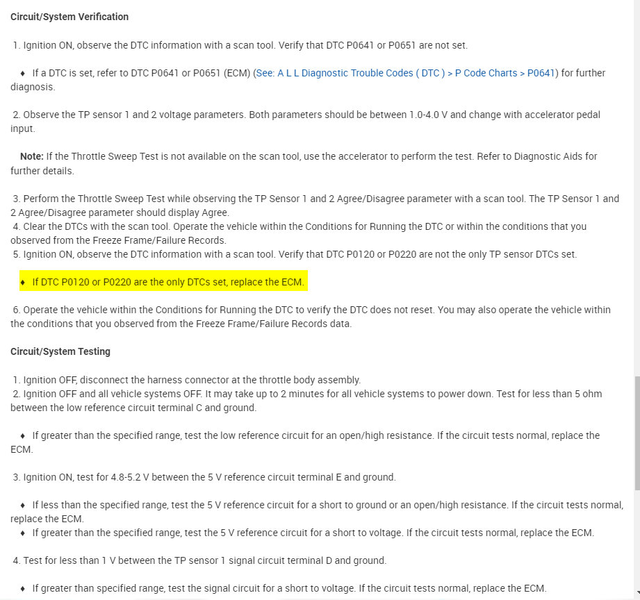

Normally these sensors are not tested with resistance. The reason is, we need to see what the voltage reading is according to the PCM. So the resistance readings could be different. In fact TPS 1 and 2 are exact opposites of each other so I would not expect the resistance on each circuit to be different.
However, there is a note in this manual that you need to pay attention too. If this is your only DTC then it says to replace the ECM.
However, this DTC is saying that there is a circuit issue. So more than likely you have a wiring issue or a circuit board issue. Clearly that may be answered for us if this is the only DTC.
Let me know what you find. Thanks

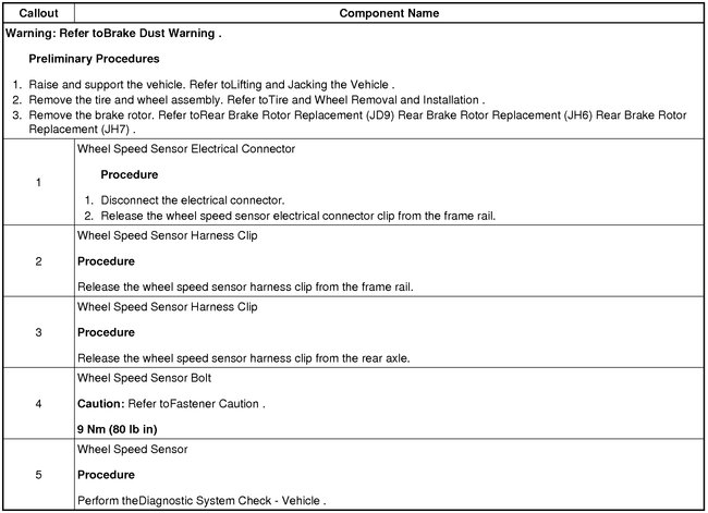

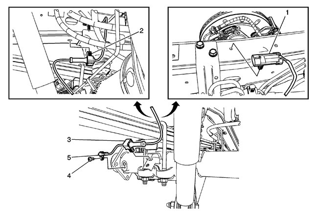

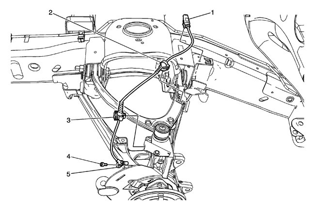

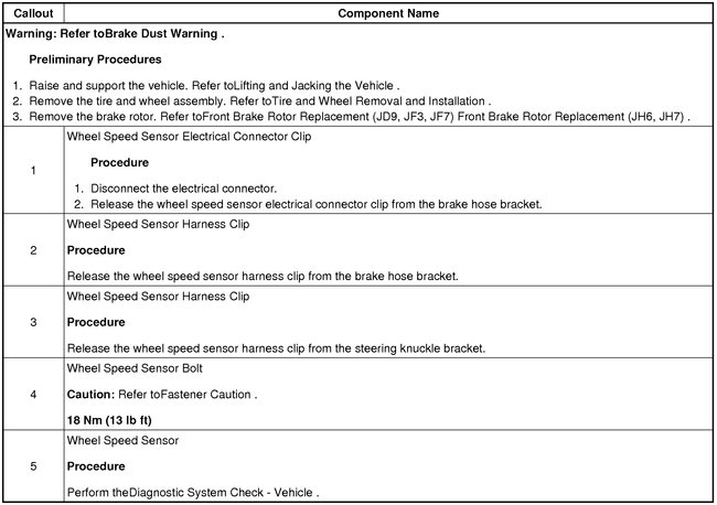

Next, most often, the light is triggered by a bad wheel speed sensor or even low brake fluid.
Here is a link that shows how to check wheel speed sensors:
https://www.2carpros.com/articles/abs-wheel-speed-sensor-test
I don't know if you need them, but here are a couple links that you may find helpful when checking the sensors:
__________________________________
If you find one of the sensors is bad, directions for front sensor replacement are listed in pictures 1 and 2
Pictures 3 and 4 are related to rear sensor replacement.
