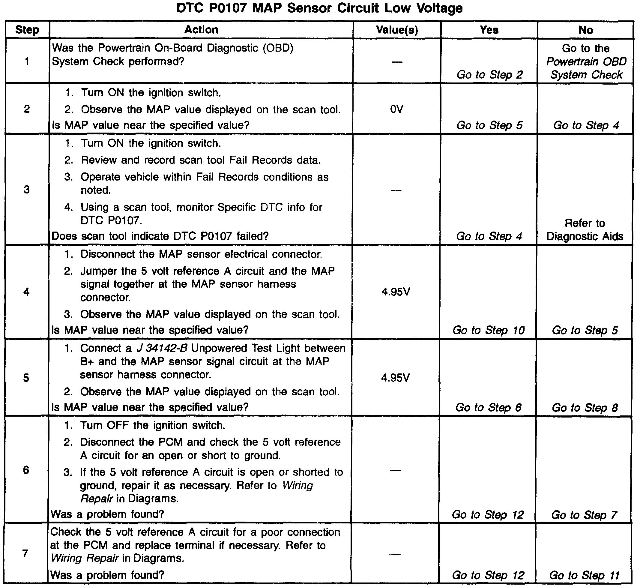

That code indicates low voltage to the manifold absolute pressure sensor (MAP). The first thing I would recommend is to check the plug to the sensor to make sure there isn't corrosion or a weak connection. Note: If you find the connection is the problem, it will take 40 warm up cycles for it to reset itself or you can use a scanner, clear the code, and see if it comes back.

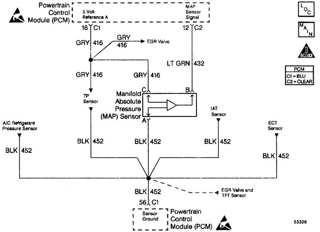

Here is a description of the circuit and how to check it. It will require a scanner that can read live data

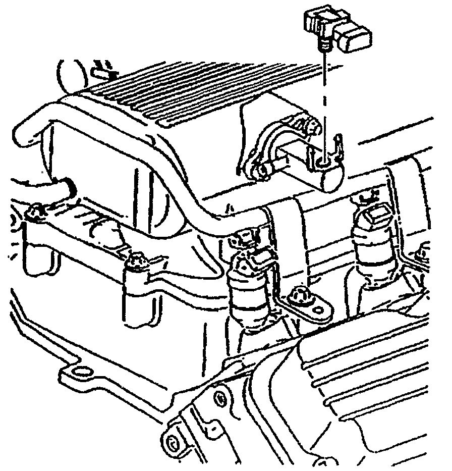

Next, on your vehicle, the manifold absolute pressure (MAP) sensor is mounted to the intake manifold vacuum source. See picture 4

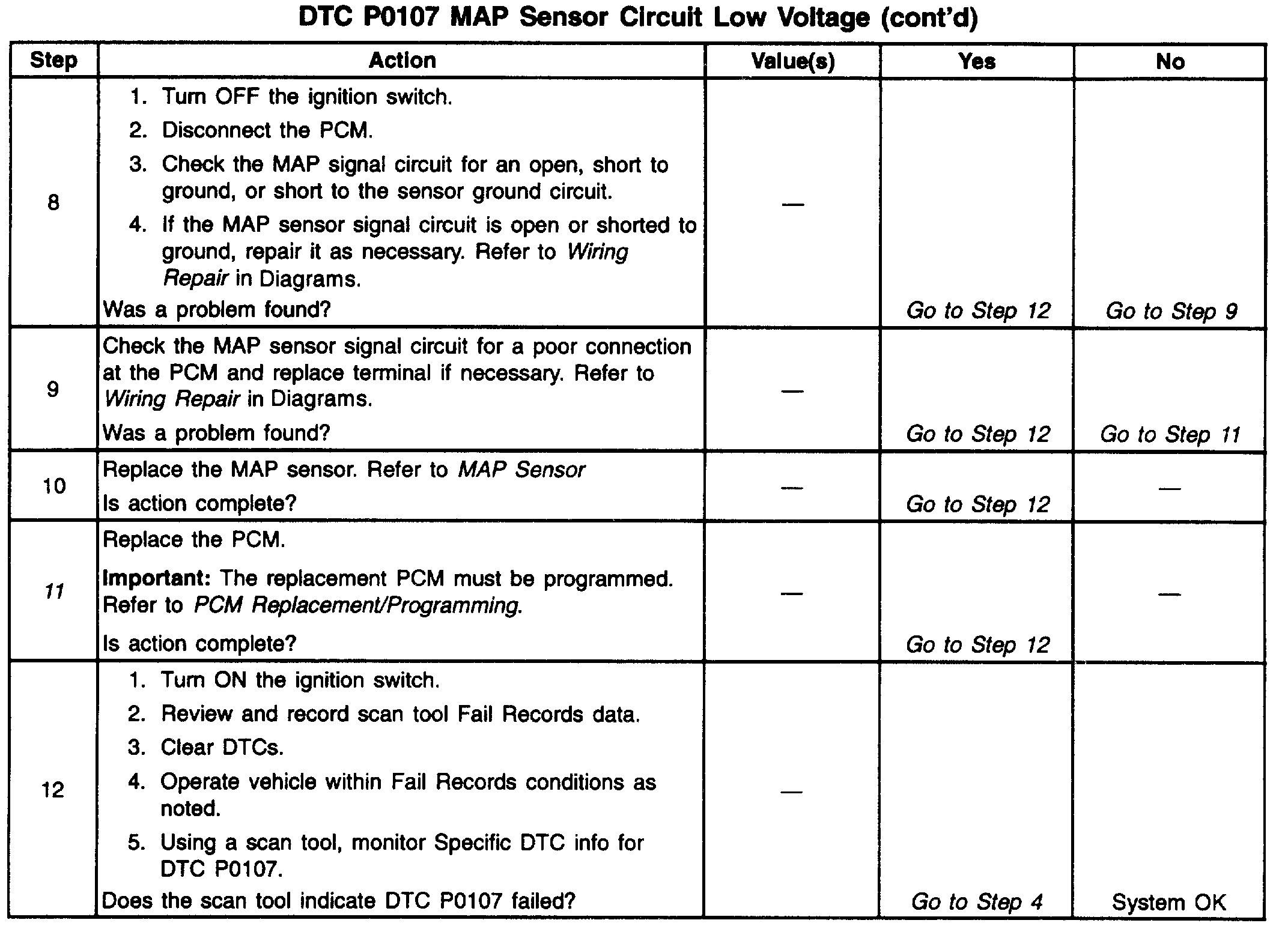

NOTE: Pictures 1-3 are a flow chart for diagnostic trouble shooting.

- Poor connection at the PCM. Inspect harness connectors for backed out terminals, improper mating, broken locks, improperly formed or damaged terminals, and poor terminal to wire connection.
- Damaged harness. Inspect the wiring harness for damage. If the harness appears to be OK, observe the MAP display on the scan tool while moving connectors and wiring harnesses related to the sensor. A change in the dIsplay will indicate the location of the fault.

Take a look at the pictures I attached above. They include a diagnostic flow chart related to the code you have.

Great. also, do you have any pictures of its location? It is a 3800 series engine.
Jan 20, 2019 at 11:28 AM
  • 110,251 POSTS
Hi:
Picture 4 listed above is its location. It is mounted to the intake manifold.
Let me know if this helps. I reattached the picture for you below.
Jan 20, 2019 at 11:39 AM
IGENIUS92
  • 205 POSTS
Helps a little. sorry to ask if there is a better picture?
Jan 20, 2019 at 11:52 AM
  • 110,251 POSTS
Not a problem. That's the only one I have. If you look on the inside portion of the valve cover, you should see it.

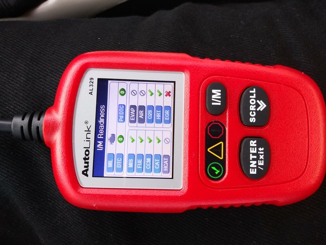

So here's the update: i cleared the code and ran the cycle no check engine light on during the cycle and no codes came up after i plugged the ob2 in. checked the ready test and my ob2 all have a check mark except the EGR ready light has an X mark not a green check mark like the other's. Is it ready for smog?
Jan 30, 2019 at 11:40 AM
  • 110,251 POSTS
That is all based on where you are located. I am in PA and we are permitted to inspect them with one system pending. If you were here, yes.
The fact that only one isn't reset, it may take a few more trips for it to ready. Hopefully, the problem is fixed and nothing will turn back on.
What to do is call the place you take it for emissions inspection. Ask if it will pass if all but one of the emissions systems has passed / is complete and one is still pending. See what they say.

So i drove it for over seventy five miles today and the EGR light still has an x mark on it.
Jan 31, 2019 at 9:12 PM
  • 110,251 POSTS
Can you upload the picture of what you are seeing on the scanner? I need to try to determine if it is pending or failed.
Thanks, Danny. Things are different here.
Let me know,
Feb 1, 2019 at 4:56 AM
IGENIUS92
  • 205 POSTS
Sure, here's a picture of the ready test on my obd2.
Feb 1, 2019 at 5:20 AM
  • 110,251 POSTS
I was hoping I could identify if it was complete or incomplete. I see your confusion.
Do me a favor, if you still have the manual for this scanner, see if it indicates what the X stands for on this scanner.
Feb 1, 2019 at 7:37 AM
IGENIUS92
  • 205 POSTS
The X states that it's not ready it says basically.
Feb 1, 2019 at 12:25 PM

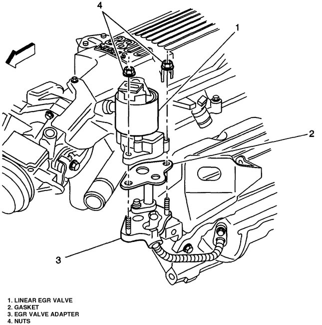

What should i do now? Replace the EGR? Is there a picture or diagram of where the EGR sensor is? Maybe i can just clean it.
It is a 1997 Camaro v6 3800 series engine 5 speed.
Feb 1, 2019 at 12:27 PM
  • 110,251 POSTS
Okay, if it isn't ready, that means the vehicle needs to be driven more (incomplete). The cycle hasn't completed. As far as the EGR, it's on the intake. I attached a picture of it.
