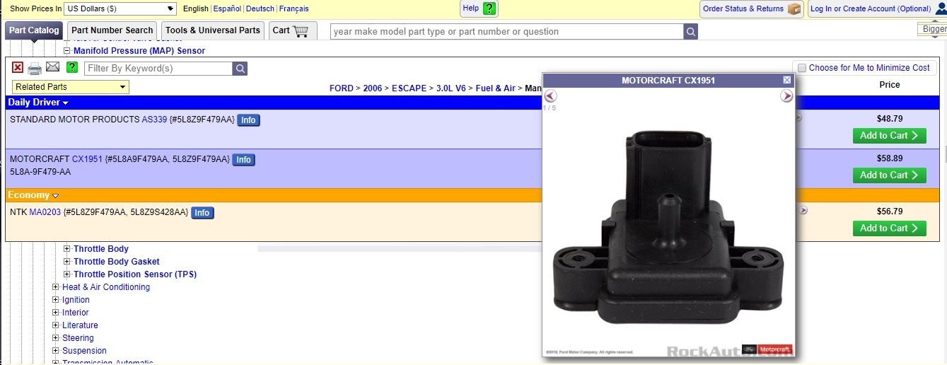

I have ordered two replacement parts and they did not fit. Can someone help with the exact replacement part number? Also, is this an easy fix I can do myself? Thank you!

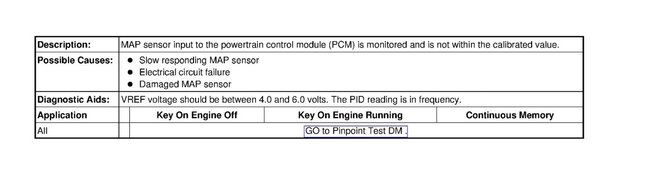

This code could be the MAP sensor but needs to be confirmed. You need to verify voltage to the sensor and the sensor operation. Make sure the vacuum line is attached and has vacuum at idle.
I attached a picture of the part from rock auto.

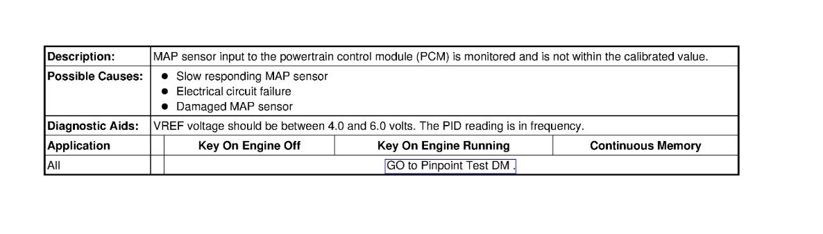

I also attached a flow chart for you to follow. If you have a scan tool, that would make it easier.
P0106
Descriptor
Probable Causes
Electrical Circuit Failure
Manifold Absolute Pressure (MAP) Sensor Damaged
Manifold Absolute Pressure (MAP) Sensor Slow Responding
Flow chart for 106.
DM15 DTC P0106: MAP RANGE/PERFORMANCE
Note:If MAP DTC(s) P0107, P0108 or P0109 are present, diagnose those DTC(s) first. If any mass air flow (MAF) sensor related DTCs are present, diagnose those DTCs prior to diagnosing MAP DTC P0106. Disregard any DTC(s) generated as a result of this test.

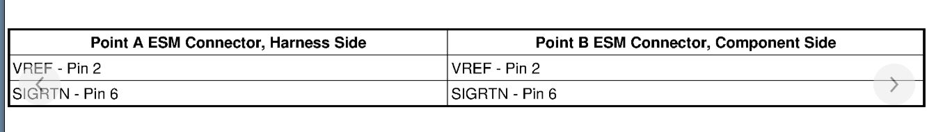

- Key in OFF position.
- ESM connector disconnected.
- Connect a 5 amp fused jumper wire between the following:
- Key ON, engine running.
- Measure the voltage between:
Is the voltage between 1 - 2 V?
- GO to DM19.
- GO to DM16.
