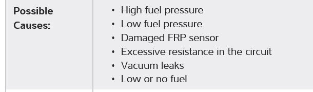

Hello all, please i have similar problem but in different form. I bought my car last year at 107km miles, but presently with 120km miles. Recently i was declining from hill when i suddenly lose power on my accelerator and "check engine sign" showed in yellow on my dashboard with oil an battery indicator in Red. I put of the ignition and restart, to drive it home, but the check engine sign remain on the dashboard. After diagnostic scan code P0191 Fuel rail pressure sensor circuit/performance was shown and it was changes. After one week of using, it came up while was on highway at 120km. I was able to manage it back to the mechanic. and a routine service was carried on it. He advice i drive it for a complete cycle to see it will happen again. 3 days after, its occur again (i.e the engine lose power, that accelerator was ineffective and check engine sign came up) while my wife was driving BUT this time when she put it off and re-start the engine, lo there was no check engine sign again. But has anyone experience such issues on his SUV either tribute or Mazda of same model. what did you change apart from Fuel Rail Pressure Sensor? It happens again on Saturday, the check engine sign came up and engine short-off. Several attempt to restart was going of intermittently. I had to let it rest some few minute before its start. I drove it again to my mechanic and this time we planned to check fuel pump and filter. Has anyone experience this issue before? thanks for feedback.

see pic for most common causes , but this may be more in the fuel pressure range being low so check pressure with a gauge auto parts rent it see link. or have your mechanic do it. but its pretty easy.
https://www.2carpros.com/articles/how-to-check-fuel-system-pressure-and-regulator see pic on causes as well pic will be in another answer
Mar 19, 2017 at 11:51 PM
HMAC300
  • 48,601 POSTS
here is pic
Mar 19, 2017 at 11:53 PM

Hello, We have checked with my mechanic as i didnt have a gauge to test the pump pressure but he said it was my pump that need to be changed and fuel filter. Another person said its the accelerator pedal and throttle unit which is ridiculously expensive. We haven't open the fuel pump unit yet.

it comes down to whom are you going to believe your mechanic or another person. low fuel pressure will cause your problem.if yo have ever run the car out of fuel then i'd go with the pump because the pump gets it lube from the fuel.

I took it to my a mechanic and the fuel pump, fuel filter And air filter was change. From observation, all of it look rusty and the filter on the fuel pump is seriously clogged with brownish particle that may seal when the vehicle tank is pressurized.

Yes, It does solve the problem. But right now i am experiencing the same issue. this is after i fix the problem in march 2017 and now in Nov 2018, i am having the same issue. I will get a new pump and fix again.
I feel i might have cause this one because sometime i run my engine even when i see my fuel tank showing reserve sign.
Nov 14, 2018 at 5:24 PM
BMDOUBLE
  • 1,139 POSTS
If it starts to eat fuel pumps, drop the tank and clean thoroughly, otherwise it will never run right.
