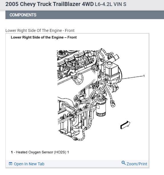

Not sure how many oxygen sensors my truck has.

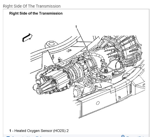

This is an inline six cylinder. This truck only has two. One upstream and one downstream.
Jun 28, 2021 at 1:02 PM
SQM
  • 6,383 POSTS
This vehicle has 2 oxygen sensors.
One located on the exhaust manifold (upstream), and the second one is located after the catalytic converter on the exhaust pipe (downstream).

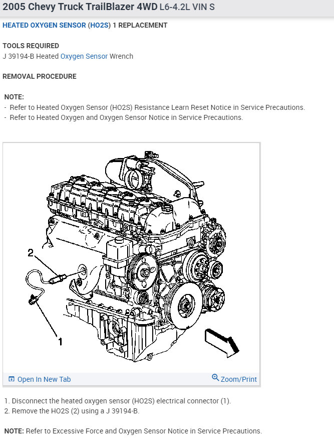

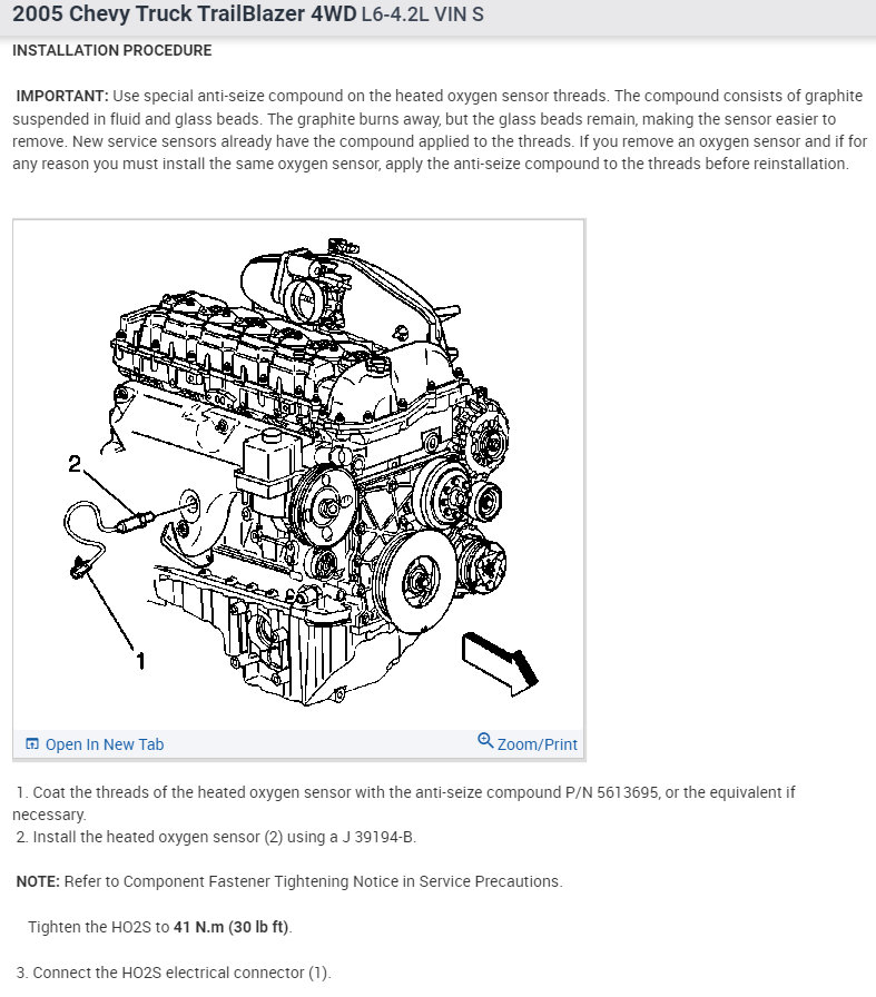

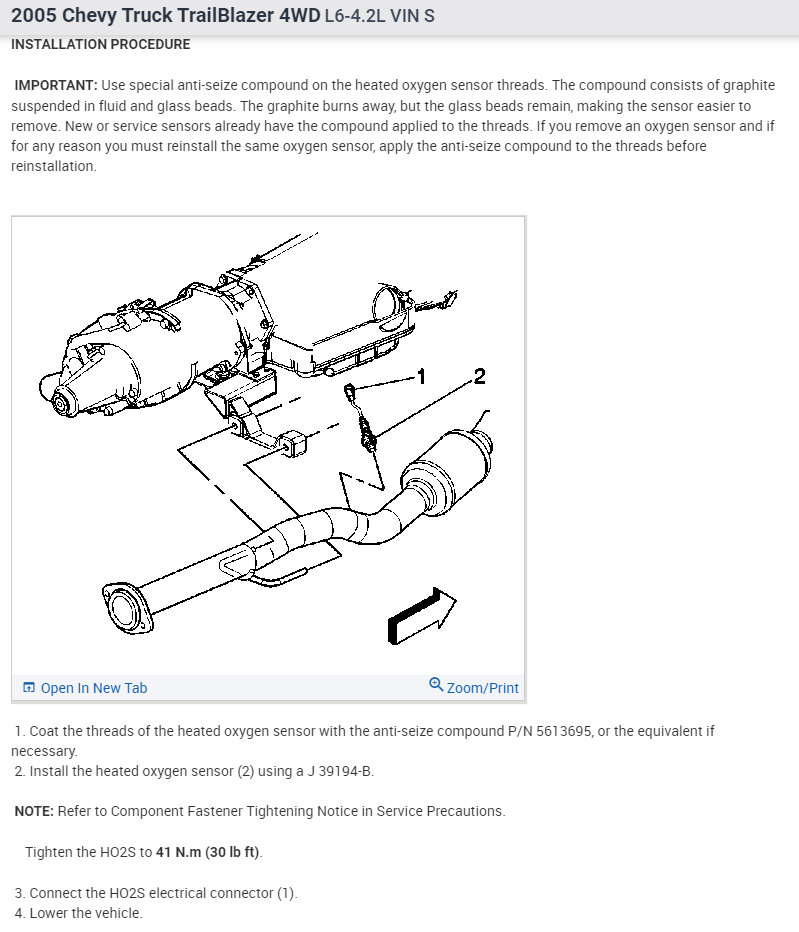

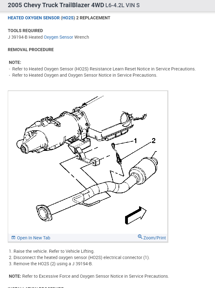

Here is a helpful guide on replacing oxygen sensors:
https://www.2carpros.com/articles/how-to-replace-an-oxygen-sensor
I have attached diagrams as well as replacement procedures for both of the sensors below.
