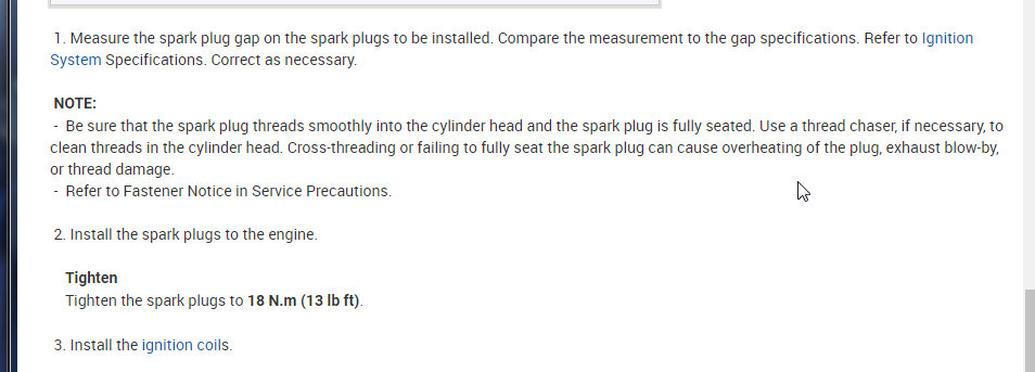

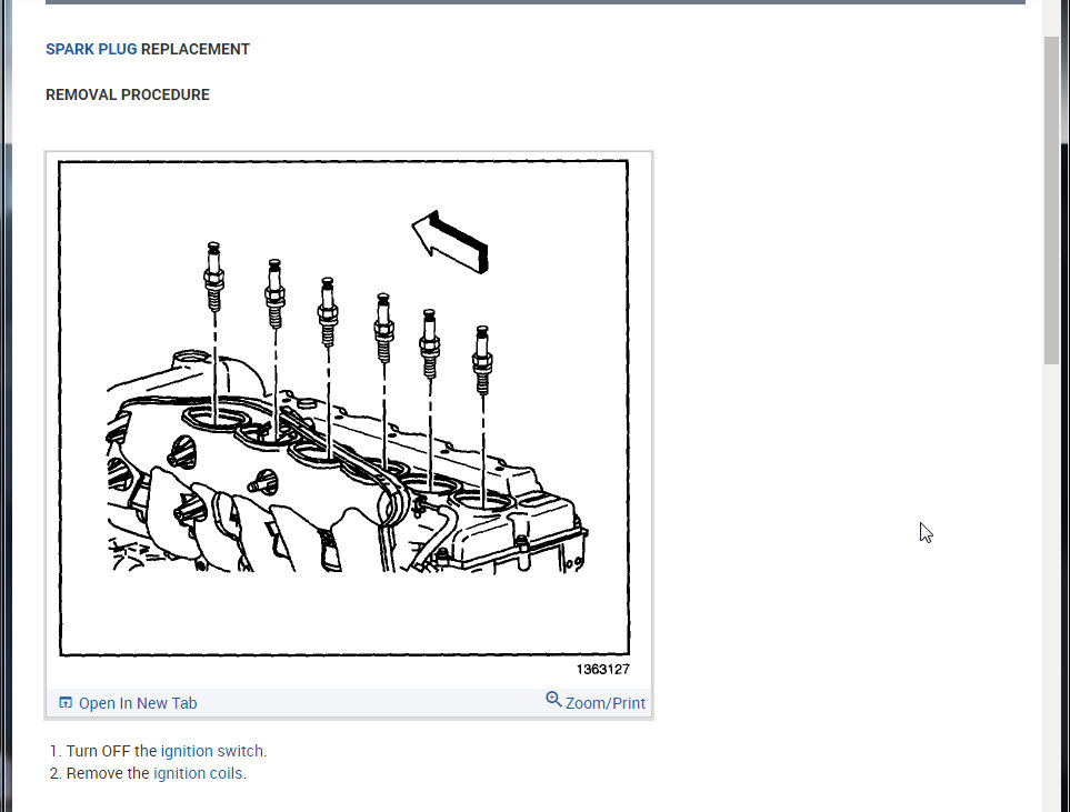

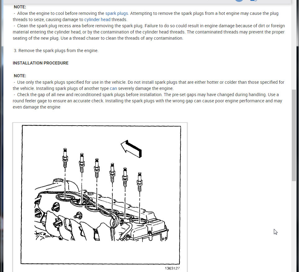

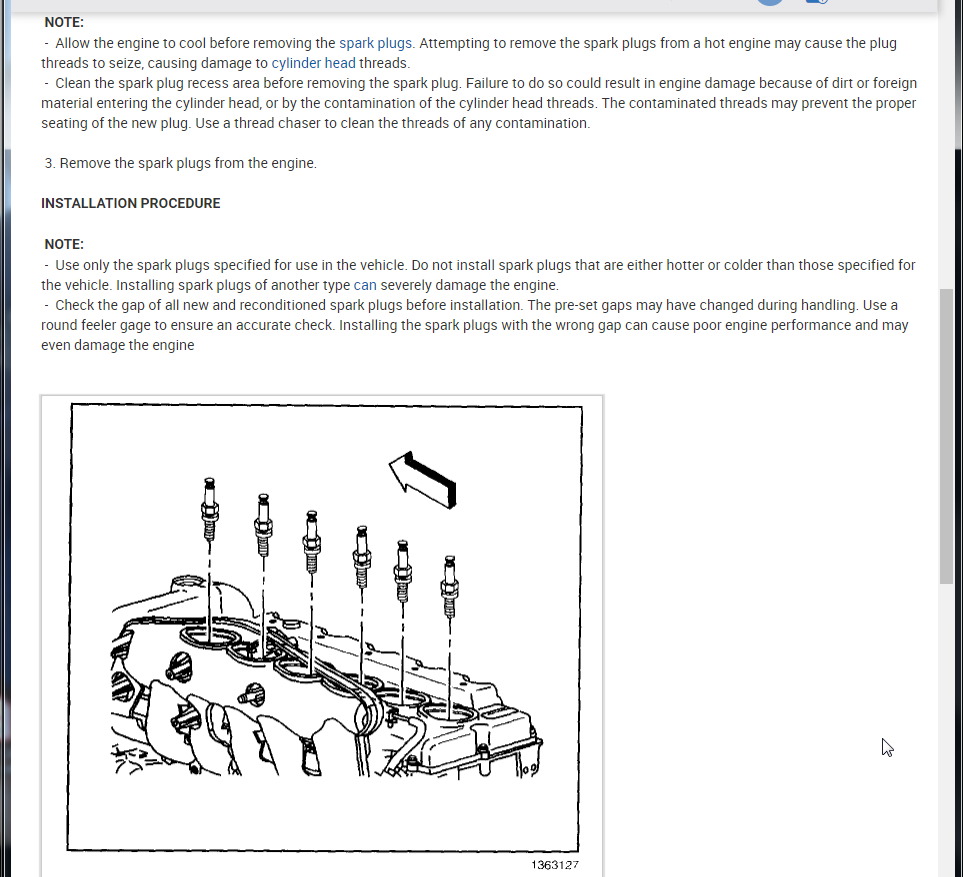

I want to do a tune up can you please help me?
Nov 19, 2008 at 8:42 PM
Sure can. Here is a guide on how to do this:
https://www.2carpros.com/articles/how-to-tune-up-a-car-engine
Also, I attached the process below on how to replace this from the manual.
Let us know if you have other questions or would like to replace some other components with this. Thanks
