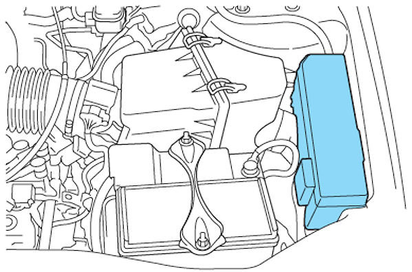

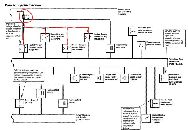

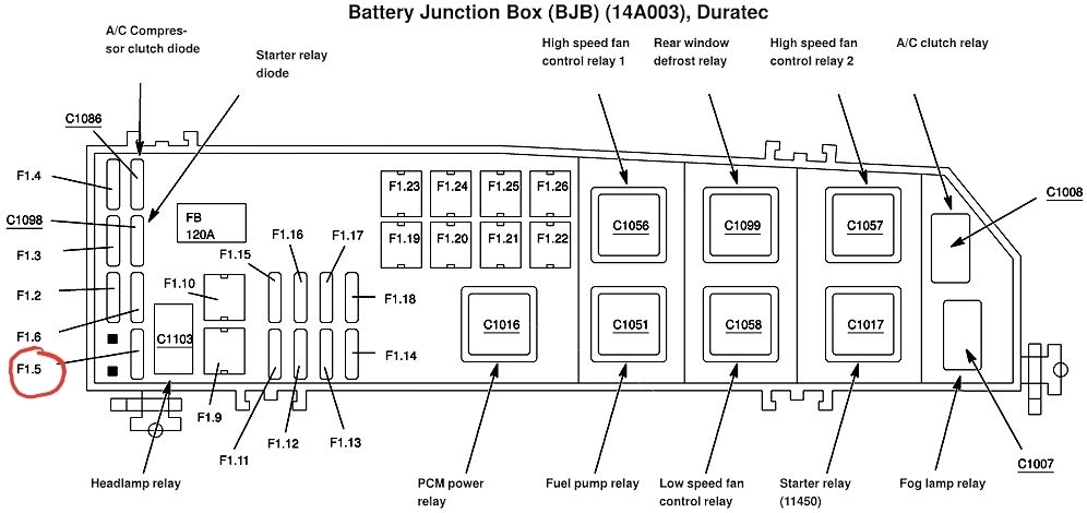

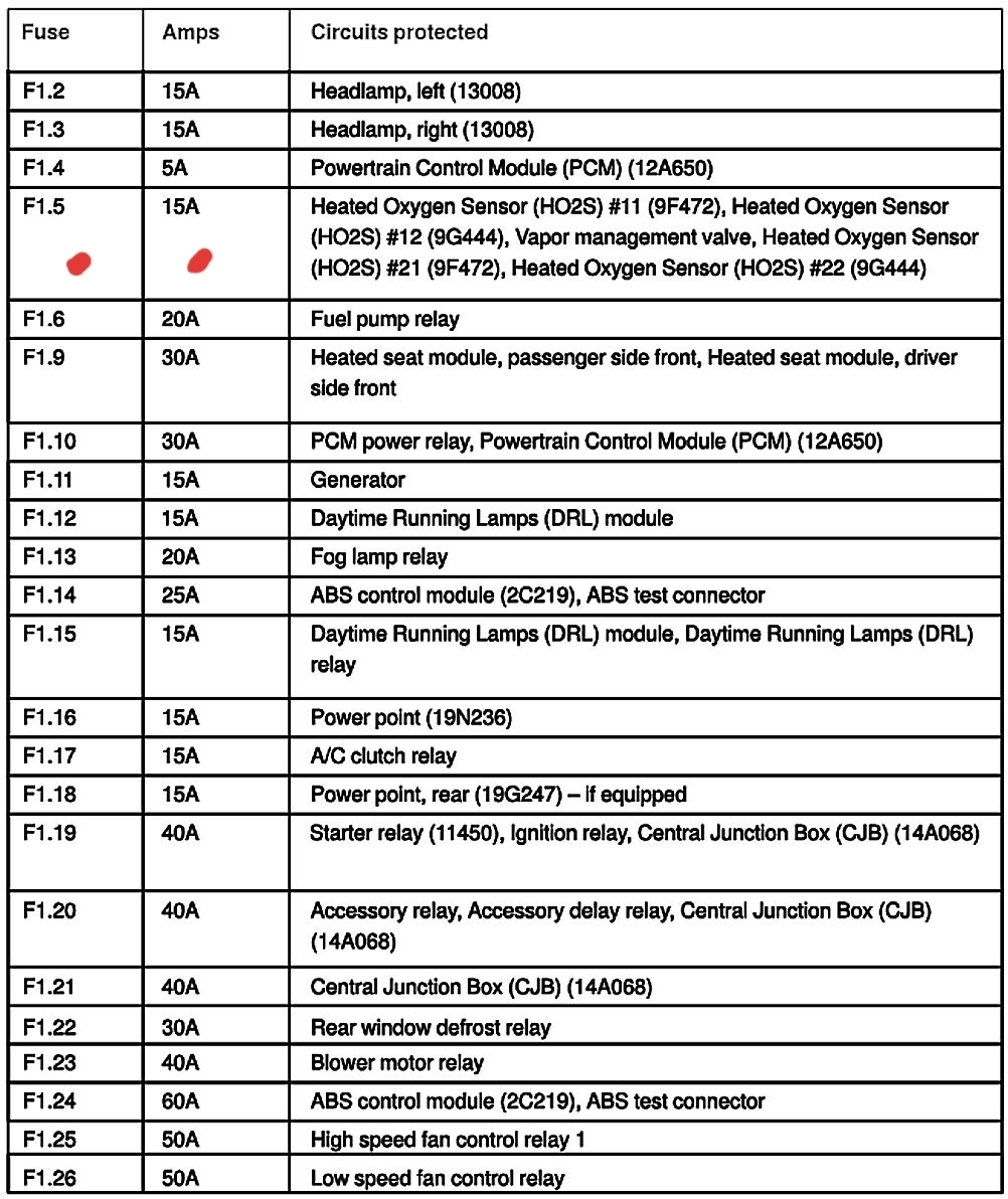

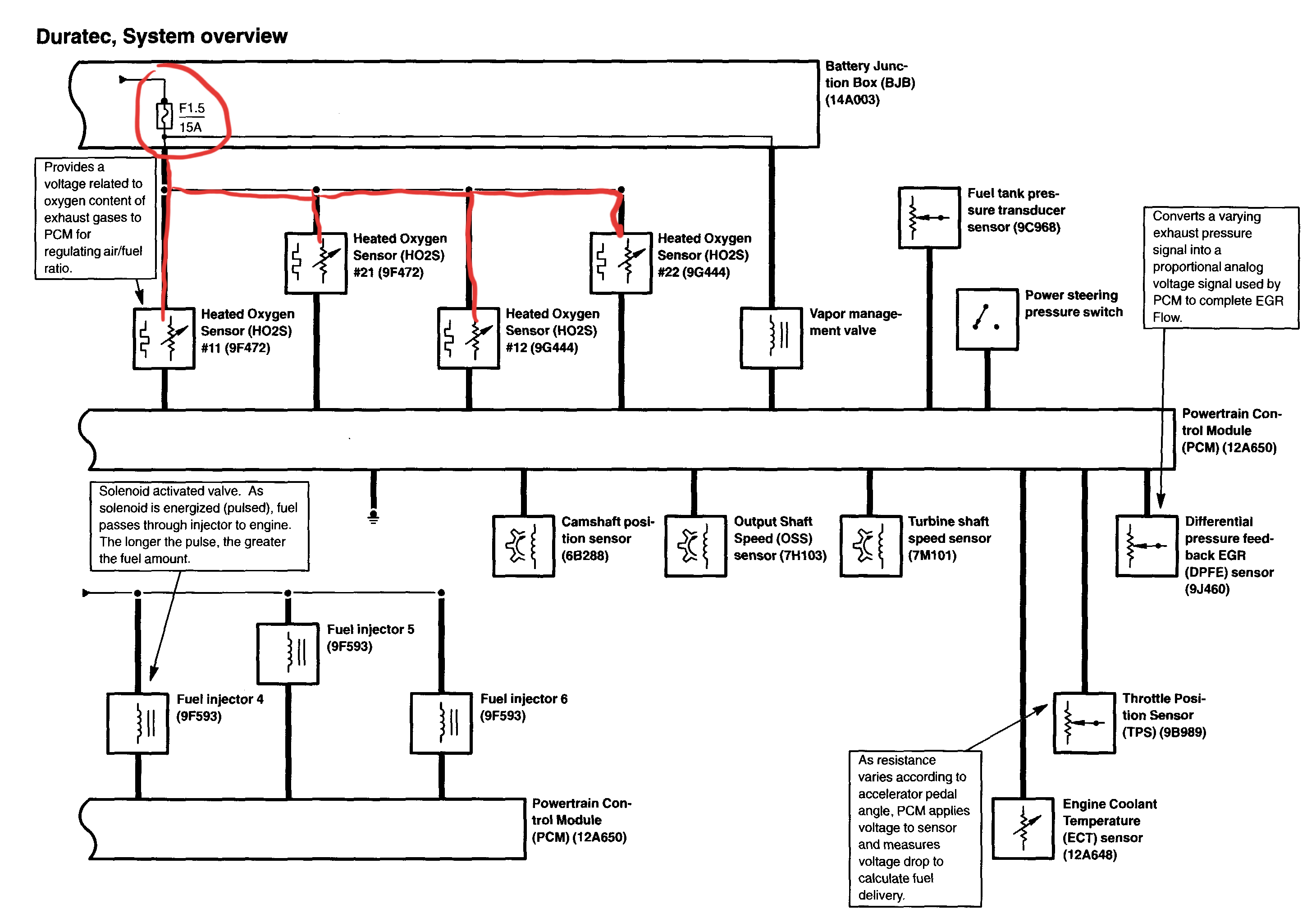

There should be 4 sensors. The first thing you should do is check your fuse #5 in the engine compartment. It is a 15 amp fuse that supplies power to all 4 sensor. See images below. Let us know how the fuse is. Replace it if it looks questionable and reset the codes and also verify you have power going through the fuse.

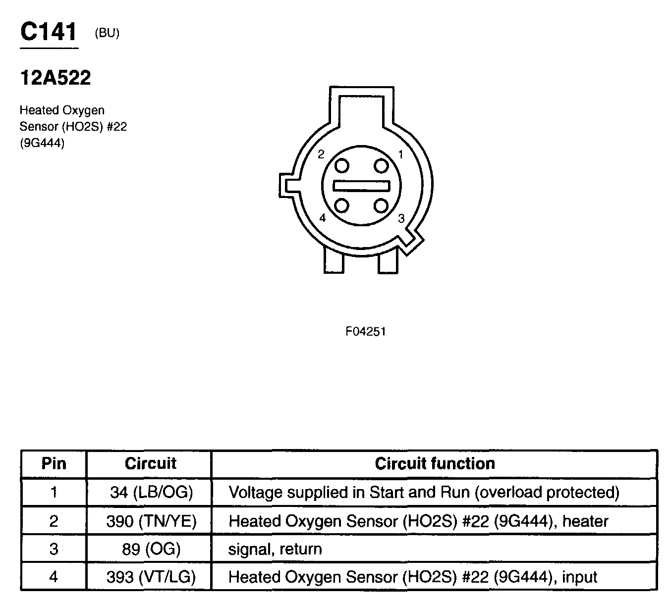

First verify you have 12 volts to all the heater circuits on pin #1 on all 4 connectors. The wire color should be light blue with an orange strip. All 4 connectors will have that one power wire. Measure the voltages and let us know what you get.
