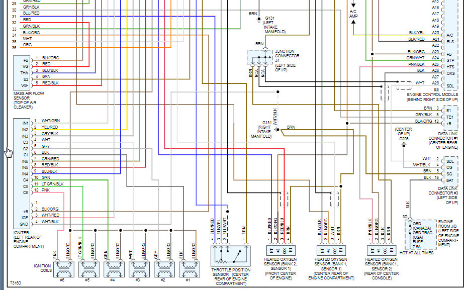

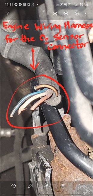

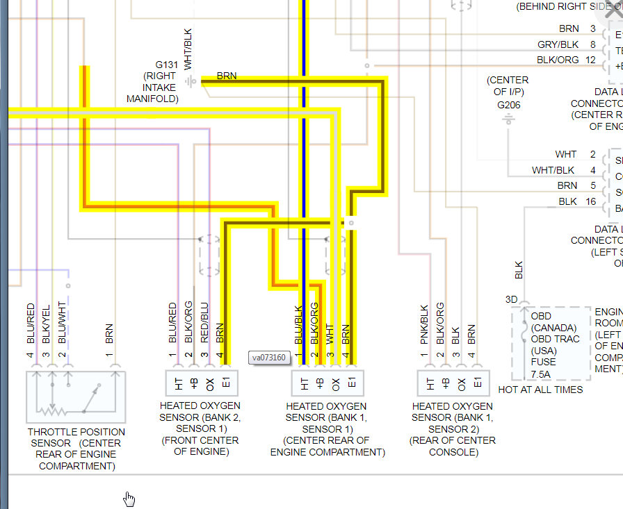

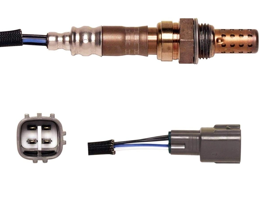

I need to replace the engine wiring harness connector (female) that connects to the Oxygen sensor connector (male). It has 4 color coded wires. When connecting those 4 color coded engine wiring harness into the oxygen sensor connector, does it matter where each color wire goes in which terminal? If it does matter, can you please supply a diagram or describe where each color wire specifically goes into which terminal? Thanks!
Jul 11, 2020 at 1:16 AM

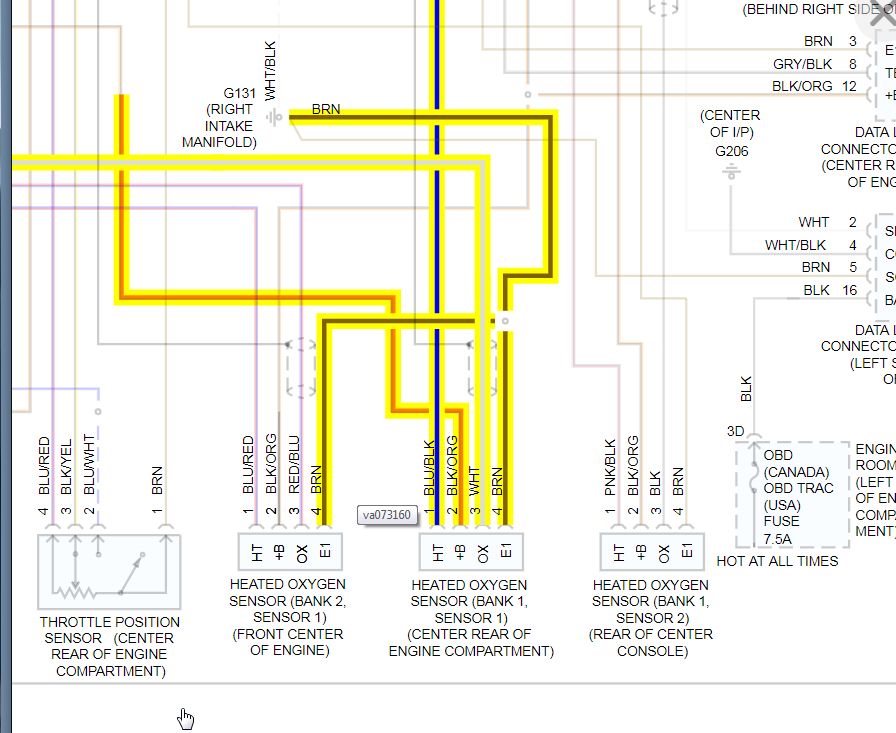

Yes. It does matter which wires these are connected to. I attached the wiring diagram for each wire. You will see the label of each wire on the sensor. With your wire colors it appears you are doing the Bank 1 sensor 1 o2 sensor.
Take a look at this and let me know if you have more questions. Thanks.

Yes, it is for the Bank 1 Sensor 1. Does it matter if the gauge is different of the wires that I plan to splice to the existing wires shown in the picture I attached or do they have to be the same exact gauge?
I appreciate so much for the diagram you attached. It was very helpful. Is there a website where one can find this diagram including many other diagrams for this car?.Thank you!
Apr 6, 2021 at 4:58 AM
It should be the same but you will be fine if the wiring is larger rather then smaller. The smaller the wire, the higher the resistance due to the lesser ability to all current to flow and it could cause the wire to overheat.

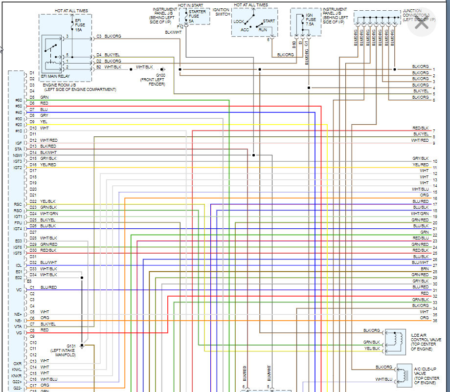

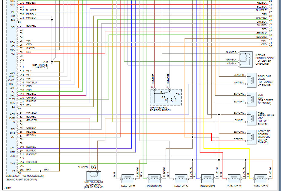

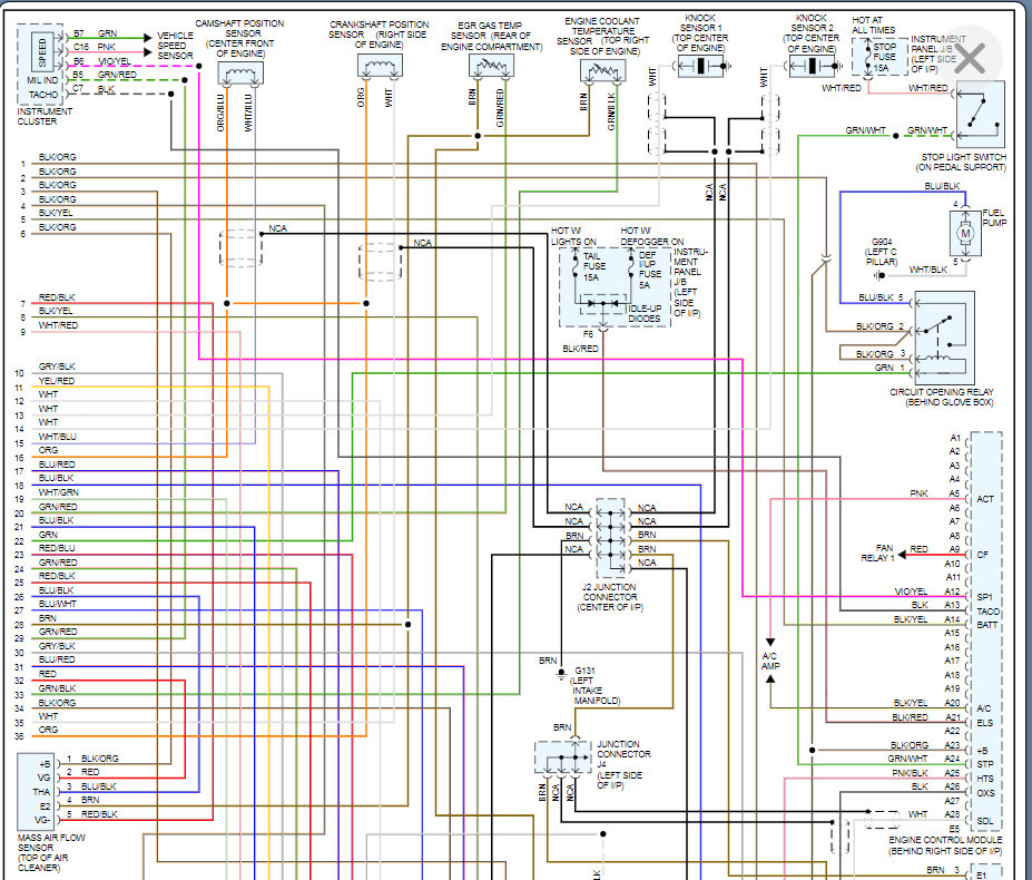

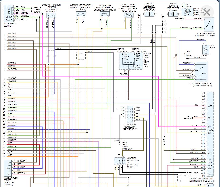

Can you please provide a wiring diagram for the fuel injectors and ignition coils? The ground wires for those are connected to the ECM. I need to trace those wires all the way to the ECM. So, If there is a diagram that shows where each color coded ground wire is connected into which terminal of the ECM, it would be greatly appreciated. Also, where do the power wires for the fuel injectors and ignition coils connect to? It doesn't appear to be to the ECM.
I also need to do a DYI wheel alignment. Can you please provide the specs? It would be very helpful if it was in inches, particularly for the toe specs. Besides a toe alignment, does this car require a camber and caster alignment as well? Do the rear wheels need any type of alignment, including toe or is it just a front end alignment that's needed? Thank you!
I attached the complete wiring diagram for the power-train. It will contain everything you are looking for.

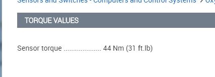

Can you please provide the torque specs for all the oxygen sensors of this car?
Bank 1 Sensor 1
Bank 1 Sensor 2
Bank 2 Sensor 1
Thank you!
Cheers!
Looks like they are 31 foot pounds. Let us know if you need more info. Thanks

How do I determine which terminals of an oxygen sensor represent HT, +B, OX, E1?
Please refer to diagram.
Thank you!

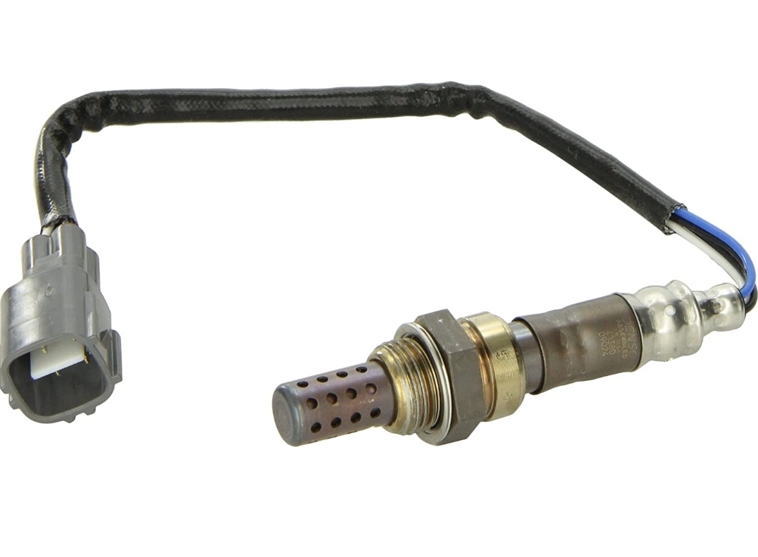

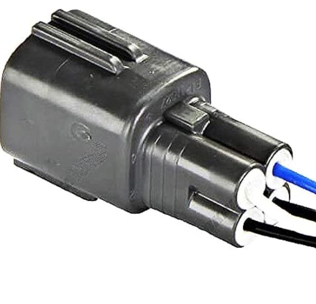

My oxygen sensor has 4 wires, 2 black, 1 white, and 1 blue. How do I determine which wire represents the terminal of HT, +B, OX, E1?
Attached is a picture of the oxygen sensor including a picture of the wiring diagram.
