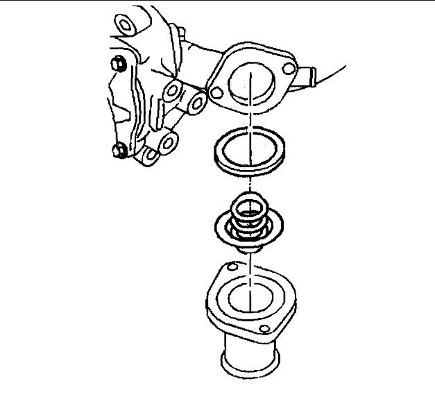

It is possible the thermostat is bad causing it to run hot. It will also expel coolant out the tank.
I would start by replacing the thermostat.
Do the cooling fans work?
Removal Procedure
1. Drain the cooling system.

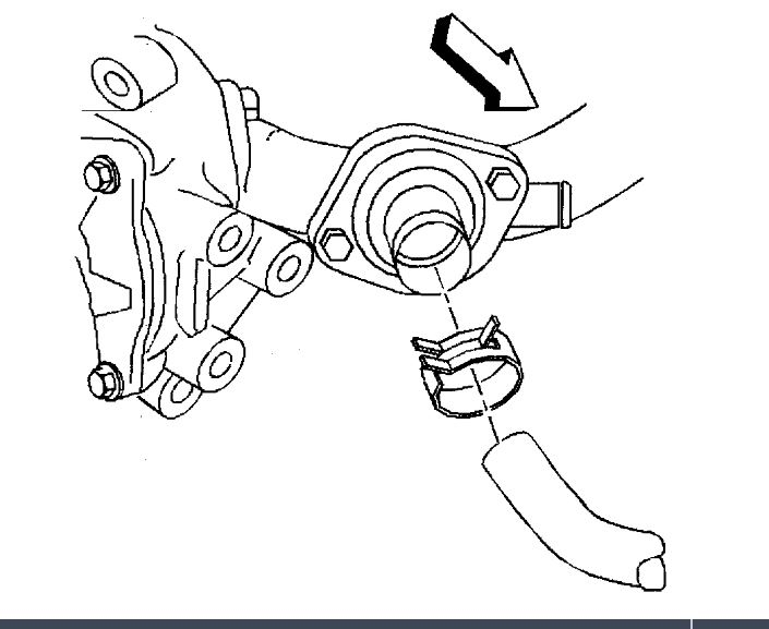

2. Remove the lower radiator hose from thermostat outlet.

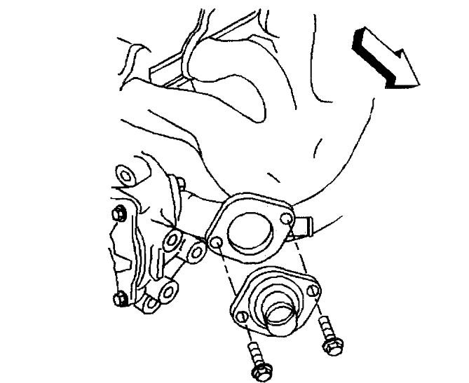

3. Remove the thermostat outlet bolts and outlet.

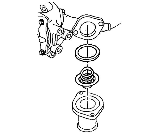

4. Remove the thermostat.
5. Clean the mating surfaces of the radiator outlet and the radiator outlet pip
