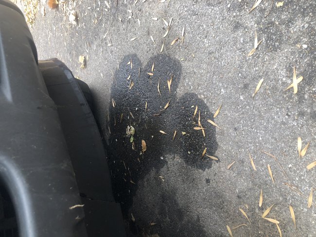

I’m looking for any kind of answer or help. so one night I was driving and it overheated all the way to the top of the temperature gauge like beeping can’t go any further so I stopped driving and had it towed. The mechanic said I need to replace the intake manifold gaskets it was $730.00 so we did that but before I did I asked him was there any other possible it would be happening he said maybe a blown head gasket but that he couldn’t check until the manifold was fixed so he fixed it. I sent my friend to pay as I was working. I go pick up the car within 10 minutes it overheats. I live close so I make it home not long after and it cools downs and there’s a big puddle of coolant underneath the reservoir again. I just don’t understand and feel taken advantage of. If anyone can help I would greatly appreciate it.

Can you post a picture of the leak?

As far as the head gasket, he is incorrect. You can check it without doing the repair. All he needed to do was remove the plugs and air up the cylinders and look for any coolant movement in the radiator.
I would return to the shop and request a refund and take your car somewhere that will do a correct diagnosis and repair.

This was just taken and needs to be rotated to the right.

I understand. Then take it back and tell them you have the same leak and symptoms. Have them recheck there work and report back to you. Then let me know what they say and we can go from there. I will try to help guide you through this.
