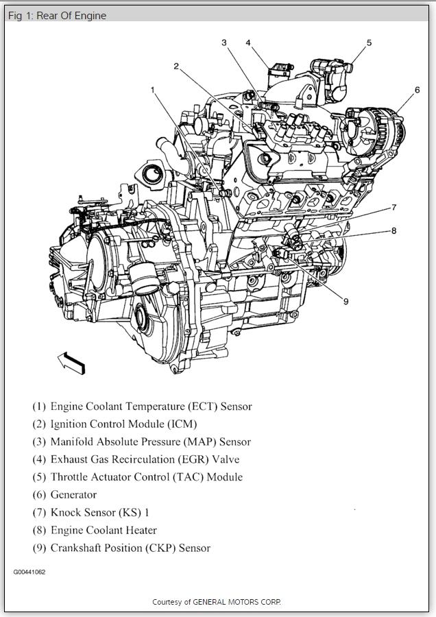

cooling fans work correctly but come on to soon
2007 CHEVROLET EQUINOX
26,000 MILES • 6 CYL • AWD • AUTOMATIC
CORKSTER
My cooling fans work correctly but come on to soon and remain on approx 7 minutes after the engine is turned off even when cool . Where are the temp sensors located so I can test them. Thanks Steve
Jul 30, 2009 at 11:33 AM
  • 54,832 POSTS
The engine coolant sensor is located in the rear of the cylinder head, I have attached a diagram for you. Check out the diagrams (Below). Please let us know if you need anything else to get the problem fixed.
