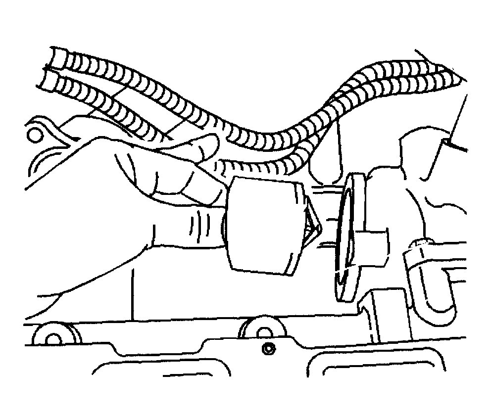

My car has the heater core bypassed and it overheated and the air conditioner started blowing warm very humid air when this happened. what should I do?
Jul 14, 2020 at 1:51 PM
  • 110,240 POSTS
The first thing is to make sure the engine coolant is full. Next, if the coolant is full, I need to know if this happens only in stop and go traffic or does it also happen when driving at highway speeds?
Next, pay attention to see if the cooling fan is turning on when it starts getting warmer. If it does and the coolant level is full, I would suspect the thermostat is bad and not allowing coolant to flow.

Thermostat Replacement
Removal Procedure
pic 1
1. If equipped with an automatic transmission, remove the exhaust manifold.
2. Drain the cooling system.

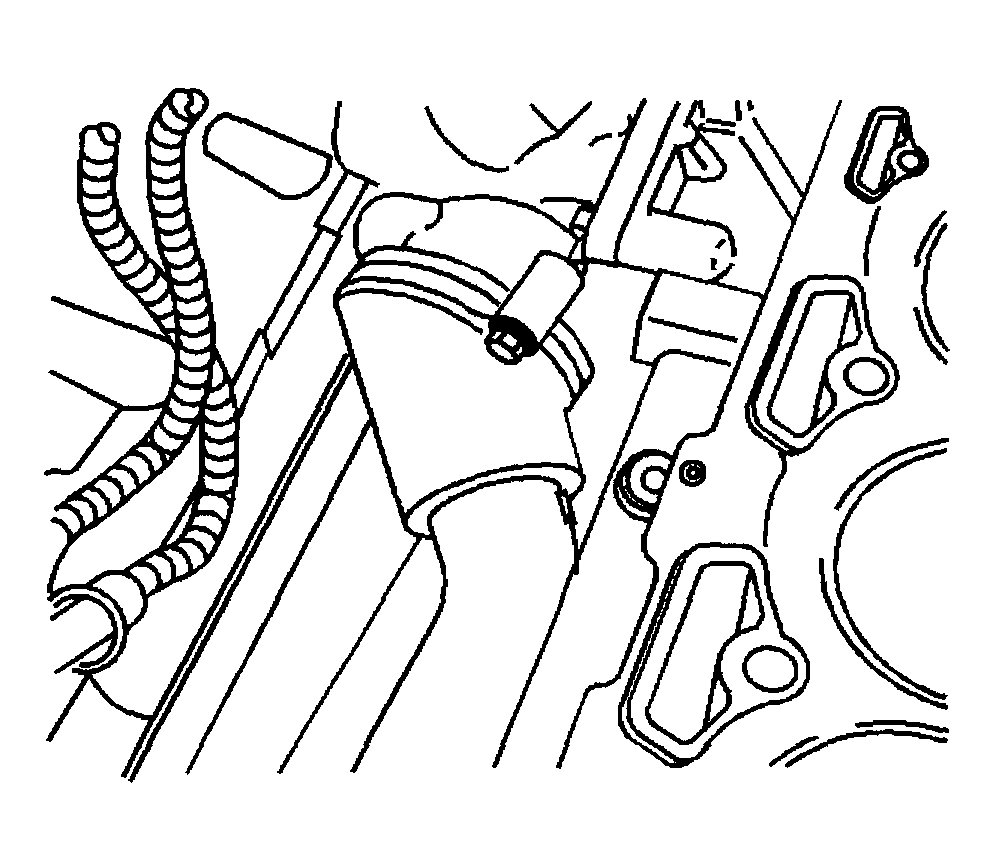

3. Remove the thermostat housing to water pump feed pipe bolts.
pic 2
4. Remove the thermostat housing to water pump feed pipe.

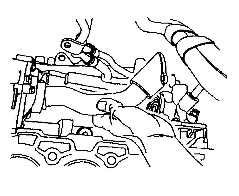

pic 3
5. Remove the thermostat.

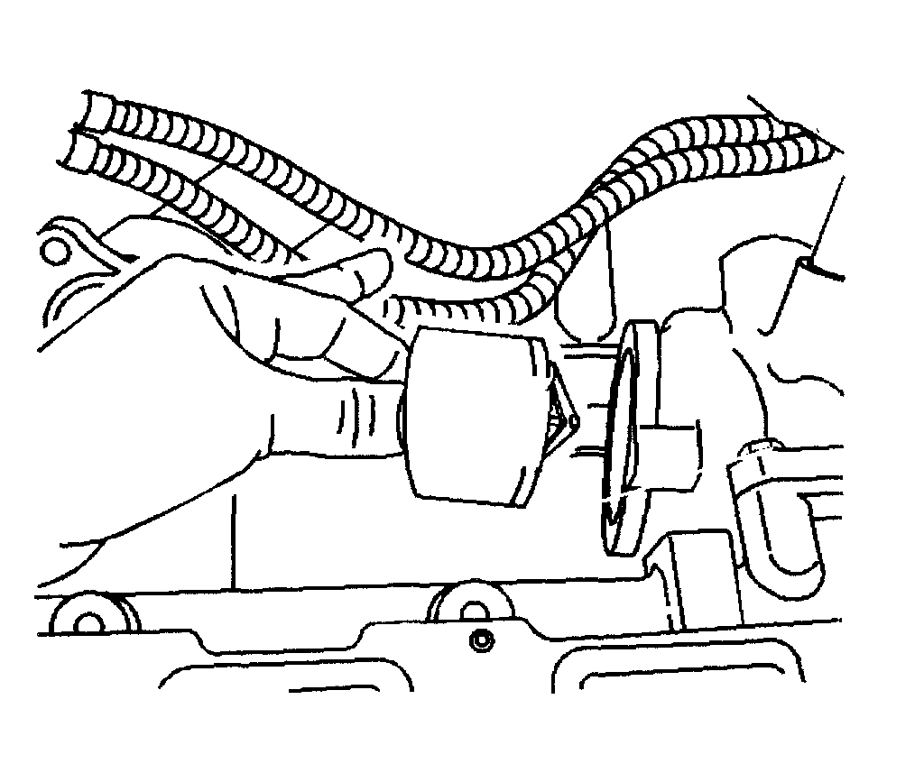

Installation Procedure
pic 4
1. Install the thermostat.

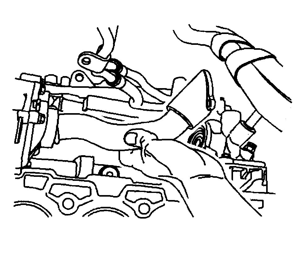

pic 5
2. Install the thermostat housing to water pump feed pipe.

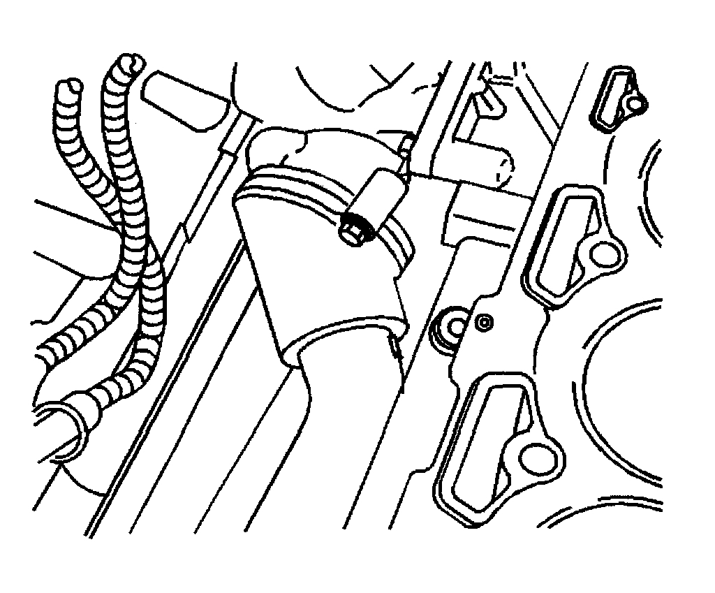

pic 6
Notice: Refer to Fastener Notice in Service Precautions.
3. Install the thermostat housing to water pump feed pipe bolt.
^ Tighten the thermostat housing to water pump feed pipe bolt to 10 Nm (18 inch lbs.).
4. If equipped with an automatic transmission, install the exhaust manifold.
5. Fill the cooling system.
