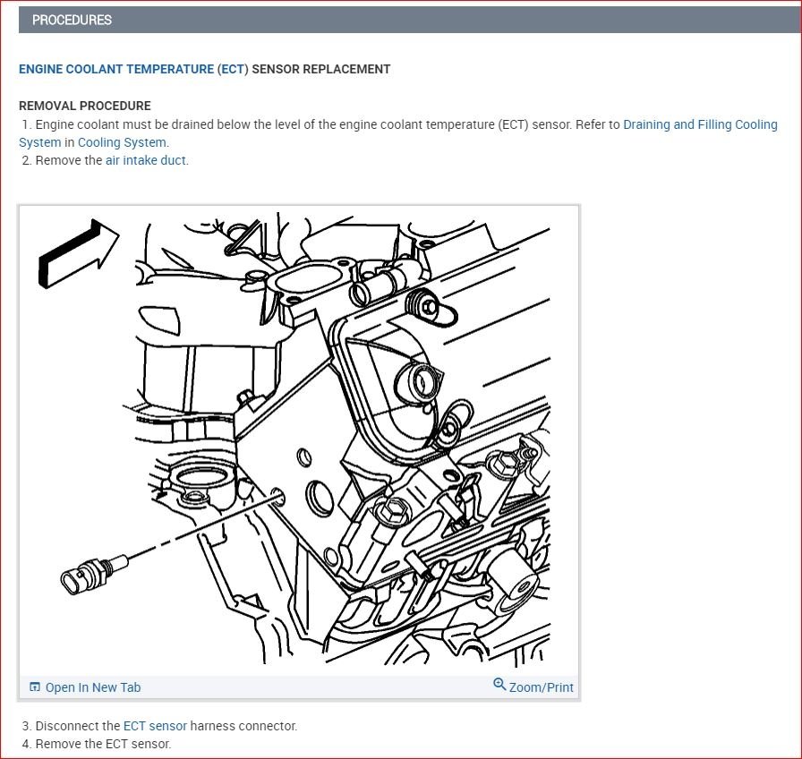

After a few minutes being on skyrockets hot and says overheating with all alarms and chimes going and it loses power, but there's never any heat coming from the engine. I replaced the thermostat, alternator, fuel pump, water pump. what causing it to overheat without it being hot? Also no heat comes through what I have the heater on full blast.

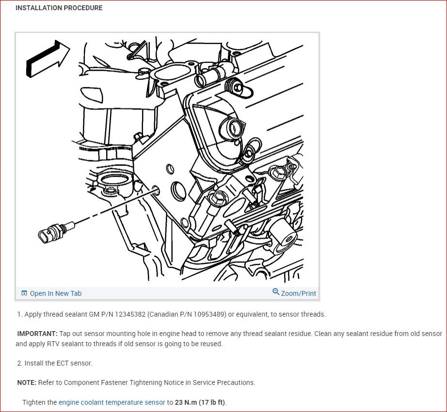

Once we confirm the engine is at proper operating temp, then we need to look at what the control module thinks the engine temperature is. This would be the engine coolant temperature sensor. We need to scan for any codes and then monitor what the PCM is seeing from the sensor. If the sensor is telling the PCM that the temperature is high then it is going to peg the gauge and chime to get your attention. I included the process of replacing the sensor if this turns out to be inaccurate.

Once this is done let me know the results and we can go from there. I would suggest tackling this issue prior to the no heat issue and see if they are both resolved after. The reason is, if you are not getting any heat that could be a blend door issue in your HVAC system or a blockage in the heater core circuit.
