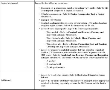

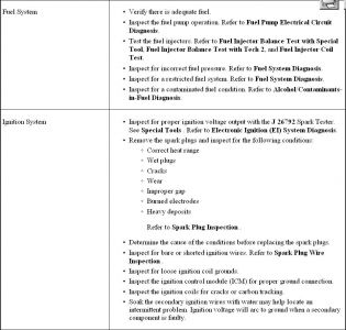

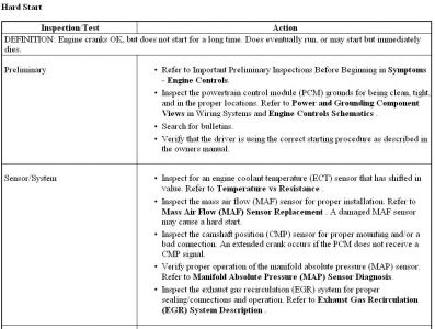

Hi Ohio28,
Here are possible causes for hard starting.
https://www.2carpros.com/forum/automotive_pictures/192750_HardStart01a_1.jpg
https://www.2carpros.com/forum/automotive_pictures/192750_HardStart01b_1.jpg
https://www.2carpros.com/forum/automotive_pictures/192750_HardStart01c_1.jpg
Tuesday, October 19th, 2010 AT 8:28 AM
