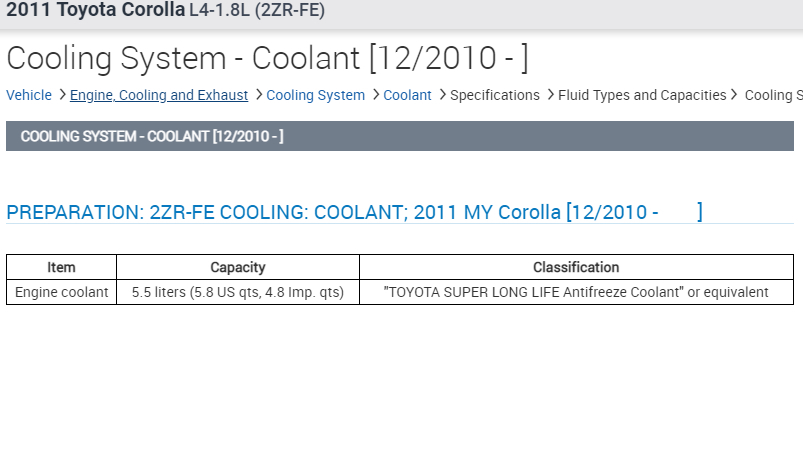

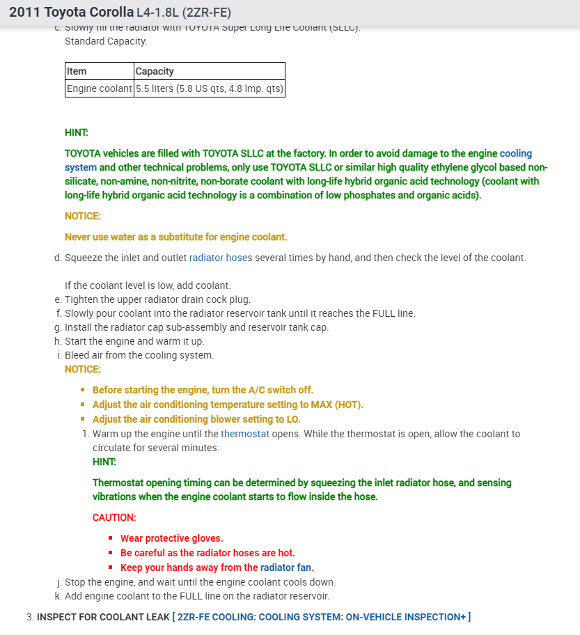

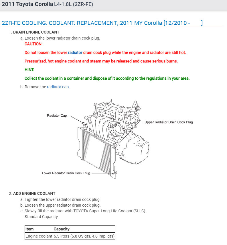

SQM
  • 6,383 POSTS
The radiator or the cooling system should be filled with coolant/water mix. Not just water.
Just adding water will evaporate and you will have to add it more often.
As long as there is no leak or you are not experiencing overheating, you can fill as often you need to.
Also using the condensation water from the A/C won't make any difference.
Take a look at this guide:
https://www.2carpros.com/articles/engine-cooling-system
Let me know of any questions.
