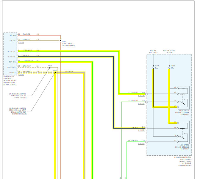

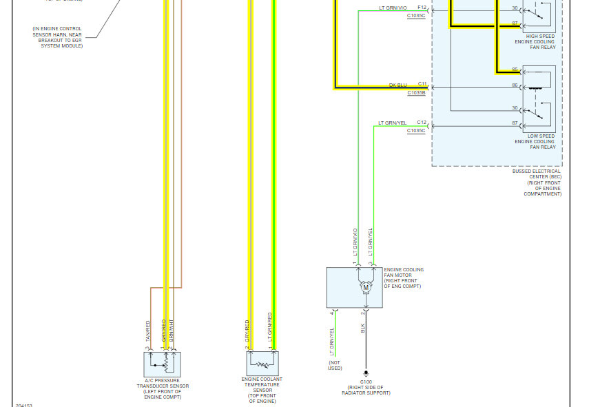

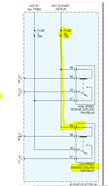

I attached the wiring schematic for the fans below. If you checked the fuses already and used them as a power supply, we know they are good. If you didn't, please confirm there is power present in both sides of them.
Next, pins 87 should have power at the relay at all times. I need you to confirm that both of the pins (87/one at each relay) has power. If they do, we need to confirm there is a ground path being provided when the engine is starting to overheat.
The ground path is what turns the relays on to send power to the fans. Also, disconnect the engine coolant temp sensor to see if that forces them to turn on as well as the AC.
Here is a link that explains how to test the relays and the circuit:
Let me know what you find.

Update: Fuse has power in and out. Terminal 87 on high and low speed relays has power. Both have ground but it seems it's there before it gets hot. When the temp sensor is connected the fan will not come on even at 200, measured with IR gun. When it's disconnected the fan run as long as the car is running. When the temperature sensor is connected, and the AC is on it cycles on and off. Scratching my head on that. I now found out that this engine has been overheated 3 times. The system doesn't seem to pressure up and I can smell coolant and hear a hissing down by the passenger side head. I'm also told that it will lose some coolant in a couple hundred miles. I don't see water on the dipstick, but I think there a tiny bit of oil in the coolant reservoir. Tomorrow I will do a combustion gas test on the coolant. I think the T-stat failed and caused a small head gasket leak.

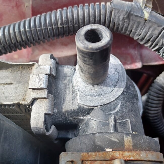

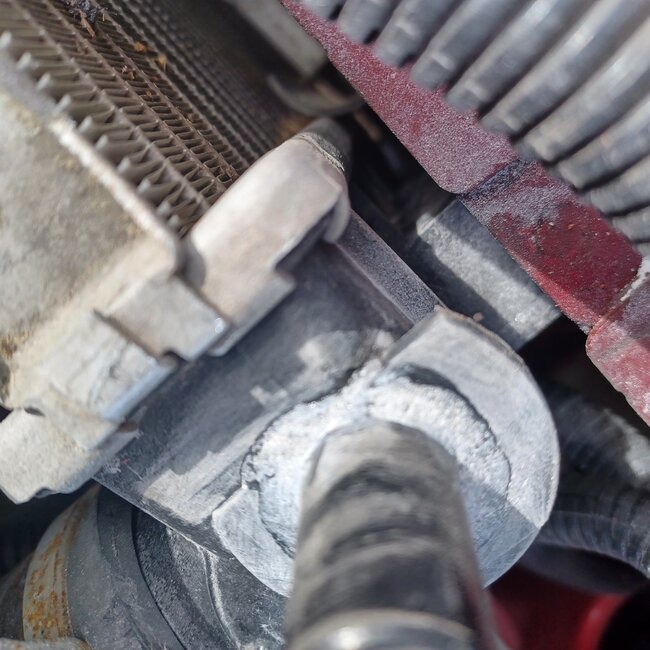

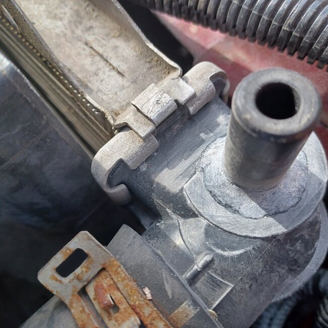

I did the pressure test and found a very small crack on the base of the passenger side upper locating post. I ran the car with 15psi and my scanner reading live data and the fan cycles at 109 C. That's with it idling in the driveway. It would appear everything is working as it should. Just need to put a thermostat in it. Right now it's open. I'm going to try and repair the crack with super glue and baking soda. I've fixed so many plastics with it and even submersed it in gasoline and it doesn't break down.

I repaired the crack high speed fan circuit cycles on at 109C and off at 104C. The temperature drops to 100C. Low speed doesn't cycle or activate when relay is jumped. Is this the resistor? Drove 30mi. Live data showed coolant as low as 82C. Only reaches 109C if sitting at idle for a long time. Of course the ambient temperature is in the 70s now. I think it needs a t-stat to hold temperature closer to optimum. Last two photos are the repair and 1st is at 109C. Completely dry at 15psi and 228F. Checked again after 30mi, perfect. I swear this repair is stronger than the original plastic most of the time.

The repair looks great. What all do you put together to make it work? LOL I may need the recipe at some point.

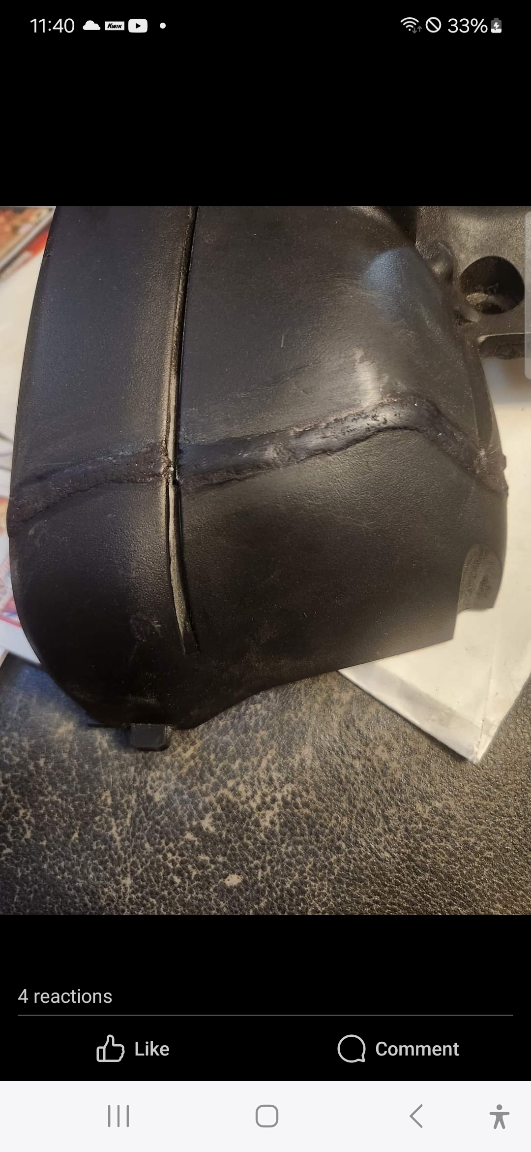

Pin 87 has power, does the resistor have two separate circuits? On most repairs you use super glue to fasten the parts. Then you rough up the crack with sandpaper or a file, lay the super glue over the crack but a little wider, then put baking soda on and smooth it out. Repeat a couple times removing excess soda between coats. You can sand it, grind it, whatever. I've used it on many types of plastic. For additional strength you can mix pencil graphite in with the baking soda. I've never tried that, I've also heard of using concrete instead of baking soda. I haven't tried that either. Here's a picture of a Volvo timing belt cover that got stepped on.

Wow, that is impressive. I never heard of doing it like that.

Pin 85 gets power from a different fuse. Try jumping 85 and 87 pm the low-speed relay. See if it turns on. If it does, then we aren't getting power to that relay, the relay is bad, or there is a broken (open) wire between the relay and the fan.

If 85 has power, there is an open circuit between the relay and the fan motor. Are you able to locate the light green wire with a yellow tracer? If so, we need to check the connector condition and confirm the wire itself isn't damaged. That is the power supply for the low speed. If pin 85 did have power and the fan didn't run when you jumped the two, there is an open or the fan is bad. However, it does work with the high-speed relay. That tells me the fan motor works. That leaves an open circuit.

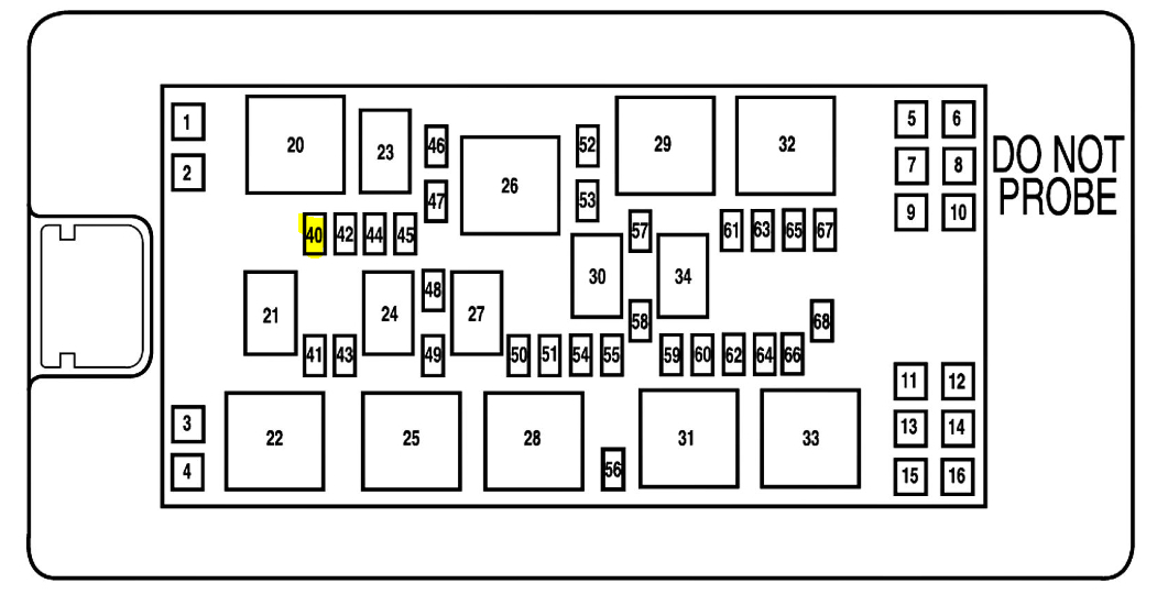

No power at pin 85. Where does it get its voltage supply?
Wednesday, October 2nd, 2024 AT 8:47 PM
  • 109,885 POSTS
Power to that pin comes from fuse 40 in the bussed electrical center located at the right front of the engine compartment. Note that pin 86 on the high-speed relay gets power from the same place. If that relay has power and the low doesn't, there is an issue with the buss.
I attached a pic below showing the fuse to check. The second pic shows the wiring.
Let me know if this helps.
See pic below.
