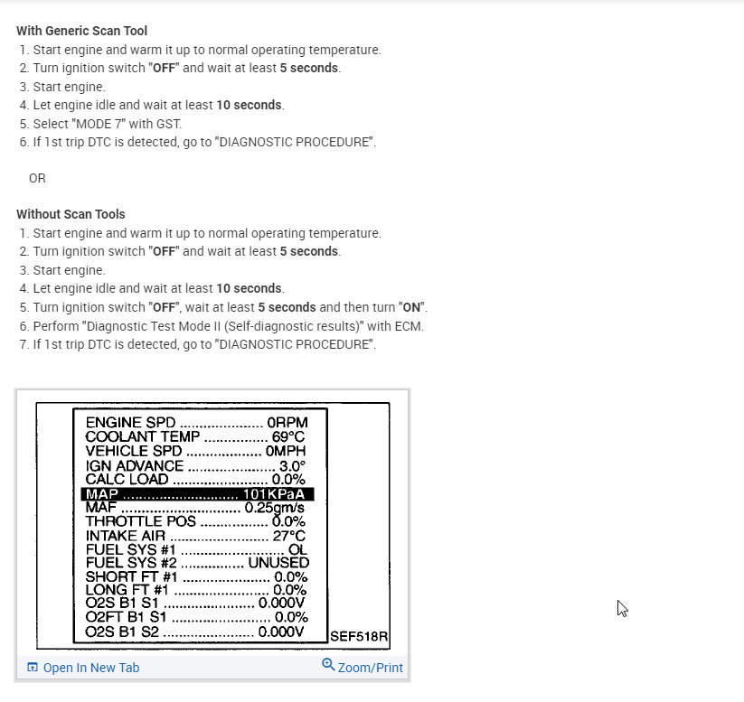

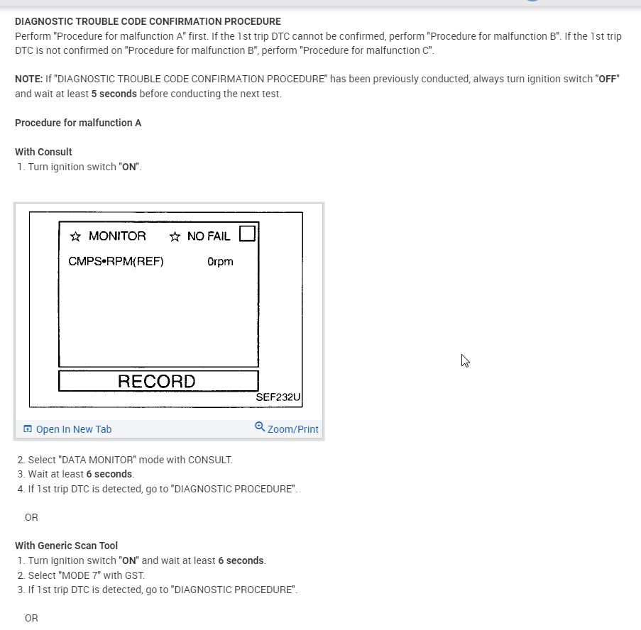

P0325,P0105,P0120 are the codes. What do you mean " motors" are bad?
Oct 25, 2019 at 9:40 AM
Okay, thanks.

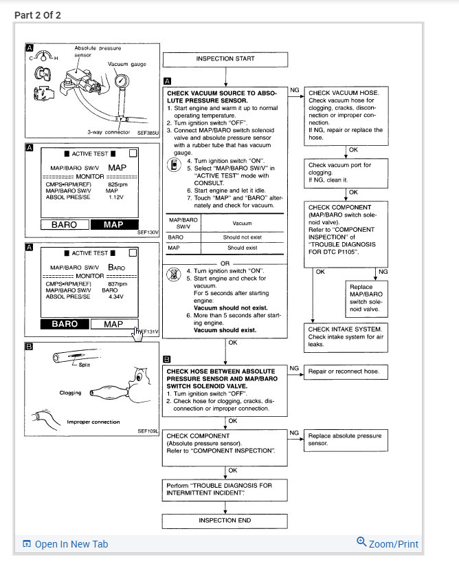

P0105 - MAP Sensor
P0120 - TPS Sensor
P0325 - Knock Sensor
These codes could cause issues but not overheating going uphill.
More than likely the overheating issue is on the path that you have been going. Either there is not enough air flow through the radiator to cool the coolant quick enough with this added load or there is an air pocket in the cooling system.
Let's start with the easier one. I would suggest investing in one of these funnels to fill your radiator because it almost eliminates air pockets. However, when you check it jack up the radiator cap has high as possible. Meaning you want the opening to the cooling system (radiator cap) as high as possible so that all air will raise and work towards the cap and then it will exit.
Here is a video of the funnel I am talking about:
https://youtu.be/xYkKW0OyeUc
It is not necessary to drain and fill the radiator again, just open the cap, install this funnel and then fill the funnel about a quarter of the way with new coolant. Jack up the front end closest to the radiator cap and then run the engine so that it gets hot. Just let it idle for about 20-30 minutes after it is hot and make sure the funnel keeps about a quarter full so that if any air pockets open up it will pull in this coolant to fill the gap.

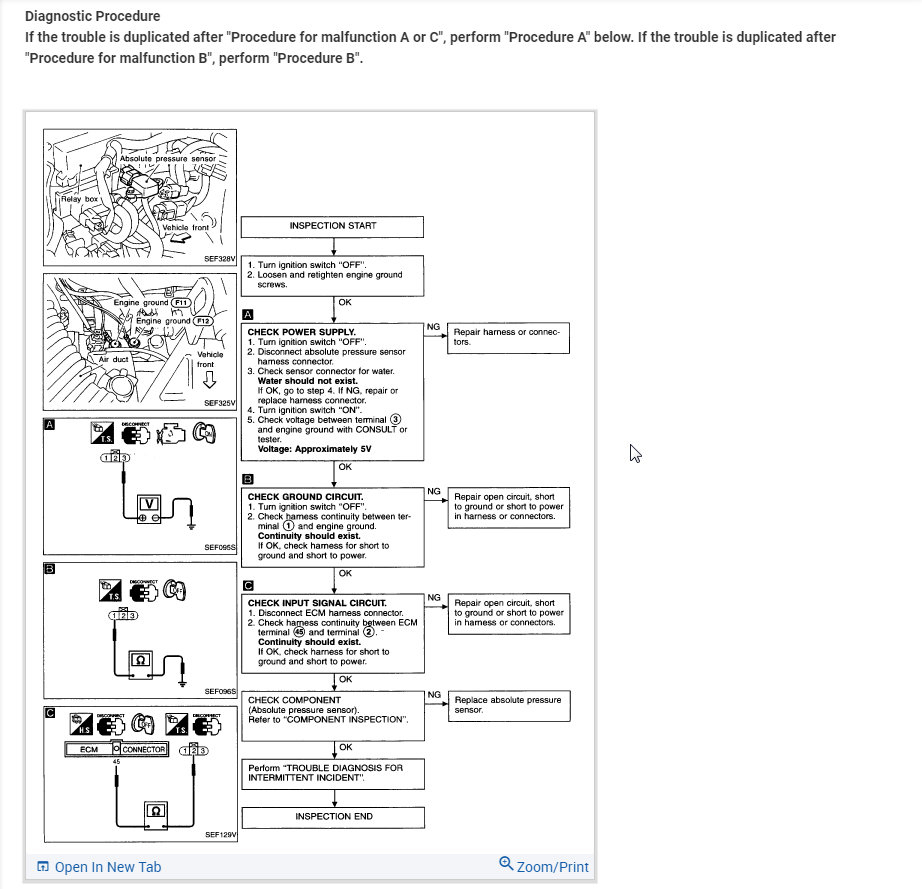

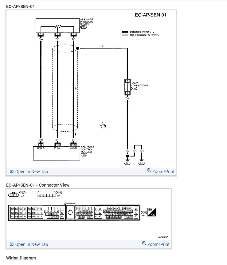

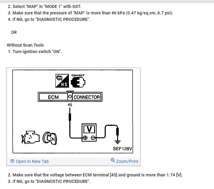

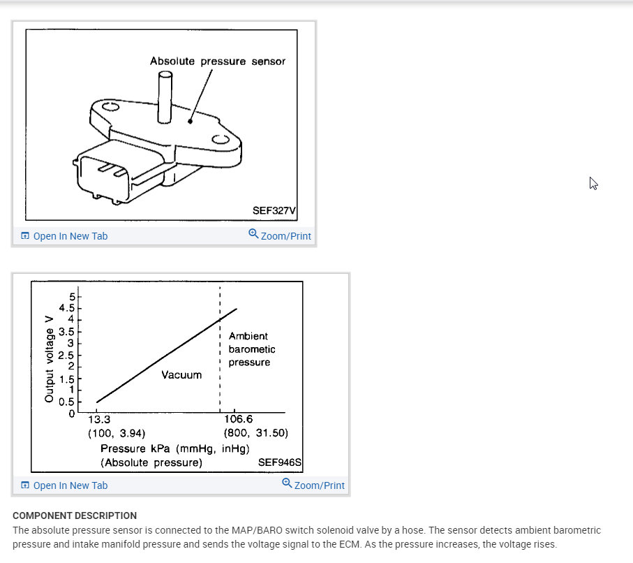

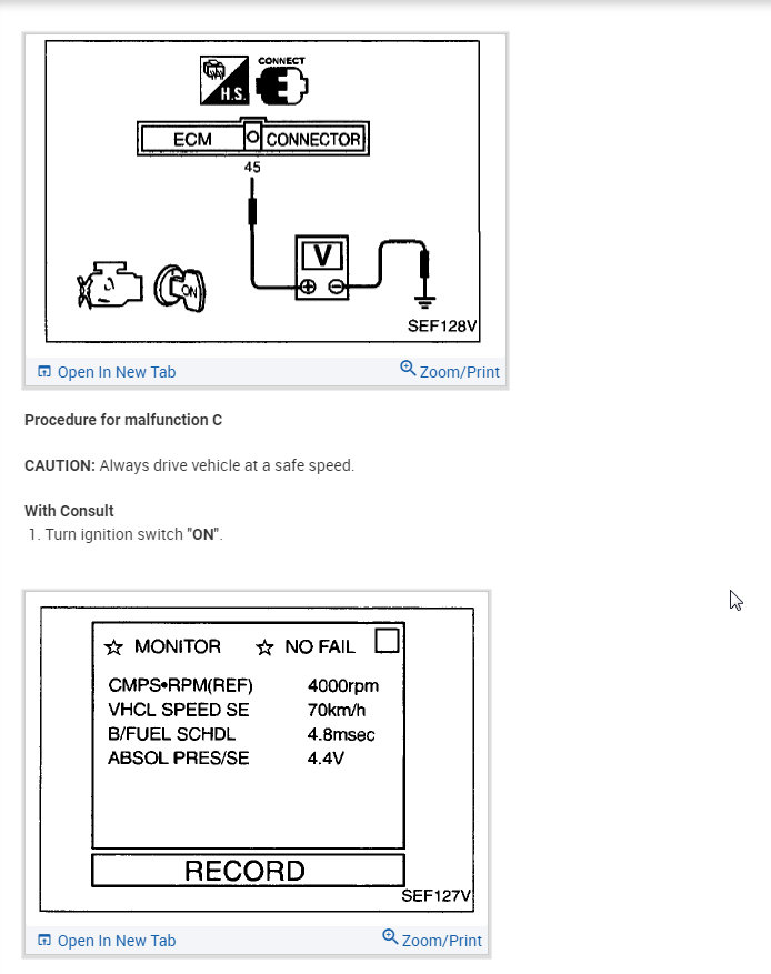

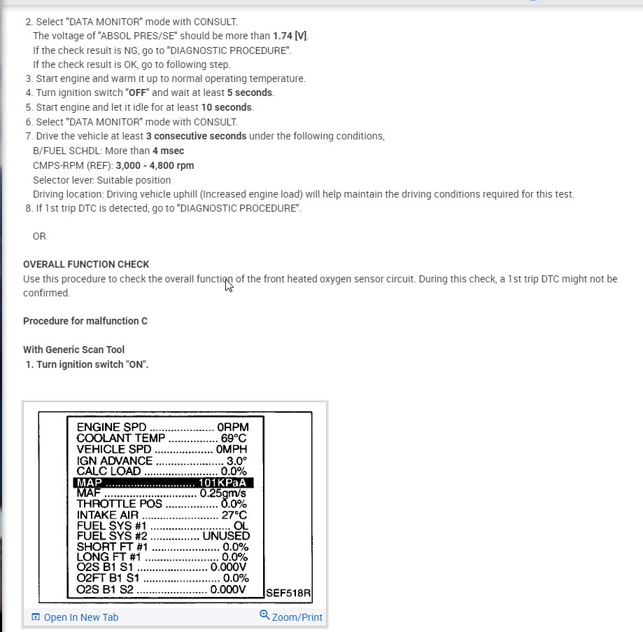

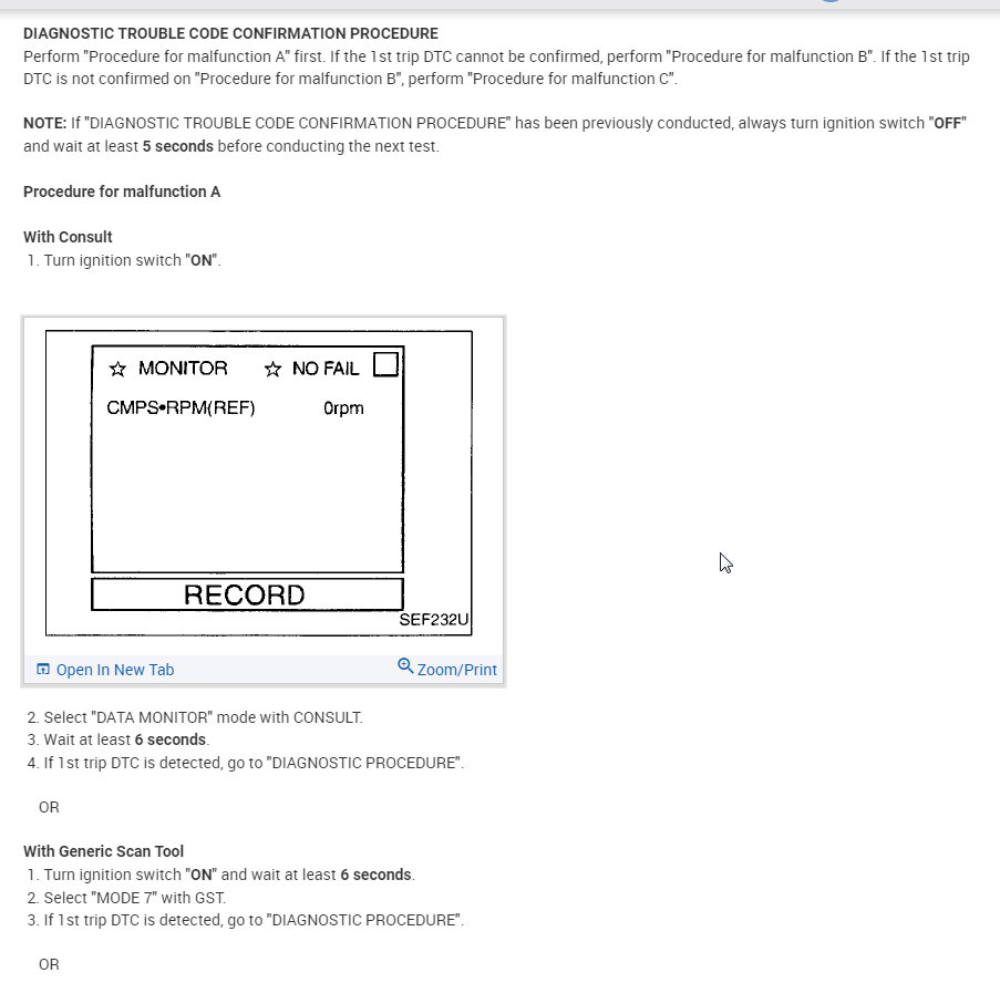

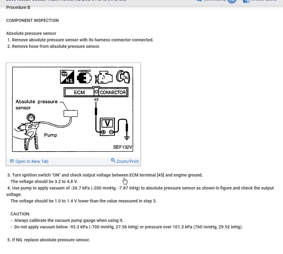

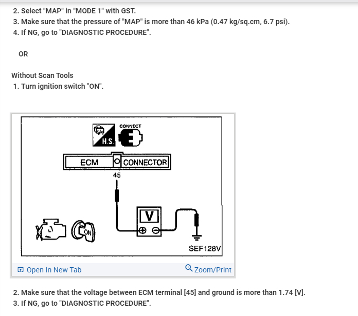

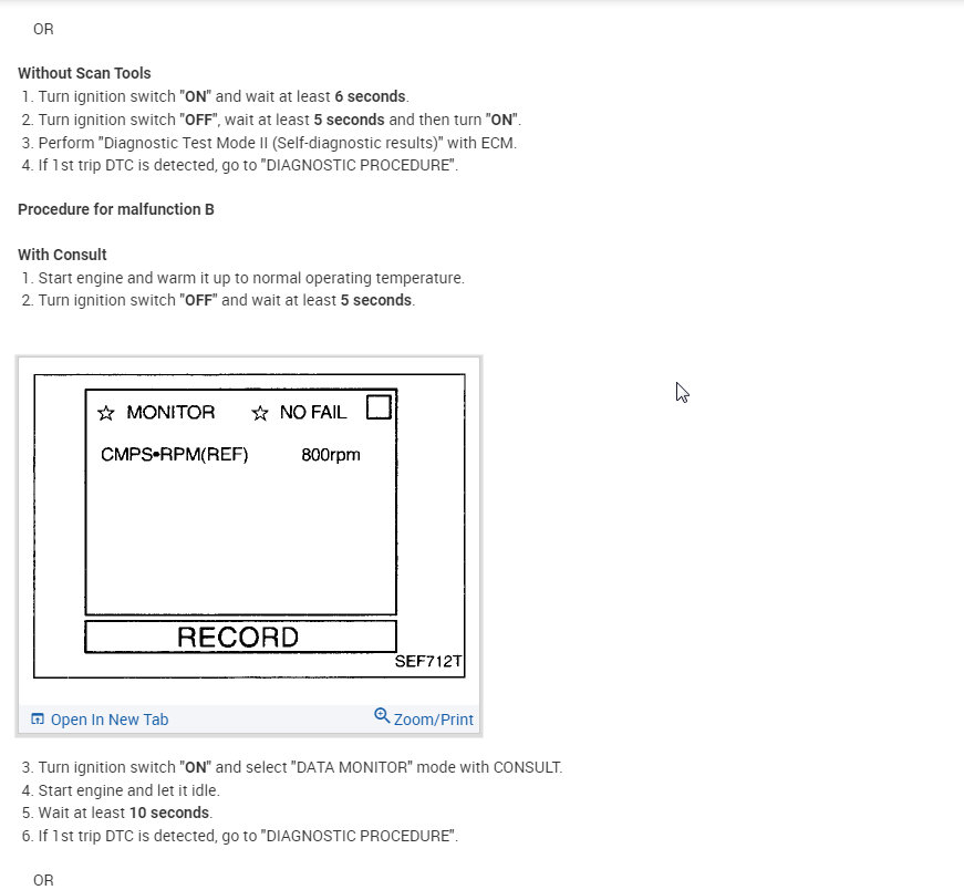

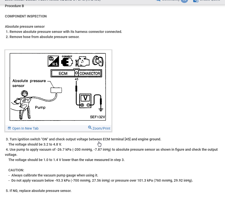

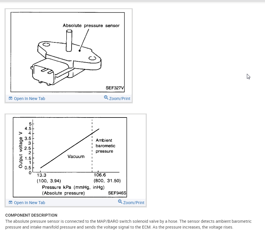

Attached is the diagrams for the MAP sensor. I suspect if you fix this one, it will fix the other codes as well. However, let's keep this post to the overheating issue. If you want to tackle these codes then let's get a new post started because we need to keep it to one topic per post so others can find any answers we come to for each issue. They won't know to look for a MAP sensor issue under an overheat heading.
