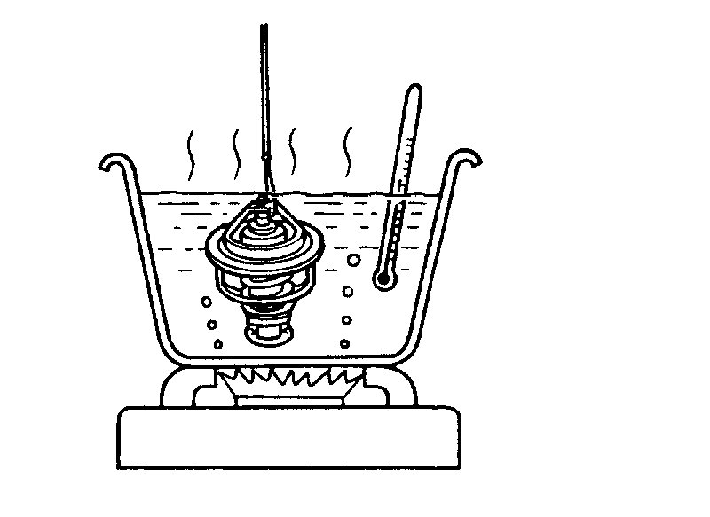

INSPECTION
1. Check for valve seating condition at normal room temperature. It should seat tightly.

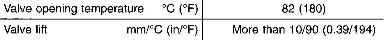

2. Check valve opening temperature and valve lift.
3. Then check if valve closes at 5°C (9°F) below valve opening temperature.

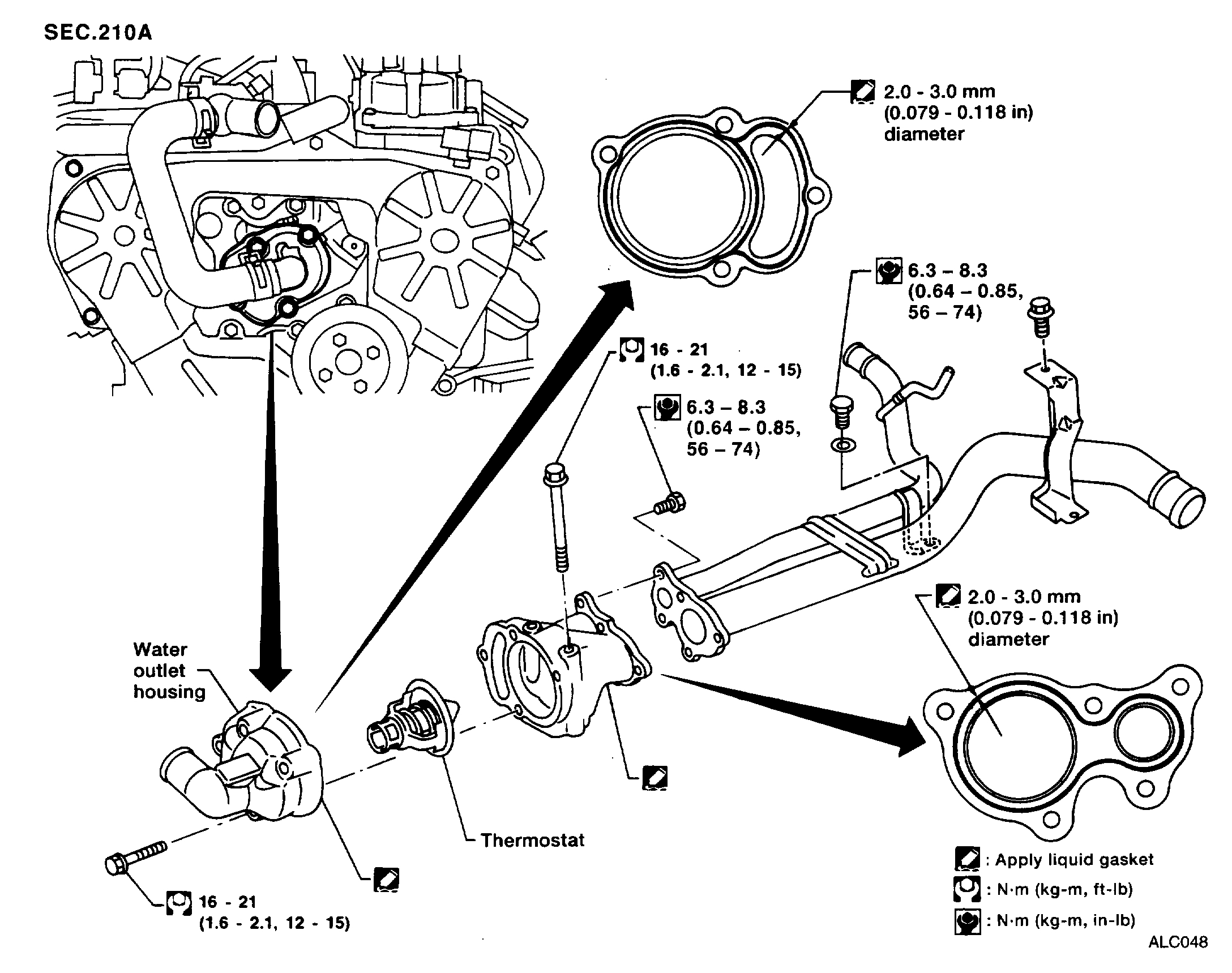

INSTALLATION
pic 4

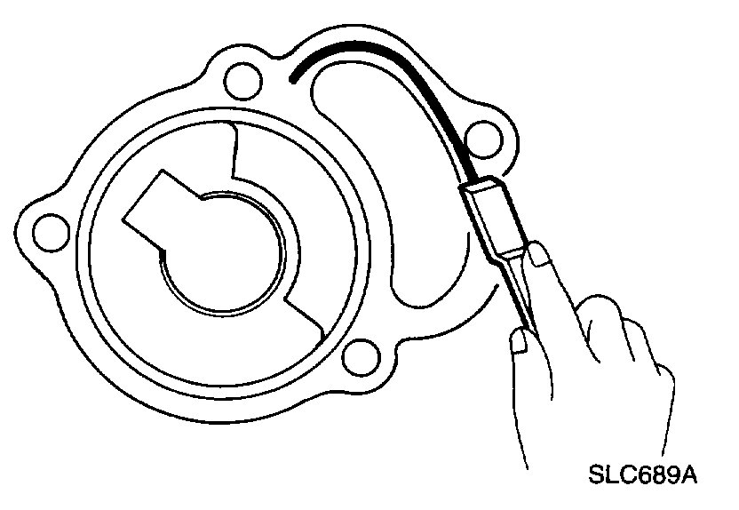

1. Use a scraper to remove old liquid gasket from water outlet housing.
2. Apply a continuous bead of liquid gasket to mating surface of water outlet housing.
- Use Genuine Liquid Gasket or equivalent.
pic 5

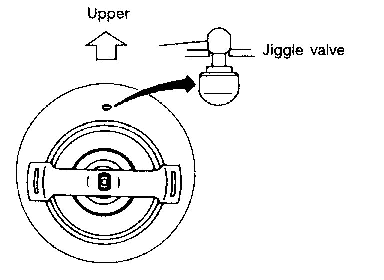

3. Install thermostat with jiggle valve or air bleeder at upper side.
4. Install water outlet housing.
5. Install water hose to water outlet housing.
6. Refill engine coolant.
- After installation, run engine for a few minutes, and check for leaks.

Note: Make sure the jiggle valve is in the 12 o'clock position (pic 5). Otherwise, it will be very difficult to get the air out of the system.
