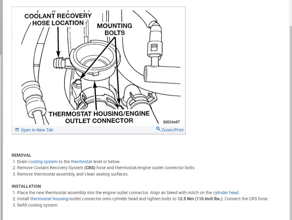

This thermostat has a notch on the rubber grommet that you need to line up with the notch that is pointing towards the cylinder head.
Here is a guide that will help with draining and filling the coolant to avoid air pockets:
https://www.2carpros.com/articles/coolant-flush-and-refill-all-cars
Below you will find the info from the manual on this as well.
