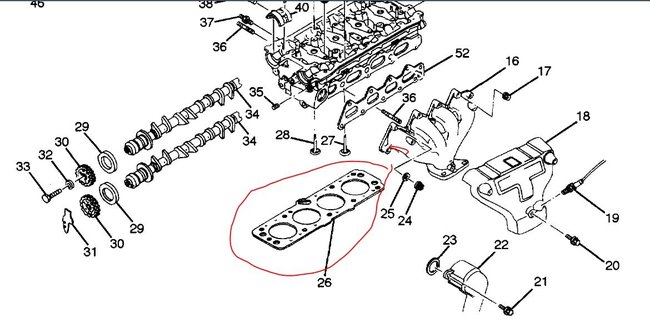

The car was recently overhauled, it's overheating, water flows out of the water bottle. what could it be?
Feb 5, 2020 at 6:29 AM
Good morning,

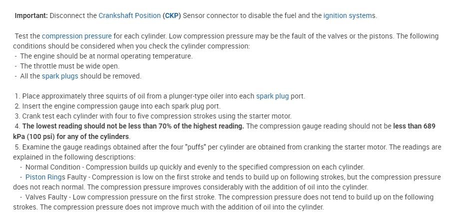

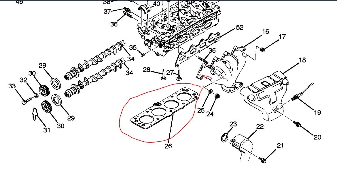

This is not a good sign. It sounds like a compression leak into the cooling system from a head gasket leak. You will need to have a leak down test performed to see if it is the head gasket.
That is where you inject shop air into the cylinder one at a time and watch for coolant movement in the surge tank.
