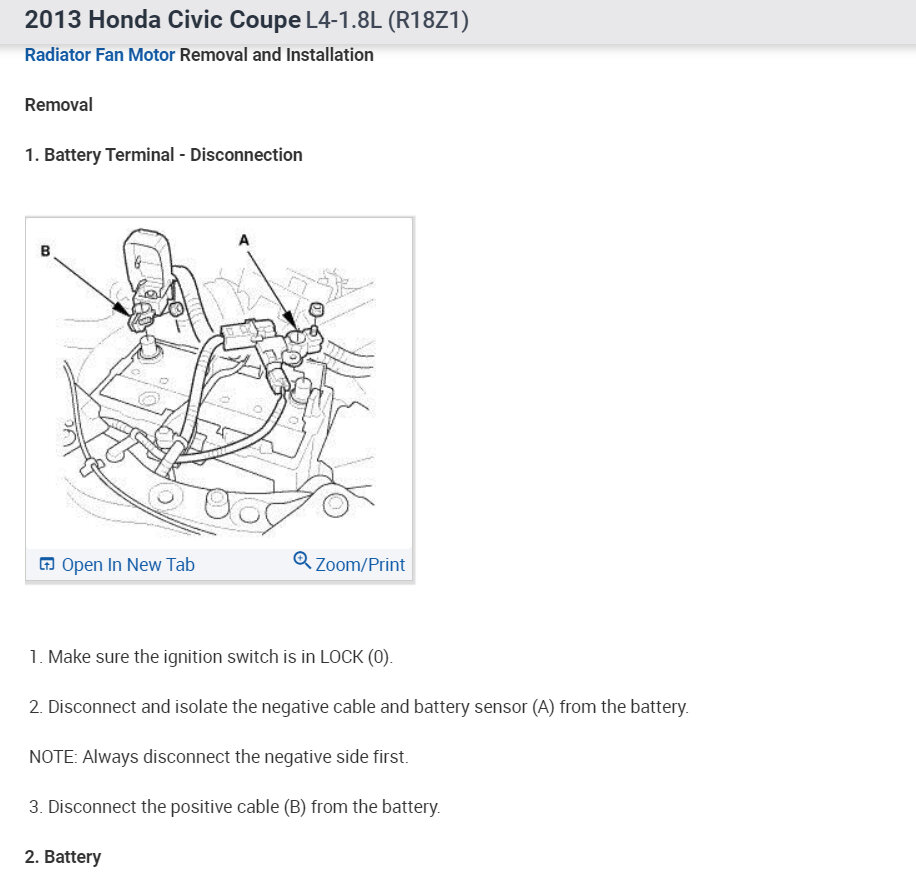

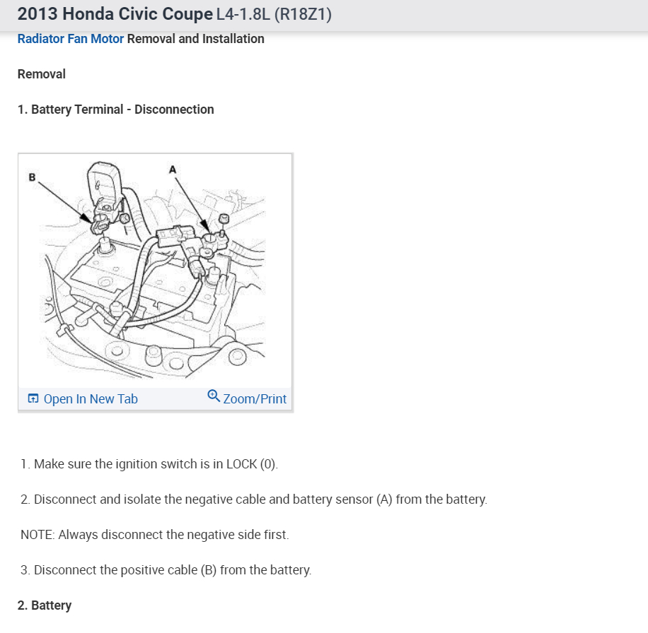

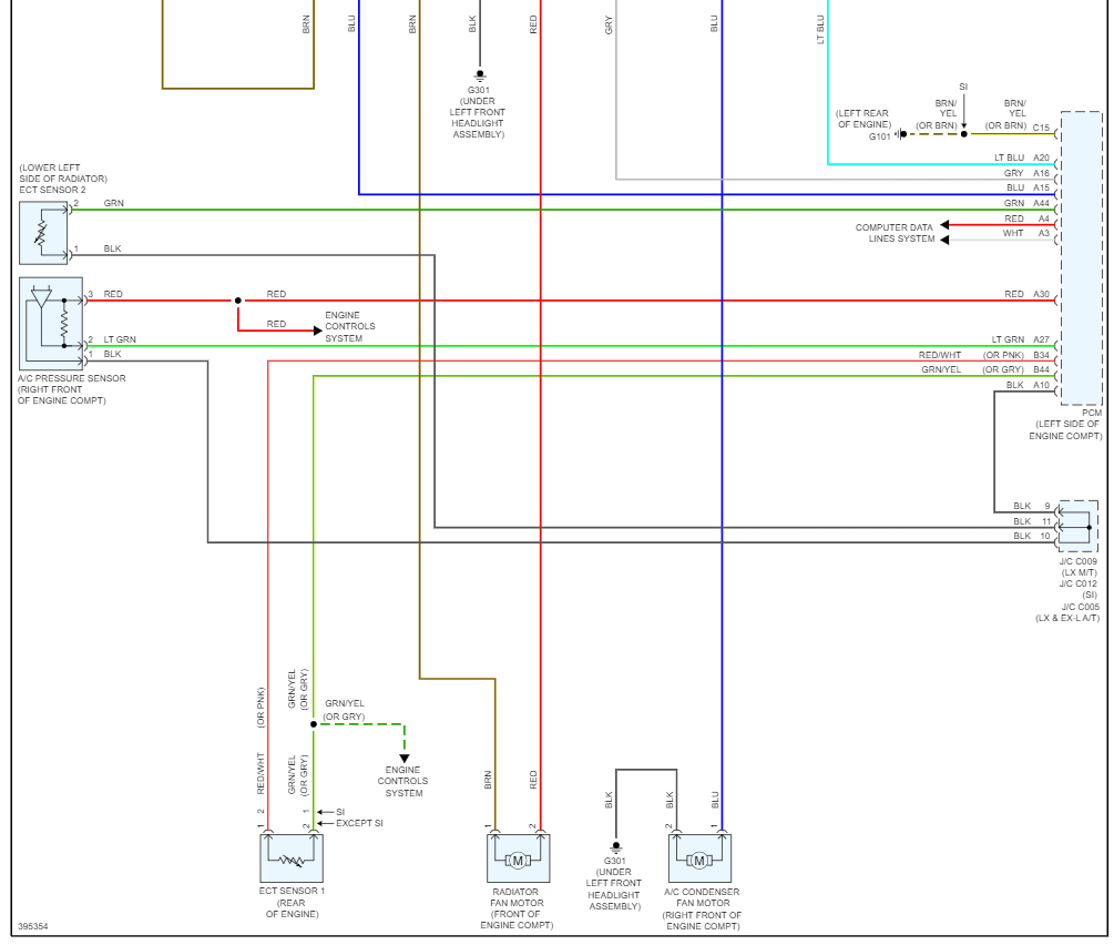

In the morning i checked my coolant level and everything was just so fine. In the evening i went for a drive and was returning home suddenly at a speed 5 to 10 kmph i noticed overheat signal bumped on the dash i immediately stopped the car and let it cool down i checked the coolant level it was normal, but the fans were not working. I need help.
May 28, 2023 at 7:06 PM
  • 55,399 POSTS

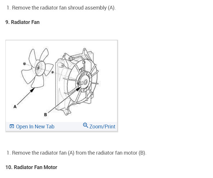

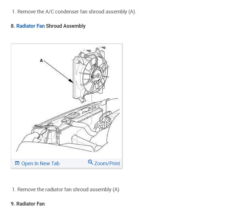

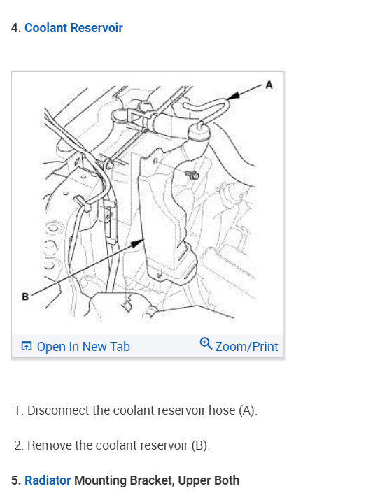

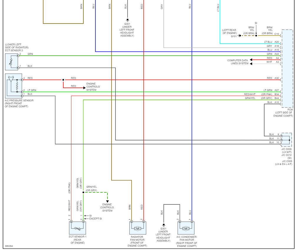

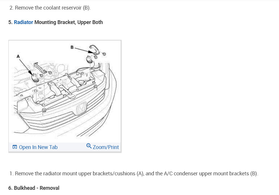

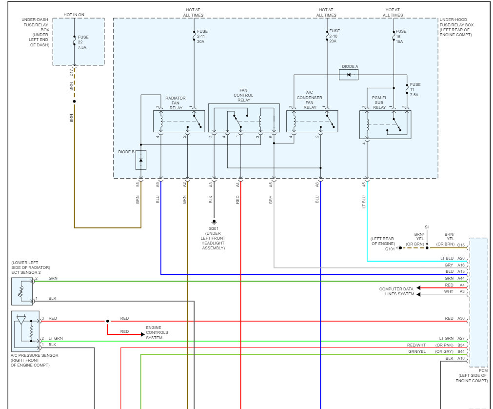

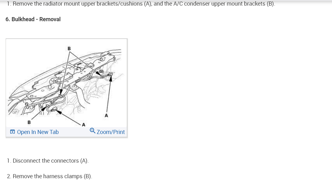

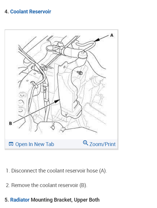

Yep, you need the fans to keep the car from overheating. Here is a guide to help you test for power and the fan wiring diagrams so you can see how the system works and which fuses to check as well.

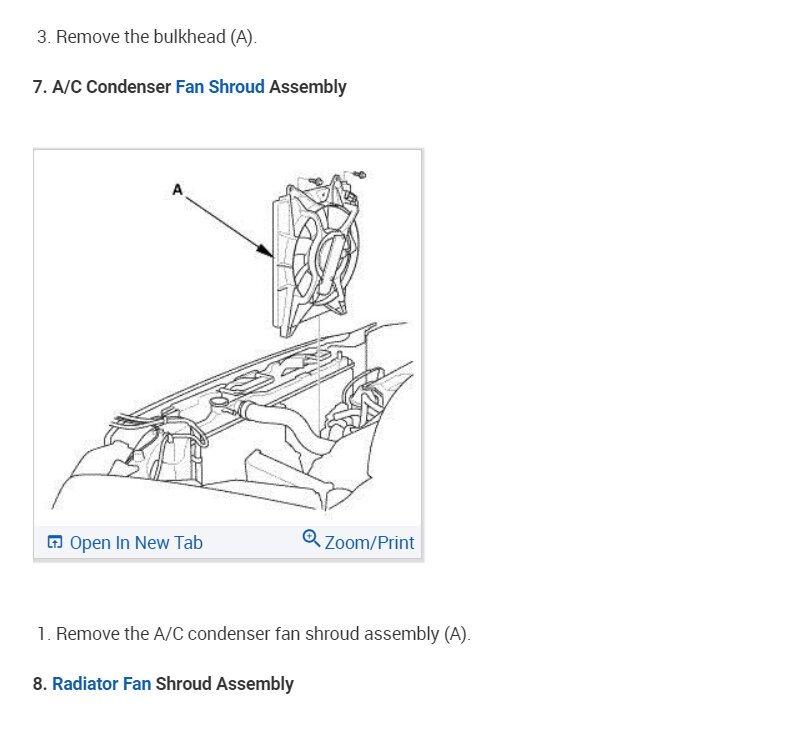

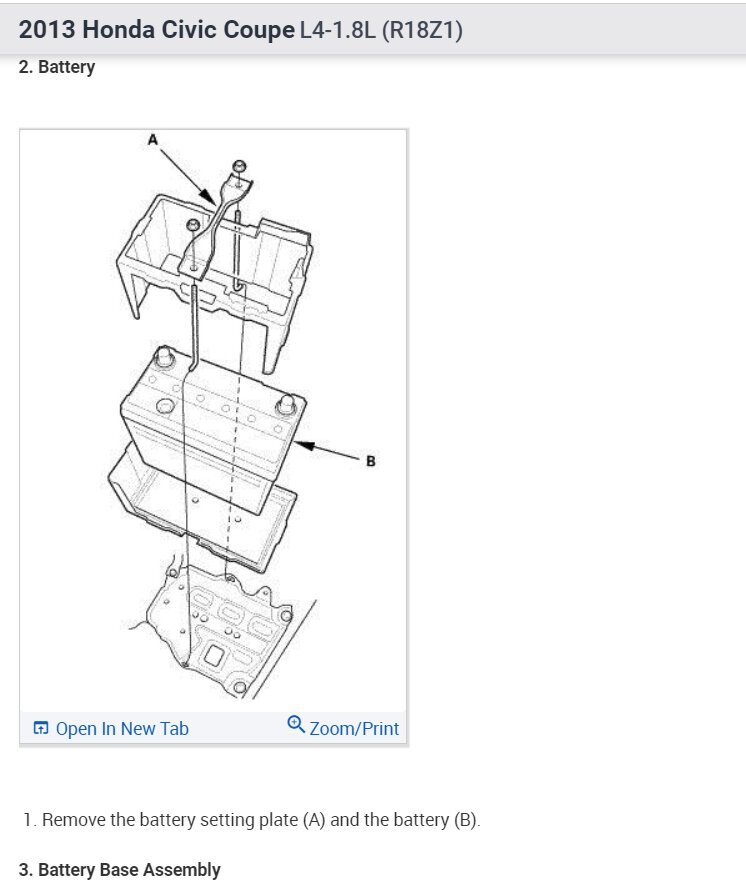

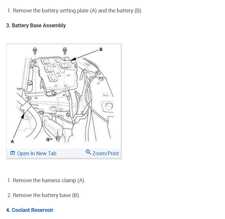

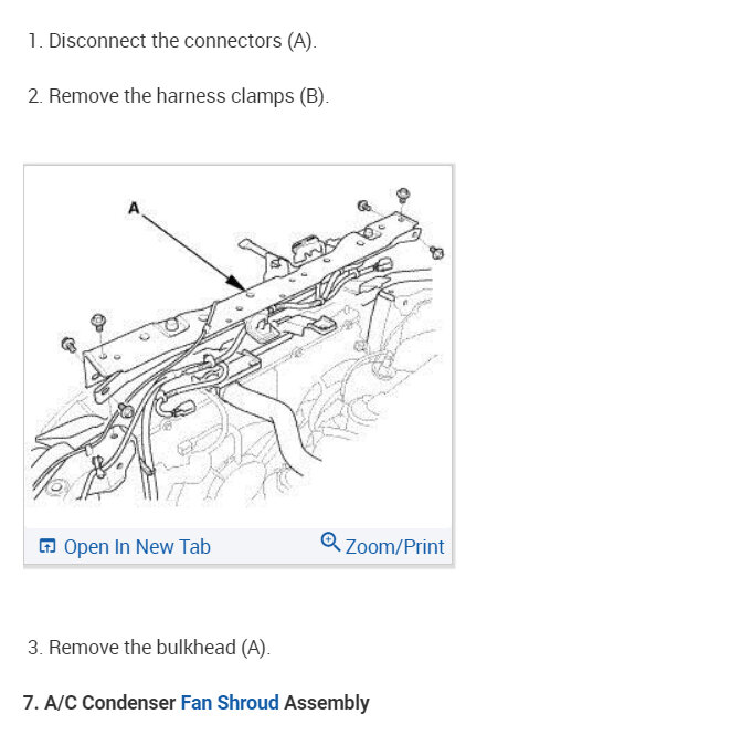

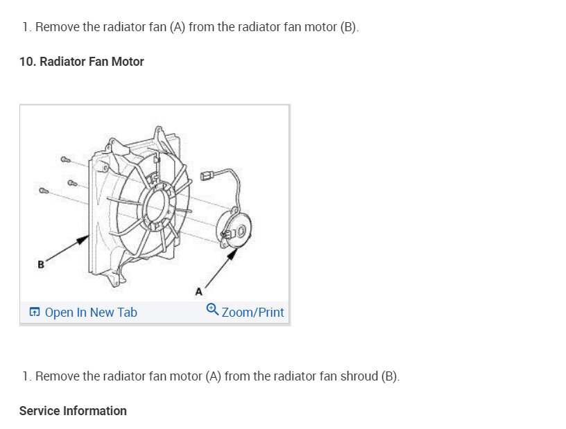

It could be the radiator fan is burnt out which is common here is a guide to help you step by step in changing it out and I have included instructions in the images below to show you how on your car.
https://www.2carpros.com/articles/replace-electric-fan-motor
