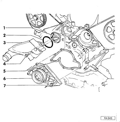

My car listed above (Quattro) overheats after after a short time of driving. While I am in stop and go traffic it will overheat, but once I go on the freeway or non stop the temperature goes back to normal. What could be causing this problem?

My fan does turn on at idle speeds and stop and go traffic but then it stays on while I am driving. I had a friend check at the other day and it was still overheating but once I started to drive it went to normal operating temperature. I am lost at this point and do not know what to do It is just weird that the engine check light was turned off when we did the O2 sensors and had recently came back on when I drove it to the lake and my friend did a test on it, and it said the sensors were still bad and that is when started to overheat going uphill. Then leaned out to normal operating temperature once we were on top and driving to normal highway speeds. Still continues to overheat at slower speeds or stop and go traffic. Thank you for your help, I appreciate it. I just need to know what this is so I can register my car this Saturday without any problems.

If the same codes are returning, chances are it is not the sensor but rather a rich or lean fuel mixture, partially plugged catalytic converter, bad wiring to the sensor. If your friend has a scanner that will read VAG codes, it should be able to read real time/live data. If that is the case, ask him to check short term fuel trims. They should hover around 0. Let me know what you find with that if possible.
Now for the cooling, since the fans are working, there has to be a different problem. Since it happens regardless of the fans running, either you have a partially plugged radiator, bad thermostat, or the water pump itself is bad. I have attached a picture of the thermostat for you to see. If you decide to check or replace it, here are the directions for checking to see if it is working.
https://www.2carpros.com/articles/how-an-engine-thermostat-works
At this point, if you have not already, I would suggest replacing the thermostat and flushing the cooling system. You should inspect the water pump for play or damage to it. If you decide to replace the pump, it is an involved process. It requires removal of the timing belt. If you choose to do that, let me know and I will provide you with the directions.
Let me know what you find. I am interested in the codes and if the cooling system has ever been serviced.
