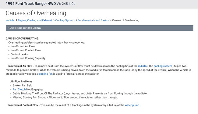

Recently the lower radiator hose busted, after replacing hose and adding antifreeze back I started truck and everything seemed to run the same as in past. Within 5 miles however notice the truck began to overheat. Checked to make sure hose stayed on and it did however after let truck cool down it seem to not want to start acting like it wasn’t getting fuel it needed. After finally starting yet again within few miles the truck continued to overheat. I’m not very mechanically inclined and need to know what I can do myself to try solving problem.

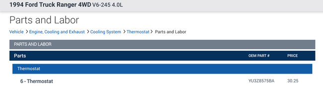

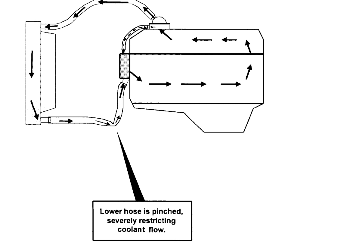

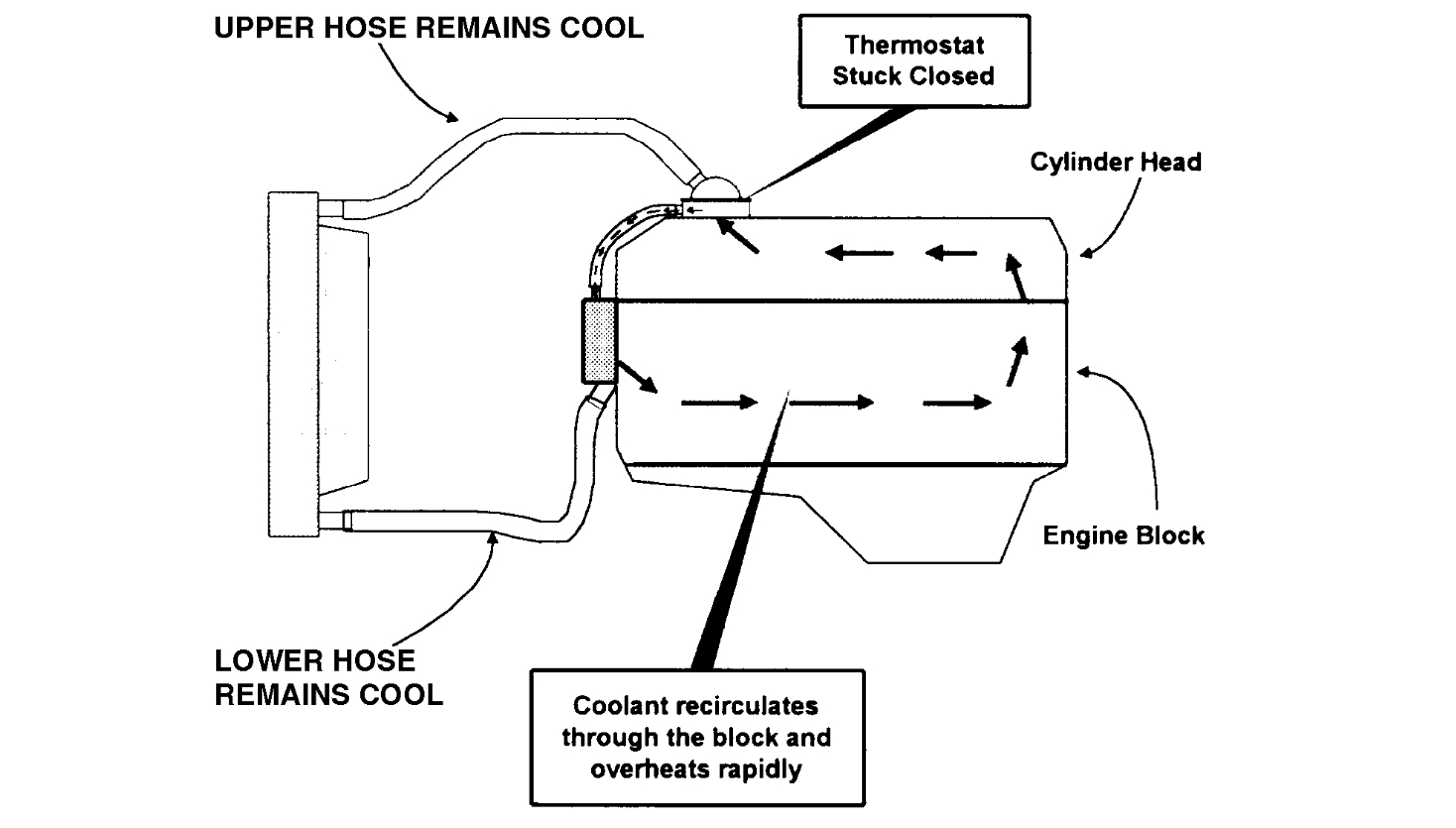

This sounds like your vehicle's thermostat may have stuck shut. Every vehicle has a thermostat in it that allows the coolant to heat up and then it opens at a predetermined temperature to let the coolant flow through the radiator, which cools it. Then the thermostat closes again and the whole process starts over. This allows the coolant to get hot enough so your vehicle has a heater and a defroster. When a thermostat fails it either sticks open or sticks closed depending on how it was when it failed, usually closed. Thermostats are very easy to change and can be done with usually with just a wrench and a screwdriver. In the diagrams down below I have included the Original Equipment Manufacturer [OEM] part number for your reference, a guide explaining all the possible ways your vehicle could overheat for your reference, and instructions for the removal and installation of your vehicle's thermostat. Please go through these guides and get back to us with what you are able to find out. I hope that this helps.

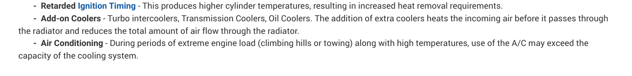

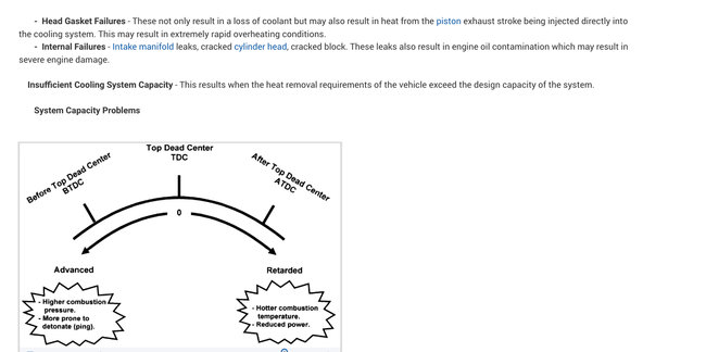

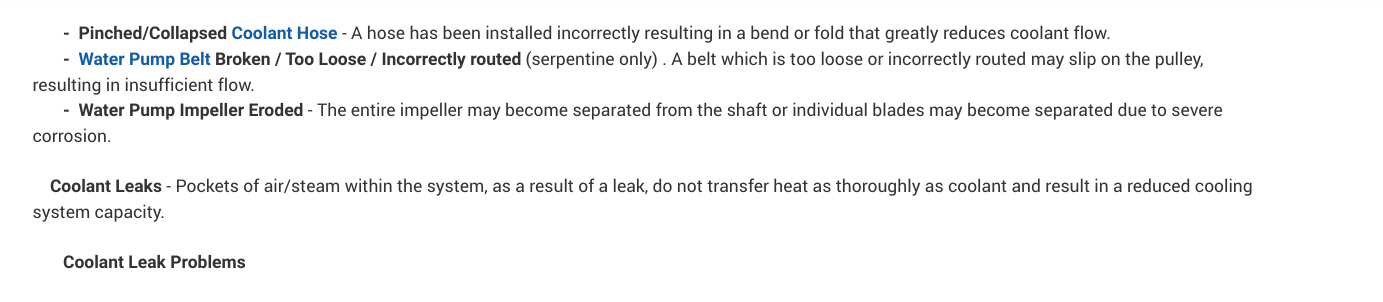

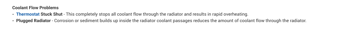

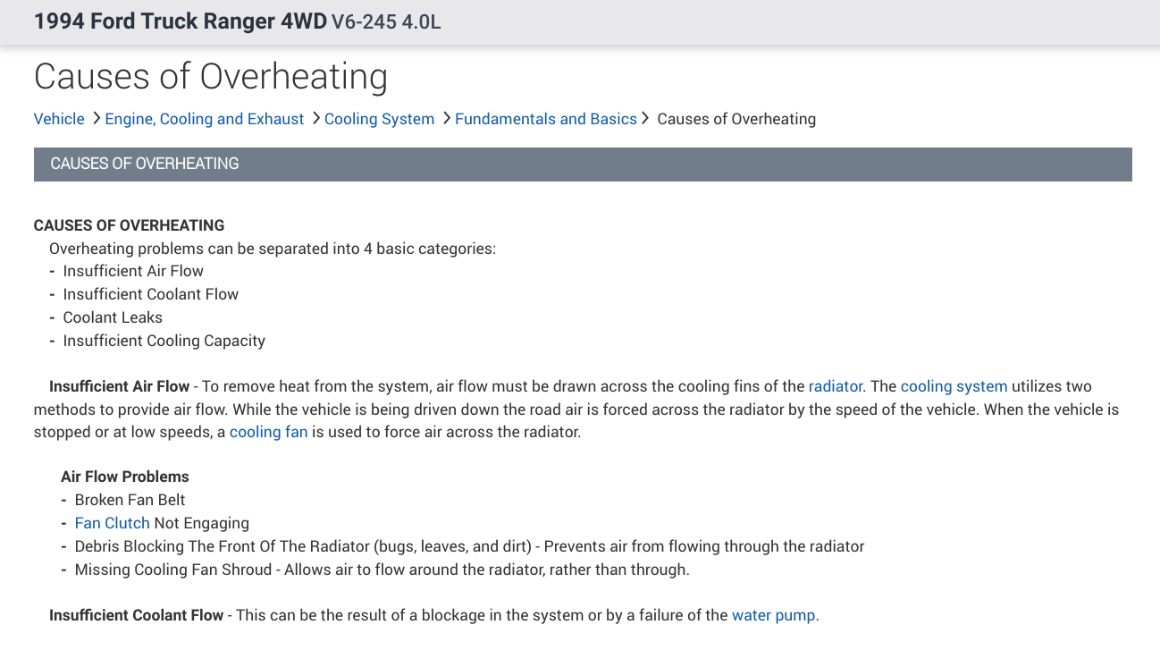

Is your radiator fan working correctly? This guide can help us fix it
https://www.2carpros.com/articles/engine-overheating-or-running-hot

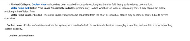

Upper hose is hot. Lower is cool?
Suspect faulty thermostat, bad water pump, restricted radiator, trying having it rodded out. Or take it off and apply radiator flush to it and keep running it through.

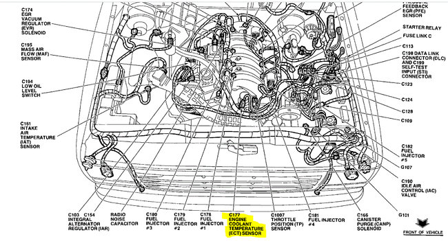

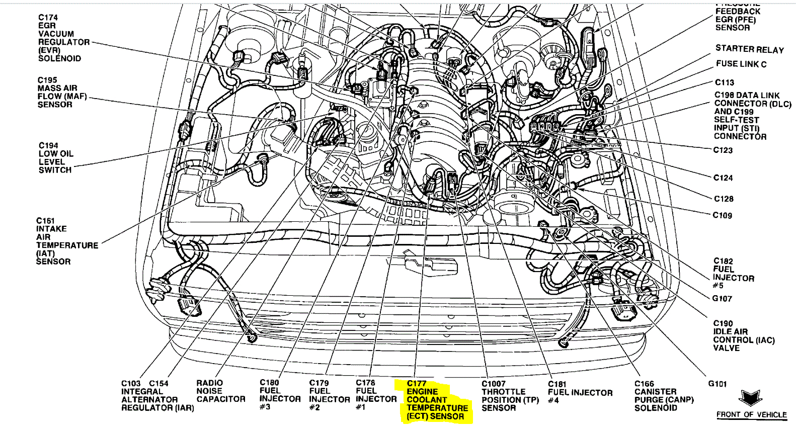

I read through you description of what is happening. I have a couple ideas that could be causing this. First, you mentioned that within 2 minutes, the vehicle reaches the 3/4 point. That is hard to believe it would happen that quickly. Have you checked the coolant temperature sensor? It may be sending random signals.
The first thing I would check for are diagnostic trouble codes. Here is a link that explains how to retrieve codes on a Ford OBD1 system:
https://www.2carpros.com/articles/ford-lincoln-mercury-obd1-1995-and-earlier-diagnostic-trouble-code-definition-and-retrieval
There is a list of OBD1 codes with definitions at the end of the link.

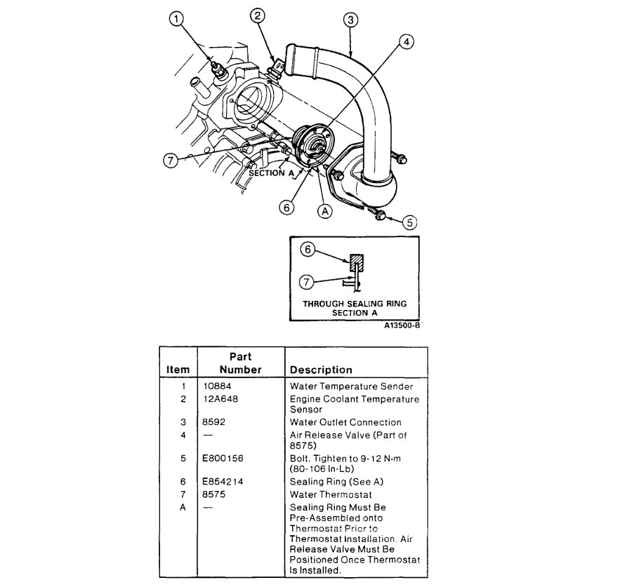

Next, I would first check the sensor. Here are the directions. Pic 1 below shows the sensor location.

If the sensor checks good and there are no codes, my next concern is the idea that coolant shoots from the radiator after about 45 seconds. That quickly leads me to believe it could be the result of pressure from the combustion chamber via a head gasket. Do a couple checks on this idea. Here is a link that explains how to check for a head gasket issue:
Let me know what you find or if you have other questions. Also, keep in mind that the reason I'm suspecting one of the two things above is simply because it happens at highway speeds and you have already done all the basics.

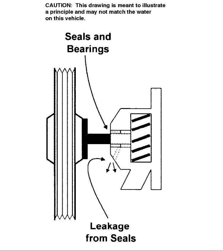

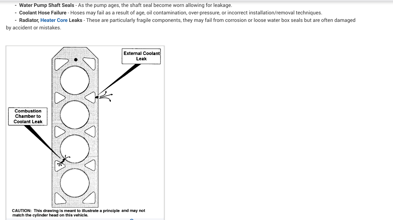

Can you tell me if the coolant level is dropping? As you are most likely aware, there are different things which can cause the engine to overheat. Things such as low coolant, a stuck thermostat, even a bad head gasket.
With that in mind, I am going to provide a few different links which are designed to help identify different causes of overheating and how to check.
First, if the coolant is low, check the following:
https://www.2carpros.com/articles/radiator-pressure-test
https://www.2carpros.com/articles/car-is-leaking-coolant
https://www.2carpros.com/articles/coolant-leak-symptoms
____________________
Here is a link that shows how to check a cylinder head gasket for leaks:
___________________

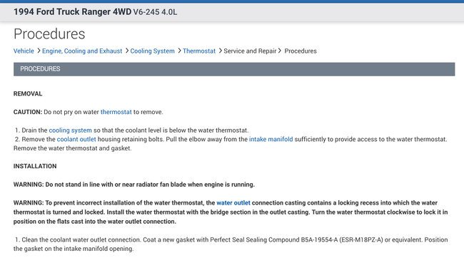

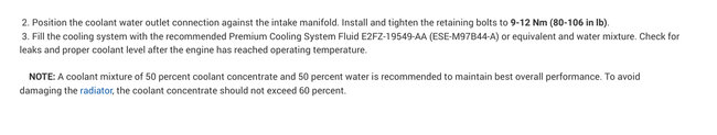

If the coolant isn't low and you can find no evidence of leaks, my next suspect is a bad or stuck thermostat. The first link discusses a thermostat, it's general location, and how to check one.
https://www.2carpros.com/articles/how-an-engine-thermostat-works
Here is a link that shows in general how one is replaced:
Once you review the aforementioned links, let me know what you find so I can further help.
