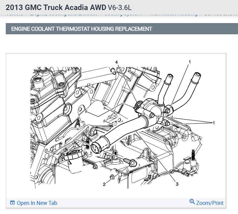

When I got home, I noticed the heater hose line connecting to the thermostat housing was snapped off (furthest back on the housing).
I thought I solved it. I added about a half-gallon of coolant into the radiator, not the res. It started getting hot again. Message did not go off. Diagnostic reader is matching pretty close to the dash temp gauge.
Turn heat on and can't feel heat, but that line replaced is hot. The radiator hose at the front of the housing is not.

To be clear you fixed the "heater hose line connecting to the thermostat housing" correct? If so, it sounds like the thermostat is stuck closed, here is a guide to help, please go over it:
https://www.2carpros.com/articles/engine-overheating-or-running-hot

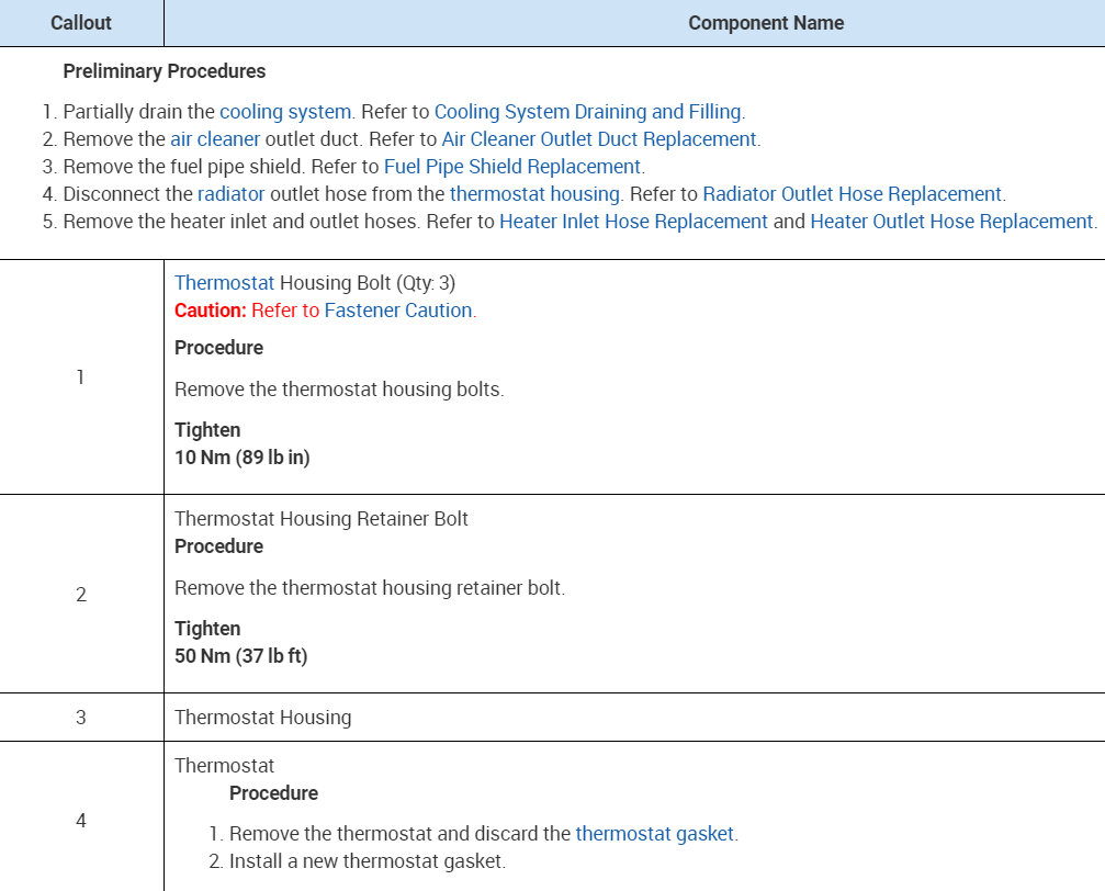

Here is how to change the thermostat out. Check out the images (below). Please let us know what you find.

Thank you for the response. Yes, I did fix the heater hose line. I have a new thermostat and housing that I bought before I saw the broken connector. I am hoping it is the thermostat and not the water pump.

I put the new thermostat and housing on. No bubbles in the coolant from the radiator. Heat blowing again in the car. Mind you, it is 50 degrees outside, so I will take it for a drive in the morning.
