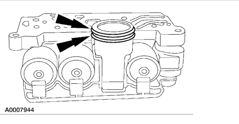

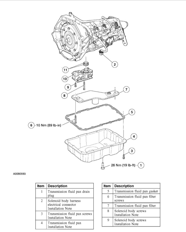

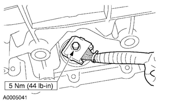

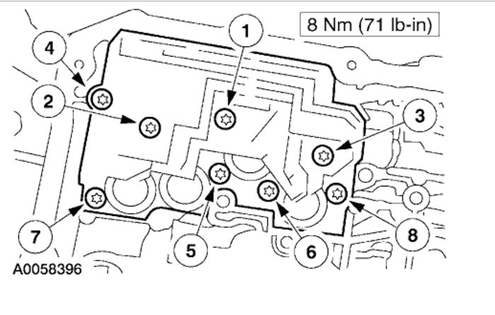

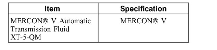

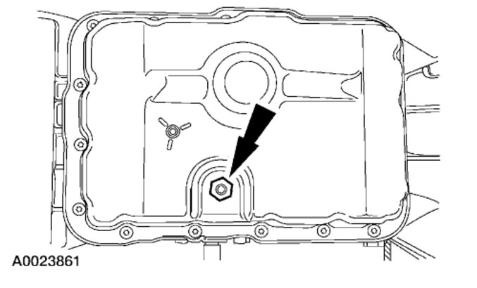

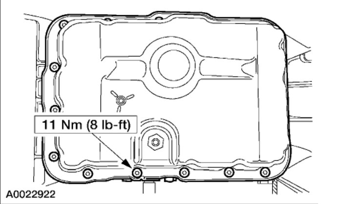

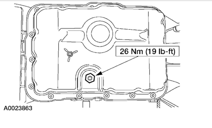

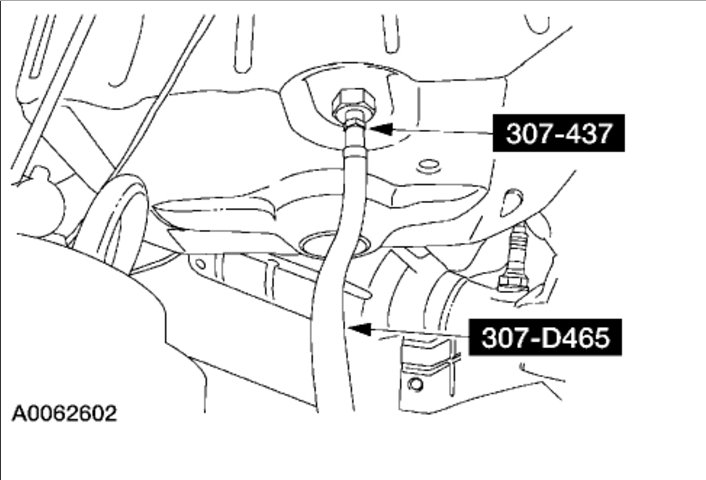

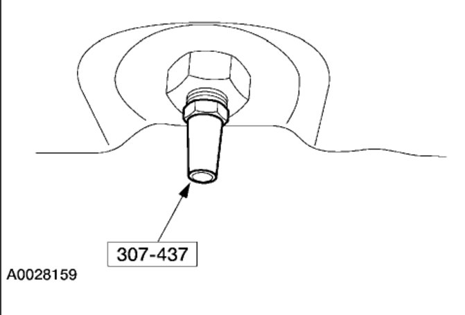

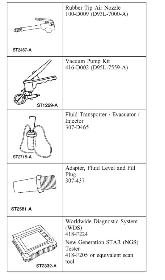

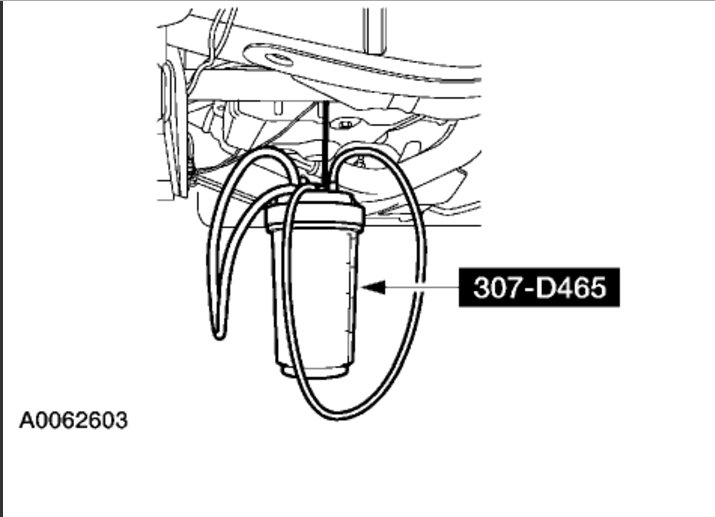

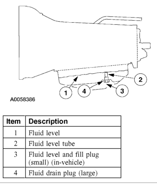

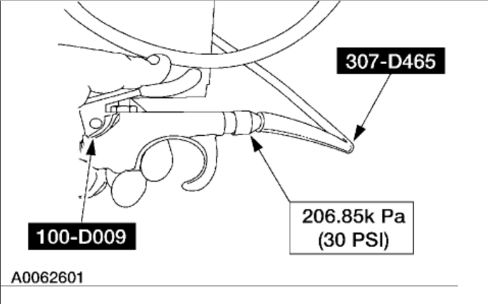

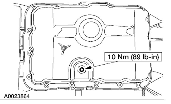

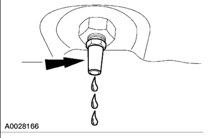

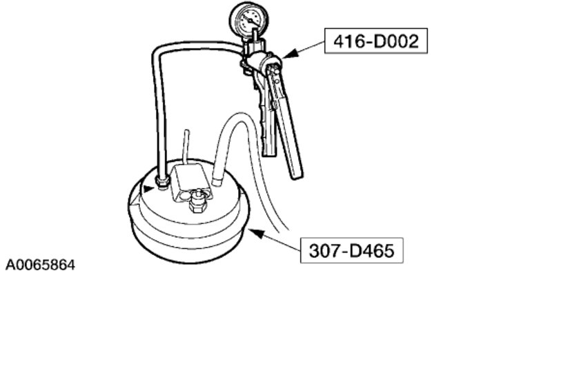

Yes the trouble code is what you should go after first. The solenoids go out all the time and are not that bad to change. You will need to jack the car up safely to do the repair. Here is a guide for that.
Then you will need to drop the pan.
Also check the connection at the transmission plug for corrosion. Here are some guides for the job. To refill the transmission you basically pump fluid in from the bottom and let the excess run out.
Please let us know what happens and upload pictures or videos of the problem.

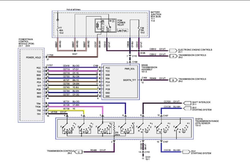

Ok. the code is P0747. My idea was to change the trans fluid 7 filter before that. Now i need help on what i have to do. Where is the Pressure Solnoid A located. Just replace this solenoid or it's better to replace all at once if they're in one block/pack.

It is in the transmission. It is attached to the valve body.

The pressure control solenoid is stuck on, so that could play a role with the reverse. I can't guarantee it will fix it, but I feel that it may be the problem.
