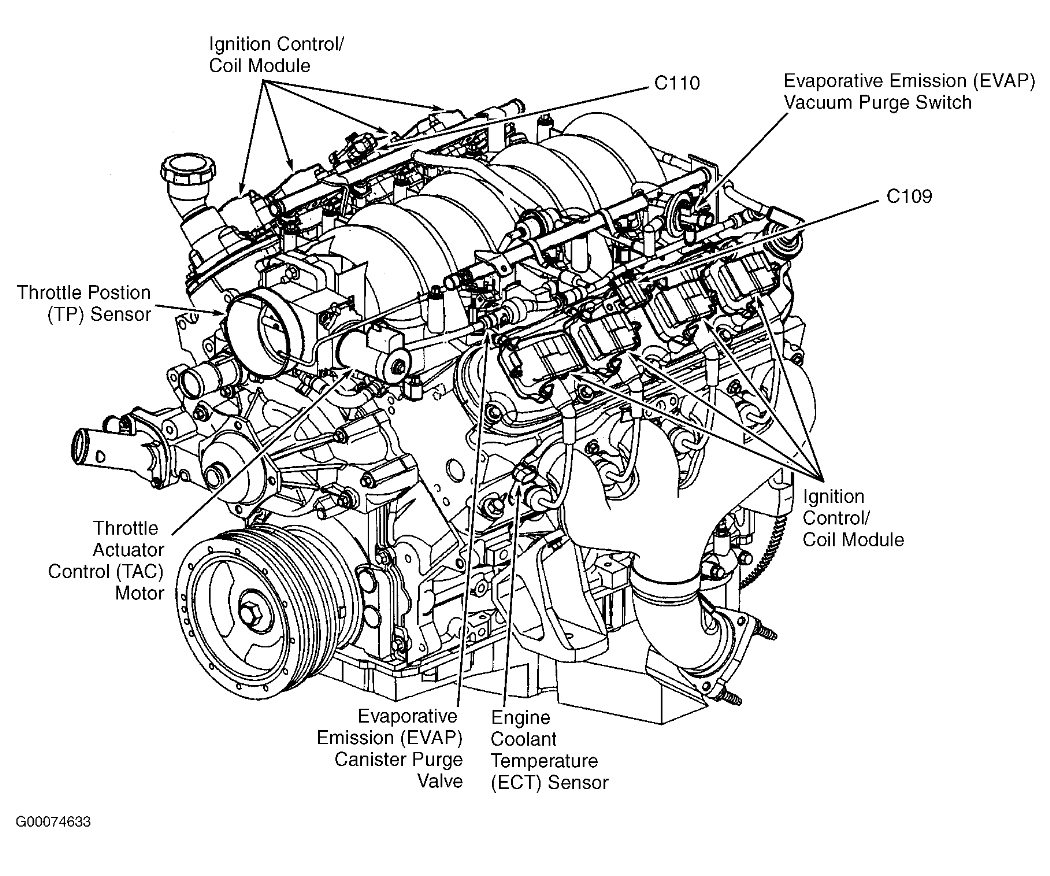

Hey Terry,
I would also check the coolant temperature which controls when the fans come on.
Here is the location
