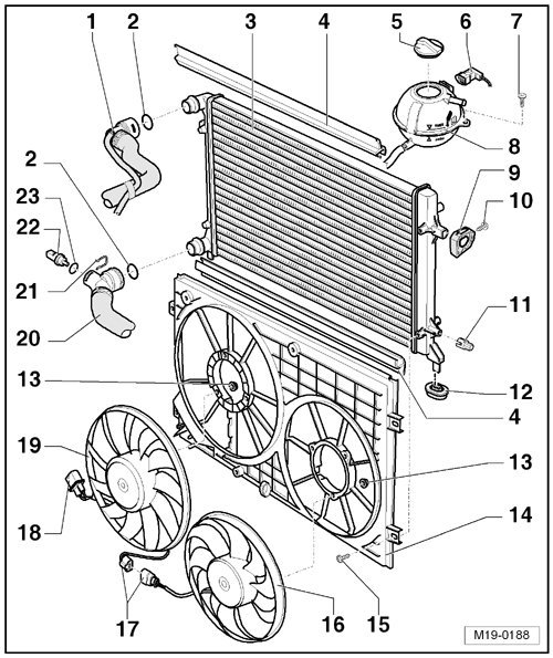

Car recently started overheating. Took it to repair shop and they replaced the radiator and thermostat. Car now runs very hot after I get off the freeway and stop at a light, just about in the red but a couple bars from it. Also, I have no heat. AC does not work but I know that is because it needs a new compressor and just cannot afford to fix right now. I only mention it to give you a complete picture. Any advice would be very appreciated.
Nov 26, 2018 at 3:00 AM
  • 110,248 POSTS
Hi Susan and thanks for using 2CarPros.
First, if you have no heat, check and confirm the coolant level is not low. Also, since they just replaced the radiator and thermostat, there is a chance there is an air blockage in the system. That should have been taken care of when the work was done.
Next, if the car only overheats when you drive slow or in stop and go traffic, it sounds like the cooling fan may not be working. Pay attention to see if you hear the fan come on when the temperature starts to go beyond normal toward hot. Since they replaced the radiator, they may have simply forgot to reconnect the fan. It would have been out of the car when the rad was replaced. Also, the coolant temperature sensor may have been left disconnected in the radiator.
Take a look through this link:
https://www.2carpros.com/articles/engine-overheating-or-running-hot
I attached a picture of the radiator and components around it. It should help you to identify where the fan connections and the sensor is located.
Let me know if this helps.
PS: If the coolant level is full, I would go back to the shop that did the work and let them know it is overheating and you have no heat. They need to bleed the system so you have heat. Also, an air blockage can cause it to overheat.
Nov 26, 2018 at 4:39 AM
SUSAN WILLIAMS2
Took it back and they checked everything and decided it must be the water pump. Have not got the car back yet but I hope they are right because that was an additional $500.00. I showed them your response and they said that they had bled the system and they checked the coolant temperature sensor.

Hi Susan:
If it was only overheating when stopped, I question that it is the pump. It could be, but I feel there are other things more likely. Did the heater work prior to it overheating? Did you notice if the cooling fan was turning on when it started overheating?
Nov 27, 2018 at 9:36 AM
SUSAN WILLIAMS2
We do not really know if the heat was working prior to over heating problem. In Arizona the heat is seldom necessary. When I got off the freeway and stopped at a light the car would get hot and I pulled into a parking lot and checked and the fan was running. The car would cool down pretty fast after I started driving.
Nov 27, 2018 at 12:13 PM
  • 110,248 POSTS
Okay, if you heard the fan, then there is a better chance it is the water pump. I just do not want you to get taken.

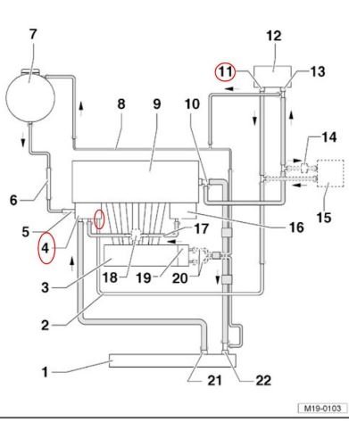

Anyway, I would like you to ask the tech one more thing. Take a look at this. It is basically the same as what you are dealing with. And the water pump was replaced, but the vehicle still overheated. They found a kinked hose was the problem. Read through this and consider asking the tech if the lower radiator hose gets hot and if he could check the specific hose mentioned. I attached a picture which shows hose number 2.
____________________________________
Replaced Thermostat and Water Pump Already, No Change.
When Run with Out Thermostat, Vehicle Does Not Overheat, and Engine Temperature Does Not Exceed 140 Degrees.
Cooling Fans cycle as Specified.
With thermostat installed the lower hose never gets hot.
Overheating
We found heater output was insufficient.
We flushed out the heater core and heater output improved, but not very much.
TECH-ASSIST
02/09/2017 | 09:56:37
1 Repair(s) Available
Verified Repairs(2)
TECH-ASSIST
02/09/2017 | 10:19:06
After multiple vacuum drain and fills, condition remains the same, doesn't seem to have an air pocket.
Vehicle doesn't boil over, just runs hot and warning light will flash. Fans come on.
We looked at the flow diagram found the #2 hose in the diagram hits squarely at the back of the Thermostat, because of the way of the outlet line back to Thermostat housing, it caused the overheat condition along with poor heater operation.
Replaced the Heater Core, over heat issue solved.
