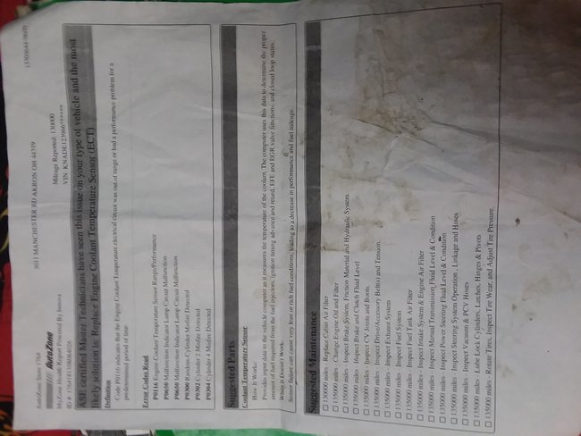

Yes that is running fine. I will get it started again and let you know I only have one battery atm. So I will have to get a new one soon. But here is a picture of the paper I got from AutoZone. When we drove it there from the car lot let me know what you think about that.
Dec 3, 2018 at 9:57 AM
  • 110,246 POSTS
The codes can all be the result of overheating. Lets hope everything works properly once again when you start using it.
